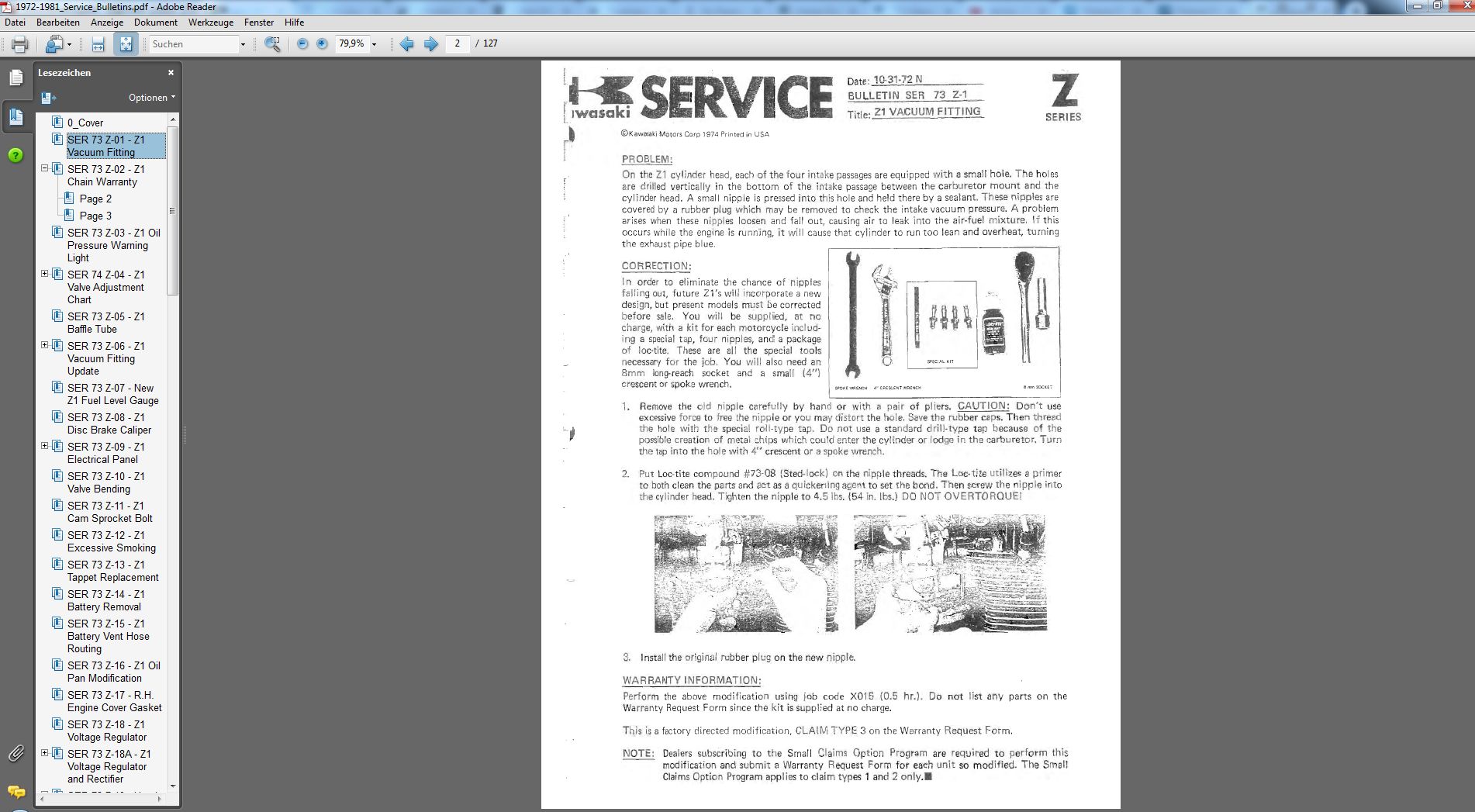

A very rare early cylinder head with press fit vaccum fitting on the intake ports, unbelievable!!! What are the frame and engine nummers???
