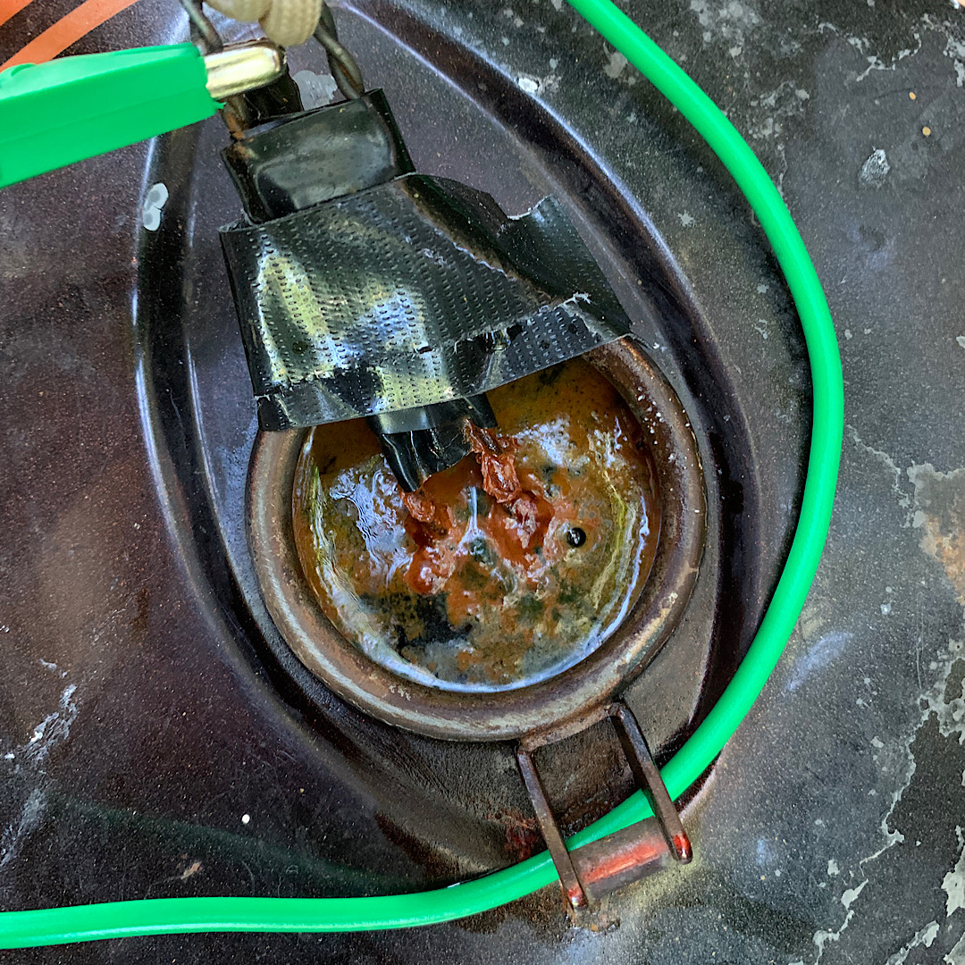

Re: 1973 Z1 Maui
14 Nov 2021 14:50 - 28 Dec 2021 13:54
Sounds good.

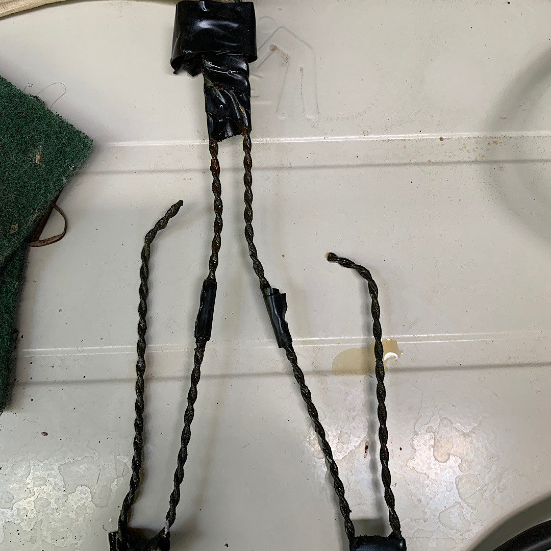

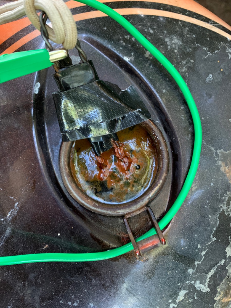

my electrolysis setup is slowly working. My anode is twisted rebar tie wire. Doesn’t look like much but it’s working.
half of engine back in the frame.

Re: 1973 Z1 Maui
16 Nov 2021 17:35

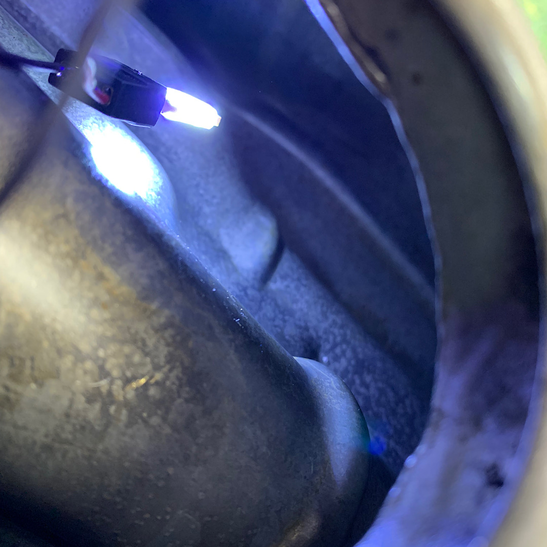

The tank interior is quite a bit better. I’ll be taking it over to Oahu early December for repair and paint along with the side covers and tail. I’m going to hand carry both ways. My little twisted iron tie wire worked a lot better than I expected.

Re: 1973 Z1 Maui
21 Nov 2021 18:54
I did a 3 hour soak with Metal Prep, diluted, the tank looks much better now. On to repair next month.

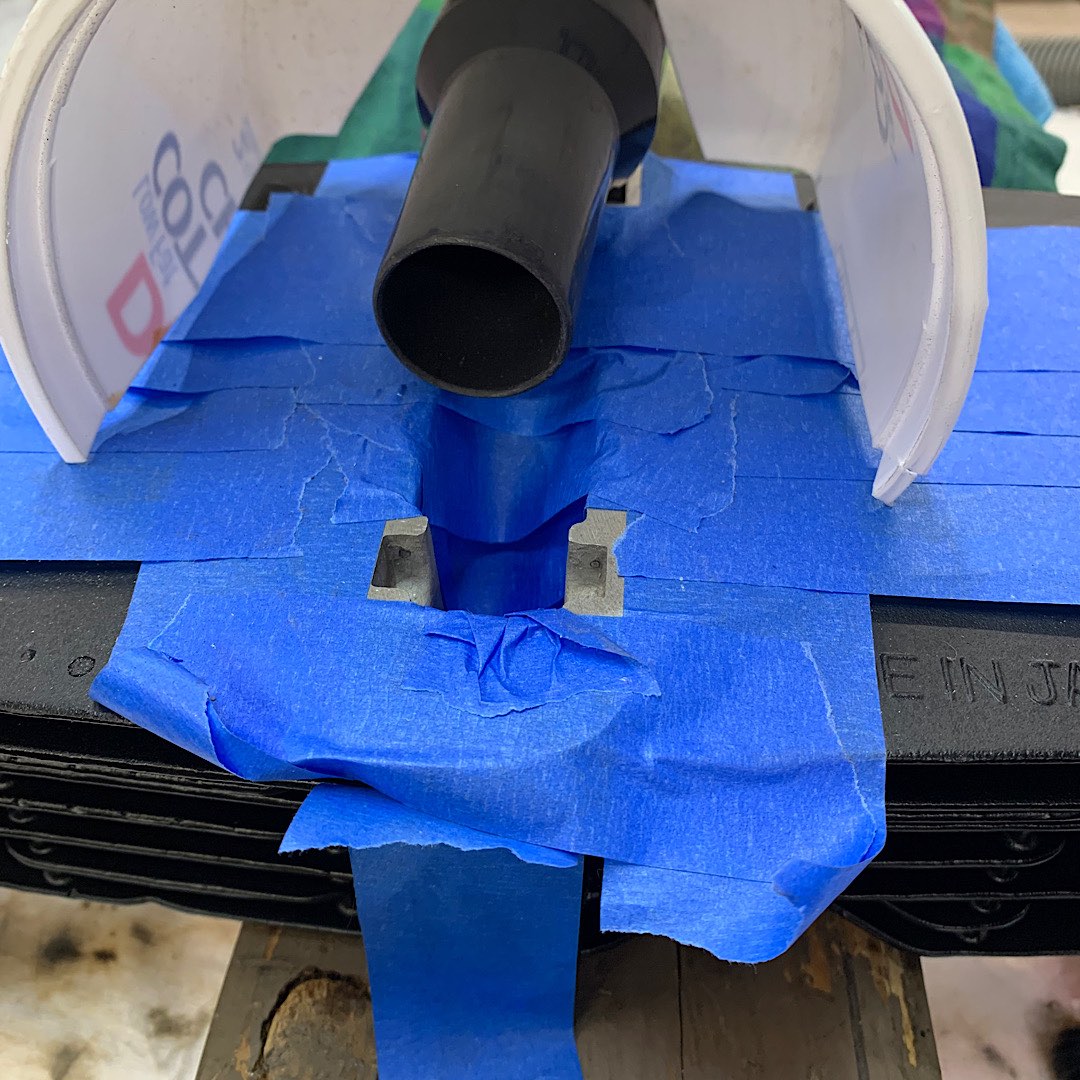

I also spent some time on the top end getting ready to assemble. As I suspected the TSB Z25 was incomplete. The PO did not relieve the inboard area of the slots to let the pin settle into the slot properly. I hope to fix that tomorrow.

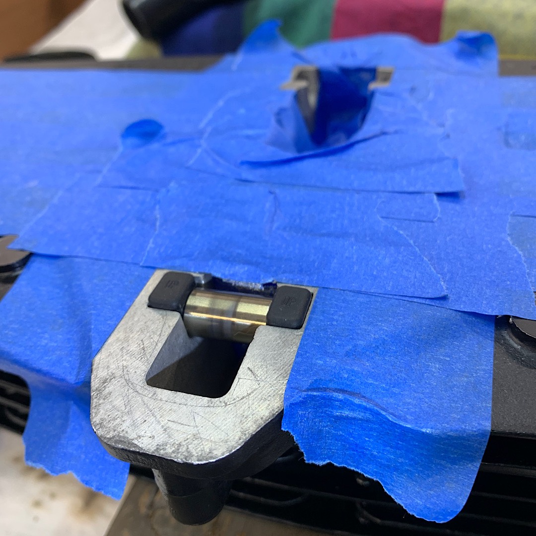

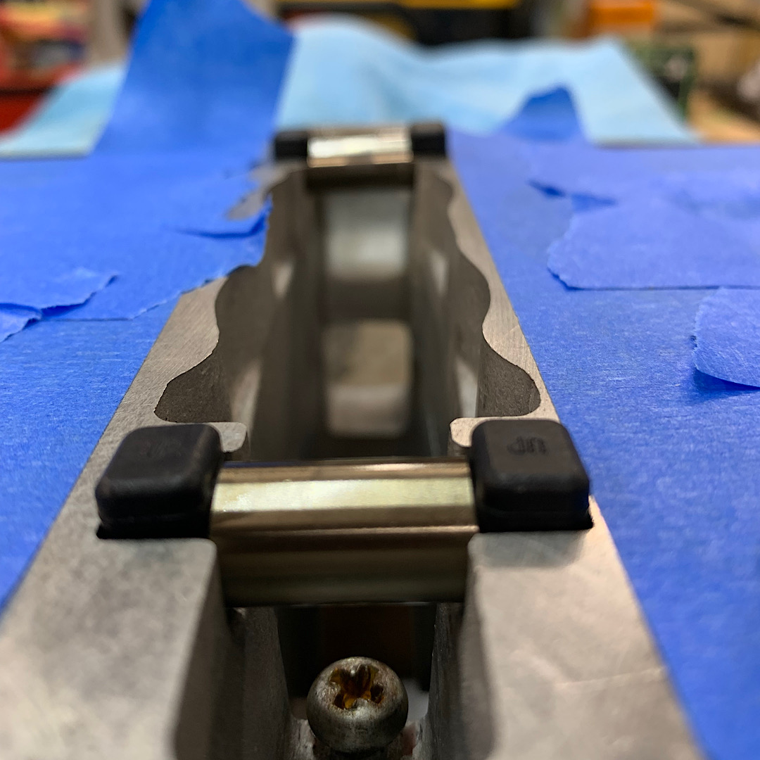

Re: 1973 Z1 Maui
23 Nov 2021 07:25

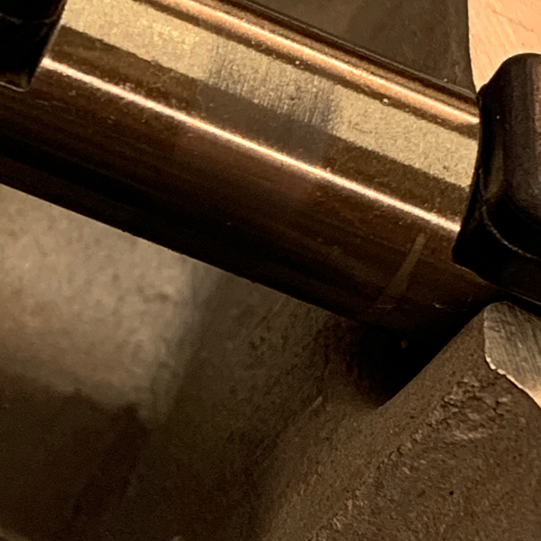

i worked on getting the idler sprockets to fit correctly. much better now.
i also fit the cylinders. they went on easily enough but they rock a bit when all the way down, i suppose it's the rubber blocks on the lower idler, i lifted the cylinder a bit to look and I also notice the sleeve o rings managed to slip down some, I wish they stayed in place, I suppose i need to remove the cylinder to push them back up but I'm not sure it will do any good

Re: 1973 Z1 Maui
23 Nov 2021 15:08
I can;'t reall any rocking motion of the cylinders when installed. There should be two locating pins between the cylinders and the case. Do you have them installed?
As far as I am aware I've never had a problem keeping the o rings in place, but I've never looked. Did they come with a gasket kit?

Re: 1973 Z1 Maui
23 Nov 2021 19:58
There are 2 sizes of those dampners. Top 2 idlers & lower one in the block on engine case. You have te correct ones? And that idler shaft looks a little worn too?

Re: 1973 Z1 Maui
24 Nov 2021 06:48
I'll remove the cylinders and check everything just to be sure.
The dowels are there
The rubbers are correct with the "up" side up.
I'm going to have a big slow down while I wait for my tank to be fixed. I am hoping this comes out ok, if it works I'll have the original tank on the bike. I'll keep the spare in case.

Re: 1973 Z1 Maui
24 Nov 2021 13:51

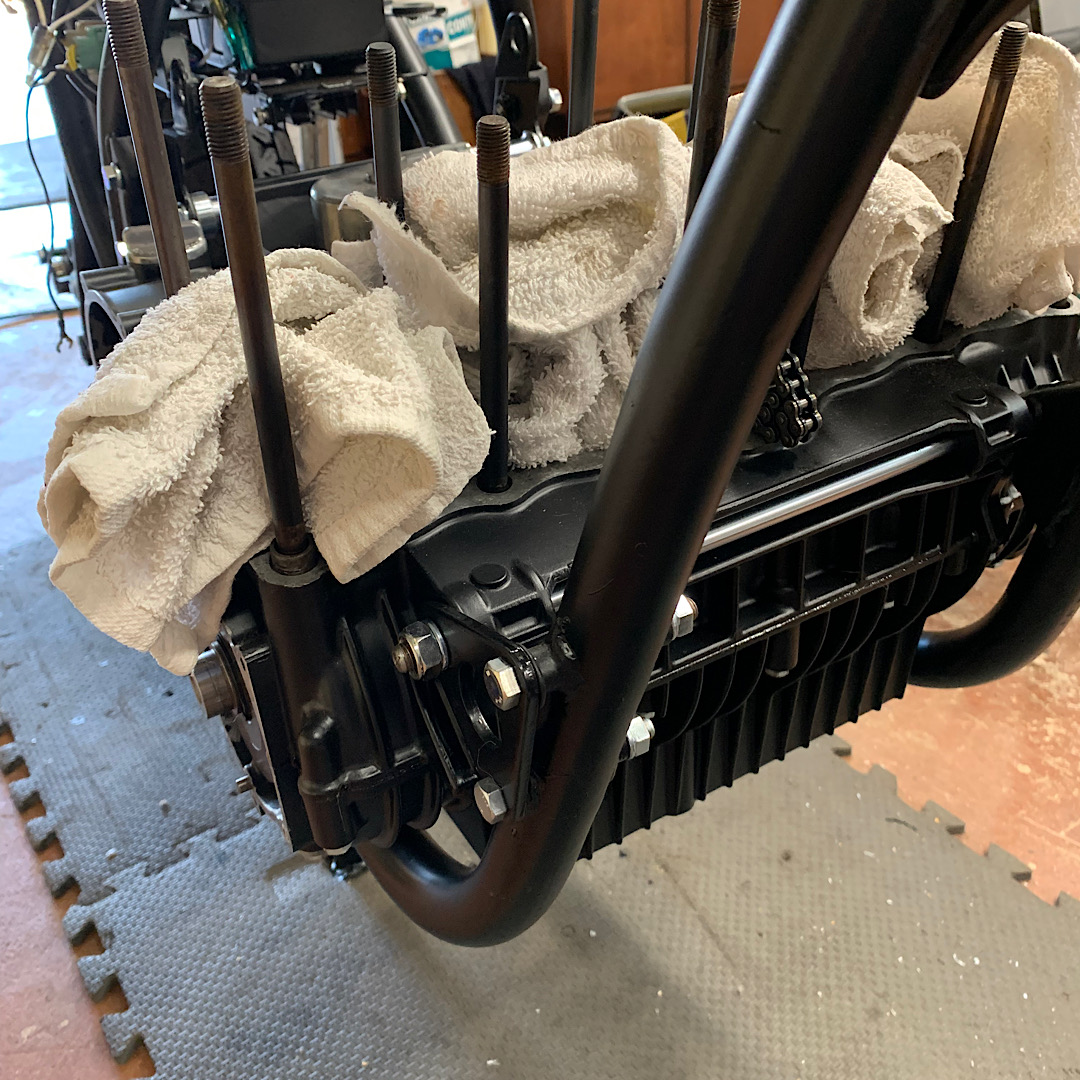

I removed the cylinders and found that the lower idler shaft had rotated a bit making the rubber block too proud. I put it back and lightly tamped it down so it would sit still.I also coaxed the o rings into the grooves which isn’t easy as they like to kink up. Second time was a charm, went right together, all torqued up. Move on to the head, which went on nicely, working on cams right now, I’ll get new photos.
I took a look at my old cams and the exhaust is even worse than I thought, I’m glad I got a set of hollow stock cams from Johnny’s.
I ordered the exhaust, it will be fun to hear it run with stock exhaust and a choke system that works.
I’ll recheck torque in a few days just for grins.
