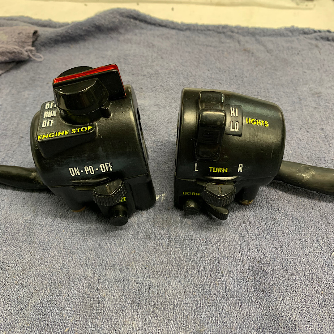

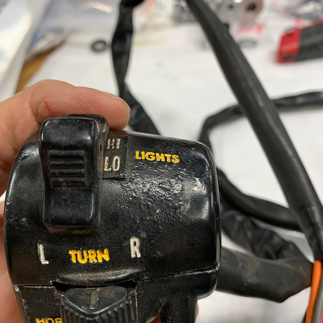

I'm in a bit of a slowdown here waiting for some stuff. In the mean time I tackled my switch gear. They were not stock, a little rough but the wiring was ok and the switch contacts inside were ok so I took a shot at cleaning them up. Glass bead blasted, painted and re-assembled, I'll try them out. I'm not sure I could ever find NOS replacements so I thought I'd see if these re-pops are still ok to use.
Glass beads are my friend. They don't tear up the alloy, they just clean it, if a bit slowly.

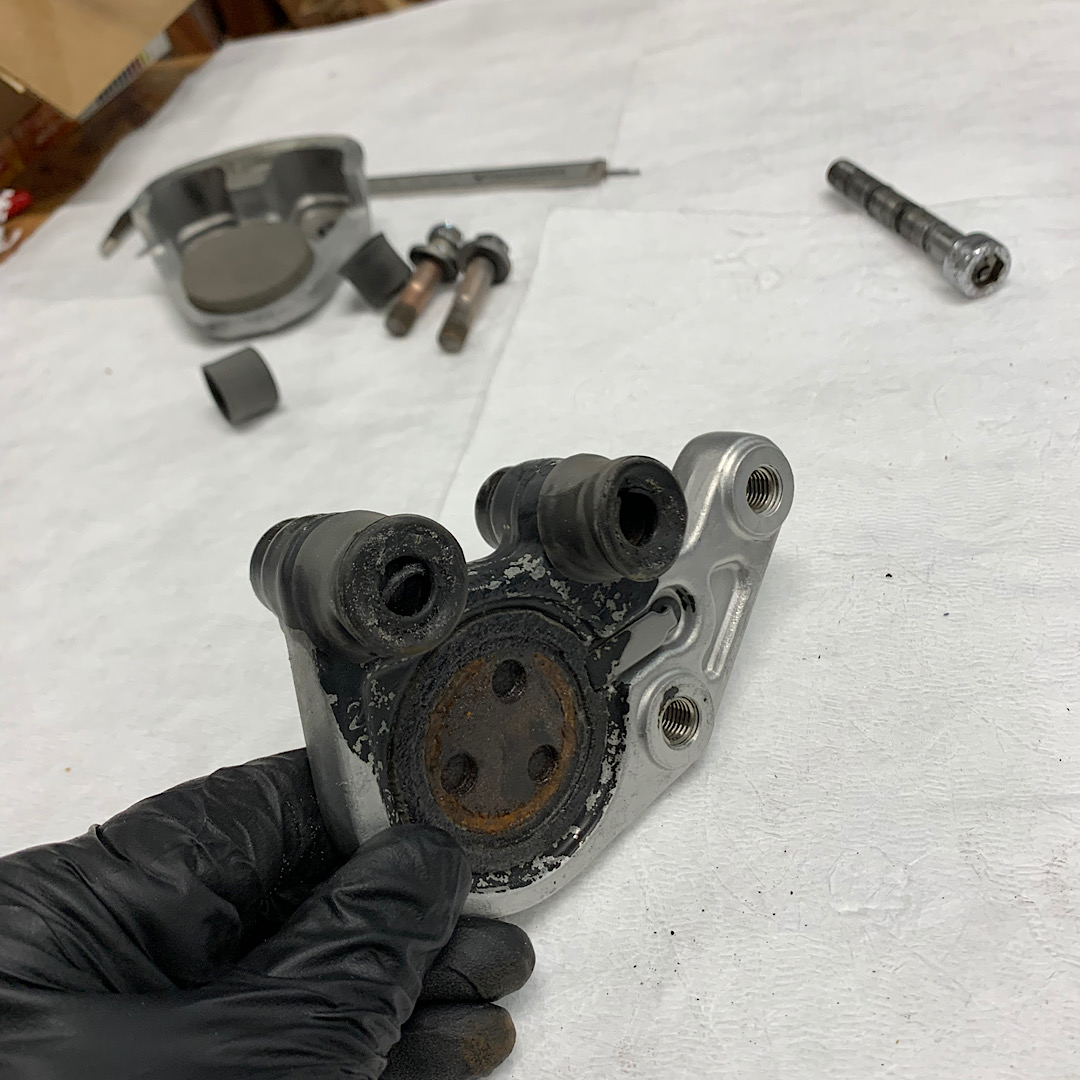

I started on front brakes.
First I bead blasted as much as I could. The PO had put lots of paint over the corrosion. Then I pumped the piston out. Fluid looked like mud. Lots of work to do here. I was going to dual disc it but I decided to keep it single. I’ll rebuild the MC and caliper. I have to get a repro disc because again, the PO got rid of the original disc.
the hoses will need to be replaced, lots of cracking. The pipe is pretty corroded too.

Soak that caliper in boiling water for 5 - 10 minutes. Then apply air pressure to the brake line input. Use welding gloves and a rag - the piston will pop out with some speed!

I think its a bit late for this, but my go-to method for removing a suck piston is to pump grease in via the bleed nipple. The pressure slowly and safely pushes the piston out.
