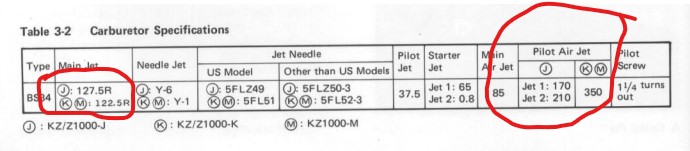

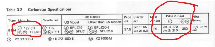

This is really interesting and certainly goes against conventional thinking but you know how your bike runs
interestingly if you look at a stock KZ1000 (J motor) as far as I am aware the only difference is the "J" has more lift on the cams than the "K" or "M" however the manual lists "smaller" pilot air jets but "bigger Mains" for the higher performance model (bigger cams = more flow) go figure !!
Would be interesting to see what the stock jets are in a 1100 (bigger capacity and hotter cams than a "K" ??
