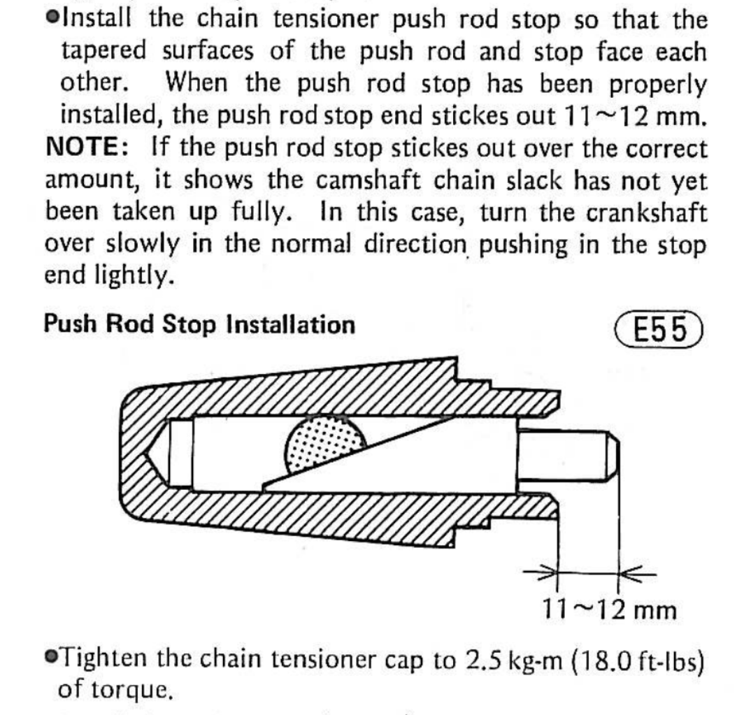

Correct tensioner adjustment range, on KZ and GPz 550 should be as shown below: excerpt from the Kawasaki manual.
However, this may not be correct for a ZR tensioner fitted to a GPz head.

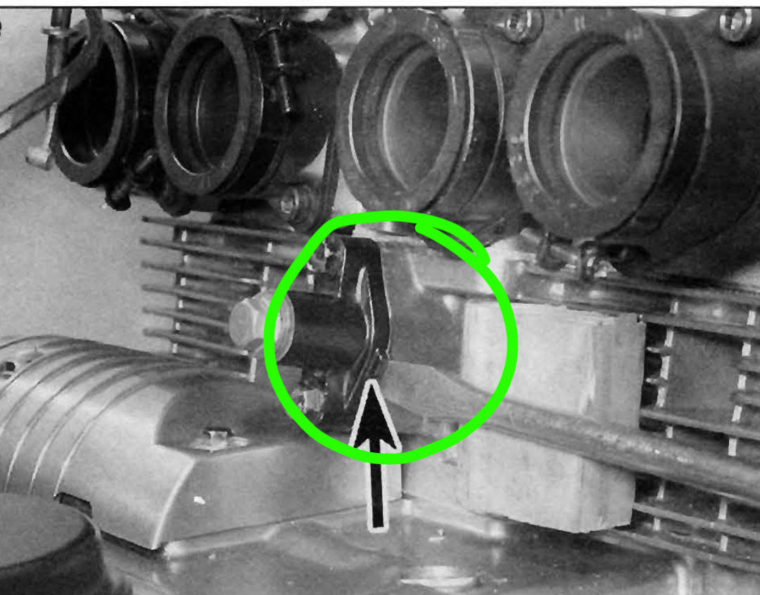

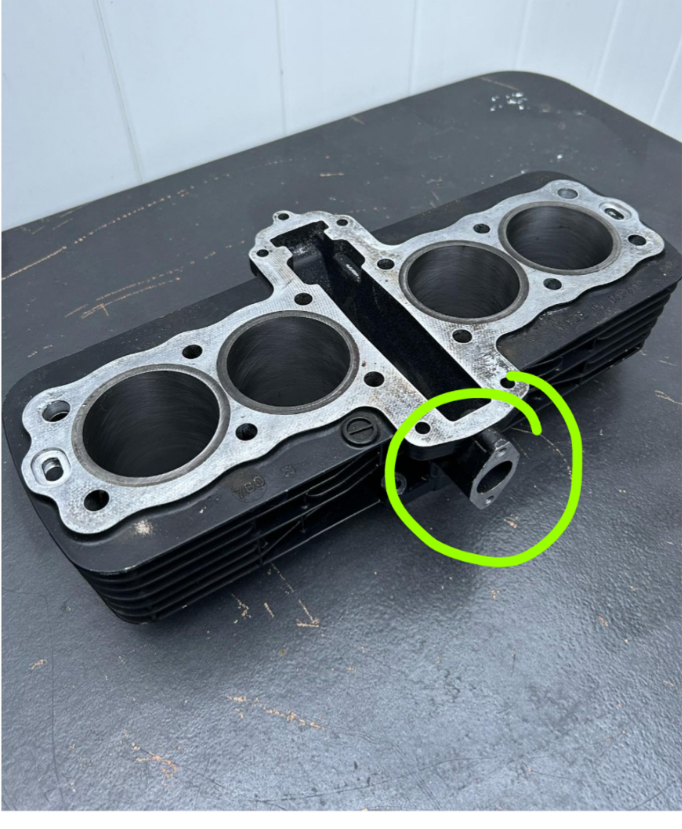

I can't be sure, but comparing pictures of the GPz head and ZR head, it "seems" that the tensioner mounting face on the GPz head is further out, resulting in the ZR tensioner being too short...
ZR Head
GPz Head
If it were mine, I would just fit a GPz tensioner, alternately, a manual tensioner...

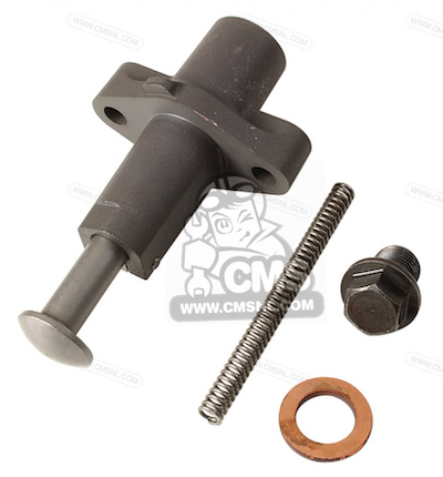

Oh, and one more thing. I found
this part
listed as a replacement for the regular cam chain tensioner, and noticed that it looks like a simple spring-loaded replacement, which at least to me makes a lot of sense. It's less expensive, and potentially less faulty than the stock tensioner, and wouldn't require periodic adjustment like a manual tensioner. Does anyone have any experience with these?

I note that the tensioner you refer too, from CMS is for a ZR 550 head, and not for the GPz...
It's not that simple, it has a " ratchet and pawl" mechanism that makes it "self adjusting" pretty much the same as a stock tensioner.
Anyhow, that manual tensioner you have installed will serve you well... If you adhere to Kawasaki recommended service intervals, and just listen... (you already know what " too loose " sounds like! )
