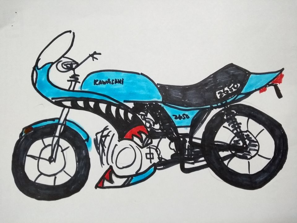

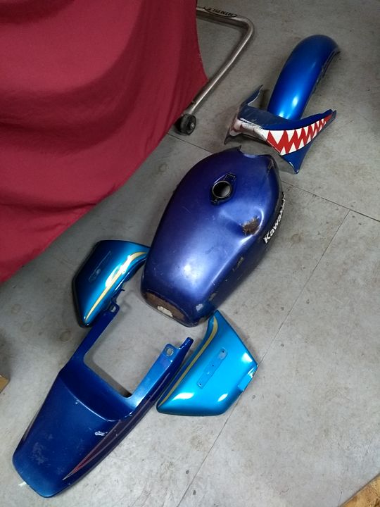

New paint for the bodywork is in order.
Will keep the Shark teeth, but make it bigger!
A rough sketch and playing with Paint3D;
Bodywork going to the painter;

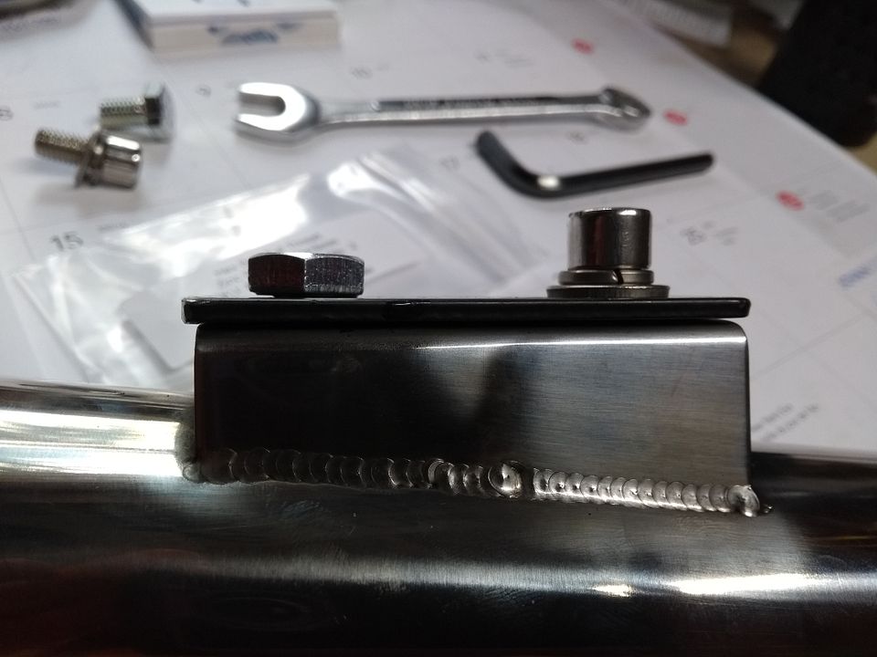

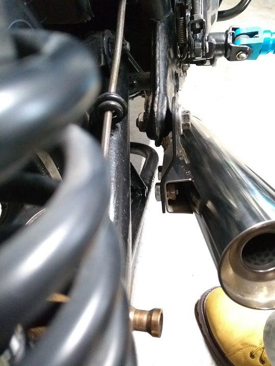

Was having contact between the swing arm brace and muffler mounting bolts.
Someone put me on to Canada Bolts where I could order online what I needed;

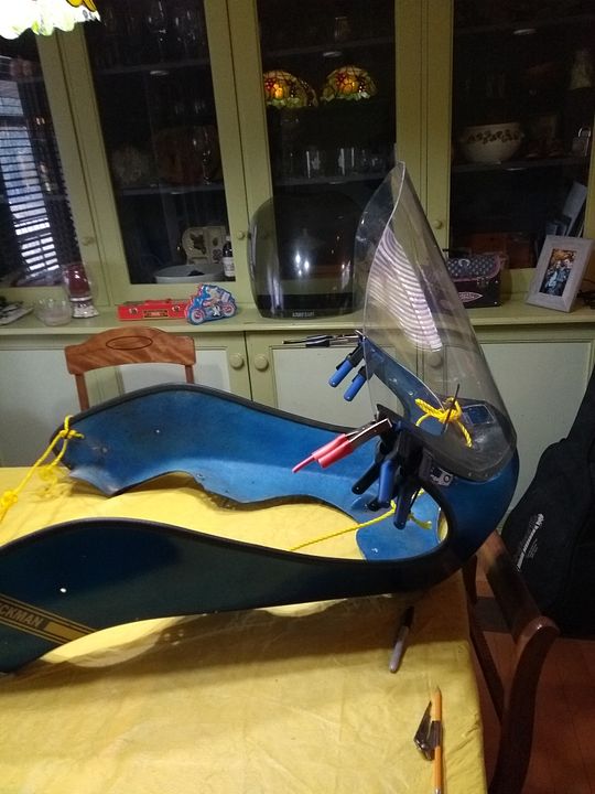

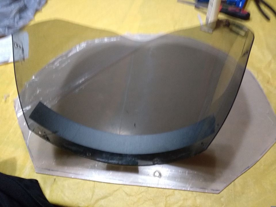

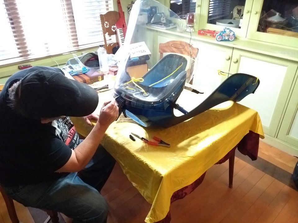

A buddy helped make a new shield for the fairing.
First attempt left a melted mess in his oven, but second try turned out not so well done;

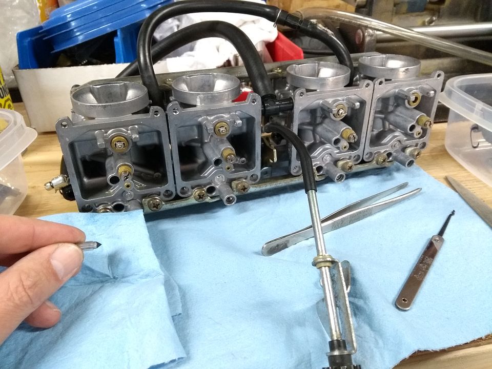

So off come the carbs again for a look.

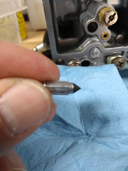

On the fuel valves, a few dark rings can be seen around their bodies.
Some type of corrosion or build up.
I took a fine file and smoothed up the four splines of each fuel valve, then cleaned them.

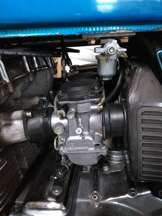

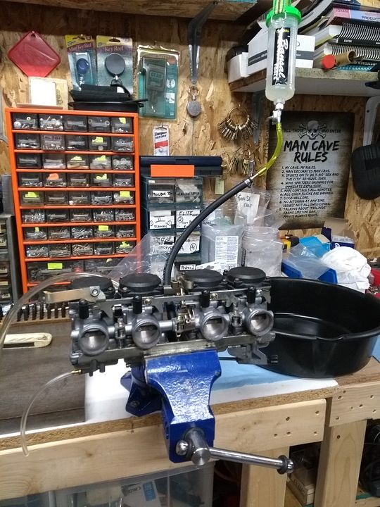

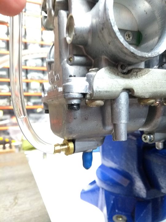

Checked and set the fuel levels this time.
#4 below was low on first check, but when I came back after checking the other three, it's level came up;

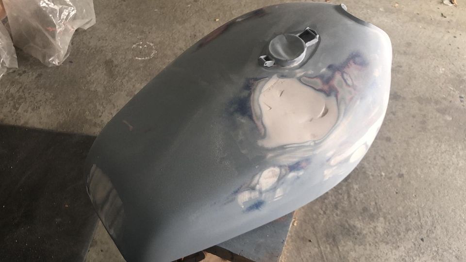

The painter sent me this picture of the bodywork being done on the gas tank I sent him;

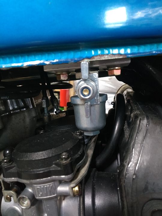

New 44mm Manual petcock found on ebay installed.
When the lever is up in the reserve position, it hits the bottem edge of the gas tank.
Some filing of the level looks to be needed;

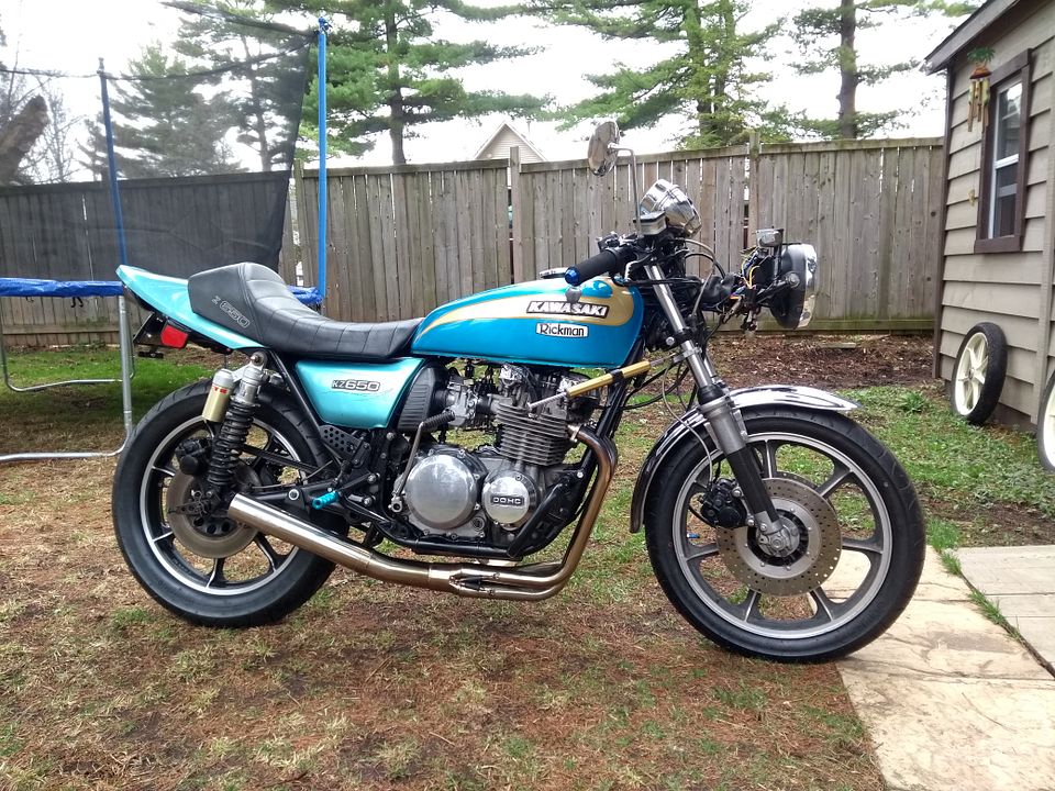

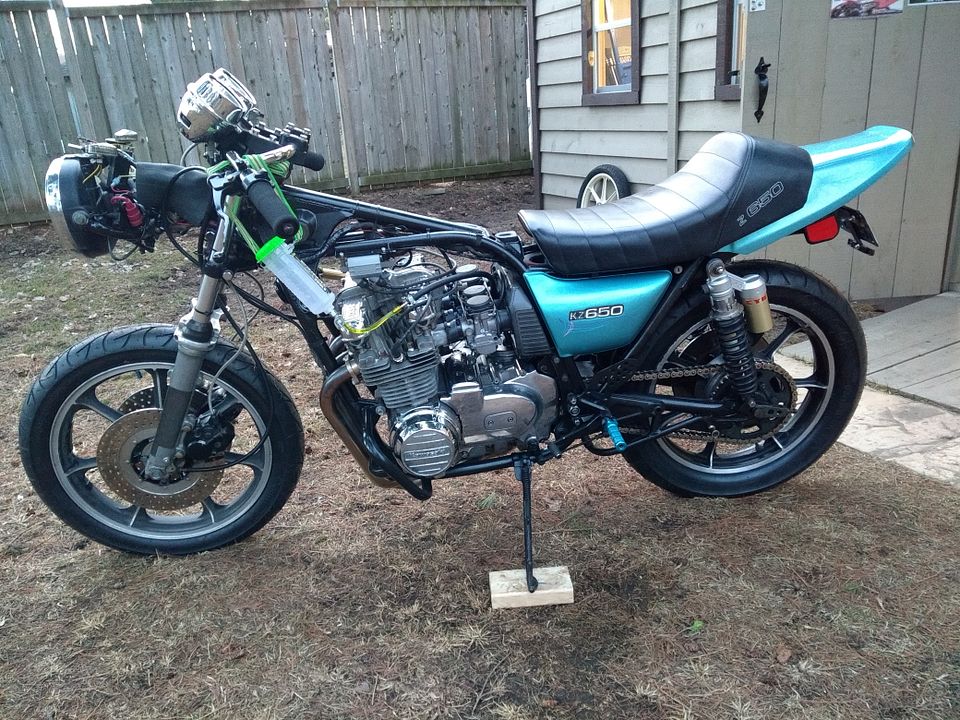

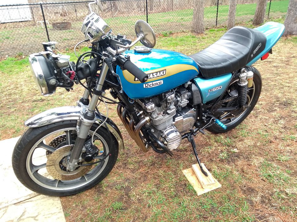

Re-installed the carbs.
Found some mirrors to put on, their normally on the fairing.
Added a stock front fender for now.
Polished up some of the chrome bits;

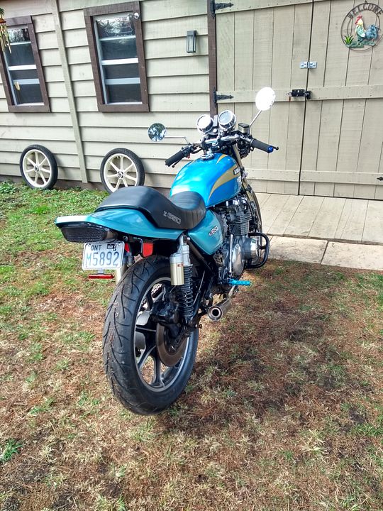

Another attempt starting her.
This time she fired right up, and sounded good.
I could tell she was running on all four.
Once warmed, she idled well.
Throttle response was good.
The rain had let up a little, and the Sun was out, so took her for a ride.
To the gas station and up the street.
20 kms/ 12 miles in all, and got up to 90 kph/56 mph.
She ran well.
Throttle response is good.
She handles the bumps well.
And the clutch is working smoothly.
Been 5 years since I rode her.

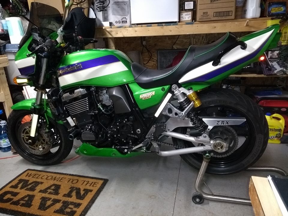

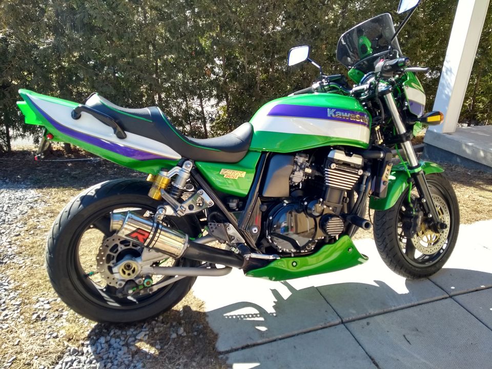

The ZRX1100, which got me off the KZ650, also got some TLC this past Winter.
One item I like is the green tail light.
It also has the signals built in, so off come the stock rear signals.
Rear fender also removed, and green undertail added.
The ZRX is so much like the KZ;
