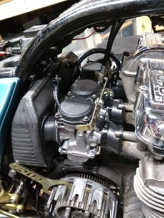

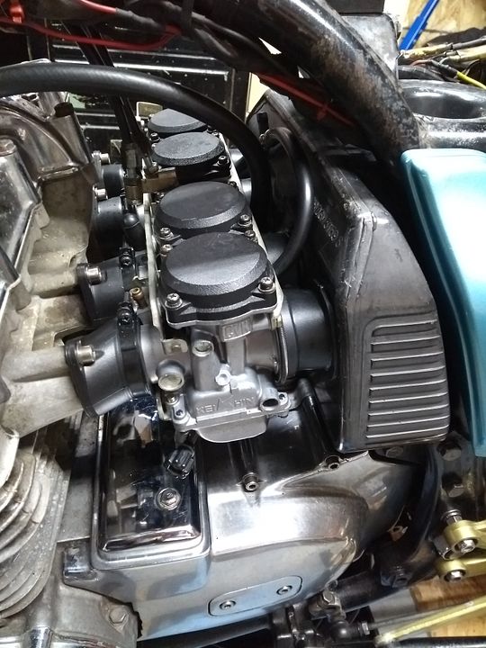

Part of the project this past Winter was installing a set of Keihin CVK32 carbs off a ZX600 Ninja.
I bought the carbs thinking they were ZR7 carbs, which was what's needed.
Thankfully the ZX600 carbs are the same size.
I followed Pablo's/z650Spirit's tutorial on installing the CVKs.
Also will use the stock ZRX shocks I have.

I used a spare air box with a bit of damage around hole #2;
Used some JB Weld to repair the damaged bit on the air box;

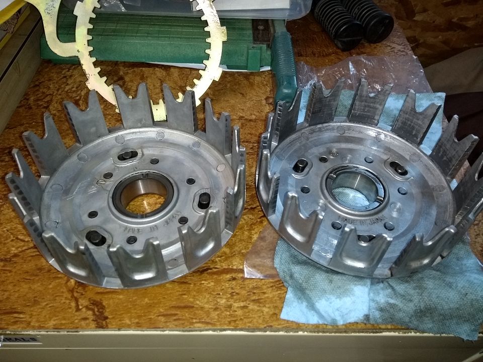

The clutch, having over 100,000 kms on it, is getting some attention;
New friction plates.
New basket, as the old Cir Cycle clutch used an extra set of plates.
The plates being thinner, have grooved the basket fingers.
The clutch release mechanism got all new parts too.

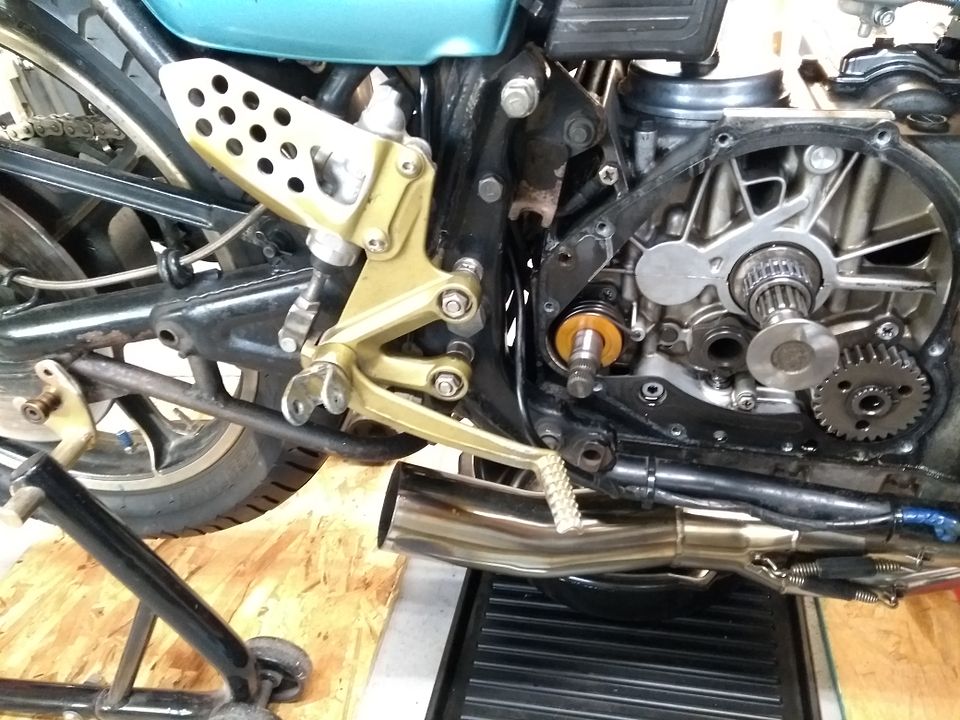

Re: Project Sharkey, 1978 KZ650C2
14 Apr 2021 07:07
