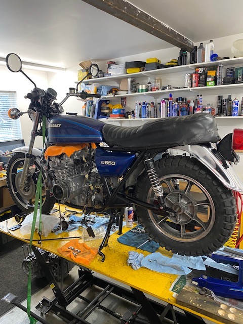

Looks good, what paint did you go with?
- Posts: 3133
- Thanks: 1235
Re: 1978 KZ650 Bike Build
07 Dec 2021 04:33
Tremclad Hi Heat Semi Gloss. I need to go to a city to buy VHT. Will use it on the brake calipers.

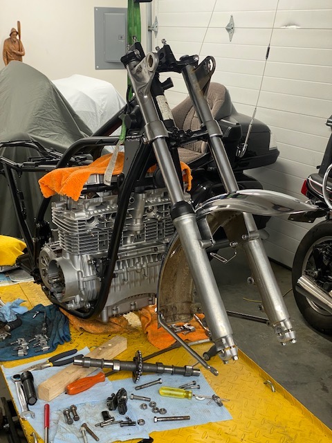

Running into a few hiccups. I put all the engine mounts in place except the rear upper. It's about a half diameter off the hole. Not sure why...all the other ones fit easily and there is no obvious damage to the frame.
I moved onto setting the timing. Everything went well but I need 5 shims that I don't have so I ordered parts to convert to shim over bucket. Waiting for them to arrive.
Still waiting for a new swingarm bolt so cannot work on the back end. That left the front end. It all went together quite well. The triple tree is from a Z1. The fender was a bit rusty but otherwise OK, and it cleaned up nicely with a bit of Mothers polish.

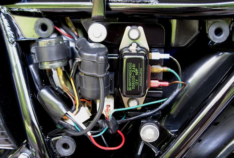

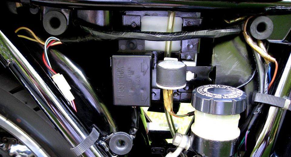

The bushing arrived and the swingarm is now properly installed. While waiting I began working on wiring. The main harness had been unwrapped so I was left with a bit of spaghetti to figure out. I have the front of the bike done but am having a bit of trouble with the other end. Could someone show a couple of photos of how the harness attaches to the frame under the tank and near the battery box?

Thanks Ron. They were very helpful, although I have both flasher units on the left site. (This is a D1). But he right side photo was very useful.
I've been working on wiring for a couple of days now. The headlight, brake lights, signals and horn are all operating correctly now.

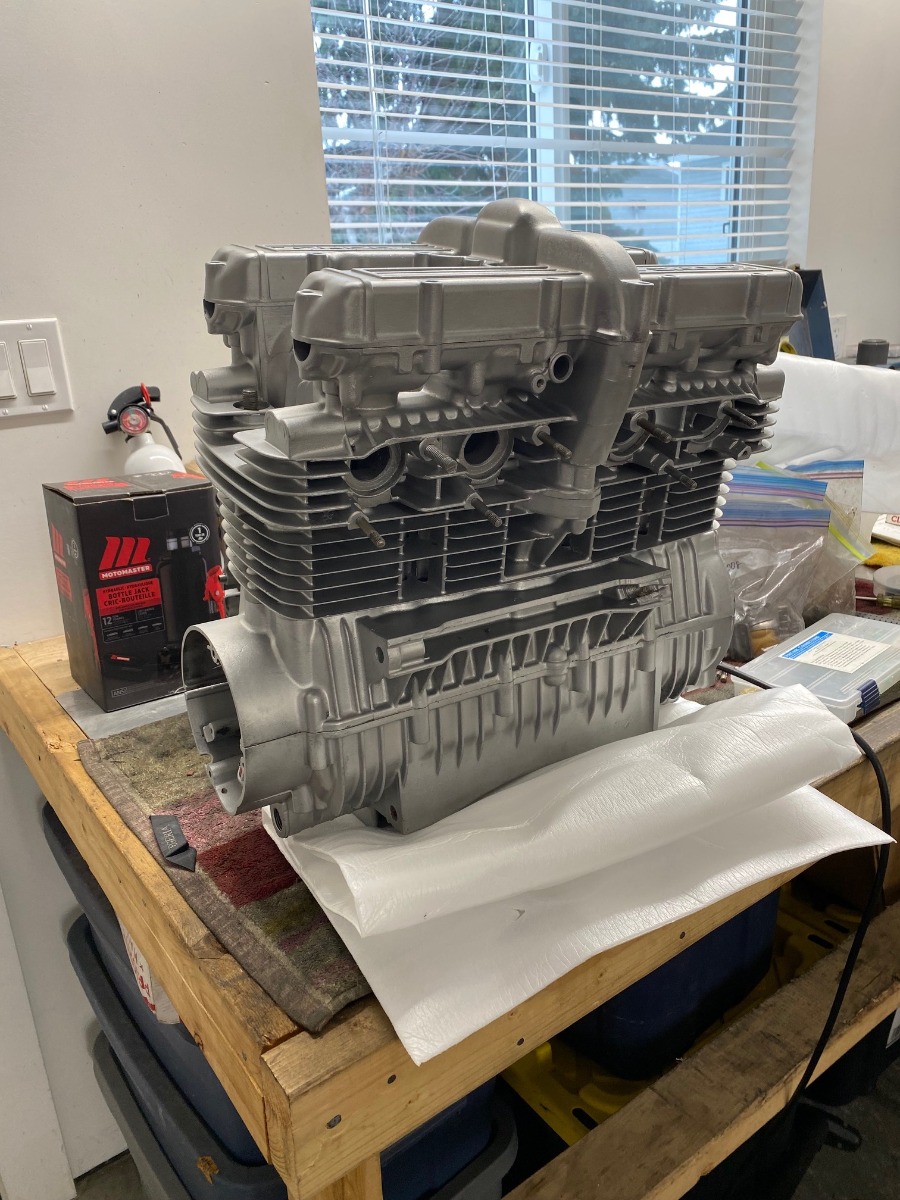

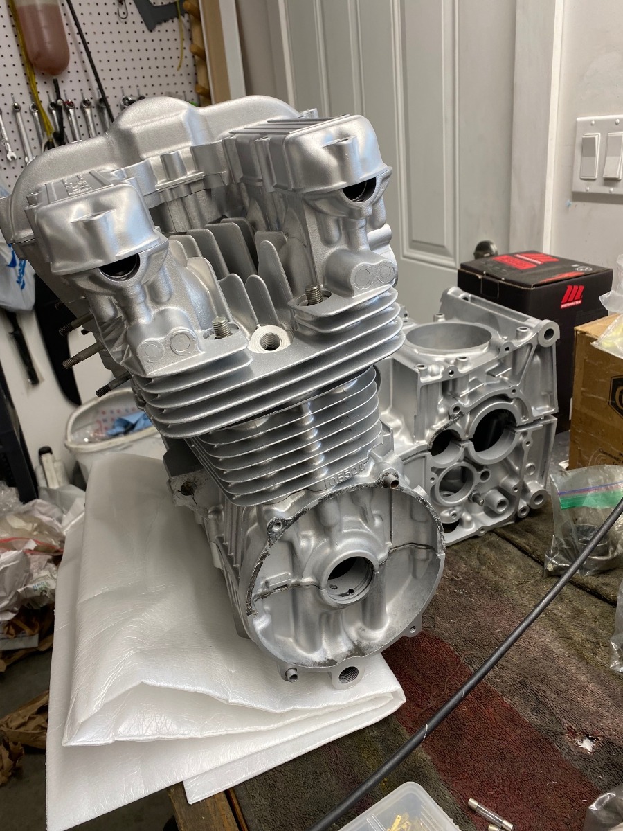

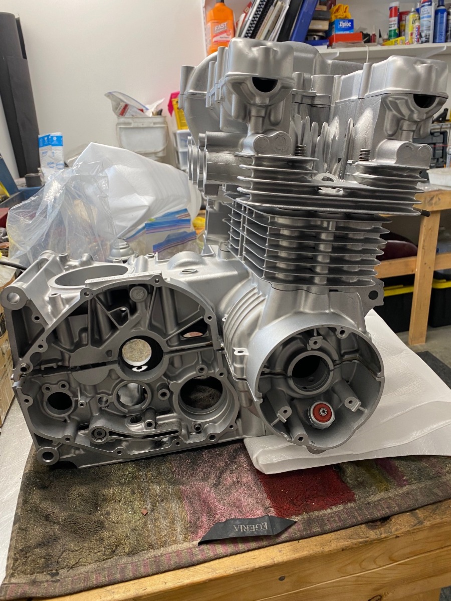

The Coquihalla highway is finally open again after last November's rain storms, so I drove down to Chilliwack to my favourite Vapour Blaster for a little engine cleaning. It always amazes me how a thorough cleaning can make an engine look new again! This engine won't go into the rebuild project, as I already had one ready to go.
