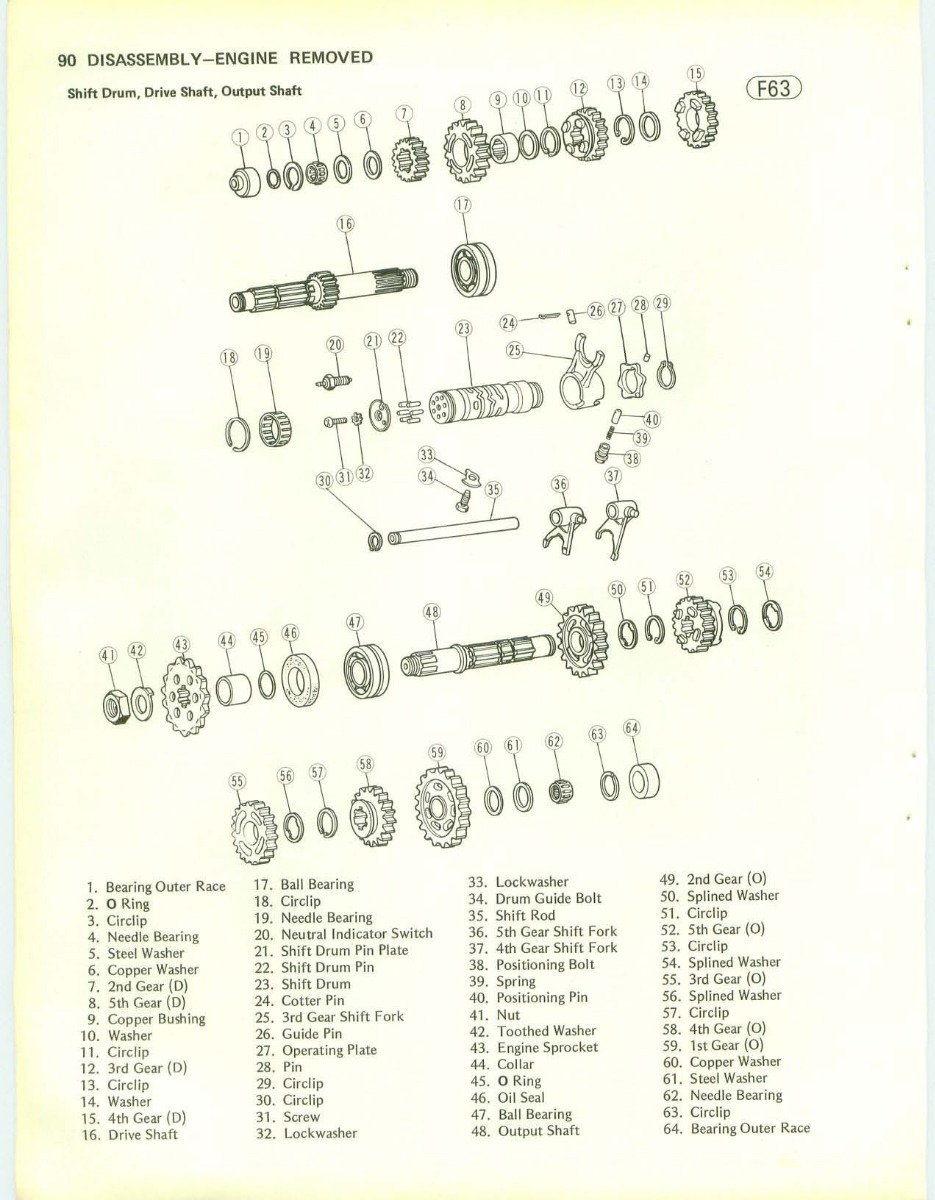

Your shift fork set up is correct. Mama Kawa made a mistake and switch the numbers in the manual pic F69.
Take a look at the pic F63 (#52->5th and #58->4th gear) and pic F78 of the 4th/5th gear position on the output shaft.

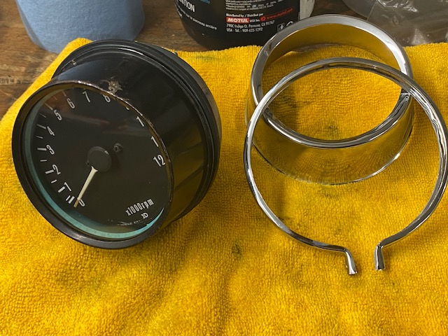

I usually find a mystery or two while pulling an old bike apart. This is the first one for this bike. The gauges have chrome covers over the top half. When I pulled the cover off the tach I discovered that someone had been into the guts, but when they pulled the ring off the center of the gauge they must have destroyed the ring, because there was none visible when I checked it out. So their fix was to install a chrome cover with the chrome ring that holds it in place. Great idea, but not so good for preventing moisture from getting into the gauge innards. I have a spare Z1 tach that I'm thinking of using instead of this little beauty.

Z1 tachometer will be black around the perimeter. The 650 is blue. Won’t match.

27 Oct 2021 16:06Z1 tachometer will be black around the perimeter. The 650 is blue. Won’t match.
That's correct! Originally I was going to put an entire Z1 front end on this beast. That plan changed when I realized the brake pods from a 650 had a different mount spacing. So I decided to go with the Z1 triple tree but I effed up one of the upper pinch bolts....broke it off in the hole. So I had to order another top triple mount. Progress is halted until it arrives in a couple of weeks. Meanwhile I can pull components apart and clean them up.
I guess I'll try the tach as it is. If it doesn't work I'll buy another one.

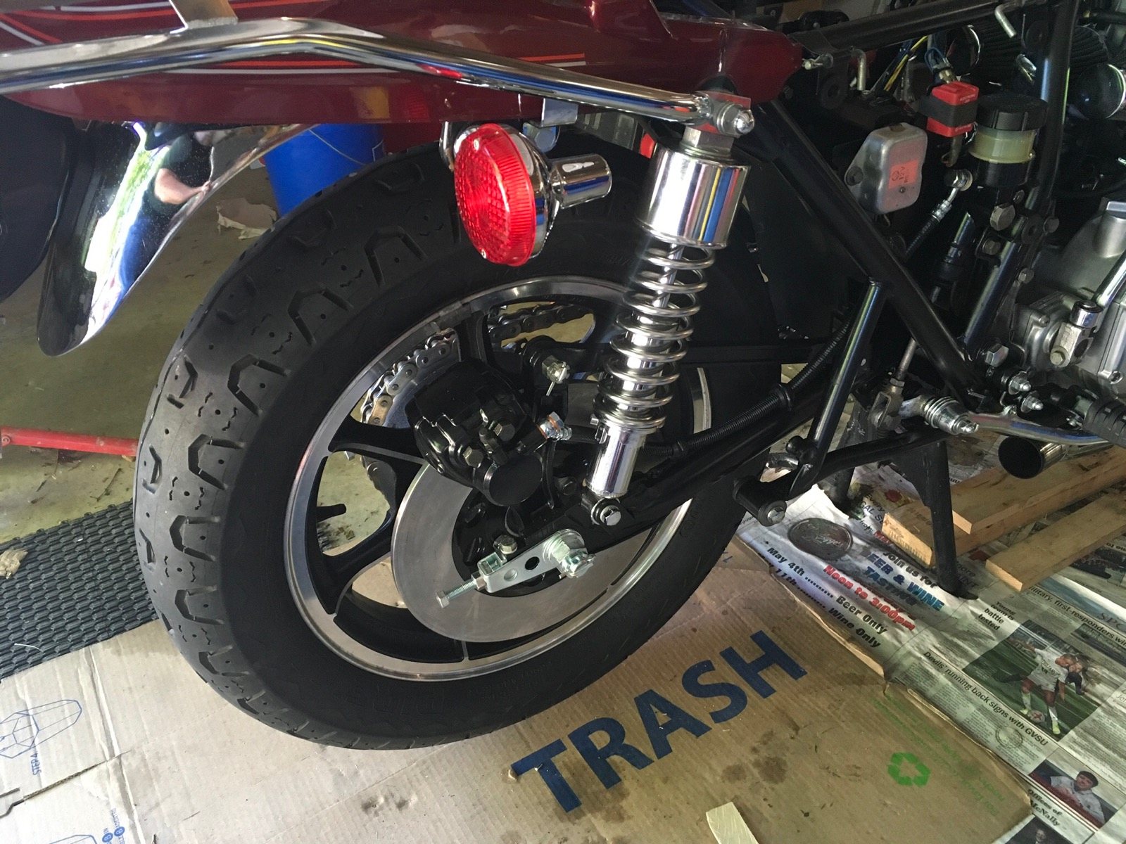

06 Dec 2021 17:51
I've been stuck for a long time trying to get the swingarm bolt out. I finally had to get a shop to cut it out, so things are beginning to move a bit. Frame painted on the weekend. Engine in the frame today.
