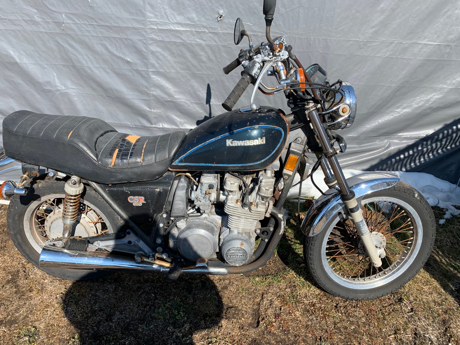

Canada actually, but on a much bigger island for sure! Yep...still going through the inner workings and aside from that broken clutch plate everything seems to be within spec. I'm pretty much ready to start re-assembling when the new cases arrive. I need to take the head apart and vapour blast it along with the barrels and some other bits, but that's about all I have to do to put the engine back together. I have a good welder for the frame, but I still don't know for sure if it's twisted. No signs of stress, no cracks and no paint crinkles so I think it's OK.
Back to the fork uppers....does anyone know if they are the same size as a Z1?

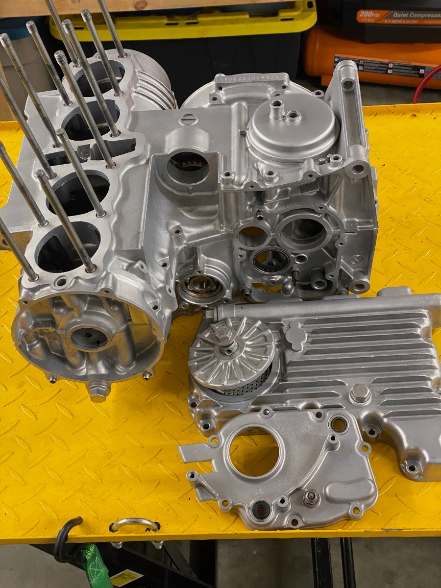

The new cases arrived today. That was one of the quickest deliveries I've ever had through ebay. Overall they look very good, but the vapour blaster left a couple of bearings in place and they are frozen from rust. No problem, I have the ones from my old cases.
