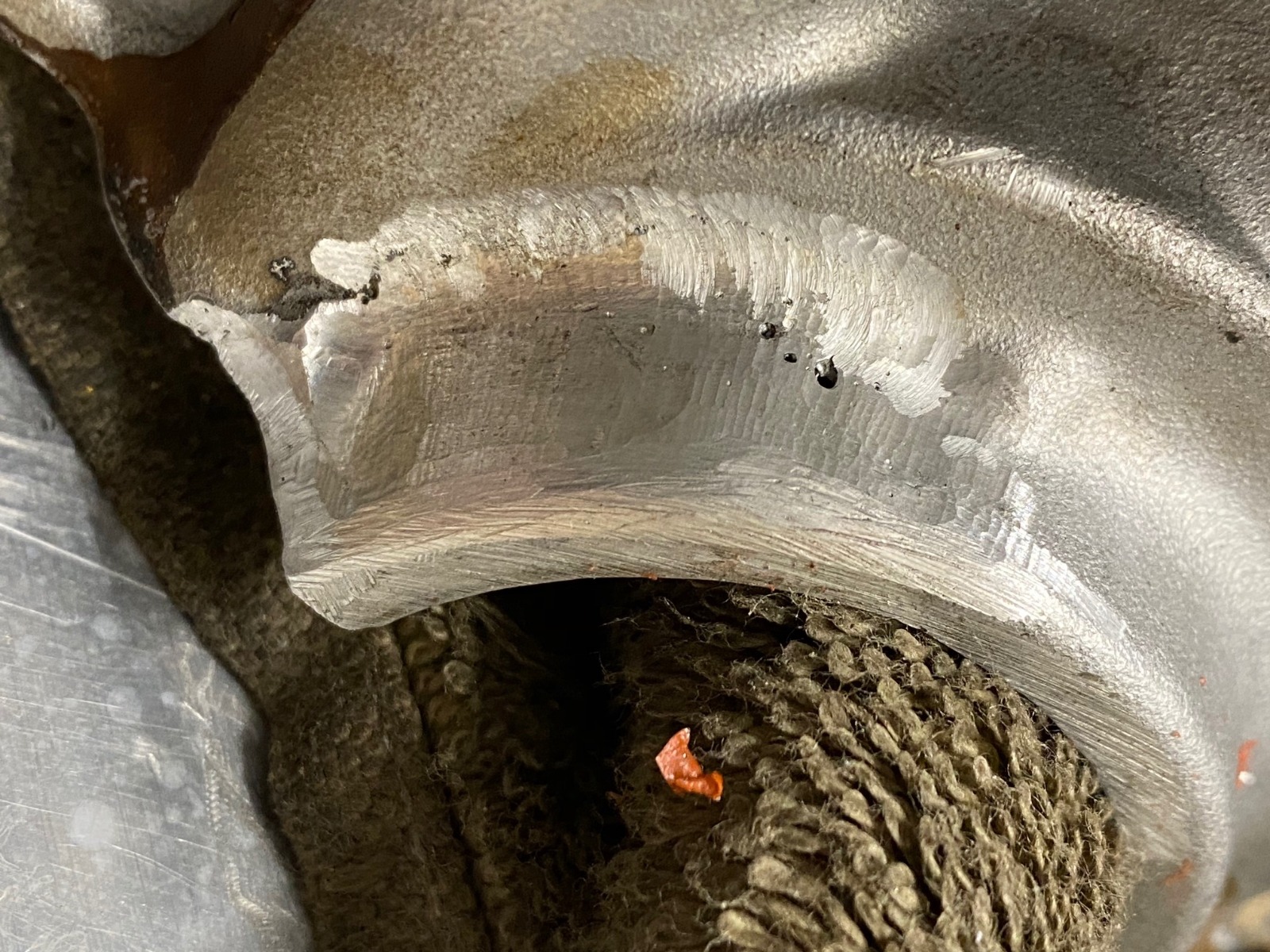

This photo shows the seal location at the end of the crankcase. Looks like the end was welded up and then new grooves were cut into the weld. You can see voids in the weld on the inner groove. You can also clearly see the joint on the case face.

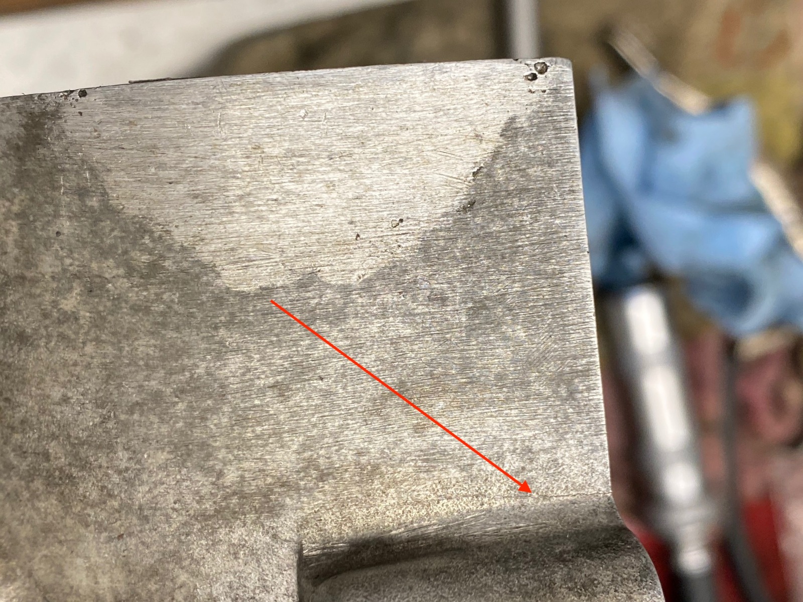

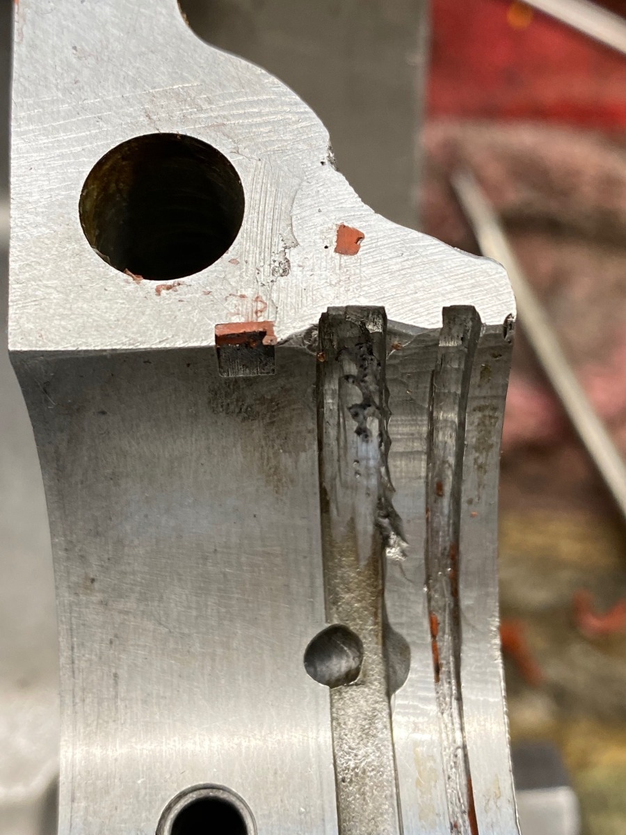

This photo shows the flip side of the previous one. You can clearly see where a piece had broken out and was replaced by weld.

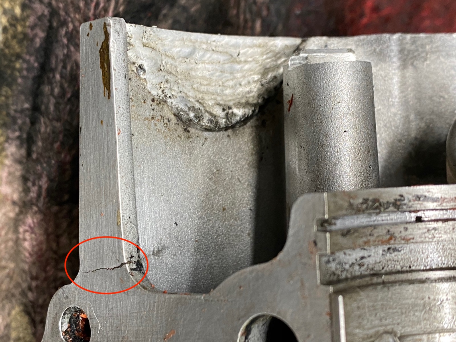

This photo shows the opposite side, where the case was welded and a crack remains on the flange.
This photo shows the crack from the previous photo on the case itself. There is a very fine line showing where the case is cracked.

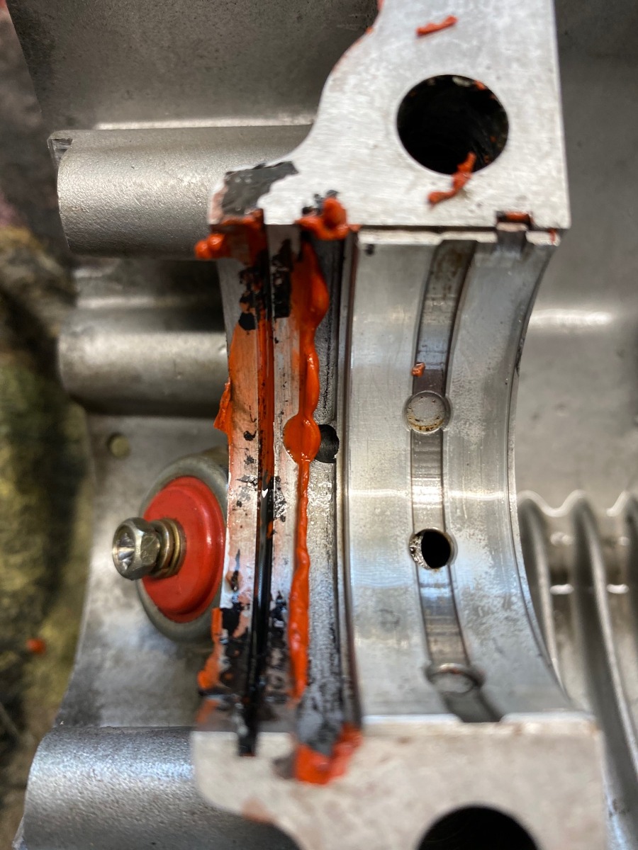

This photo shows the opposite side of the case to the first photo. Notice how the PO used permatex to help "seal" the end seal, but he used too much and the lube hole is partly obstructed.

I applaud your cleaning efforts, but I am afraid it is a futile effort. Those cases are only the value of aluminum salvage rates at this point. A very clear example to all reading this of what is NOT ACCEPTABLE in repair methods.

12 Jan 2021 20:30Skidmark wrote: I applaud your cleaning efforts, but I am afraid it is a futile effort. Those cases are only the value of aluminum salvage rates at this point. A very clear example to all reading this of what is NOT ACCEPTABLE in repair methods.
Precisely what I was pointing out.

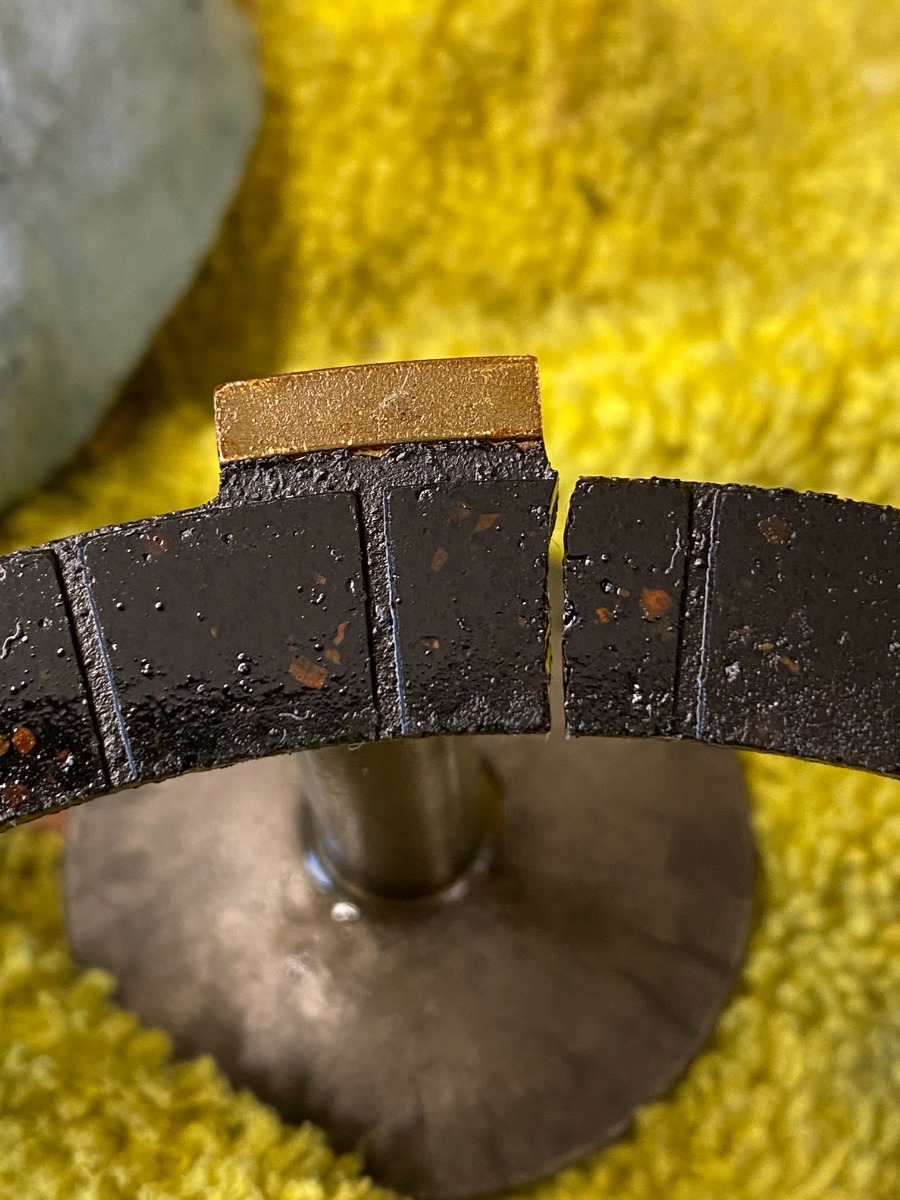

Meanwhile I've been examining all the engine components. When I bought the project the PO said he had replaced three clutch friction plates that were cracked. Today I took the clutch apart and....found a broken clutch plate. Talk about dirty! It took me an hour and a full can of carb cleaner to get the dirt and grime off the clutch housing. He also said he replaced the con rod journals, and I was debating leaving them alone, but now I guess I'll have to take them apart and check them.
