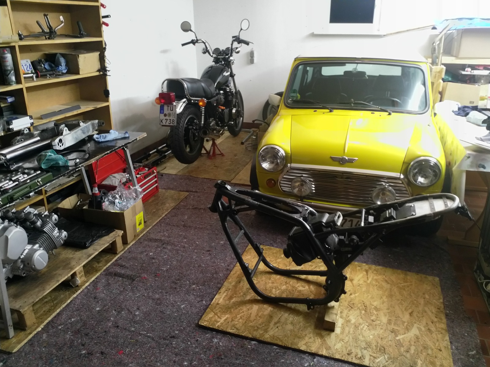

Thanks guys. I've decided to go for 1075 but still haven't decided whether to spend the money I'll save on new brakes or just use the stock ZRX brakes. Got the garage cleaned out today but it looks like the boys Zephyr will be taking up most of the space for winter. I'll just have a bit of room in the corner to figure out the riding postition and sort out what I want to chop of the frame.

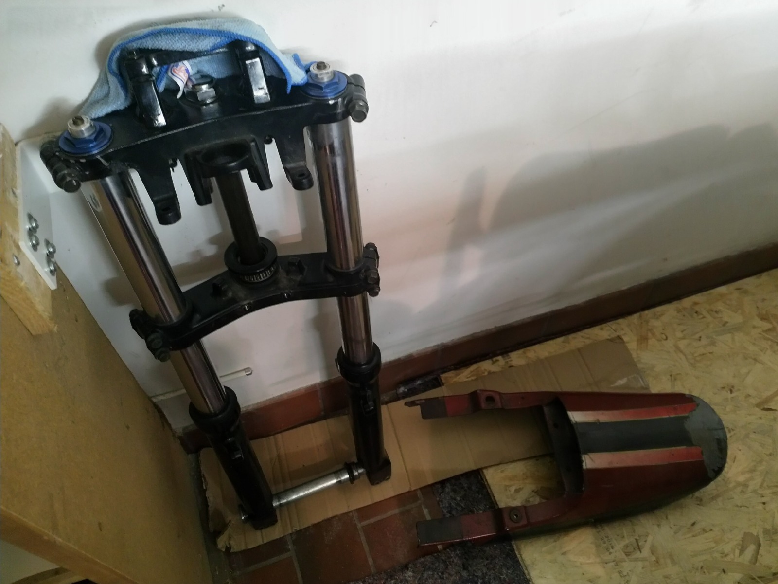

Starting to get some parts together. Got the ZRX forks and a second tail section to butcher (thanks kzstreetfighter71).
Sold the Hornet as well, so have paid for the bike and ordered a new triple clamp and swingarm.
The garage has been cleaned out and the mini and the 750 are in bed for the winter. Time to get some work done on the boys zephyr before I pick up the KZ1000.

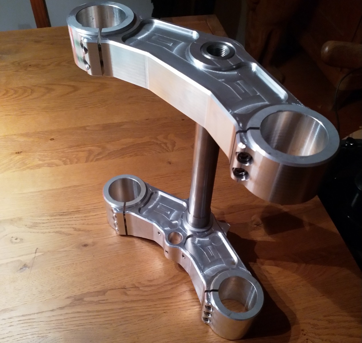

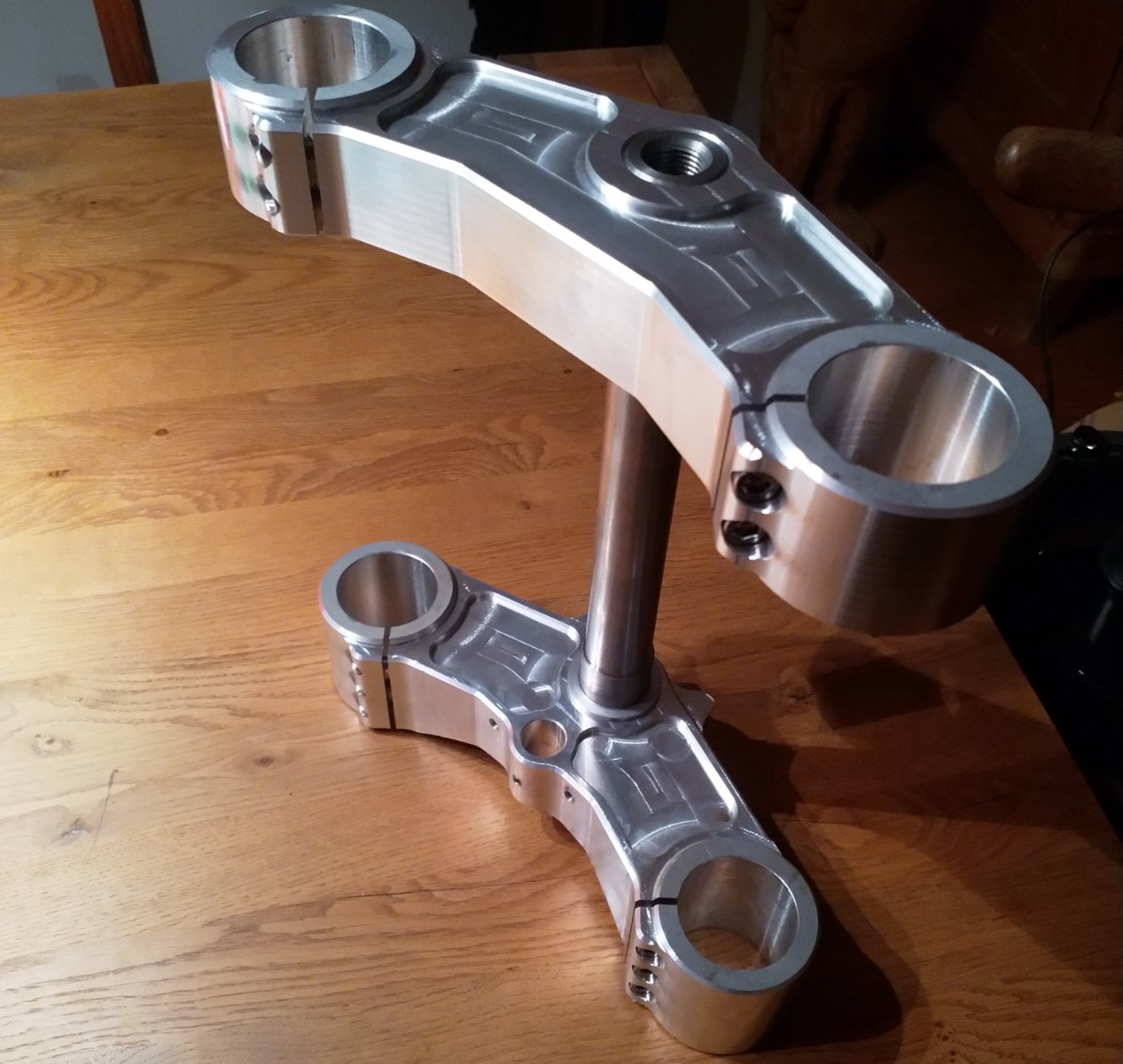

Triple clamp arrived today. Picking the bike up next weekend. Should have the clip-ons, speedo, tacho, headlight and the electrics for under the tail section by then. Looking forward to getting it together so I can figure out the riding position and get the tail section sorted.

Nice triples...

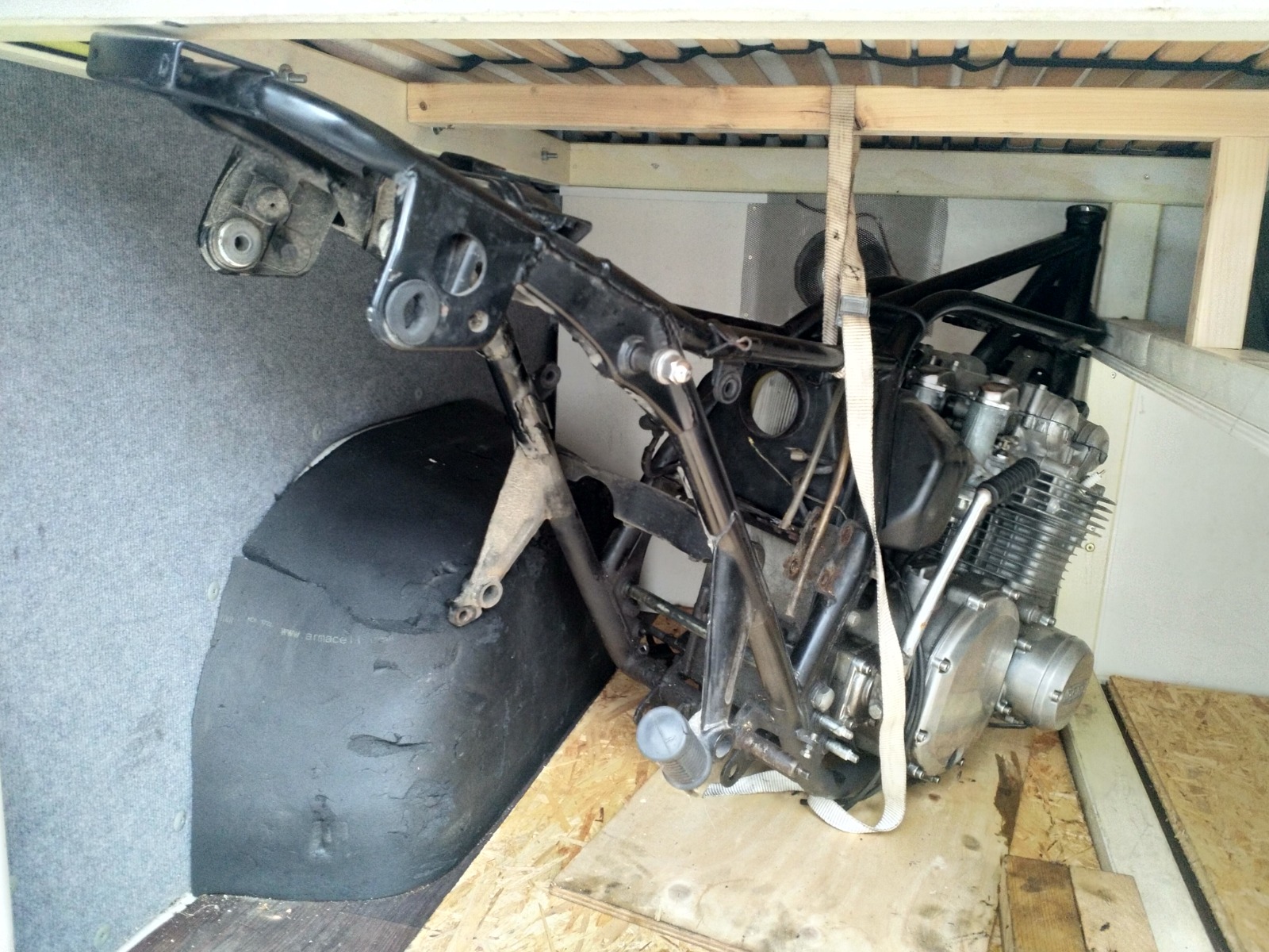

No eBay APP ID and/or Cert ID defined in Kunena configurationPicked up the bike. No trailer so dragged my son along to help get it down to size so it would fit under the bed in the van. Collecting a few more parts and will start putting things together next week. Until then I'll be helping the boy get his Zephyr together - painted the engine yesterday so can start rebuilding it next week as well.

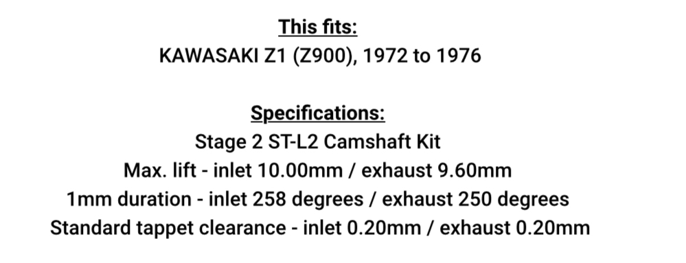

Looking for cams and found these:
Was planning on getting the 110's from Webcam ( webcamshafts.com/pages_vehicles/motorcycle/kawasaki/1730.html ) but the Yoshi's are a lot cheaper. Not as much lift or duration but as I have no idea what difference it will make I thought I'd ask you guys :) Current plan is 1075cc with ported head and 38mm intake valves.
Here's the bike in the van:

17 Dec 2020 14:18calum wrote: Was planning on getting the 110's from Webcam ( webcamshafts.com/pages_vehicles/motorcycle/kawasaki/1730.html ) but the Yoshi's are a lot cheaper.
Maybe import taxes and currency conversion makes the difference, but Ebay converts those Yosh cams to $668.10. Schnitz lists the Web 110 for $629.

For me it's €570 for the Yoshi's and €775 for the Web's.
From what I can gather the Web's will be better at high revs but the Yoshi's should be smoother down low at the cost of top-end power. That sound about right? Forgot to say before that I'll be running RS34's.

17 Dec 2020 18:11calum wrote: For me it's €570 for the Yoshi's and €775 for the Web's.
Correct. More duration move peak hp up in the rpm and could make the idle slightly rougher. The Yoshimura cam duration is measured at .040 and the web is measured at .050. Not sure how much that would change things. The Yoshimura cams are their stage 1. They also make a stage 2 that would be the same as the Web110.

Asking which is the best cam profile is a bit like asking which is the best engine oil. There will be a bunch of "right" answers. One of the variables you did not mention is porting. That will have quite a bit to do with the flow numbers and power potential and power band. You should have a cam conversation with whoever is doing the head work.
Based on what you have said so far, my guess is that those Yoshimura cams will leave a lot of power potential unrealized.
There are some really good threads about this, in which the late LarryC discussed porting and flow and such. I do not know if they are still available, or if they got archived.
(Perhaps we should have a "Which cams" FAQ.)
