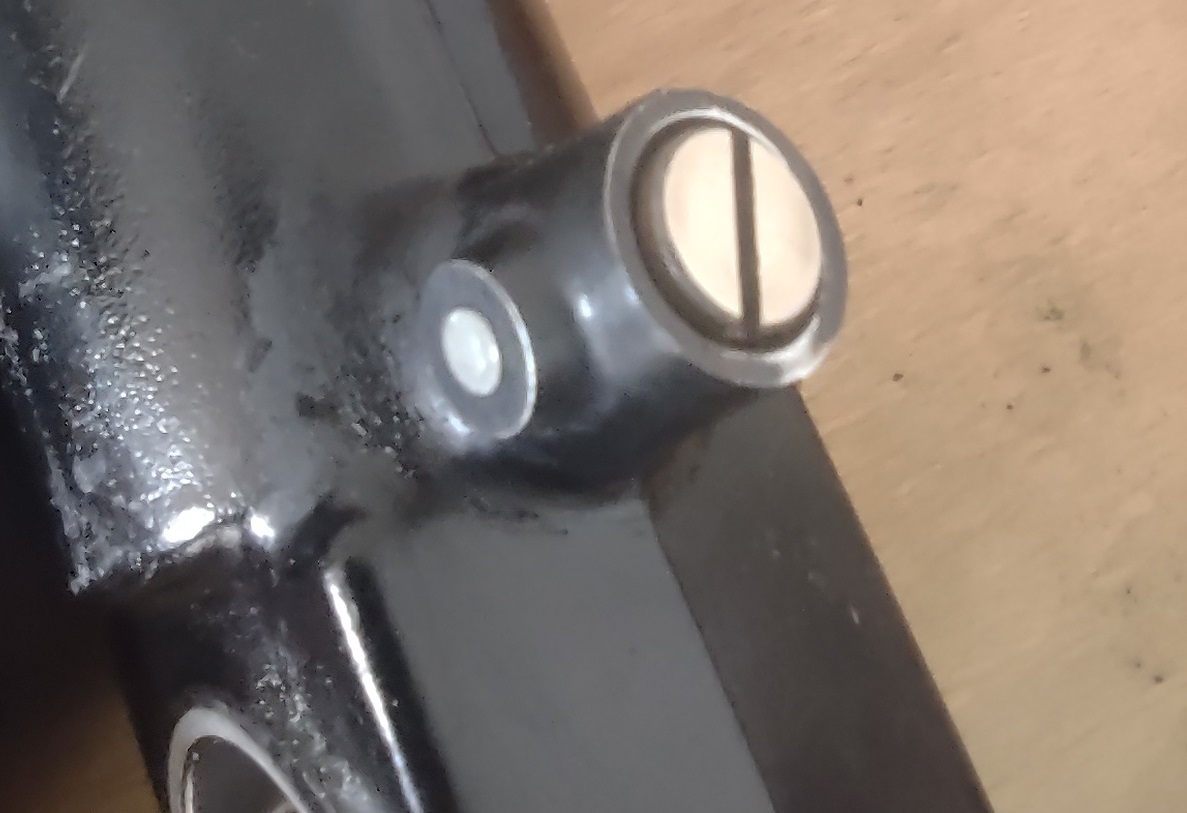

Finally got around to pulling the forks apart today. Will bead blast the lowers next week but before I do I was wondering if it's possible to remove the compression daping screw. I don't think it will come out without drilling out the plug on the side but I figured I'd ask just in case anyone knows better...
Also, I'd be interested to know what the screw actually does - how does it actually restrict oil flow?

The screw changes the size of the by-pass passage (like a mixture screw on a carb) to adjust the oil flow rate
