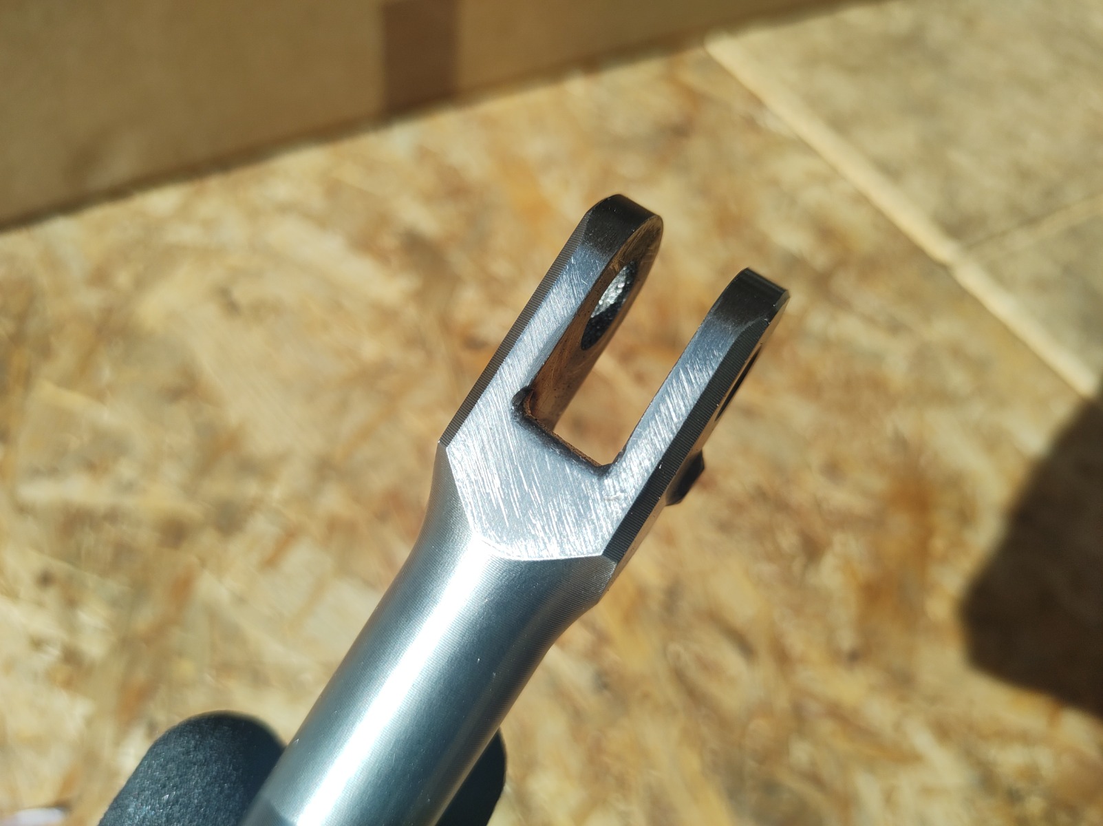

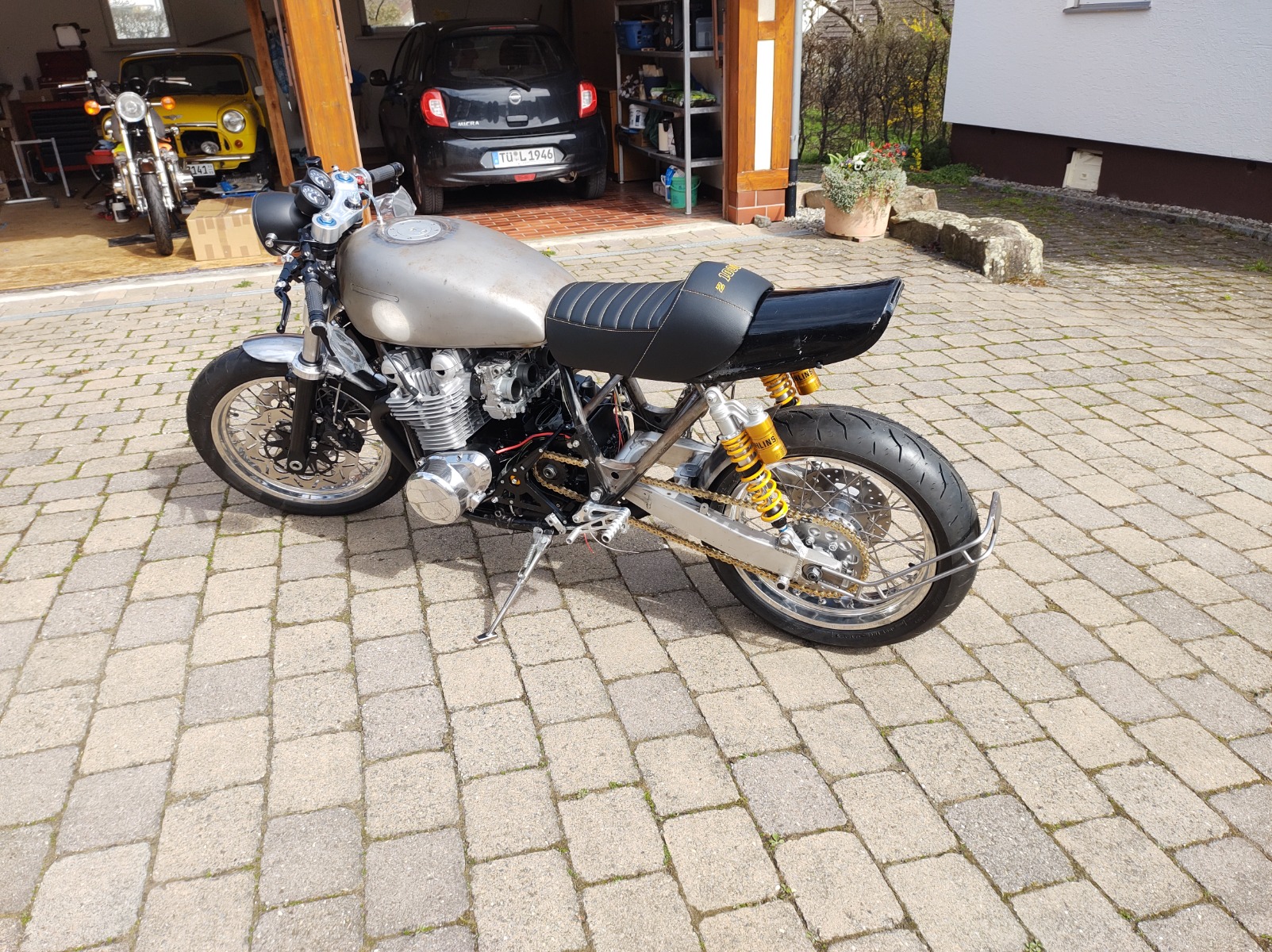

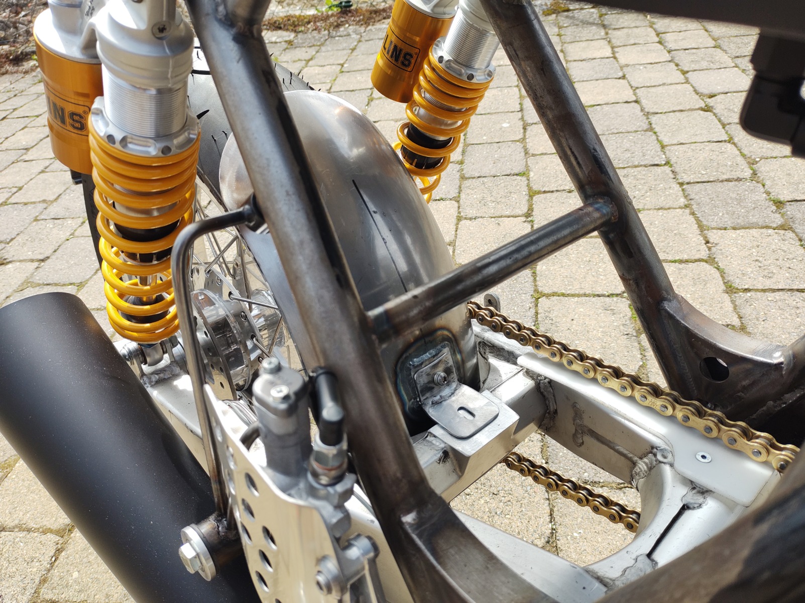

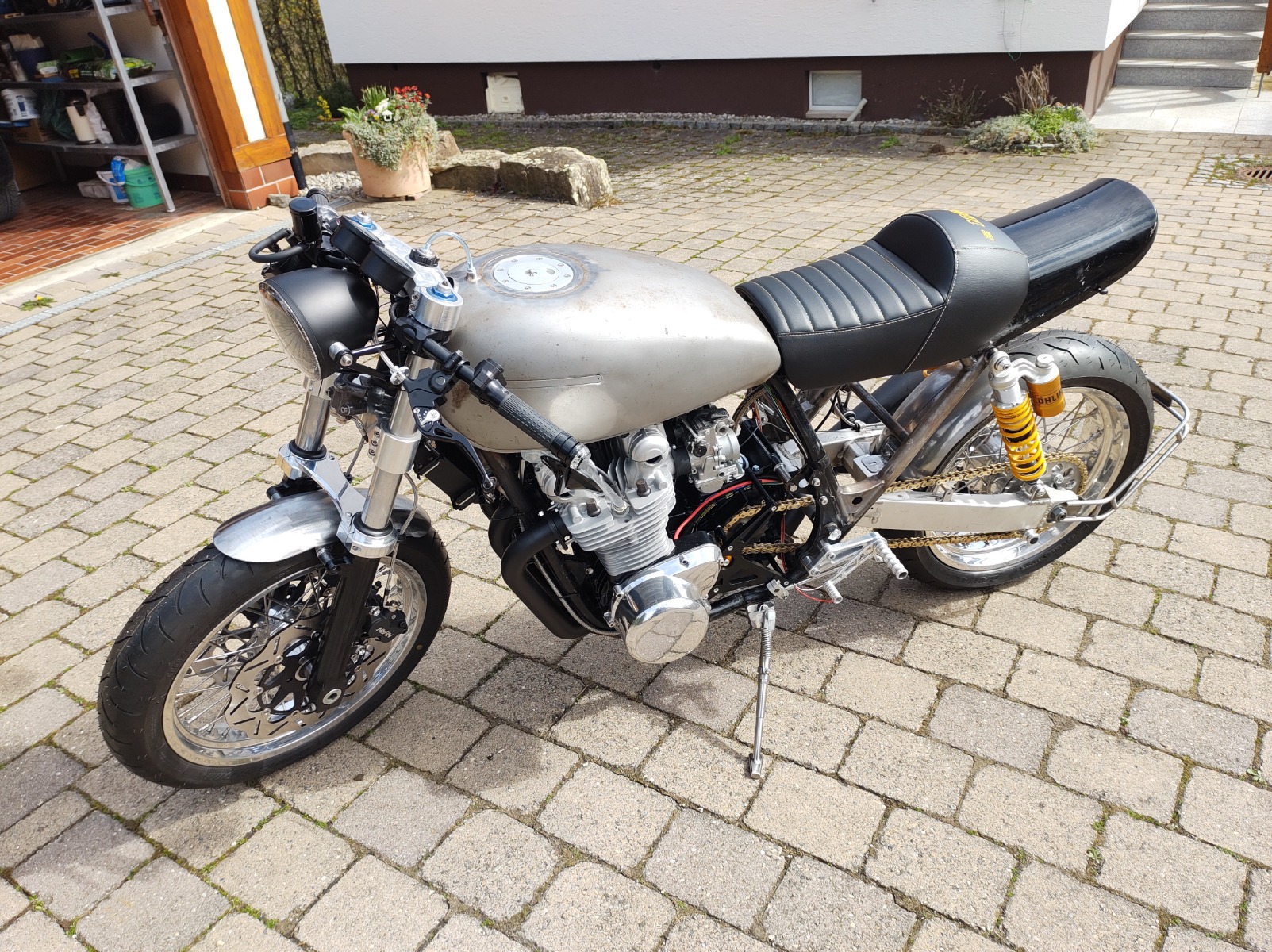

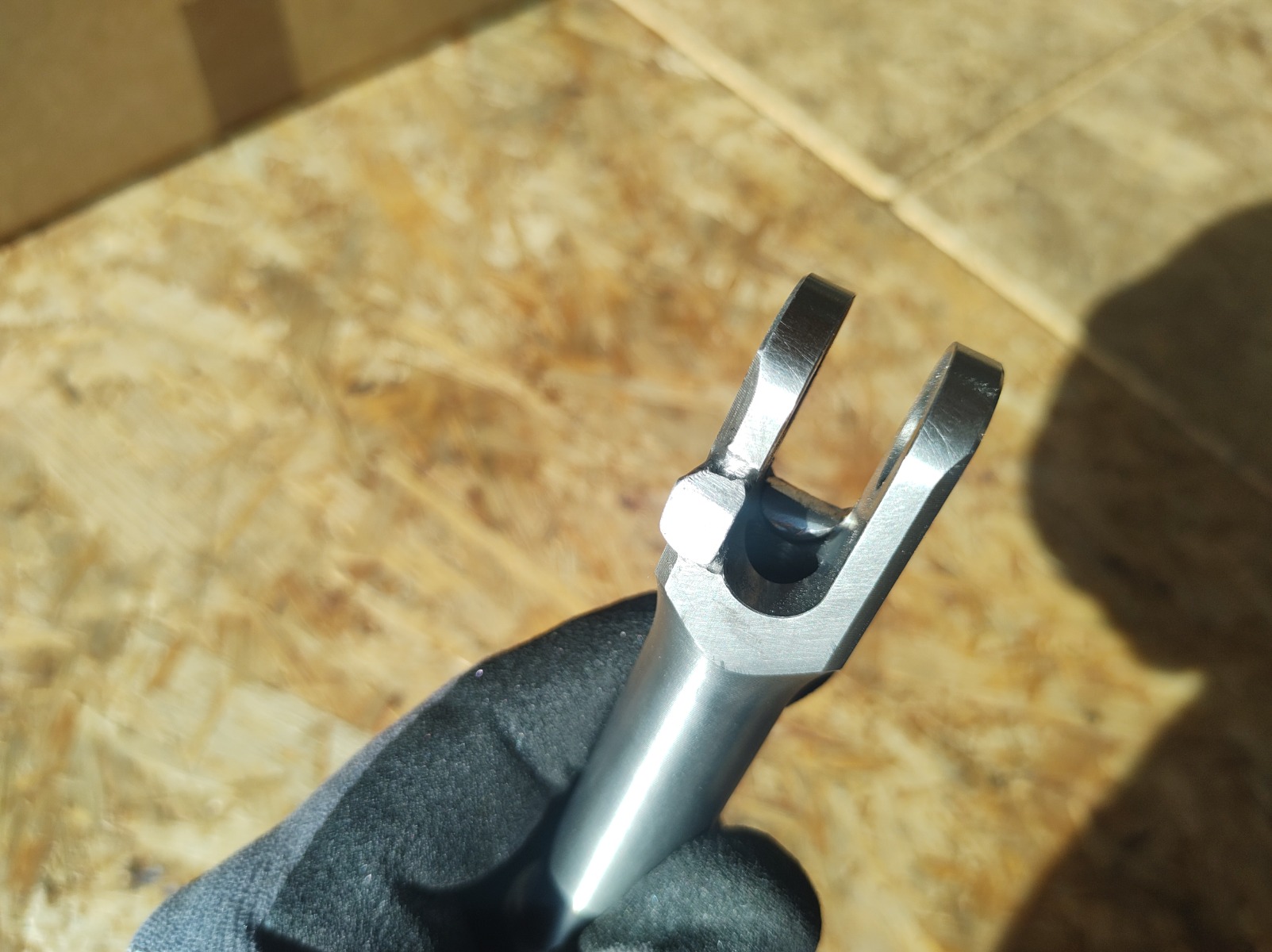

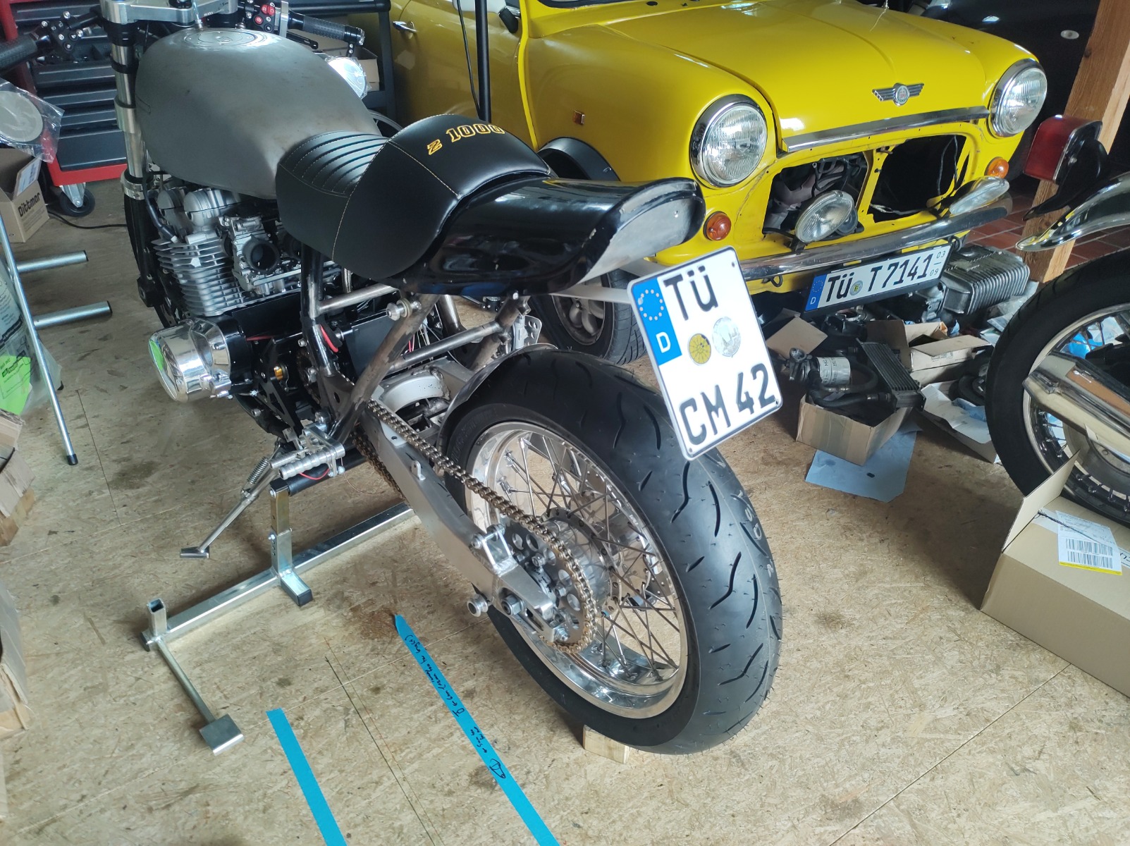

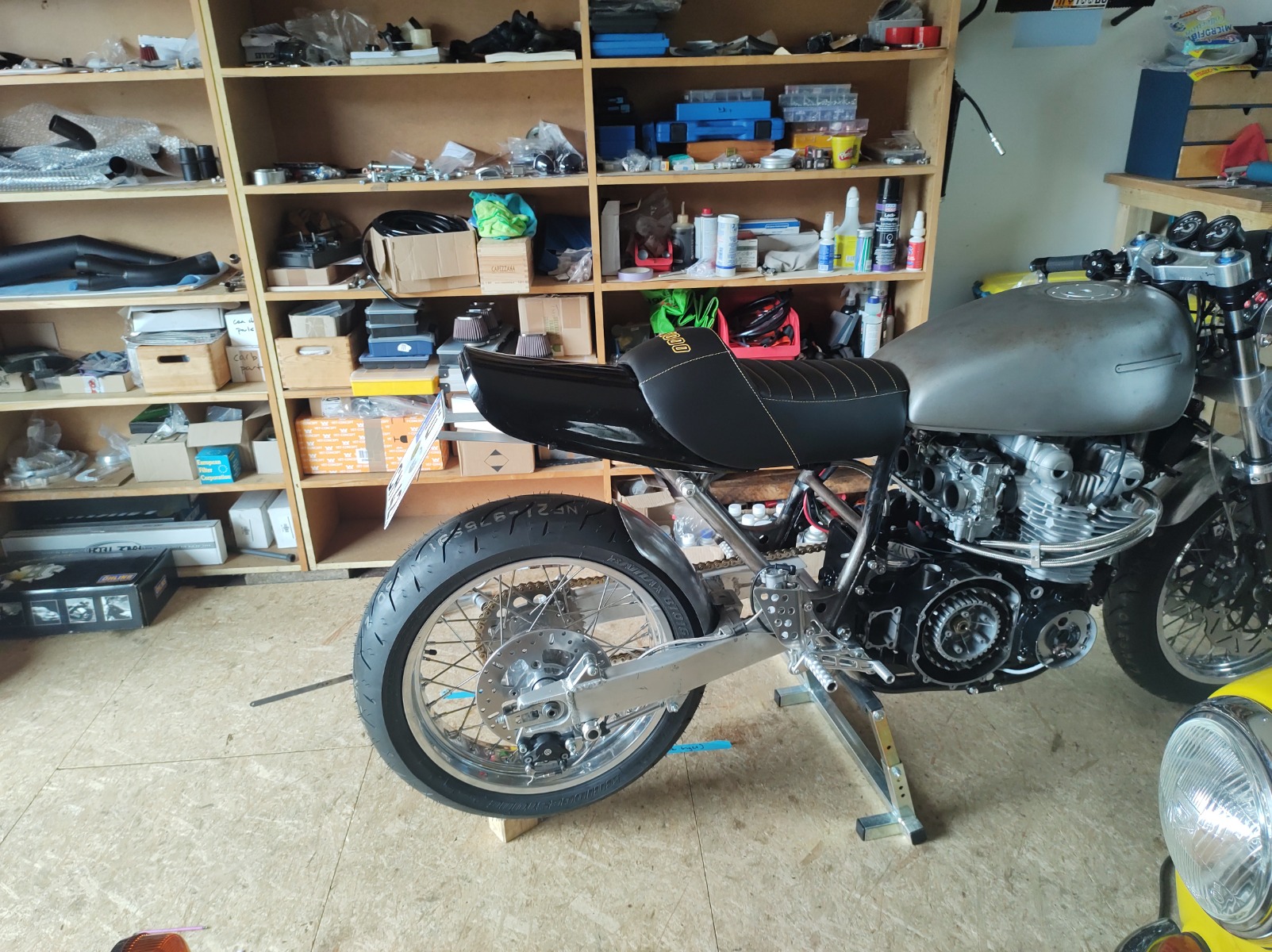

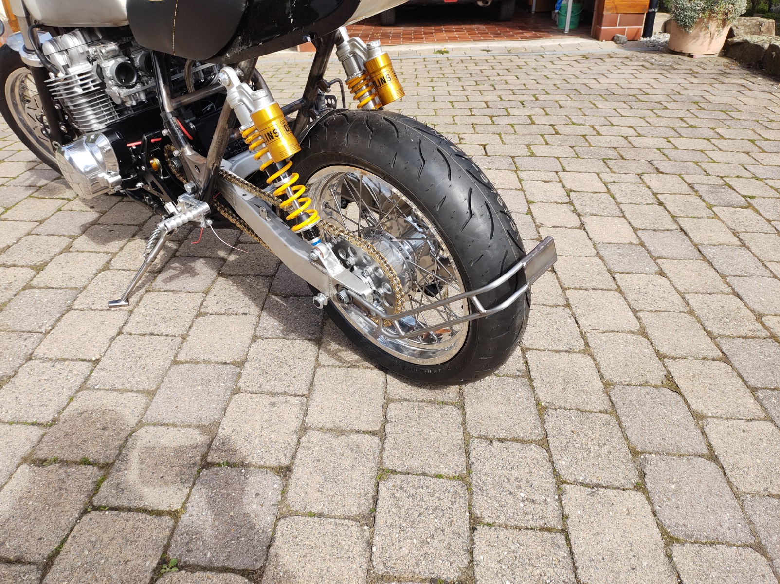

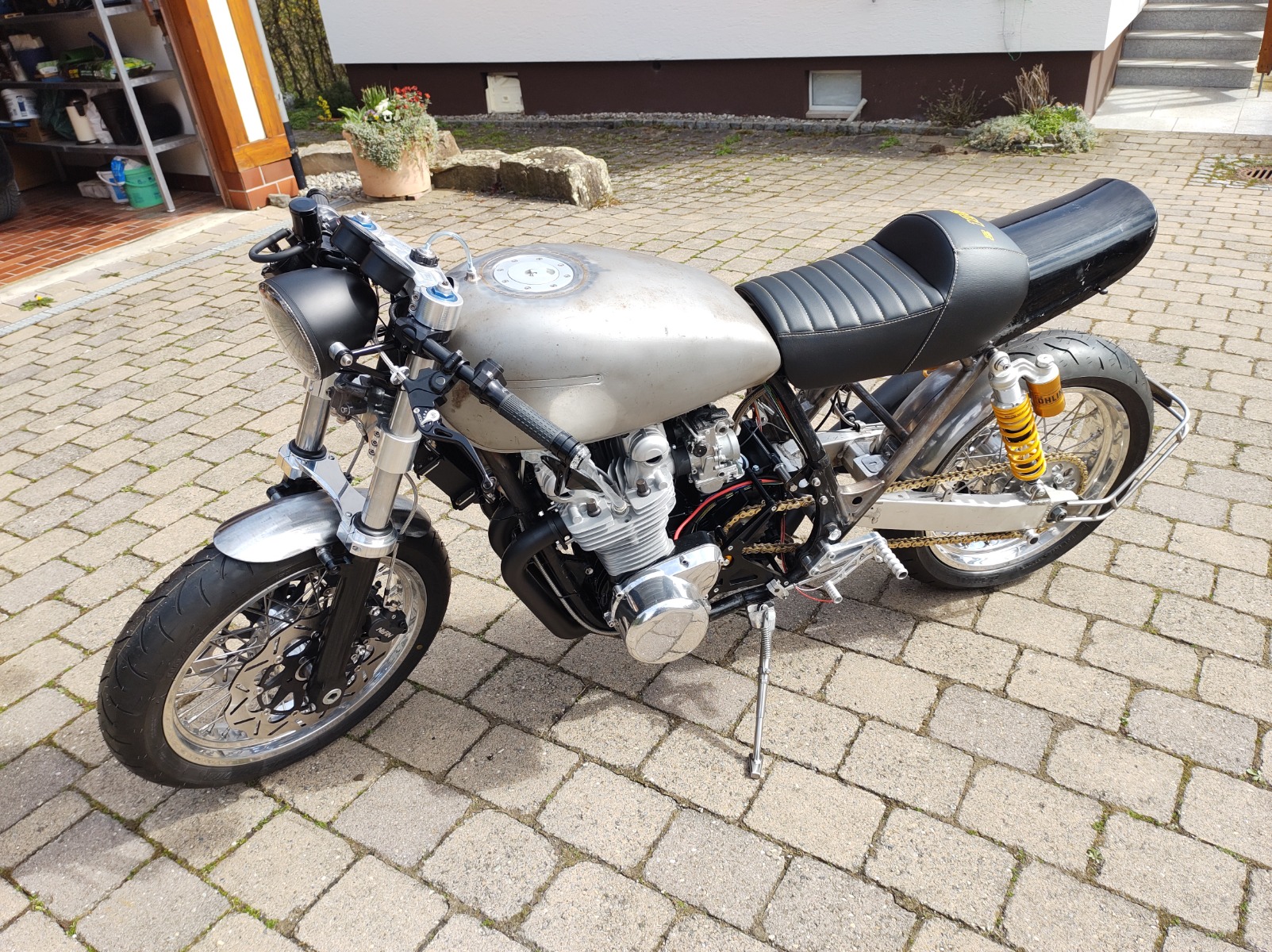

It's been a pretty big week... Started off by welding a bit onto the side stand so that it doesn't slam into the shifter. I'll add a stop to the frame when I've torn the bike down.

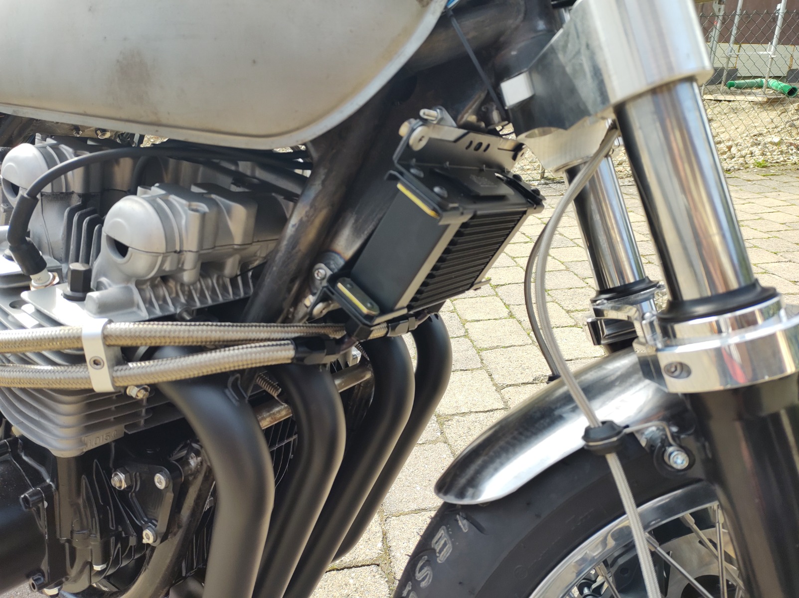

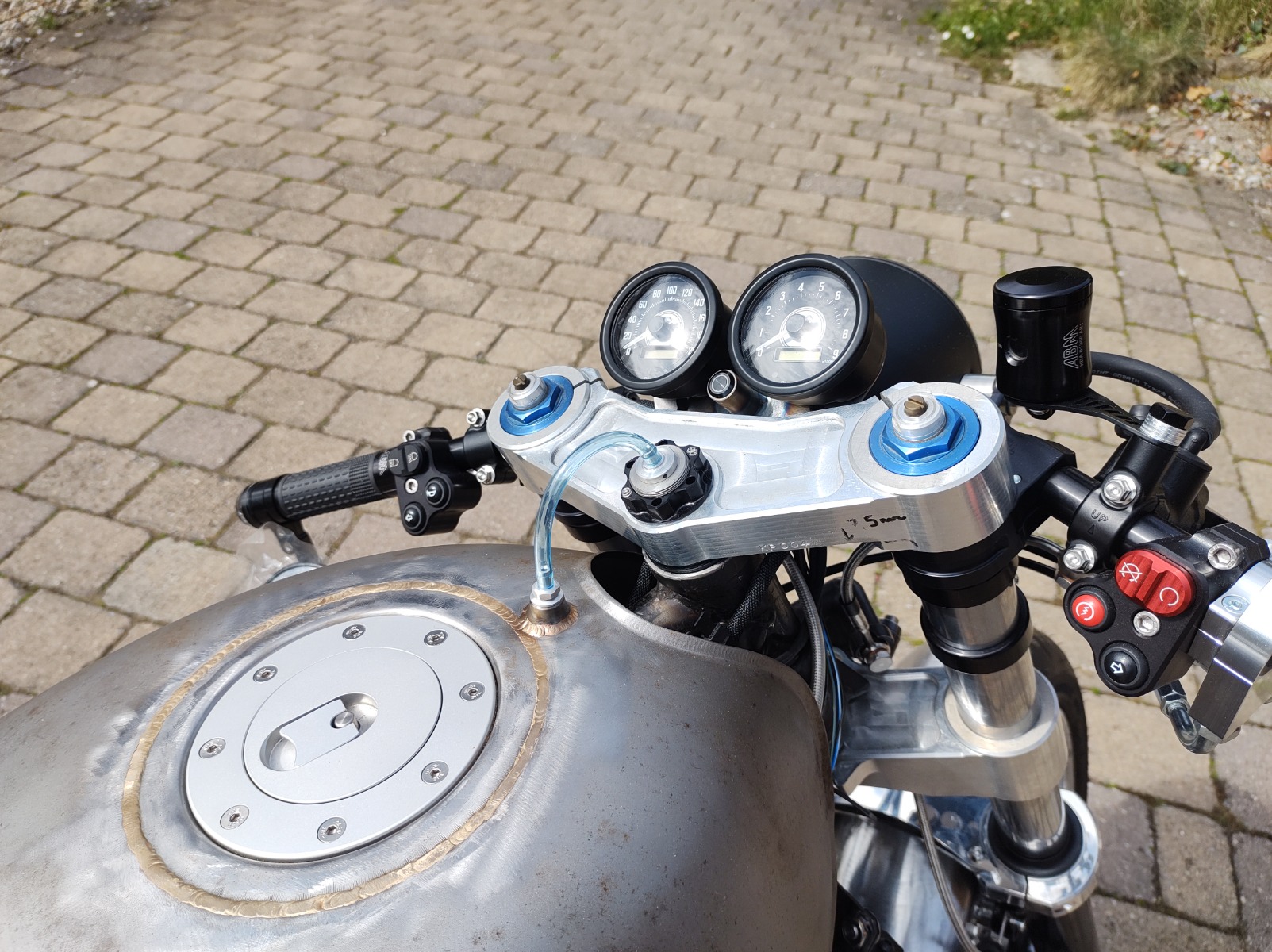

After that I got the brake lines on, the chain and sprockets properly aligned (third time lucky!), then I made a rear fender and a license plate bracket (will get a plate laser cut and weld it on for mounting the actual license plate). Got some holes in the side of the tank vent fitting and made some brackets for the brake lines. Finally welded the nuts onto the oil cooler brackets.

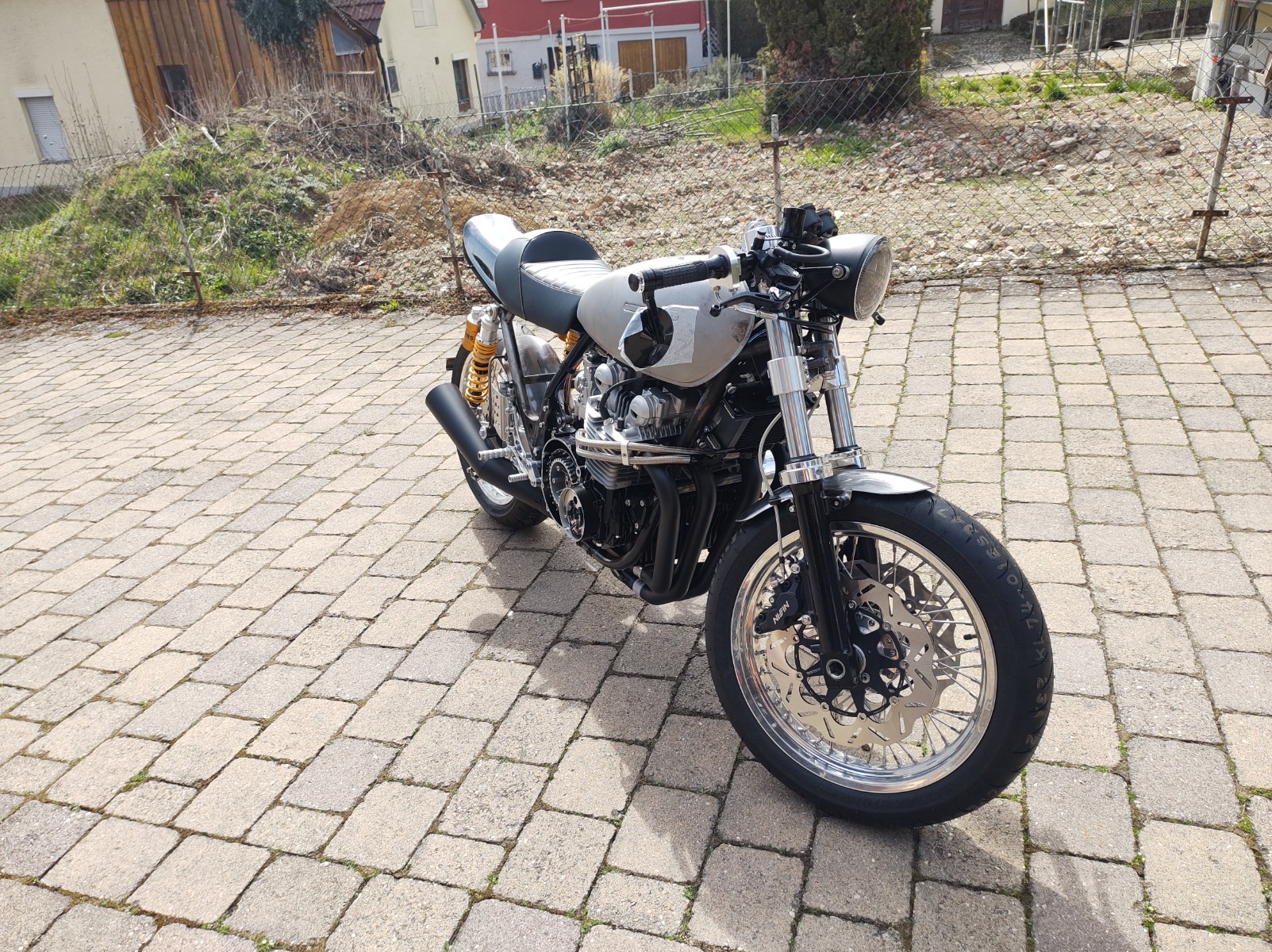

After all that it was time to roll the bike out of the garage for a few photos. I'll be tearing everything down over the next couple of weeks. I need to get some minor changes made to the swingarm, straighten the tail out and get a guy to make me a catch can (don't fancy trying to weld an aluminium box that doesn't leak). After that it's time to start bead blasting and painting before reassembly.
EDIT: I should note that the forks are pretty soft (new springs are still on the shelf). The static sag is about 40-50mm so the front end will sit a bit higher when it's done.

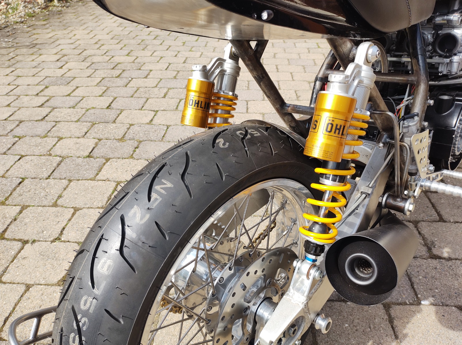

You did a perfect job to the specific parts and details! Sorry to say, BUT THE LICENCE PLATE HOLDER is beyond my personal taste, it´s an absolute NO GO!
The new "small" bike licence plates fits perfect under the duck tail, but it´s your desicion.......

Thanks. I tend to agree with you on the license plate bracket. After looking at both options I decided to put it under the tail. Then I measured everything and figured out it would need to stick out about 5-10cm beyond the tail to clear the rear wheel when the schocks are compressed - the tail section has been shortened quite a bit and the swing arm is longer than stock. I can't bury it in the tail like you have as the bottom of the tail section is covered (and the tail is full of parts). The 30° angle for the MOT is the main problem - I could maybe sort something out if it was flatter.
The only other option is on the side like a bobber/chopper and that would look awful.

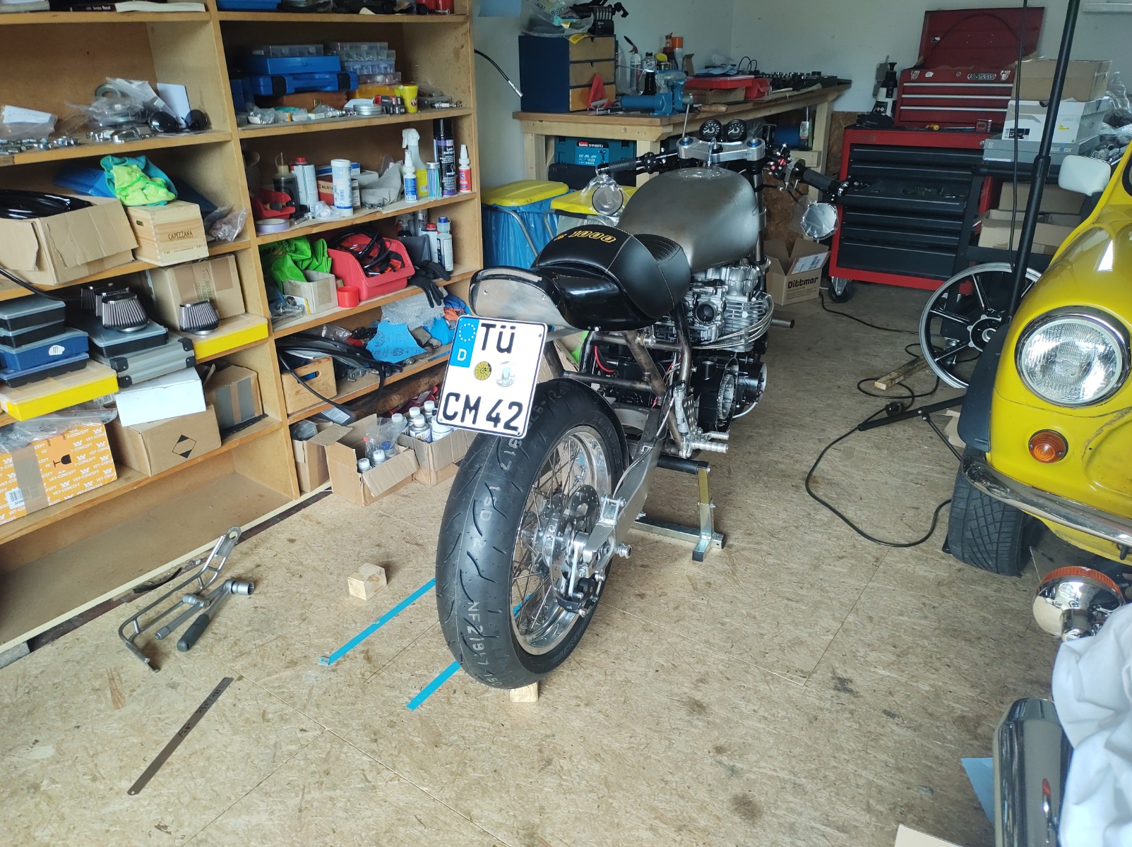

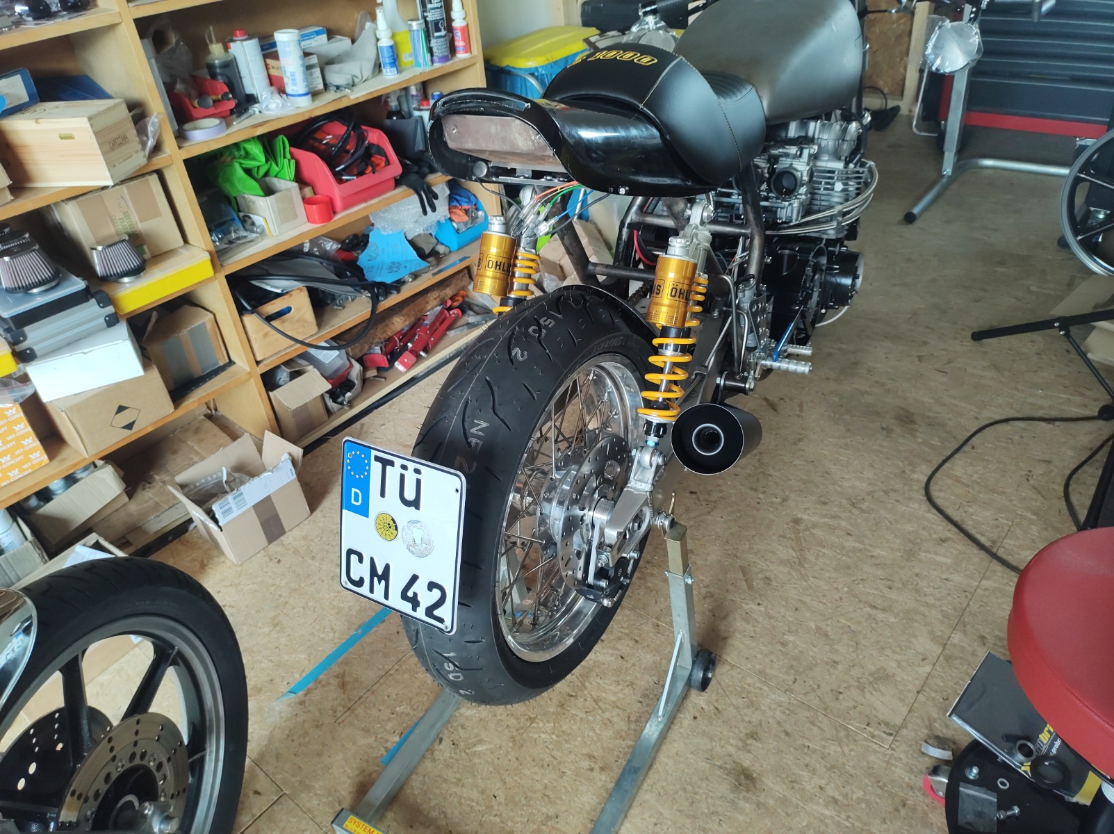

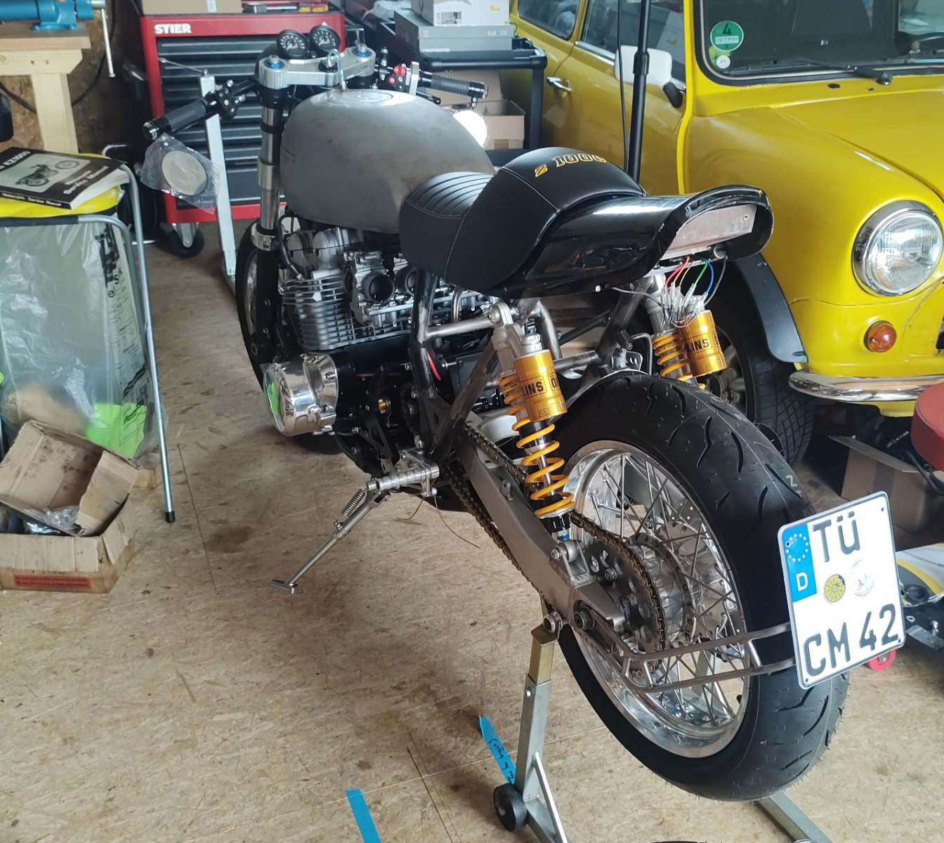

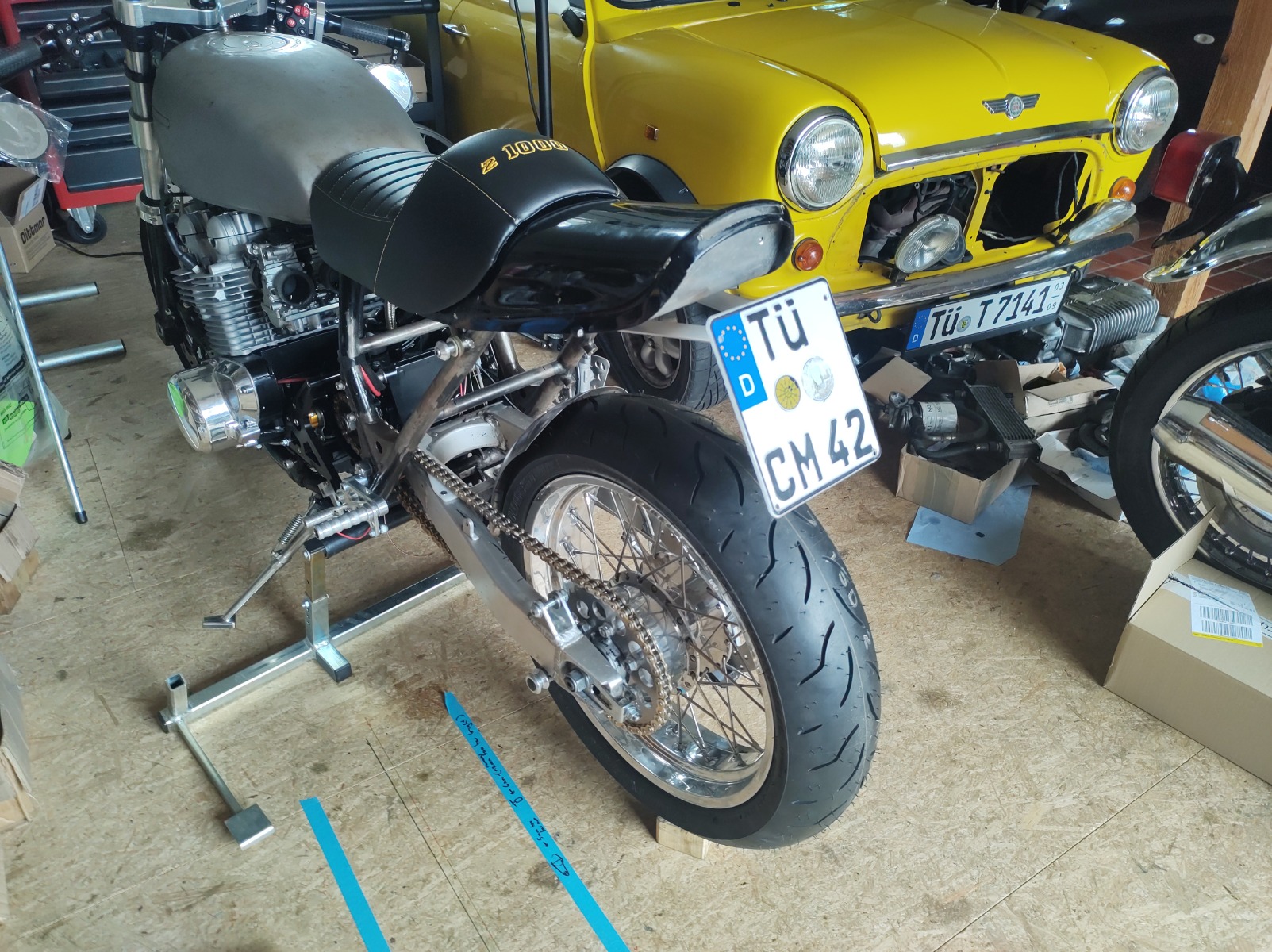

After double checking the countershaft sprocket alignment before getting a third(!) sprocket made, I stuck an old license plate on the bike. I'm pretty happy with the bracket now, a bit of black paint and it will disappear into the background. Also leaves the tail section nice and clean.
Excuse the mess in the garage
not much room til I get that yellow thing out of there.

How are you planning to illuminate it (I assume it's a requirement?)
- calum
- Posts: 1144
- Thanks: 415
Re: 1977 KZ1000 Restomod
07 Apr 2023 07:28 - 07 Apr 2023 07:33
I am getting a plate laser cut and will bolt the license plate to it. One of the bolts (probably bottom left) will be this thing:
www.louis.de/artikel/led-kennzeichenleuchte/10035537
I also need a reflector at the bottom. I'm getting the same plate cut as I used on the 750 - it will also be stainless and I'll weld it to the bracket.

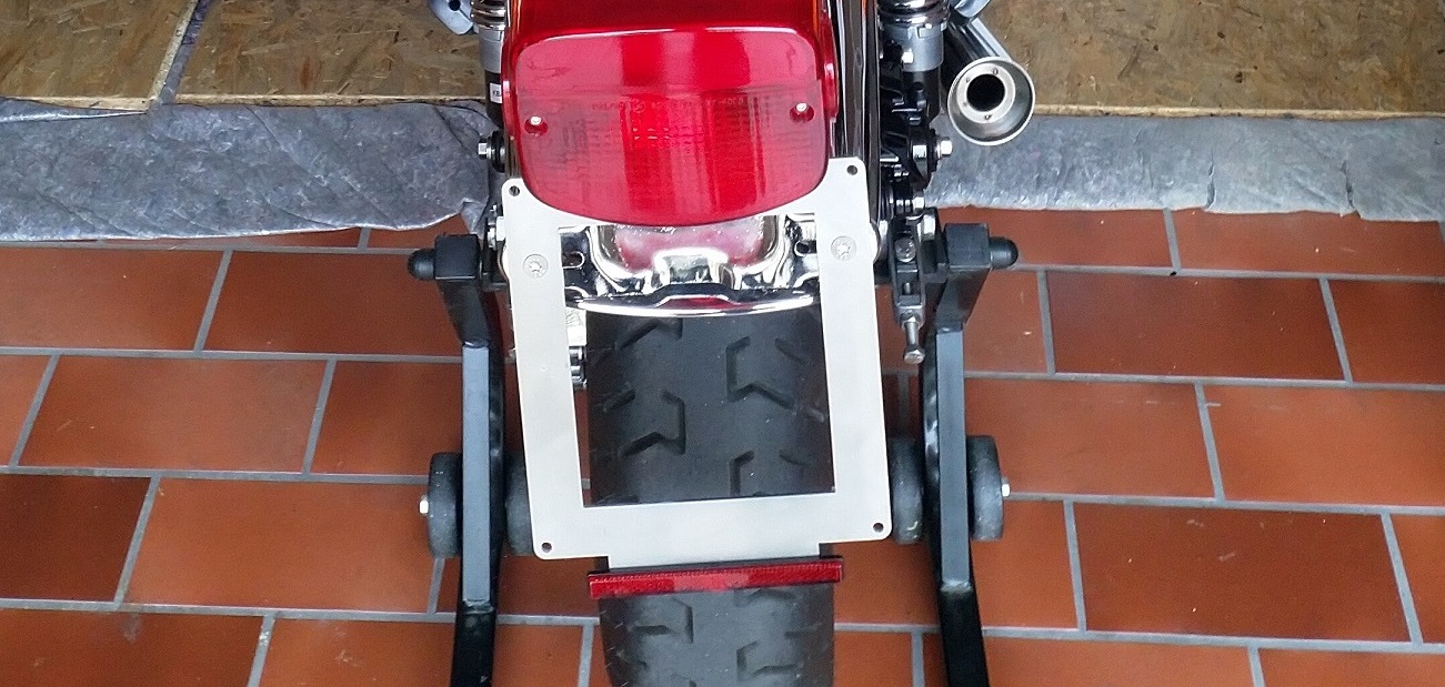

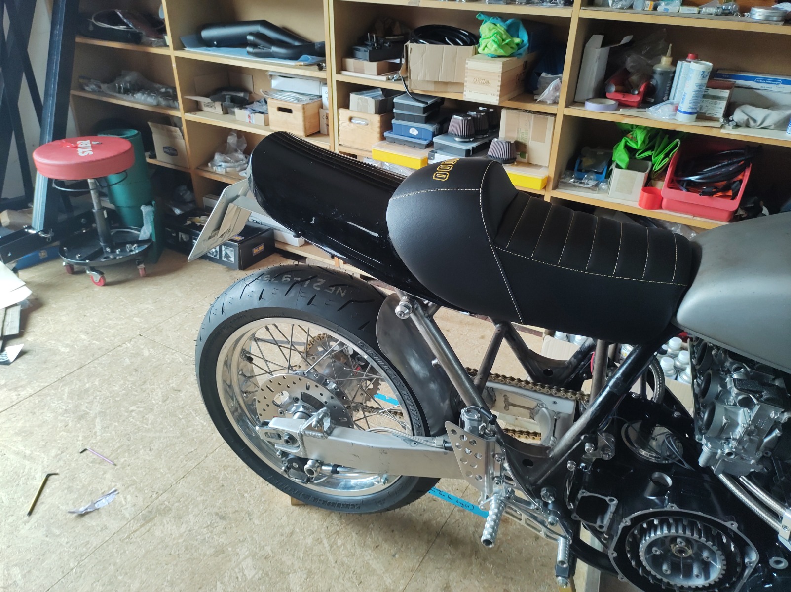

I figured I should reconsider putting the license plate under the tail. I mocked up a bracket and took the shocks off to see how close I could get it to the tail. Still not sure -. sticks out a bit much... will let this one sit for a bit, plenty to do in the mean time.
