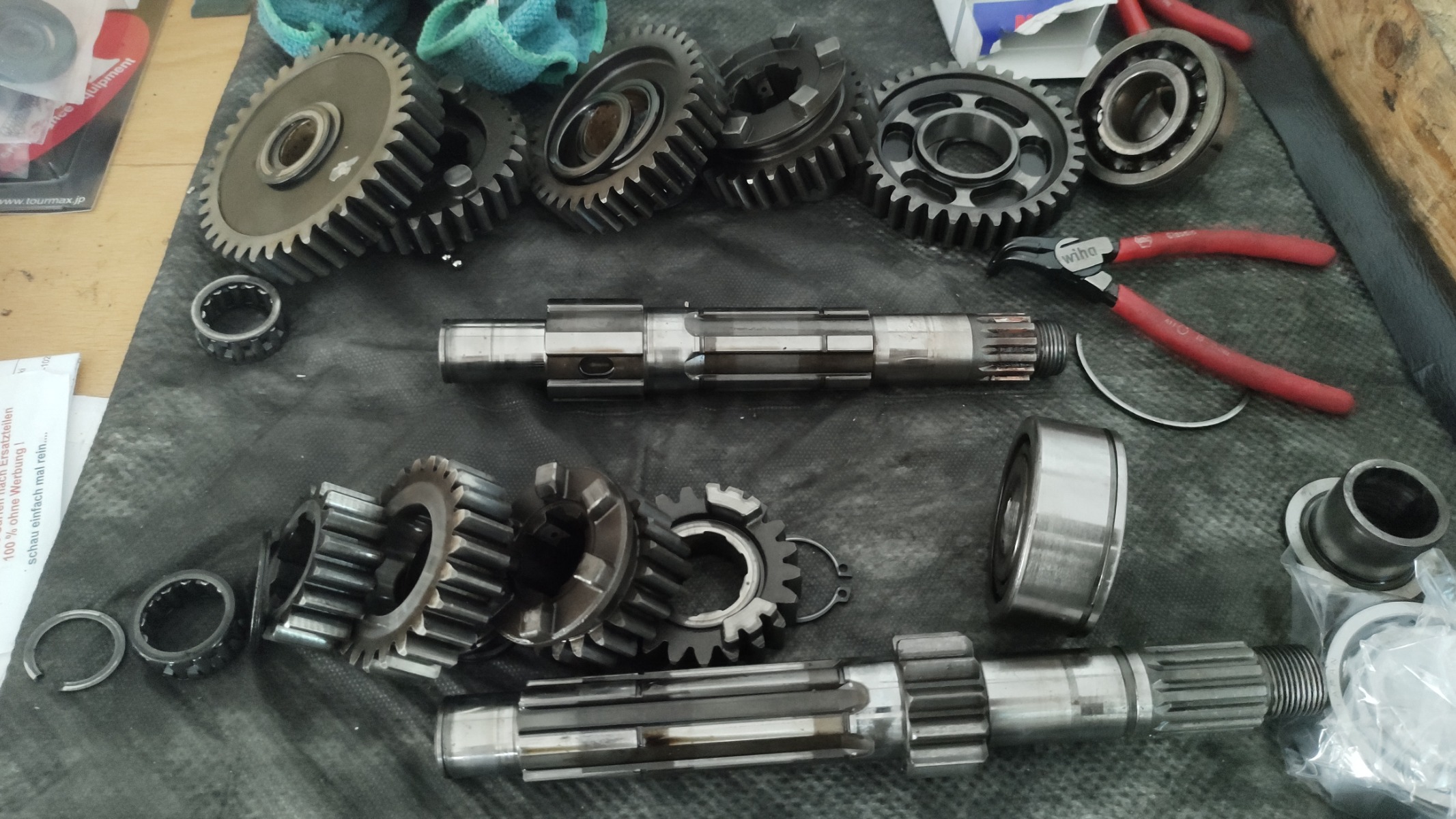

Ready to clean up the transmission. One of the circlips didn't survive the disassembly so need to wait for a new one before I can put it back together.

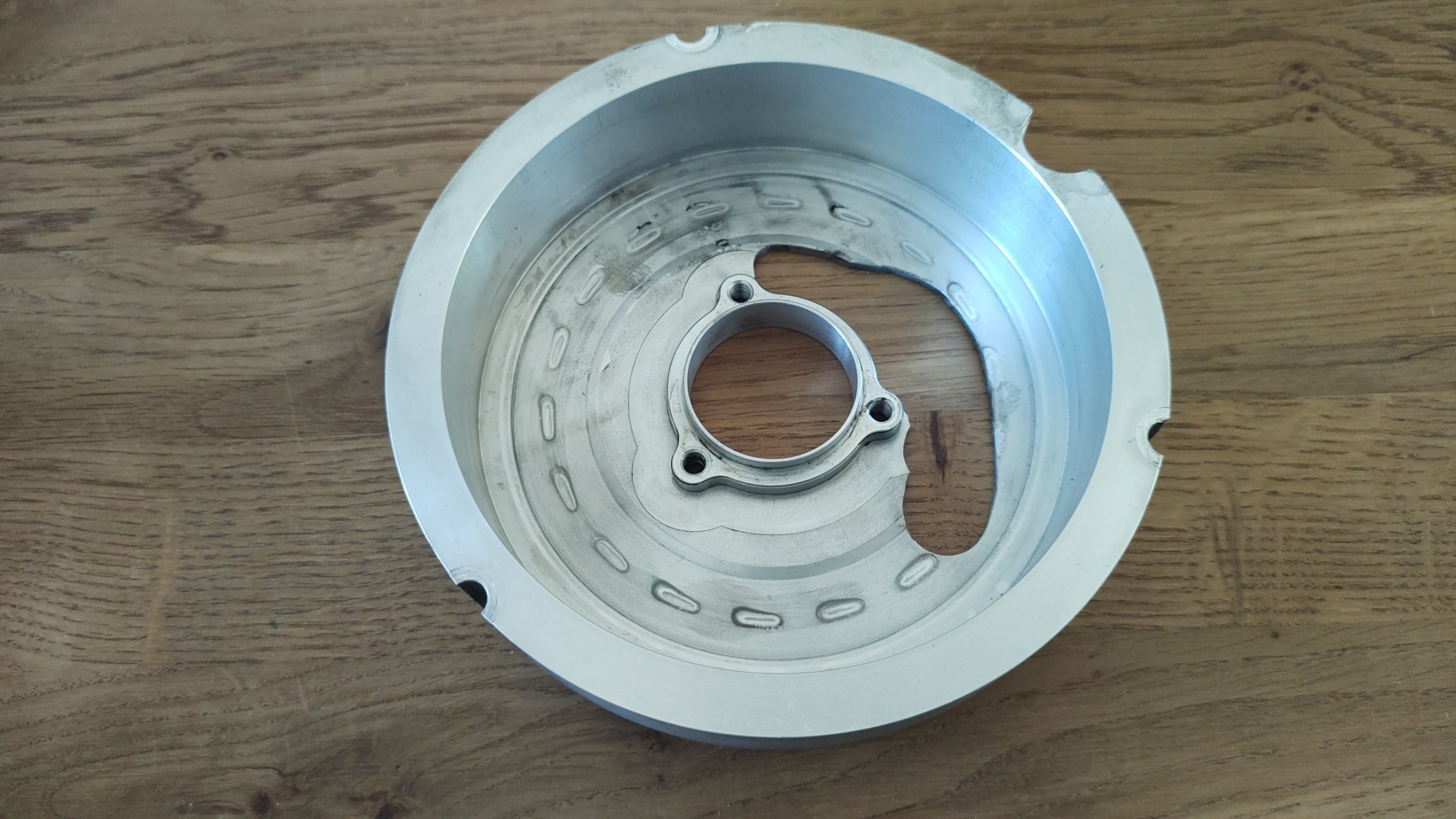

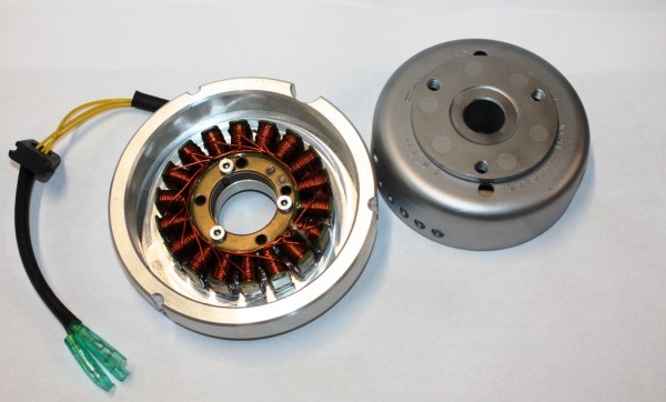

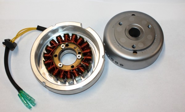

I was getting all the parts together for the bottom end today. I have a MK2 alternator cover with a MK2 (or similar) stator. I got the stator with an adapter plate for the standard A1 cover (see the pic below) and a rotor from a different model. The rotor looks like it could be from a 750 (E1, H1, ...). It fits on the taper of the KZ1000A1 crank. Does anyone know which later model you can take the alternator from for an A1 if you just swap out the cover?
Adapter plate:
Here's a pic of the conversion kit (I picked it up cheap on ebay but I'm pretty sure it's this kit):
Adapter plate:
