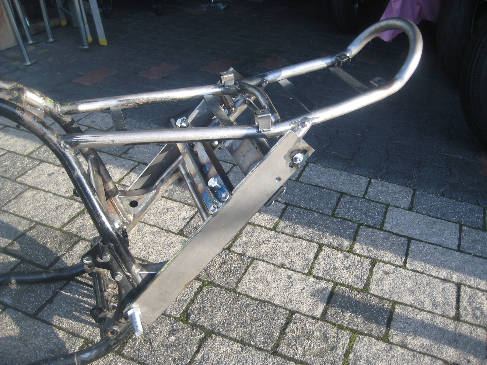

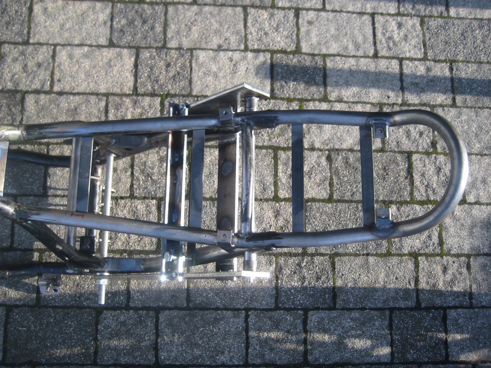

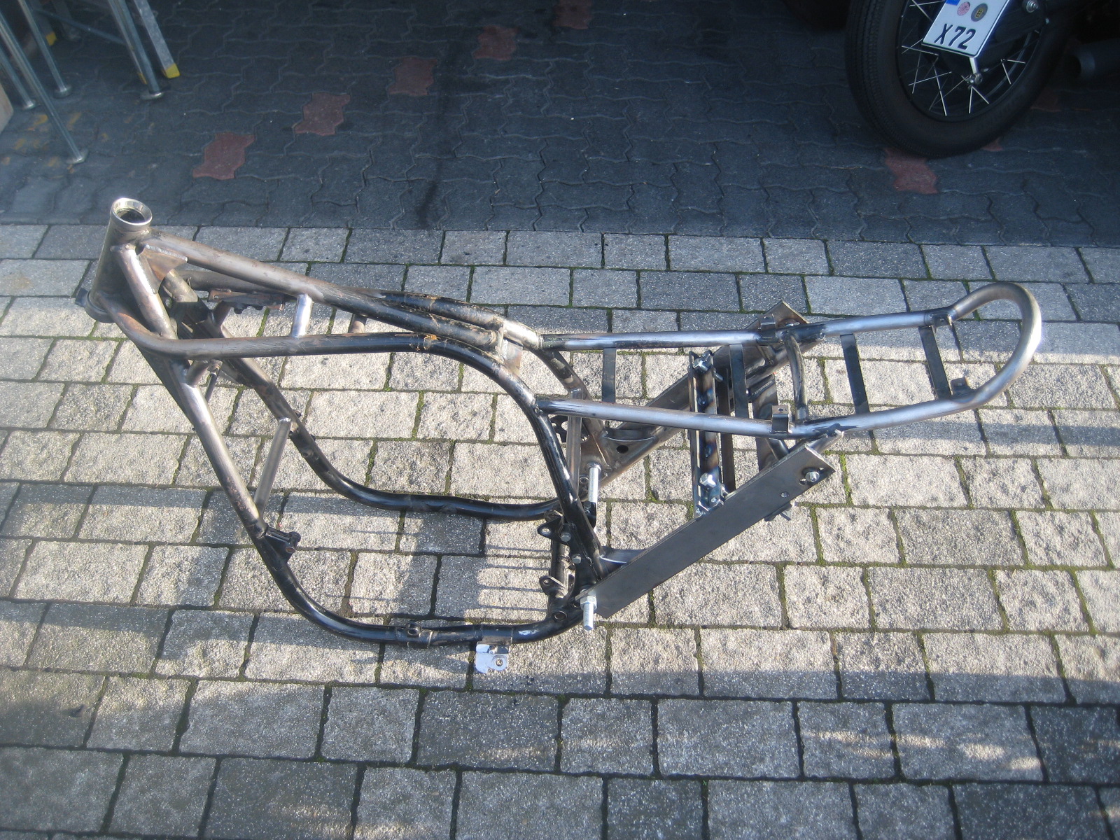

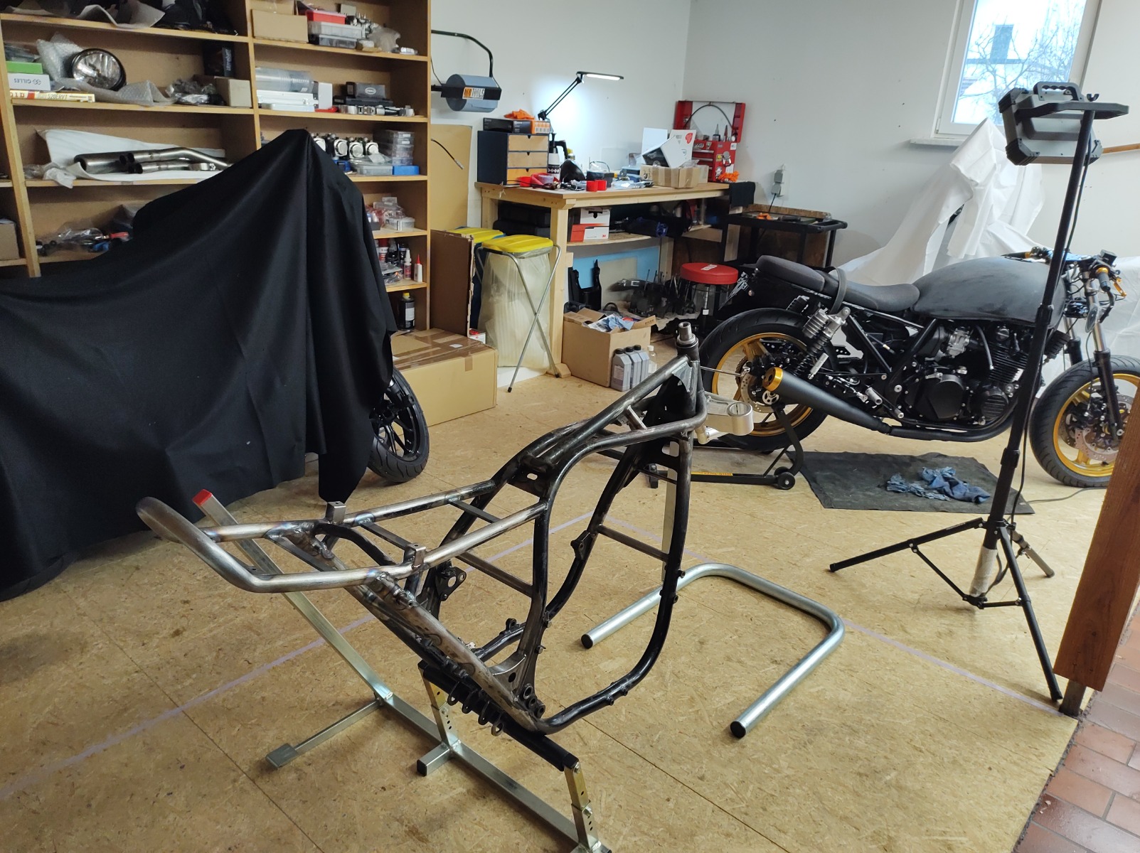

Here are some photos of the frame when I took it to get welded. I reinforced the jig and added some tubing to fit over the shock mounts.

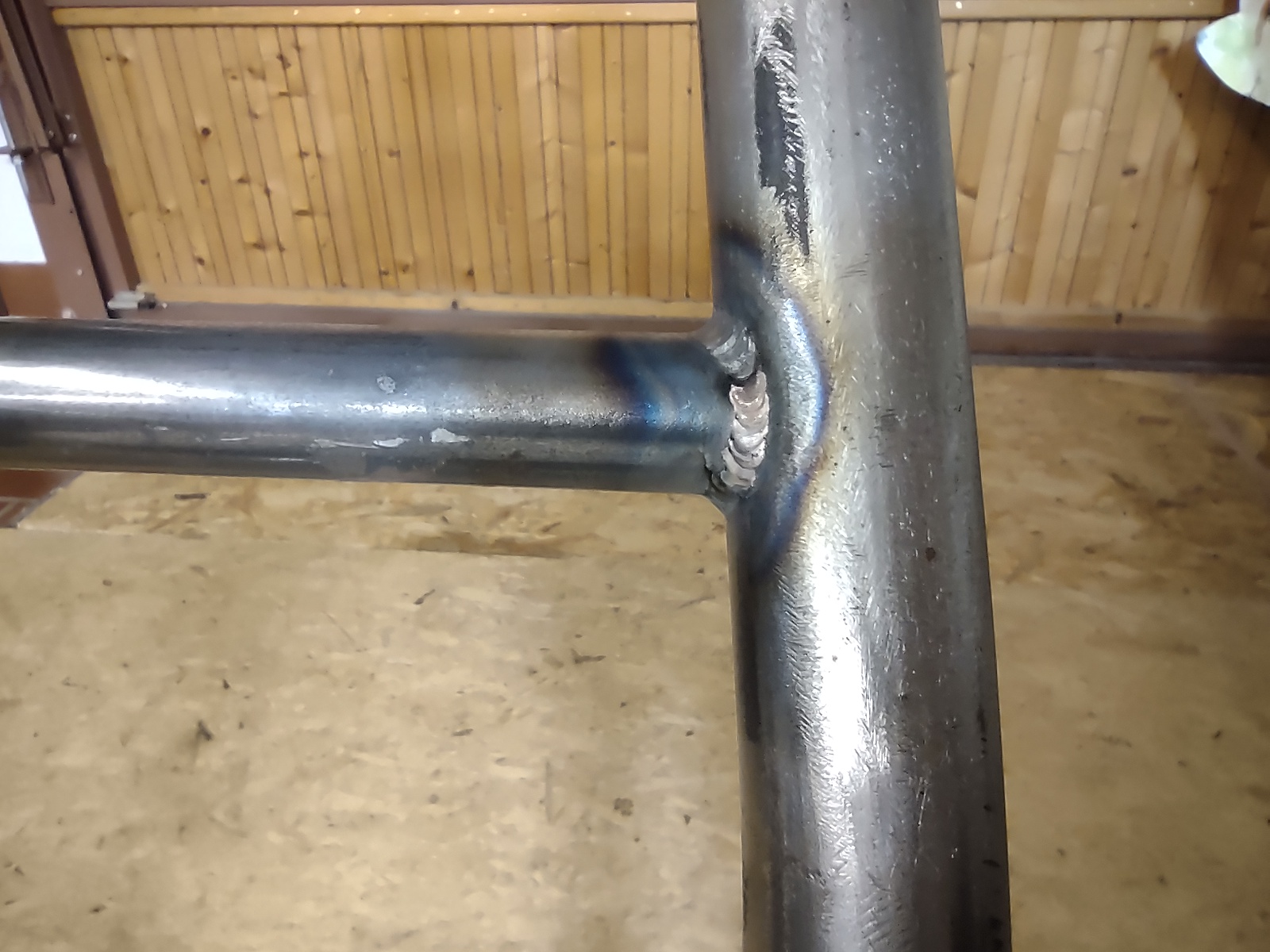

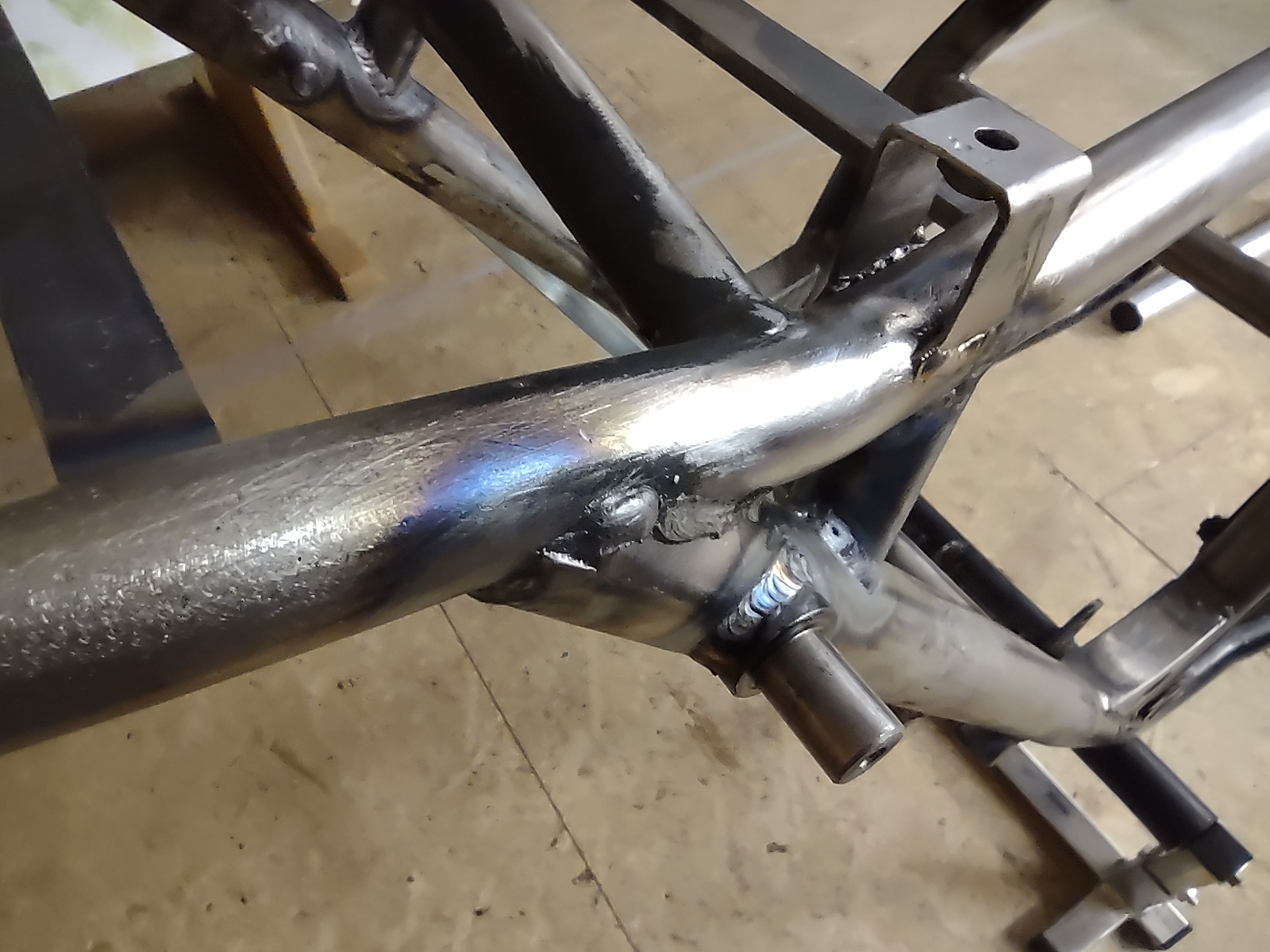

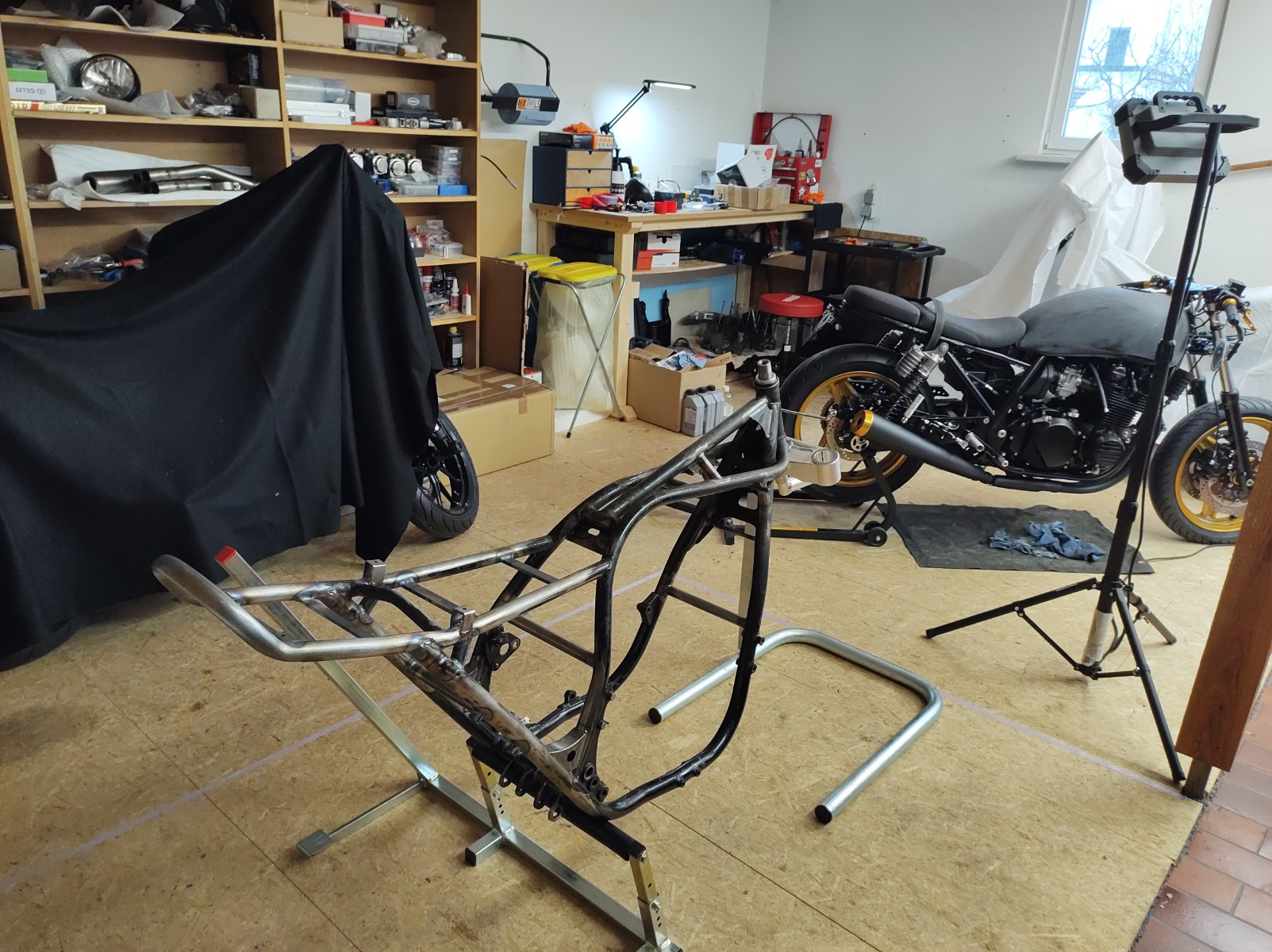

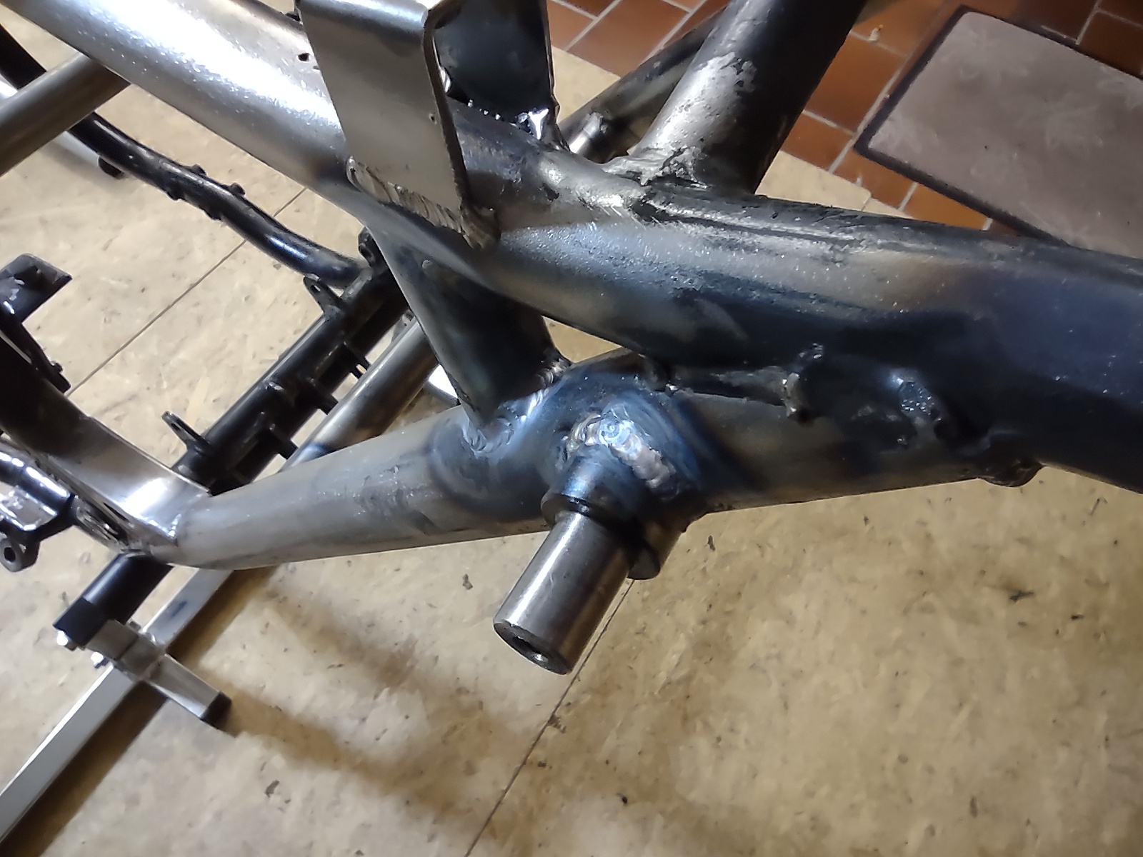

Got the frame back. The welding is OK - he didn't put too much heat into the joins and, most importantly, it'll get through the MOT. Got the garage tidied up (sort of) and I'll start working on the seat pan and a tray for the electrics over the holidays.
