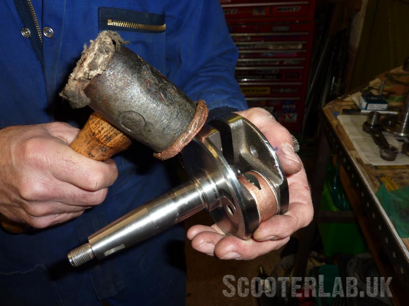

If you have ever seen a crank trued after being pressed up and clocked it is simply done by a highly skilled mallet technician.
Sounds crude but effective and a few sharp taps is all it takes.

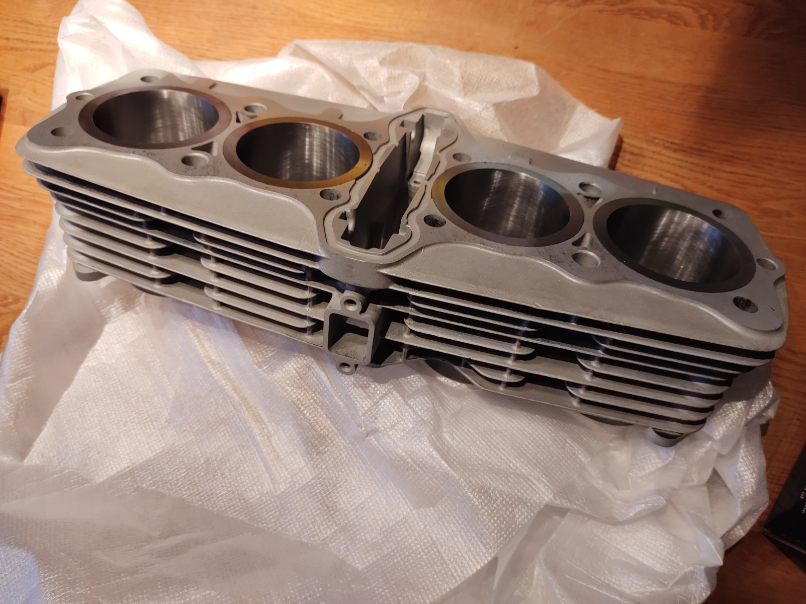

Picked up the cylinders and pistons yesterday. Took a photo of one of the cracks in the plug threads before it gets repaired, after the head was cleaned up you could see the extent of the damage. I'll post a photo when I get it back after being repaired.
The worst crack in the head:

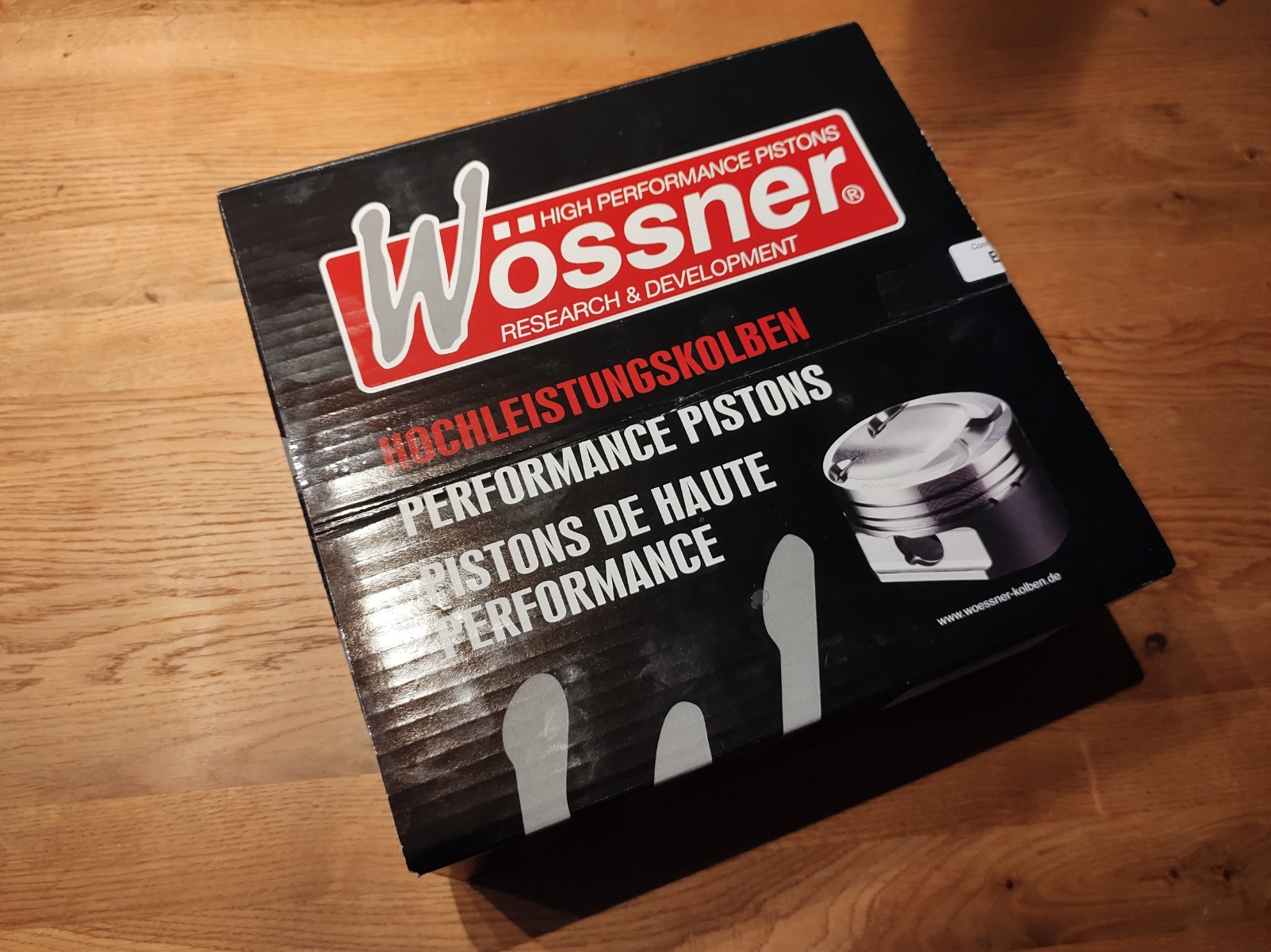

The cylinders - I went with Wössner pistons, had to go with German quality

Calum - those new pistons look great! It appears as though they apply some anti-friction coating to the skirts? Very nice.
And, just a suggestion if you haven't done so already - before installing those pistons, I would gently radius the edges of the valve relief pockets that are cut into the domes. This eliminates a potential "hotspot" and will lessen the chance of preignition. A small detail....

I’m not a professional builder but I agree. When I was building SBC street engines I’d grind and radius any sharp edges off.

Mike: As far as I can tell the skirts have a teflon coating. Can't find any real info on it though and no paperwork in the box. I'll gently take the edges off before I install them.

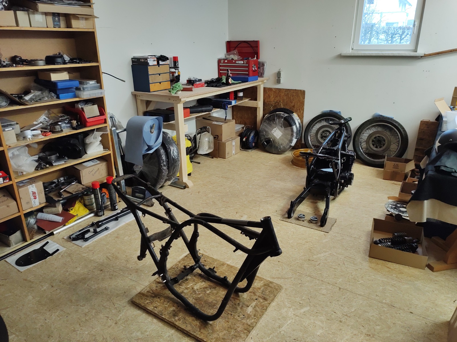

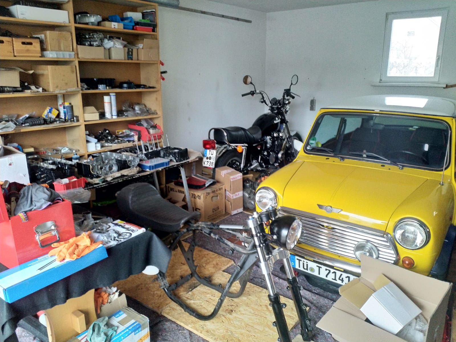

I hear you! It's been pretty frustrating working on everbody's vehicles but mine. Finally have some space though. Made myself a new workbench and laid down OSB over the tiled floor (don't ask me why anyone would tile the floor of a garage...).
Before:
After:
Before:
After:
