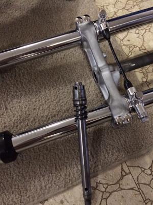

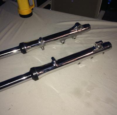

Hi MK. Was this the same polisher guy in Buffalo @ Tripp Plating that did the Zinc?
You should have bought a Harbor chi-comm buffer and some wheels and started a new career!
I just cleaned these suzuki gs1100 forks up. They polished nice. They are on eBay right now.
I have a one fork hyd. damper sitting, Would you like the whole thing? This roll pin actually looks like someone ground the tips down after it was installed?? I could mail it out today 1st class mail. You can have it free.

Marty,
No I didn’t have Steve at Tripp polish them. I try to find local guys to avoid shipping. The guy that did them was a retired guy that has a local shop I’m assuming is moragte free and didn’t need the money. I still took a chance but learned a good lesson. The gentleman on the west side of Michigan that has been doing my Vapor Hone suggested a new polisher in Tennessee. I just put them in the mail this morning. Let’s see how this goes.
Thanks for the offer on the damper. I’ll PM you to discuss.

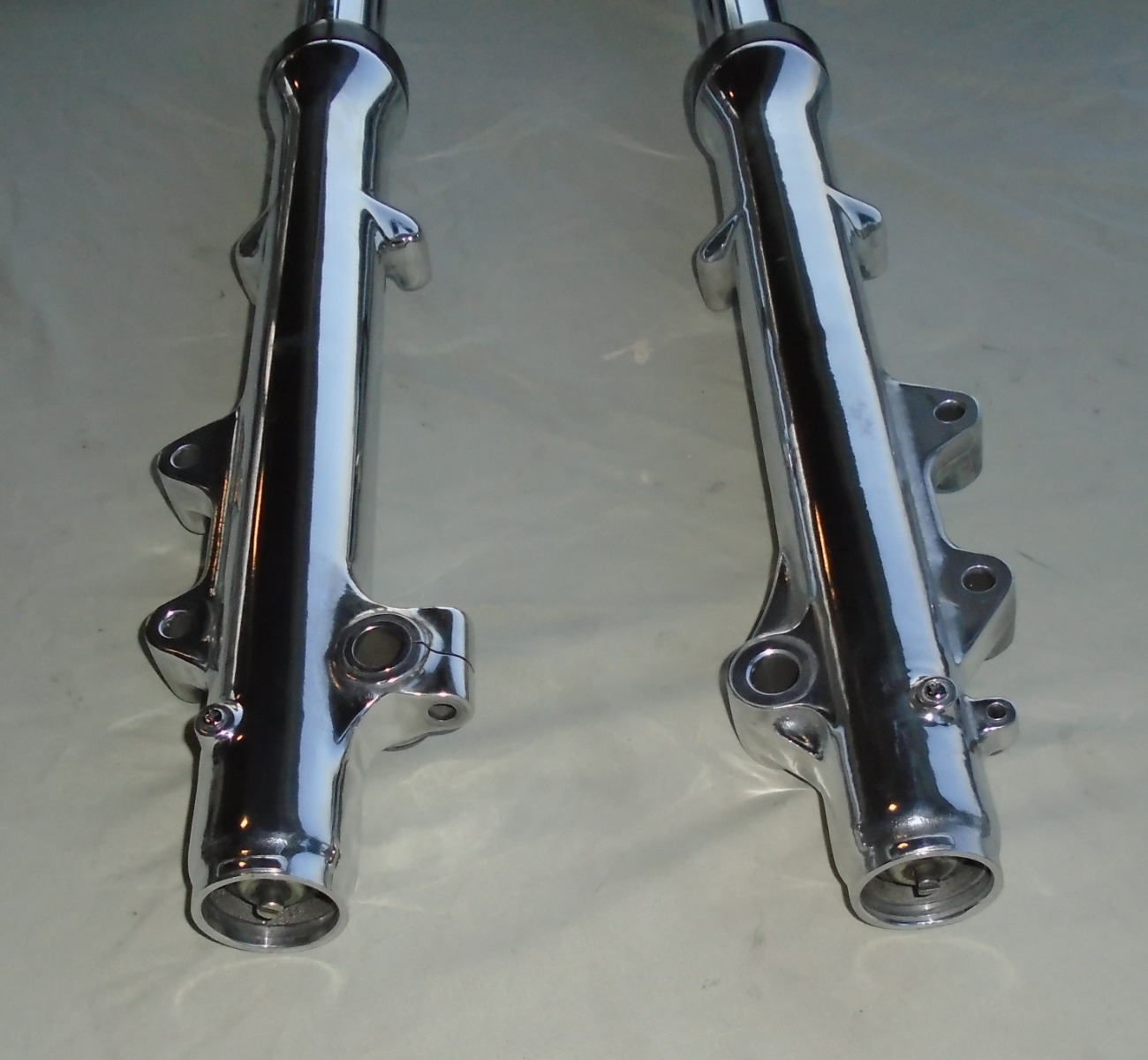

Look a few pages back, HRM showed a set he did that look very original. Sanded out the scratches, then vapor hone and then a light buff. I don’t know the grit or compound he used.

I don't recall what paper I used but I suspect it was 3000 or 5000.

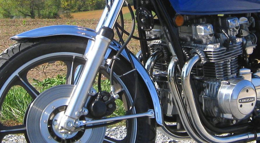

The originals, at least on the 1977 KZ650 bikes, had a clear coating of some sort on them. They were very clean and had a nice shine to them, but they did not look highly polished like chrome. Here's an image of mine when I installed a pair of new old stock ones on my 1977 KZ650-C1. Ed
