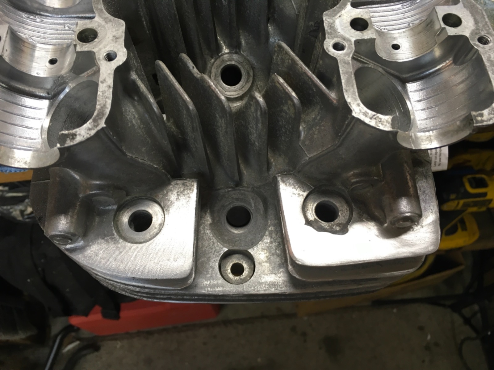

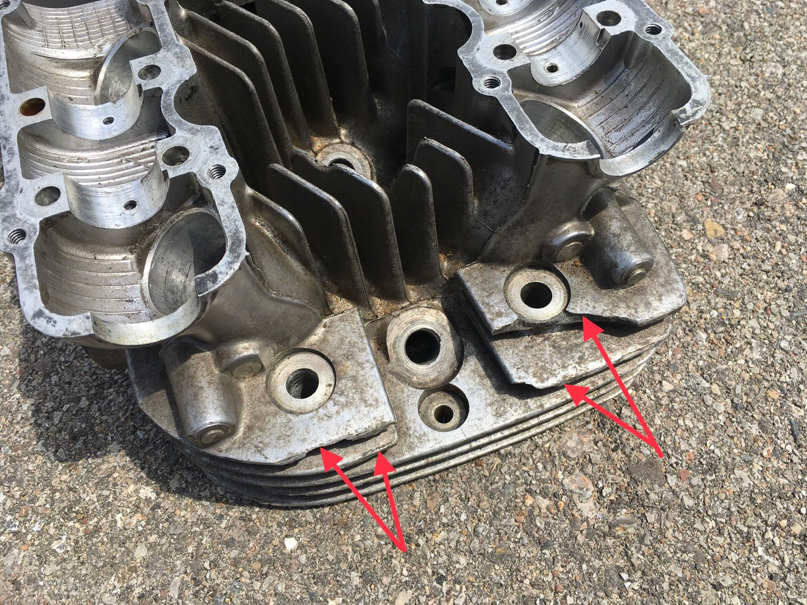

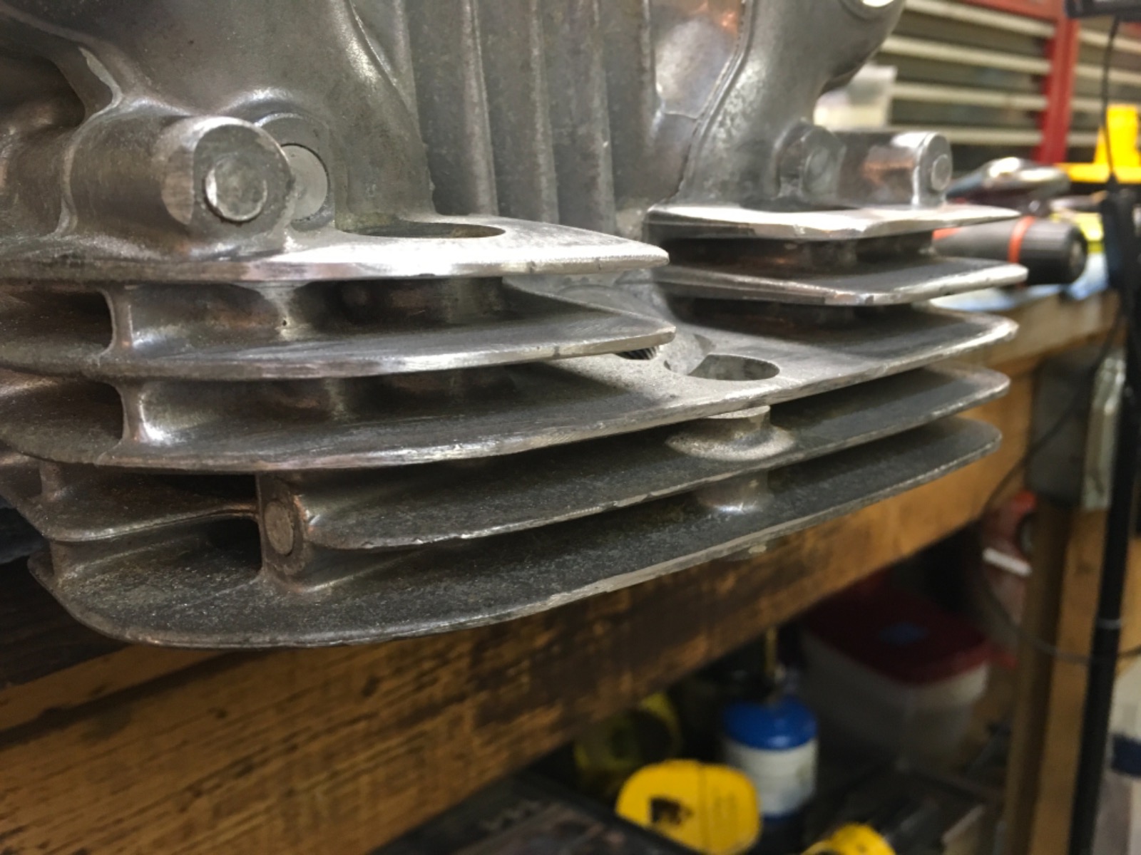

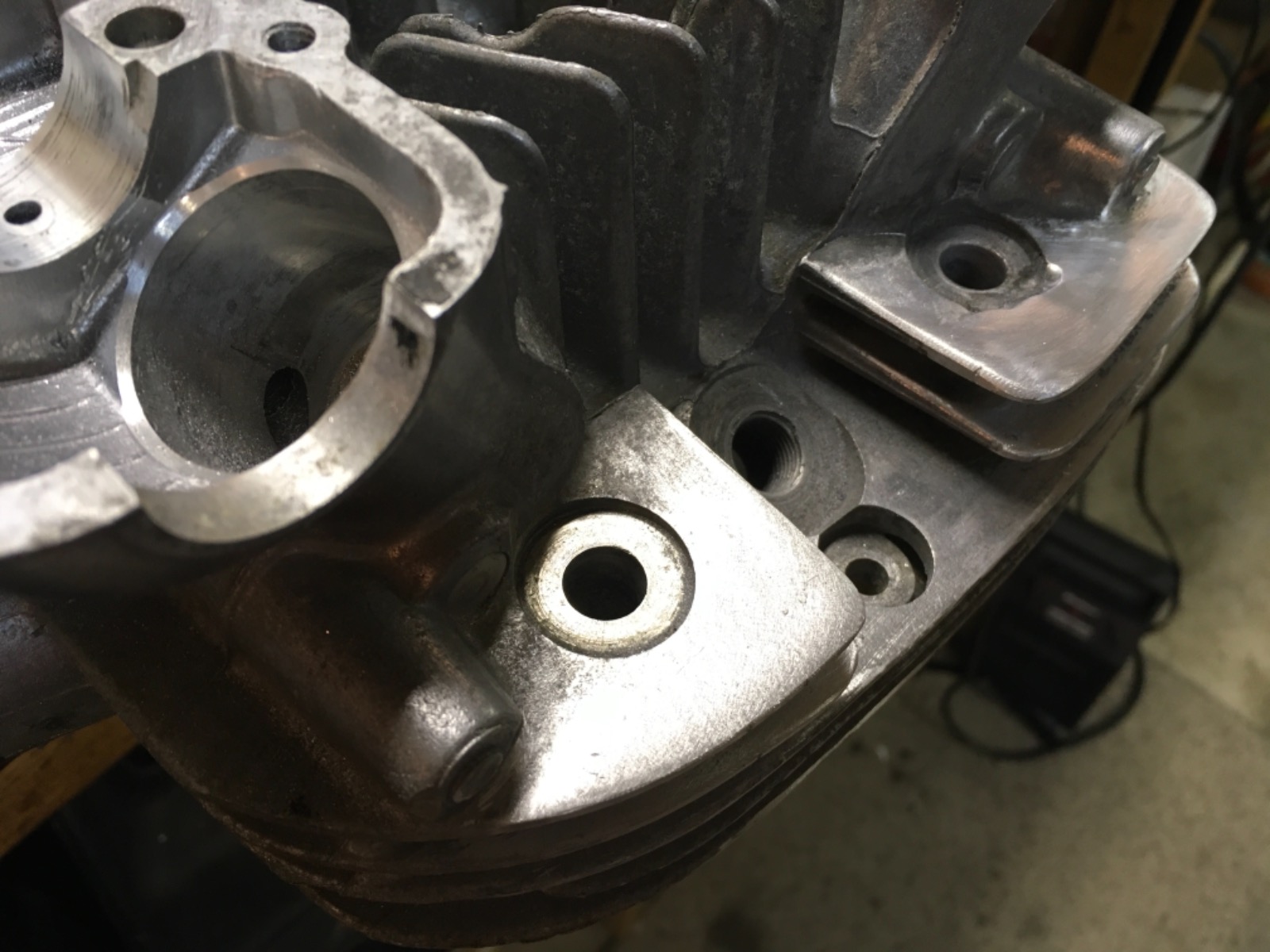

I’ve been working on the head. I found a local engine shop that had no problem welding up the broken fins. I cleaned the up today, I need to take the head back at least one more time to do a little more weld build up. They it off the be glass bead, I’m hoping that will blend in the repairs. Then to my Vapor Hone guy, and finally back to a different shop that’s been building metric engines for 30+ years.

That fin repair looks very good!

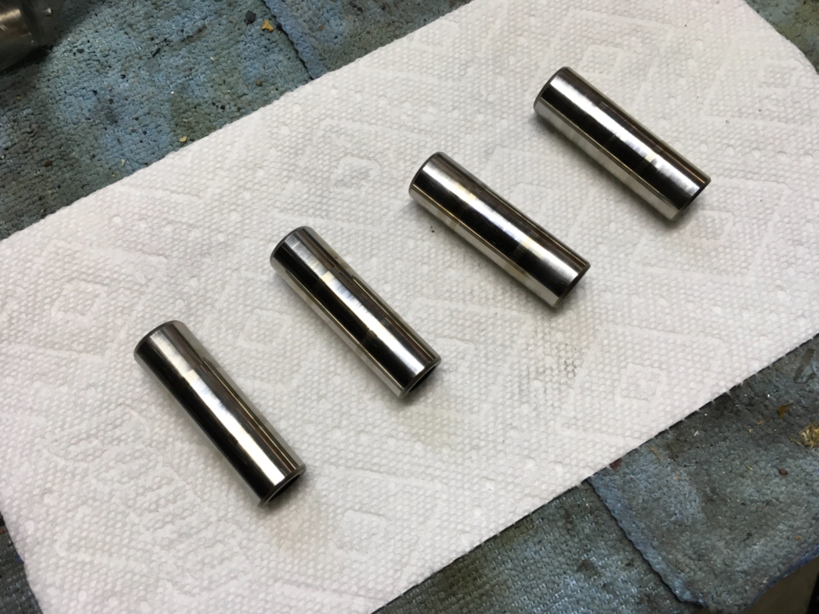

While I’m waiting on the head to be welded up the second time, hopefully I can profile the fins with the second build up and move on to the head rebuild. So I’ve taken to getting lower end parts out and inspecting them pre build. A quick reminder of where I’m at. The engine I bought for this build was an early ’76 without the oil volume cast into the upper case. It’s an unknown to me. Upon tear down it looked good but I didn’t dig deeper than the cases. They were my concern at the time so I could get them out to be vapor blasted. I did notice the pistons were 70mm wiseco. I didn’t want to use them so I have been searching for a good 66mm OEM set. I found them but no wrist pins included. I thought no problem I can use the pins I have out of the Wiseco. I dug the pistons up this afternoon and not pleased with what I find. The pins appear to have metal to metal transfer or gauling. I need advice please. I can get new pins but what if anything needs to be done to the small ends of the rods. Obviously I need this corrected before I build the lower. The backyard mechanic in me checked out the rod small end with my pinkie and it feels smooth but at the oil holes, the edges feel sharp. #2 appears to be the worst.

I have another set of 70mm stock pistons out of an engine claiming to only have 4K on it before it was wrecked and parted out. I included pictures of them for comparison.
