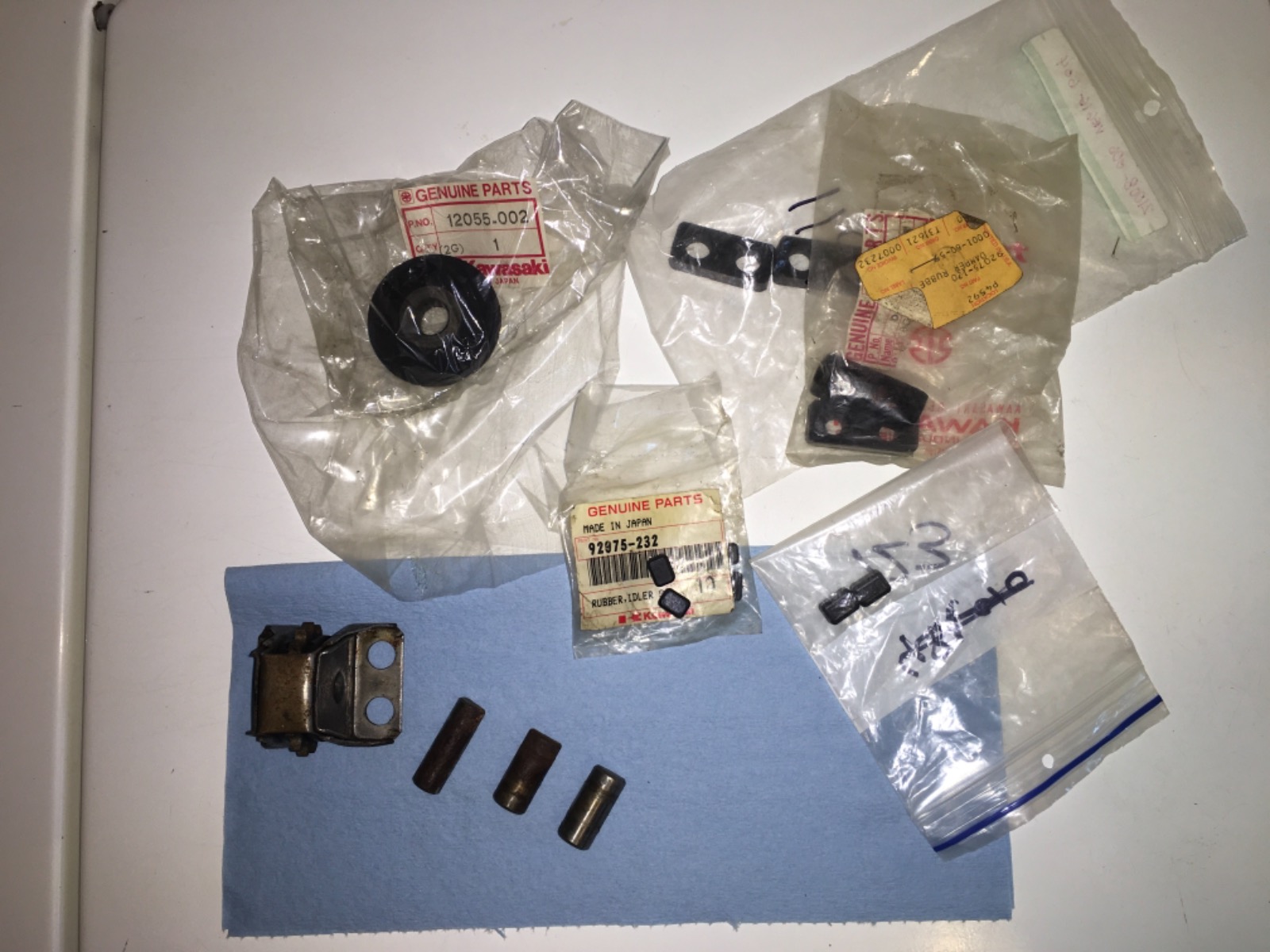

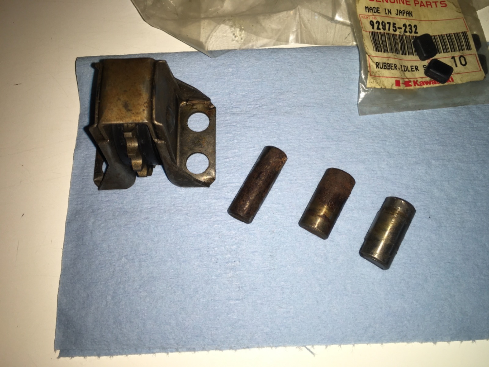

Hey MiKaw Matt, sent you an IM I hope? Getting tricky lately?

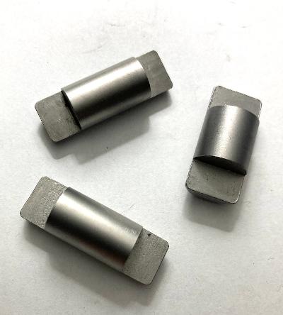

But are these the 3 you need? I cleaned them up in the glass bead cabinet.
Should be fine, no pits or grooves. I need your address, I never saved it.
Marty in Buffalo
Marty in Buffalo

Hi Matt, I sent 3 rollers out to you, 1st. class mail Tuesday. Just a heads up, small manila envelope.
Marty in Buffalo.
Marty in Buffalo.

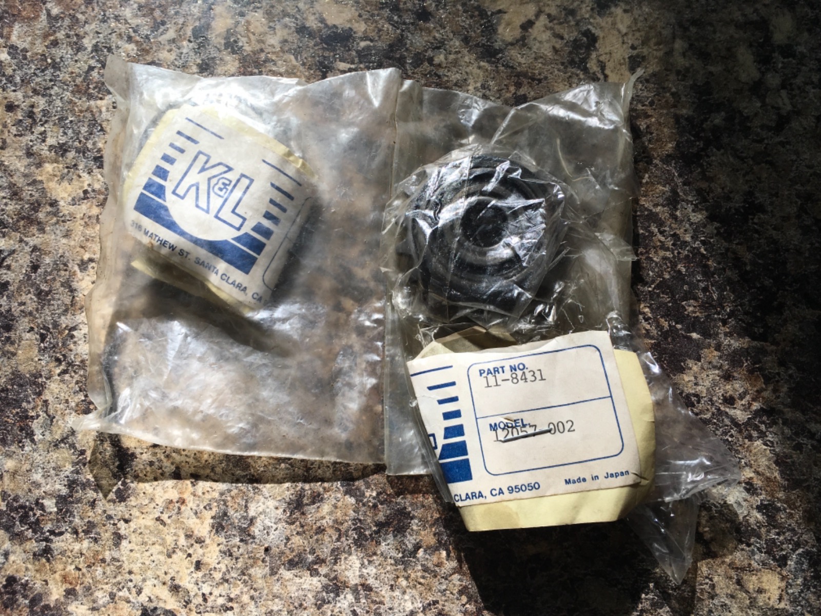

Pistons are here. Middle cam gear idlers. Ring compressor (thanks to Dr. Gamma). Z1kzonly helped with the idler shafts. Just need to source a top cam chain gear and I thing I’m ready. Head is out at machine shop. Randomly tripped over an old school metric engine builder, and close, maybe 20 minutes ride. He’s doing the block also. Plan is to get the pistons and rings to him when I pick up the head. Might even get it running this season.
At some point I have get out my big boy pants and get over it and get the lower assembled. Just eating me up thinking and not going to get the cases sealed up right. Tossing the block and head on doesn’t scare me.
Anyone have concerns for the NOS K&L cam gears? Marty, I’ll get with you on PM. Thanks for the idler shafts.
