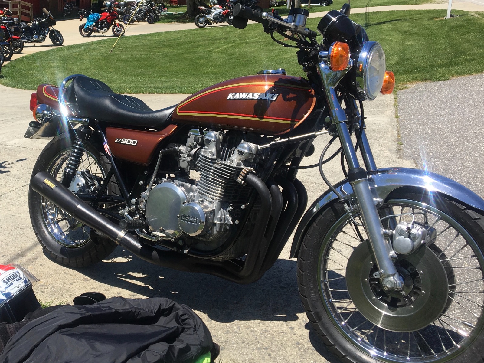

Keep it going I know it’s time consuming but once it done it will bring many smiles and enjoyment.
Hera mine I did about 5 years ago

Very nice....

I just loved that seat so much for yrs.!! I bought one! To go with Mikaws grab rail! !!
I had to weld seat tabs for hinges on. The last guy had that Old fiberglass tail on! He cut off the seat hinges???

26 Dec 2020 09:03Thanks for posting that picture. It help me stay focused on the build , but more my color choice. I have always liked the green more but it seems like every '76 is green. I chose brown because its not seen as much. Now i know I made a good choice, your brown is the sun is stunning. Who did your paintwork?.
Also just recently I found out the '76 should have the turn signal alarm but mine didn't have one when I bought it. My 1976 LTD does and its mounted inside the headlight bucket. Does your's have one? is it mounted inside the headlight?
Partzilla shows it as part of the chassis electrical but the fishe doesn't indicate where it is located. I don't recall seeing it in the FSM but I may have missed it
