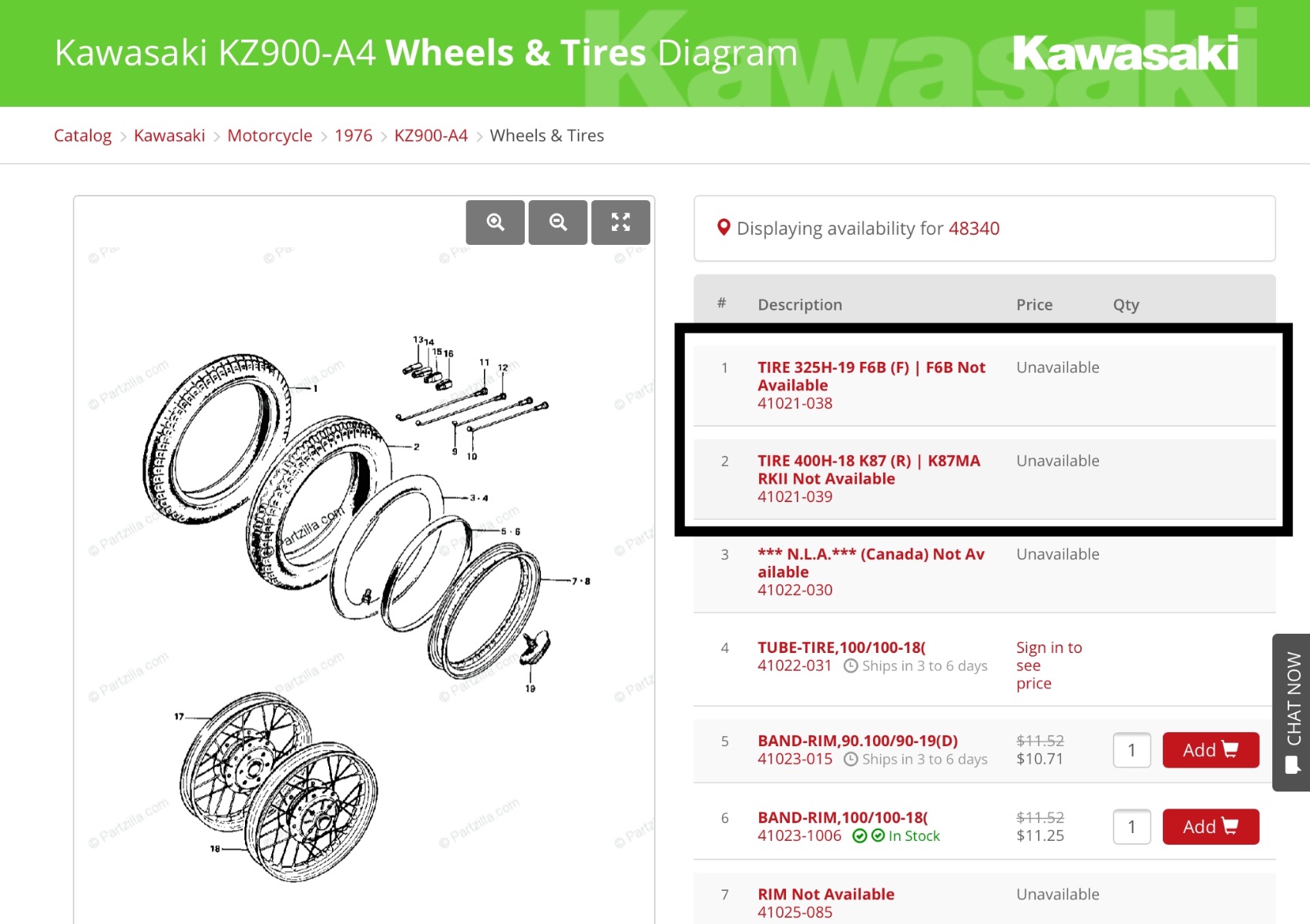

I have a front 5f 305, completely laced. Actually I bought it from Asphalt900... I just sent a rear 5e 305 off to be chrome plated... I’m more in need of direction on the correct front tire... I’m having a hard time identifying the F6B, nothing comes up on an internet search... the K87 rear I have, that’s a Dunlop Goldseal...
Re: 1976 Kz 900 A4
04 Jul 2020 11:36

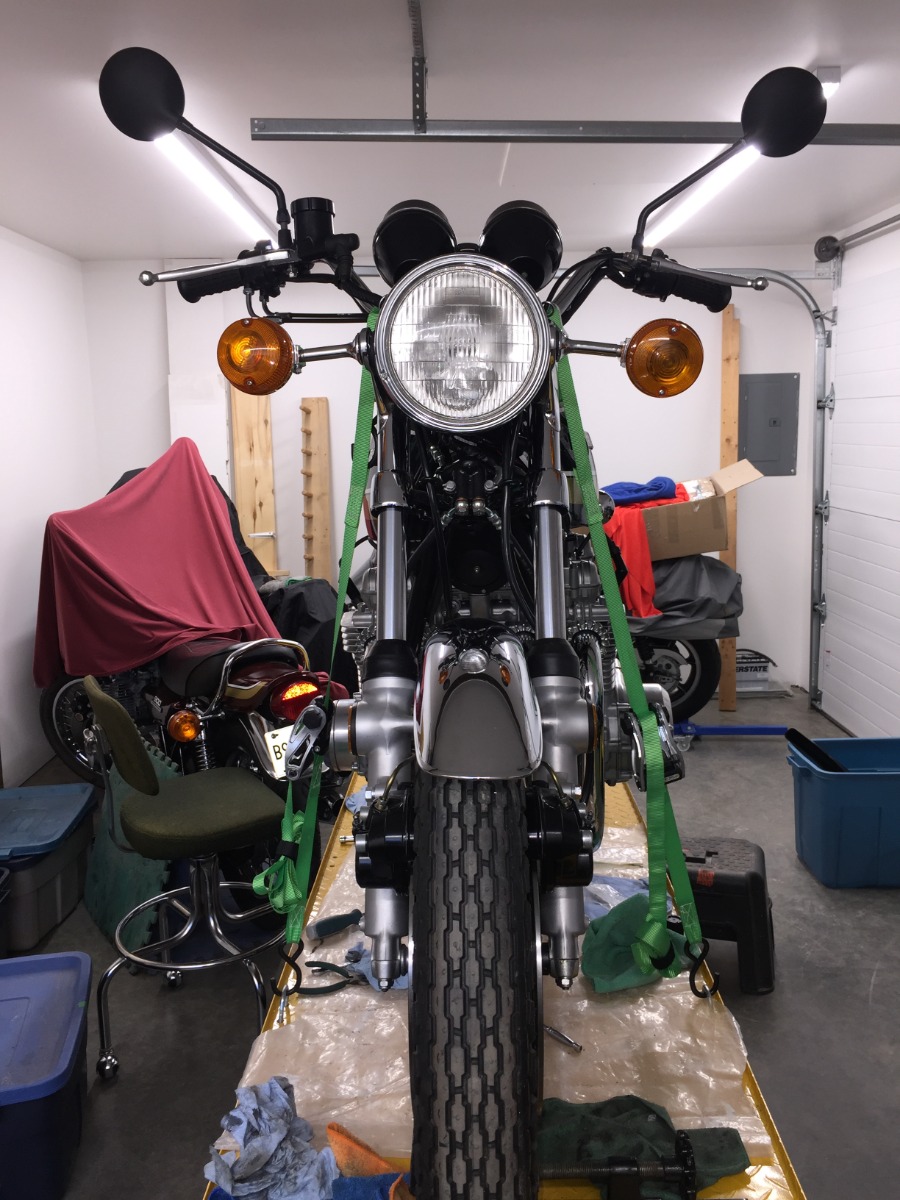

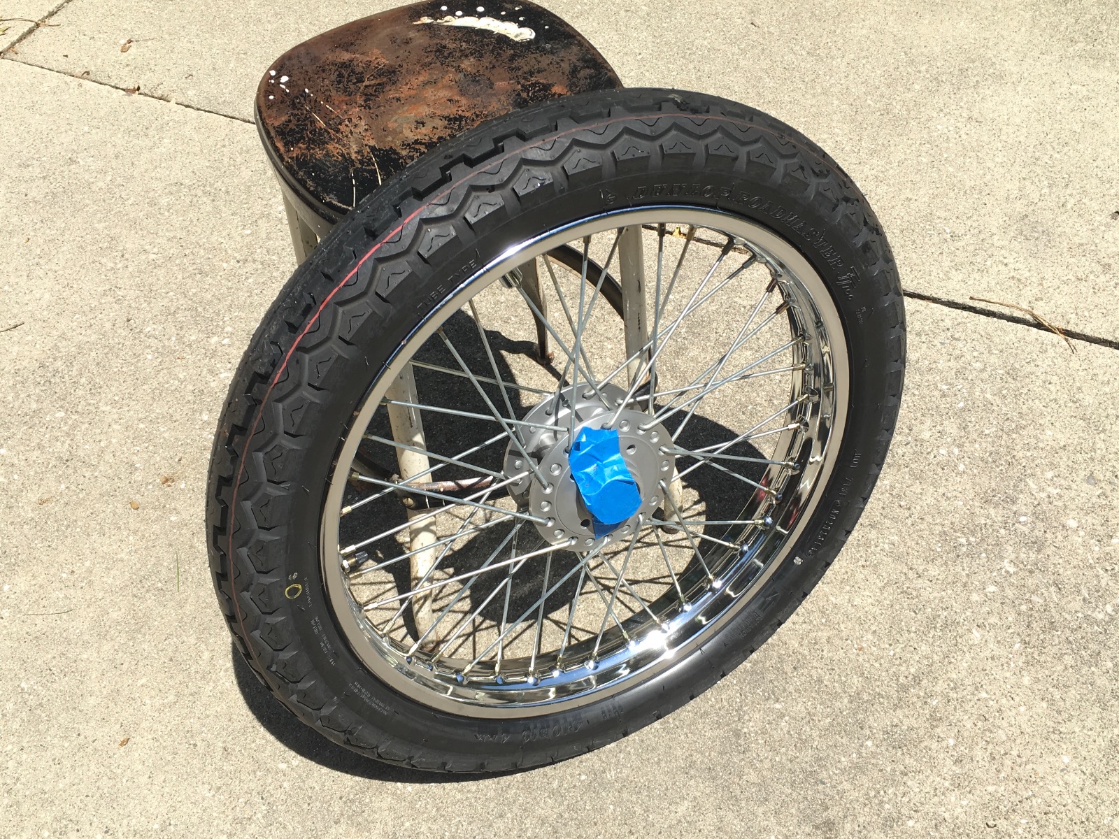

Small progress today... couldn’t find information on the front F6B and the K87 is sold out till August. So I went with the tt100 roadmaster. Hope it’s correct enough. Rear is held up as USPS is still slow getting the rim to NY for chrome Plating...

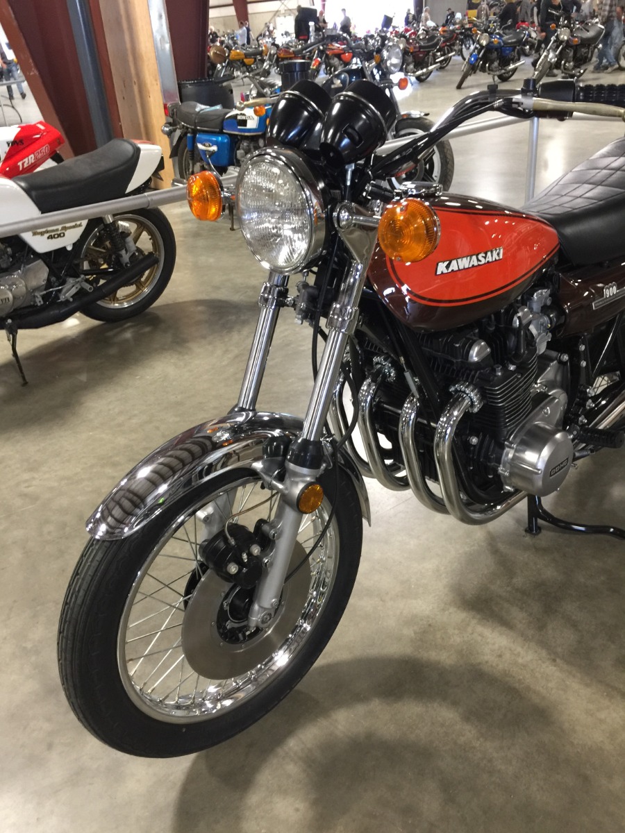

This is an F6. I have them on both my Z1's. They don't look at all like the original F11.
I bought the last one from a guy on ebay - retro-motorcycles. He is also a Facebook friend...lives in Seattle and sells Z1 stuff.
The second photo is an original F11 on a friend's Z1 S/N 1006. He completely restored it but doesn't intend to ride it. It sits in his LR.

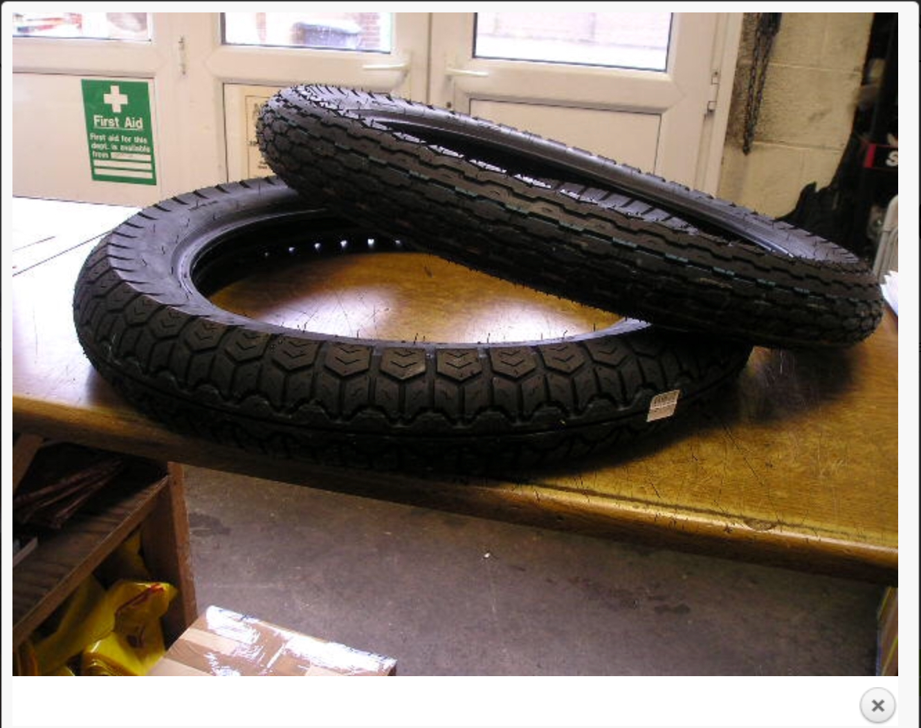

This the trouble I’m getting in to... this is claimed to be an F11 front and a K87 rear... looks like yours that was claimed to be a F6

04 Jul 2020 12:30
Definitely not an F11. They haven't made them for years but occasionally a bike shop will find one in old stock. Here's a better view of the tread. (Same bike) It's what I remember from back in the day...I'll look at my old bike photos to see if I have any showing the tread.
