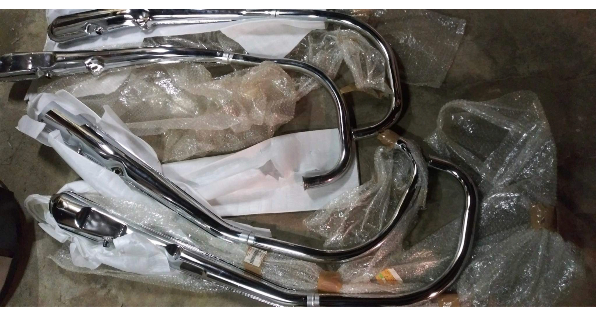

I had a deal fall through about 2 weeks ago on a set of Doremi aftermarket exhaust. The seller wanted $900. But before I could make travel plans to pick them up he called and said he was keeping them for a Z1B he just picked up. We I just made an ever better deal. Like it’s mentioned. Another door opens when one closes. No Introduction needed. Look at the following pictures.

Damn! those never were cheap. I'm not sure when they changed from the yellow tags on service parts, but I think it's probably been ten years ago by now. The number under the muffler assy script 000473-39-45 means suggested retail is $473.45 with a 39% mark up! I wonder how many $ worth I threw away that got scratched during assembly? Never quite got the hang out of polishing scratches out of chrome.(got pretty good at polishing aluminum though)
