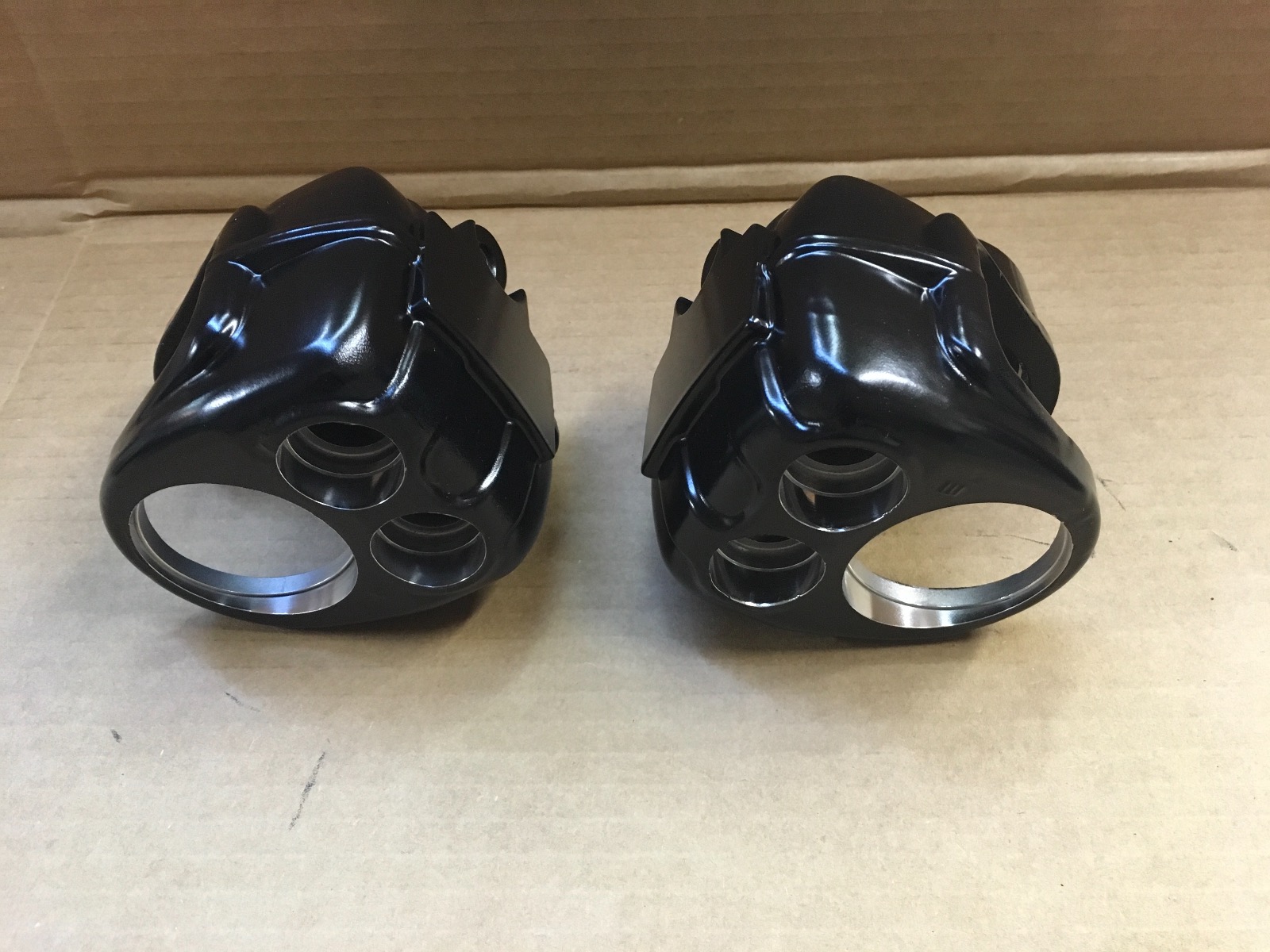

Hard to believe it’s been a week, two coats of caliper paint. Hope it’s all good. Tomorrow I’ll pull the plugs and take a peek

They look good. Not too glossy.

Those look like new old stock calipers! Nice! Ed

Nice work Matt, Did you think at all of putting your painted brake parts in the oven to cure? I always put heads, blocks and brake parts in the oven on low for an hour. I like 250° Turn off oven and let them sit till cool.
And have you though about DOT 5 silicone brake fluid? Does not eat paint.

Thanks, did consider curing the calipers in the over but I didn’t know the temp and time length. I used VHT Caliper paint, is your suggested temp and time good for that paint on aluminum parts?
Dot 5 sounds like the ticket.
