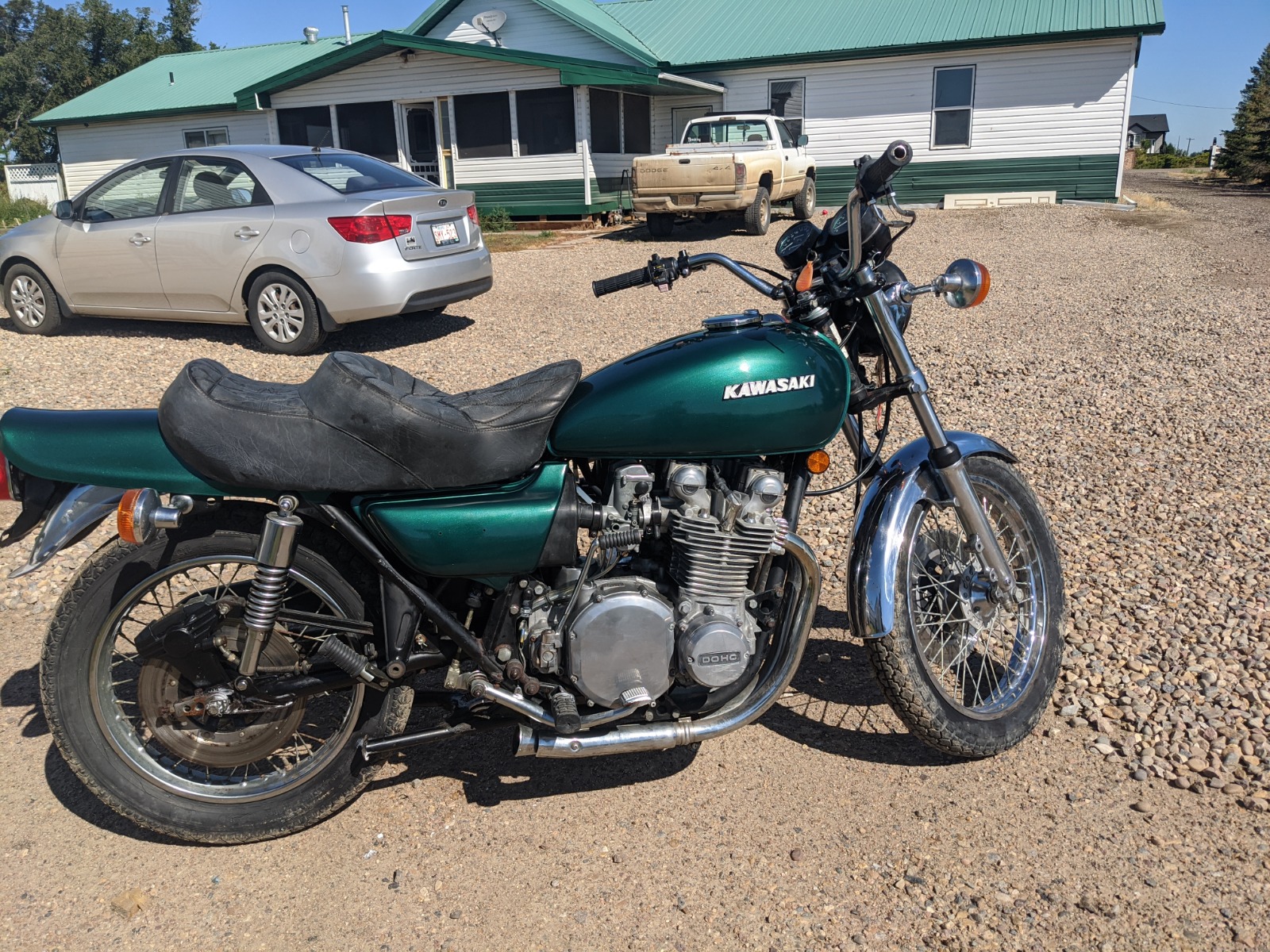

Got the bike outside in the sun today for the first time since paint. Pain looks good. Can't wait to do decals, several coats of clear, and a cut/buff. Will look incredible with some shiny paint, a new seat, and an exhaust.
Also drove it up and down the road. Starts great. It's a private road in the country so was able to get it up to about 70kmh. Seemed to run pretty good. I think it requires a clutch adjustment though. Stalled a few times at crawling speed thinking the clutch was engaged when it apparently wasn't.

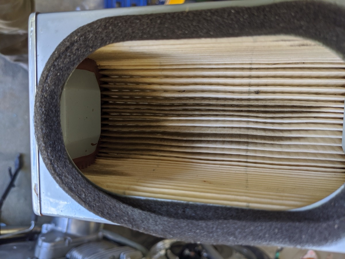

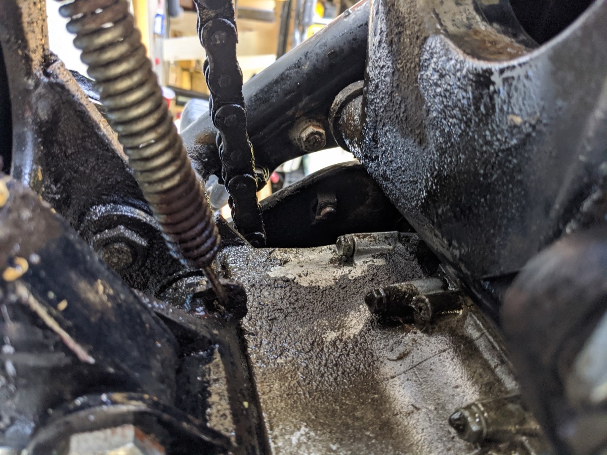

So today I cleaned out the pilot jet on cylinder 3 because it somehow became clogged. Or perhaps it was always clogged. No idea. Fired it up afterwards and it was running fine for a bit but then started bogging down, and died. If I let it sit for a bit it would fire right back up again. Couldn't figure it out until I noticed a bunch of oil on the ground. Thought a gasket went in me, but upon closer inspection, the air filter was covered in oil too.
It seems that the breather must have been filling with oil and killing itself.
I'm assuming that because I did not change the oil filter when I changed the oil that I must have overfilled it. Not entirely certain why it took until now to become an issue.
Anyway, ordered an oil filter and a new air filter today. Hoping that's my issue.

There's lots of fuel in the crankcase. Drained it. I'm going to leave it work its way out overnight. Tomorrow after work I'll flush it out with some cheapo oil. Not sure why yet. Float height on #2 seemed high so I've corrected that. Hoping that was the cause.
