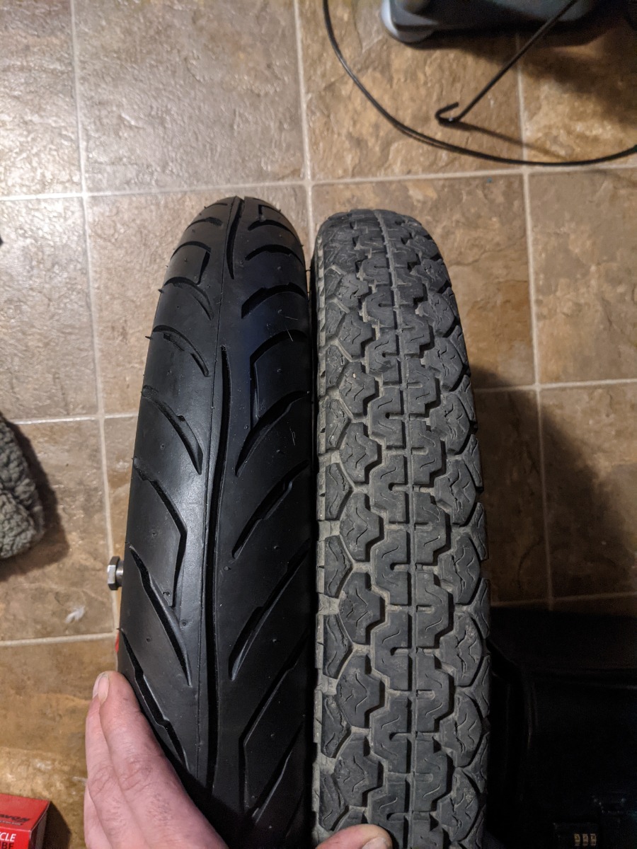

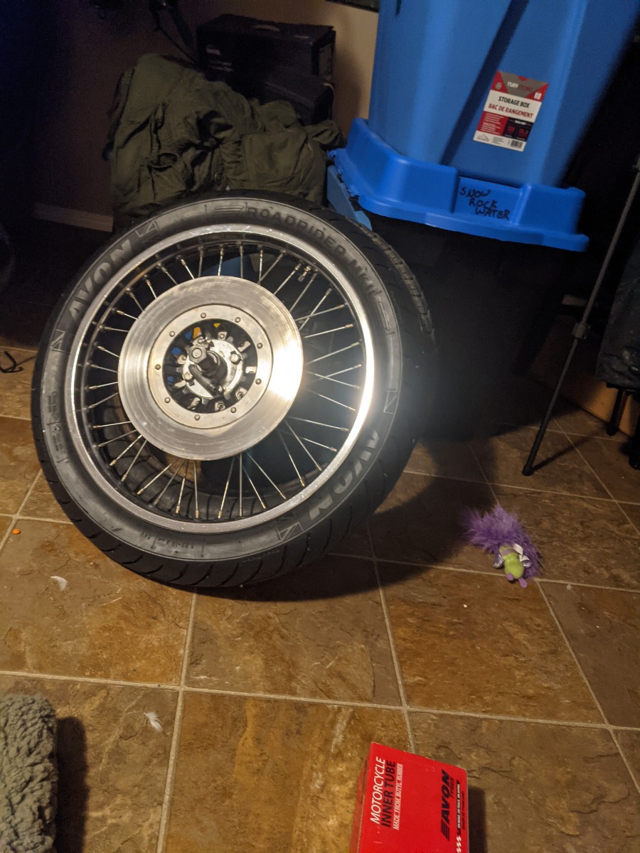

Brought the front wheel home the other day and got the new tire on. What a pain trying to get the new tub in on these!
Can't seem to get the bead to seat properly, so hopefully a hit of compressed air once I get it back to the shop will do the job.
We'll see how the rear goes with the rim locks. Allen Millyard makes it look easy, but he makes everything look easy.

Amen to Allen Millyard making things look easy, I watched the wheel lacing video more than a couple times. Just the tone of his voice puts me in a happy place. I'm definitely not a tire mounting expert, but a little air in the tube and some baby powder seems to ease the pain of installation. Getting the valve stem through the hole in the rim is the best fun!

That older tire looks like it's my age! (I'm retired, and so should that tire!!)

For what it worth. I have no experience trying, but I just had my rear tire swapped out, dealership mounted wrong tire. I had just watched Allen’s video about putting the rimlocks under the rim band. The dealership mechanic said only one rim lock can go under the band. Not sure why but he has been mounting tire for 30+ years

24 Feb 2021 14:12Mikaw wrote: For what it worth. I have no experience trying, but I just had my rear tire swapped out, dealership mounted wrong tire. I had just watched Allen’s video about putting the rimlocks under the rim band. The dealership mechanic said only one rim lock can go under the band. Not sure why but he has been mounting tire for 30+ years
Not sure why either. Just got the rear done, and both fit under there just fine.
Once again, the hardest and most frustrating part was getting the valve stem in it's hole.
The last 8 inches or so was quite a challenge too, but not horrible. Would have been easier with a third hand to keep the last bead lock in.
