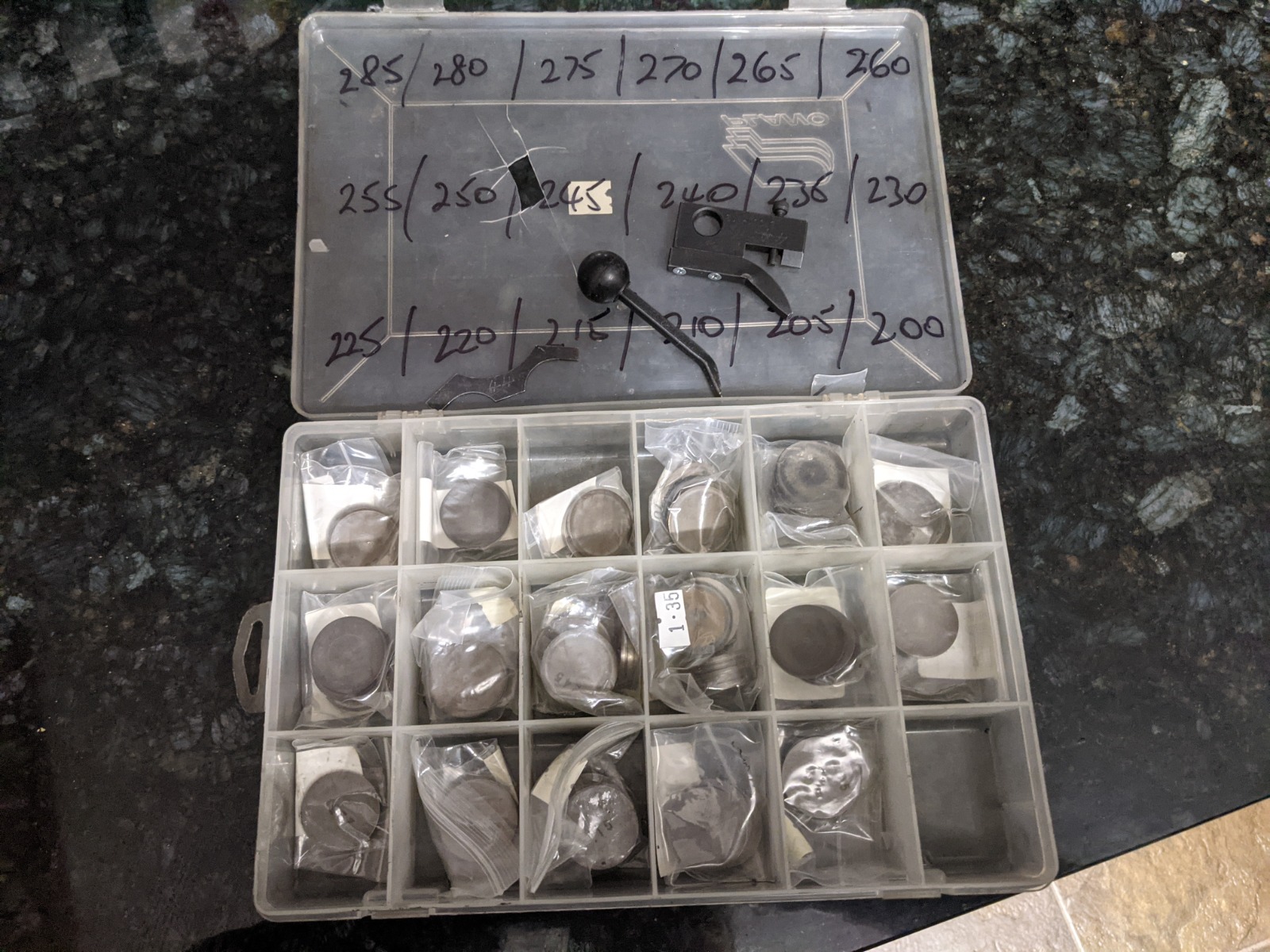

Valve shims showed up today. No one seemed to have kits online, so I turned to eBay, and got a pretty incredible deal from a shop that went out of business. Included shim tools. There's enough shims here that I could probably take out what I need with a few to spare, then turn around and resell the kit to recoup my money.
As great as it is that the shims are here, probably won't get after it for a bit. The big side of the shop is going to be getting the floor epoxied, so my side has just become temporary storage.

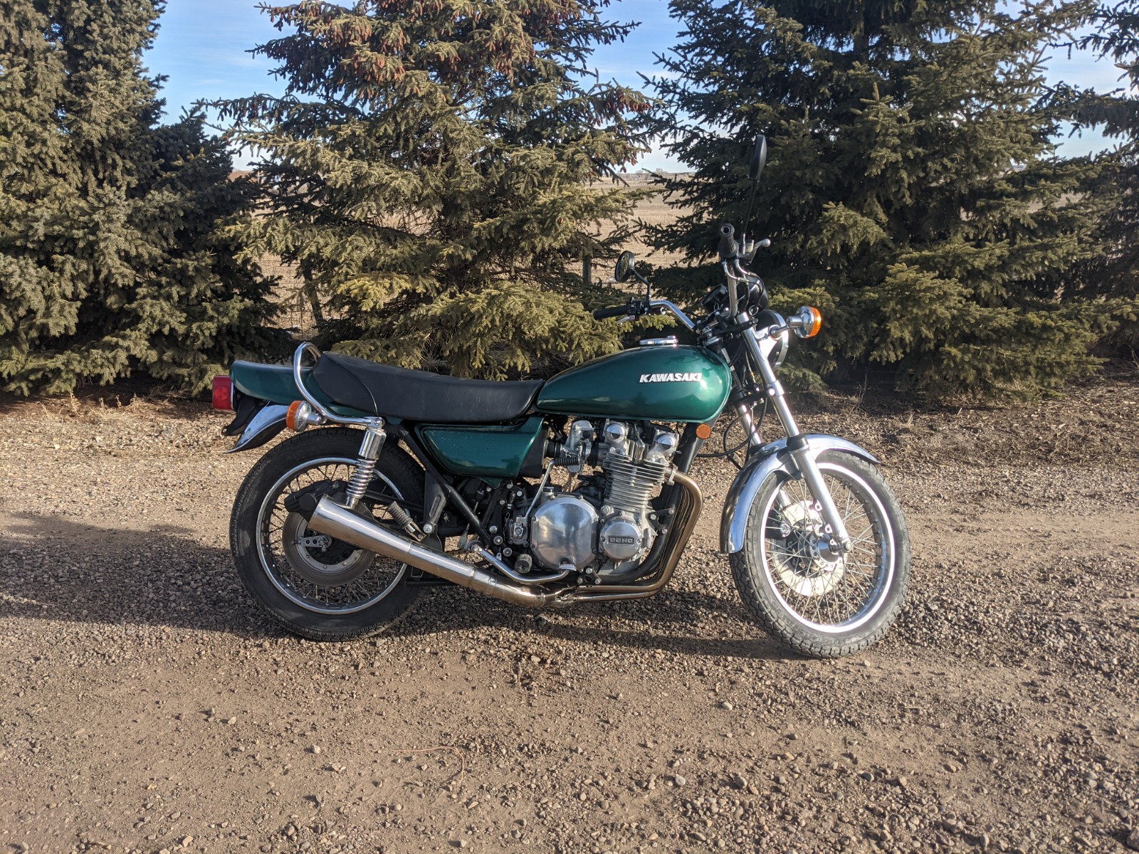

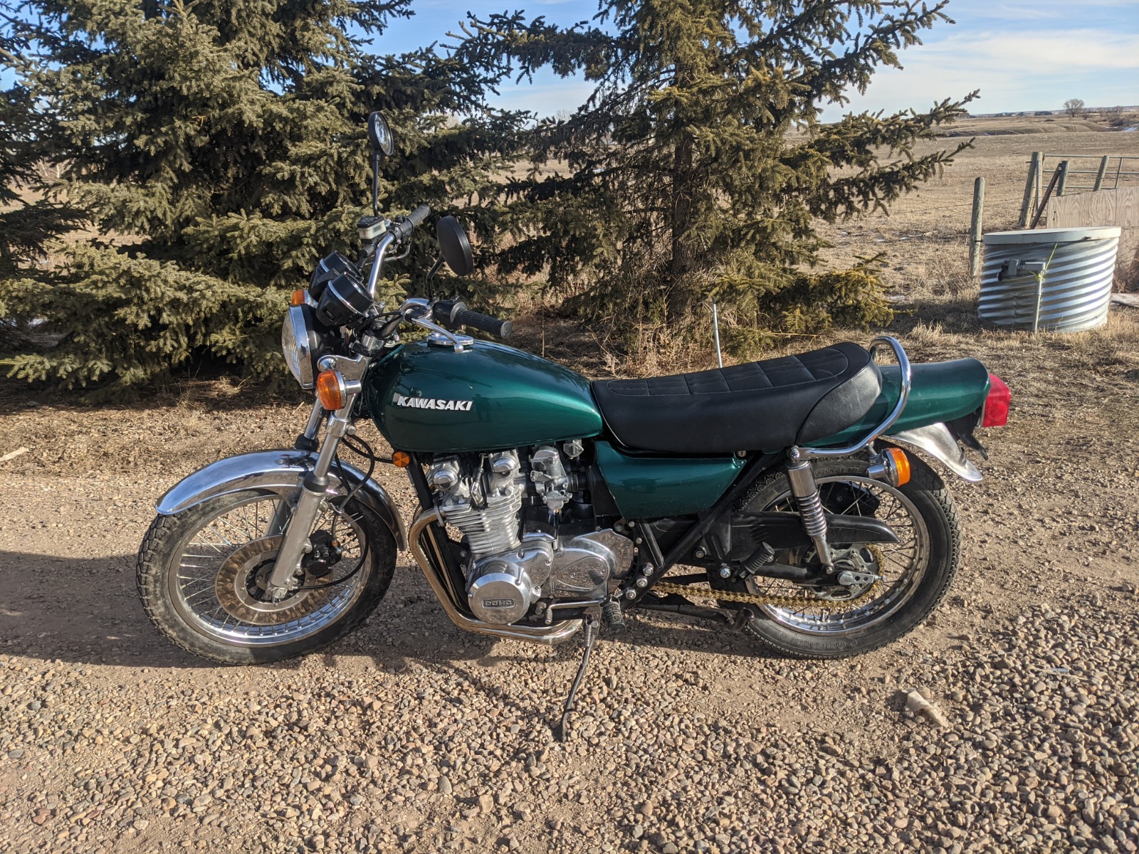

Managed to get in to the shop before it got filled up with stuff and get valve clearances done. That dealt with the issue of low compression on cylinder 3.
Also got the carbs reinstalled and got it back outside in the sun.

Re: 1978 KZ1000-A2 "Barn find"
31 Jan 2021 19:13
It’s come a long way. Great job.
01 Feb 2021 05:06
Delkevic sounds great. Sounds nicely tuned! Excellent accomplishment . Well done.
