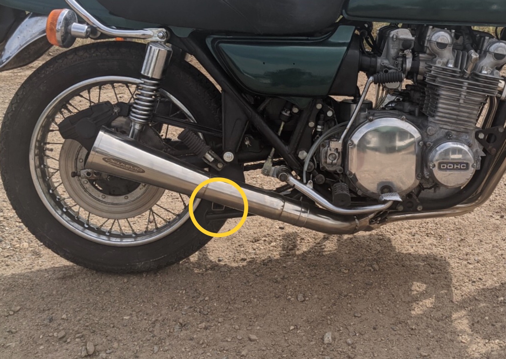

Here's some pictures of the exhaust for you Mikaw.

Thanks. I like the fit. Nice and tight to the frame. How was install? Easy? Hard?

Install was incredibly easy. Just have to make sure the downpipes are installed in the correct order. 4 & 1, attach collector, #3, #2.

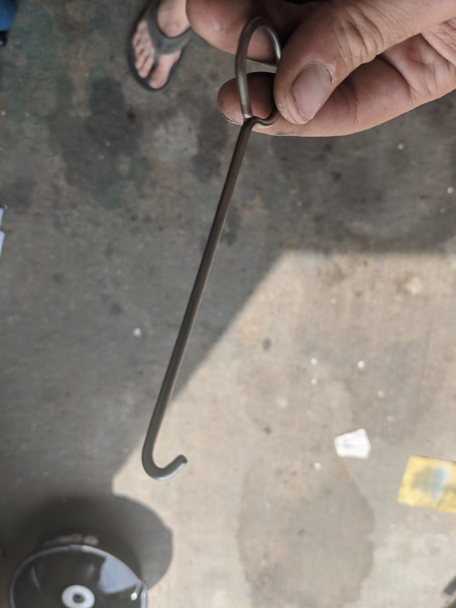

They even include a hook thing in the kit to help attach the springs that I got waaay too excited about.

You really have that machine cleaned up nice.
I didn’t expect to see a snubber for the center stand. See yellow circle.
