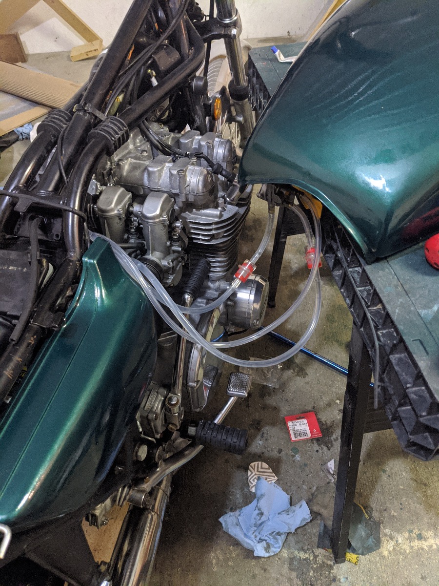

Finally figured out a few issues today. One of them is thatI’ve been chasing a rich condition on cylinder 3, causing it to take quite a while to warm up on that pipe. It was now even a visible issue, as that pipe wasn’t getting the golden colour of the other pipes.
The other issue, of course, was the fuel in the crankcase. Well, today I discovered that there was fuel in the vacuum line to the petcock. Probably would have been chasing my tail on this one for a while as I usually have a black vacuum line installed, but as I needed longer lines to keep the tank off, I happened to use some clear I had laying around.
So I took that hose off the petcock and plugged it, then ran the bike with what was already in the bowls and lines. Pipe 3 almost immediately started turning gold.
So I figure that was the cause of both a cold pipe, as well as the fuel filling the crankcase.

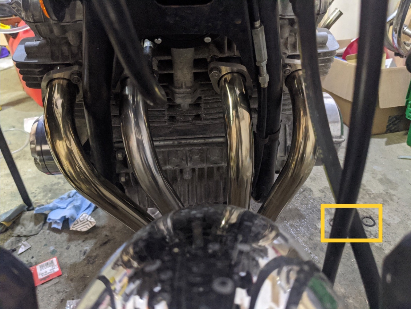

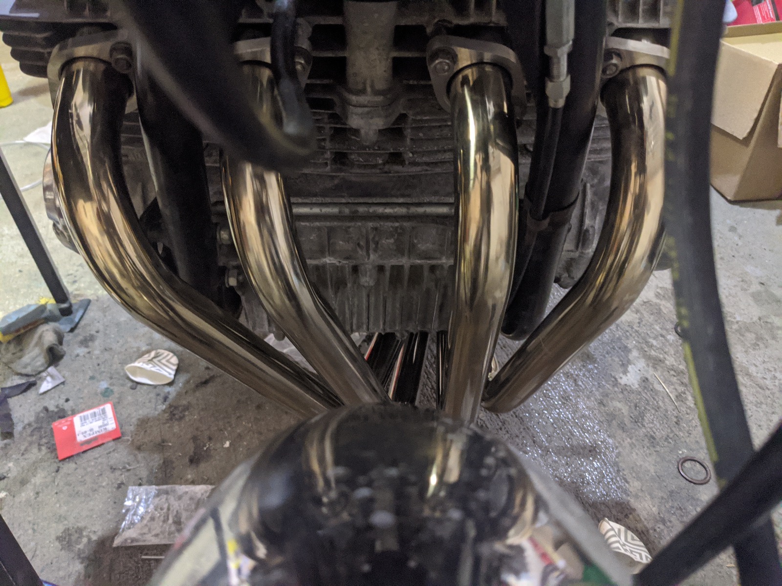

- Thanks: 1851
Re: 1978 KZ1000-A2 "Barn find"
19 Aug 2020 18:56
Not insinuating or trying to insult your skills, but these are the “old” exhaust gasket and you installed new ones right. See yellow square
