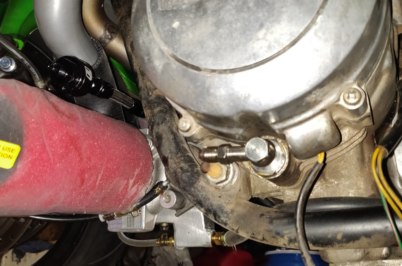

I sorted out the AN lines and fittings for the oil feed. It starts with a M18x1.5 to 4AN adapter i found on ebay. There is a matching M10x1 to 4AN adapter in the turbo. Between are a couple AN lines and a 44u turbosmart filter. I may rework this again as i dont like how far the AN elbow sticks out under the cover.... It'd be the first thing to hit if the bike ever falls.

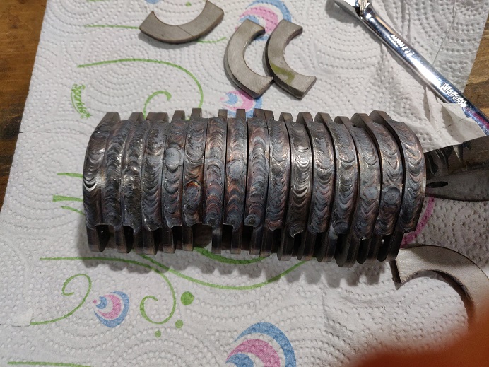

I welded up the oil cooler. If you remember... there were slots in the mount plates to weld the tubes behind them. It got messy due to the difference in the parts, so i ground it flush to hide my sins. :laugh:

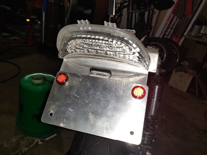

The next thing is the wiring. I started by installing a little license plate light.

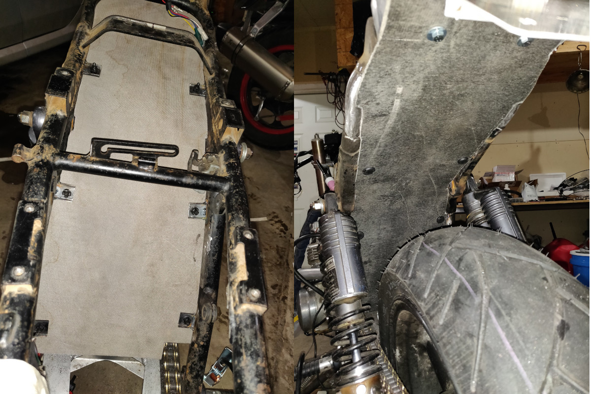

I finished up the rear fender. It looks pretty good from the outside

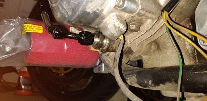

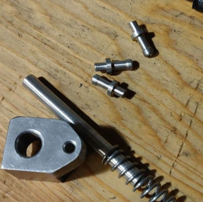

I played with one more turbo oil feed setup. Its a m18x1.5 to m10x1.0 bushing with a M10 to 4an banjo. This is lower profile but it would still get hit if the bike falls over..... So i'm keeping the old setup.
The turbo had to be pulled off to modify the internal wastegate. It opened at 20/25psi stock, so this spring lowers it down to 7psi.

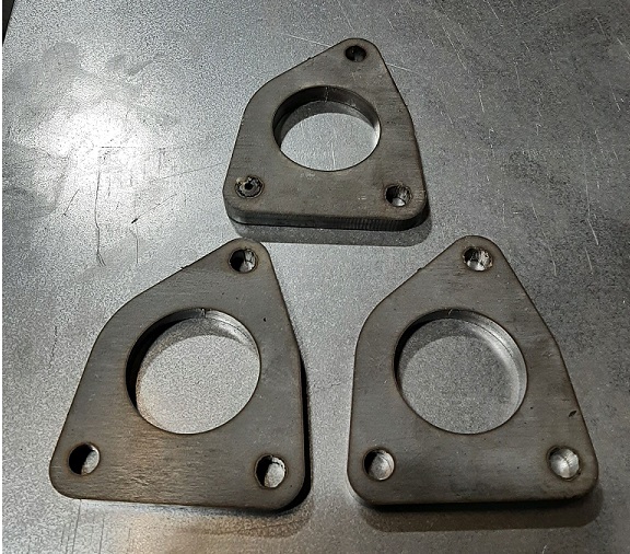

K1e lasered the rest of the flanges for me so i can finish the manifold. I also bought some 2" mandrel bends and perforated tubing so i can build a glasspack that sits under the oil pan.

Looking good Man. Your flanges are in the mail!

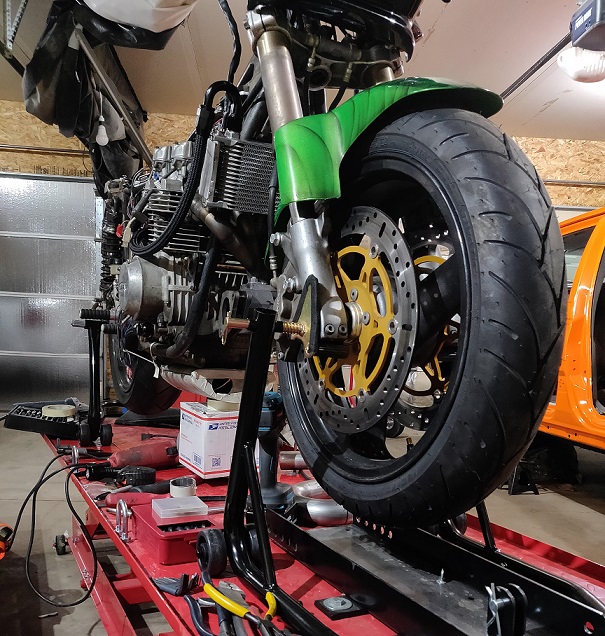

I've made more progress since the last update... The 810 motor still needs some work but I wanted to have adjustable cam gears before I dig into that. Ill be using a 750 intake cam with a 650 exhaust cam.

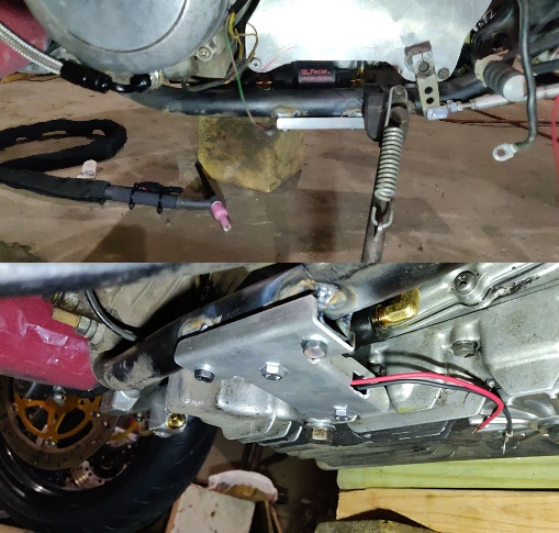

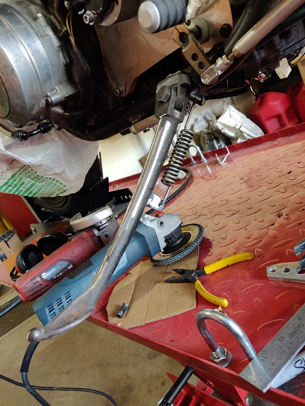

Fixed the kickstand so it doesnt hit the rear set during shifting:

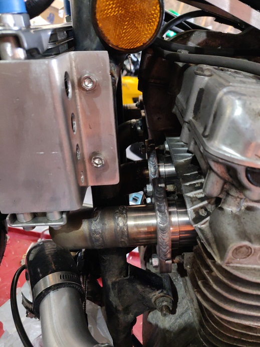

Welded the flanges k1e sent me (and used a jig this time so the SS cant warp... not playing games ). I should've used more shielding gas on these so no pretty colors

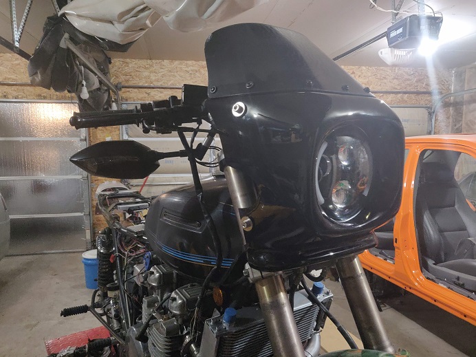

Made some proper brackets for the fairing:

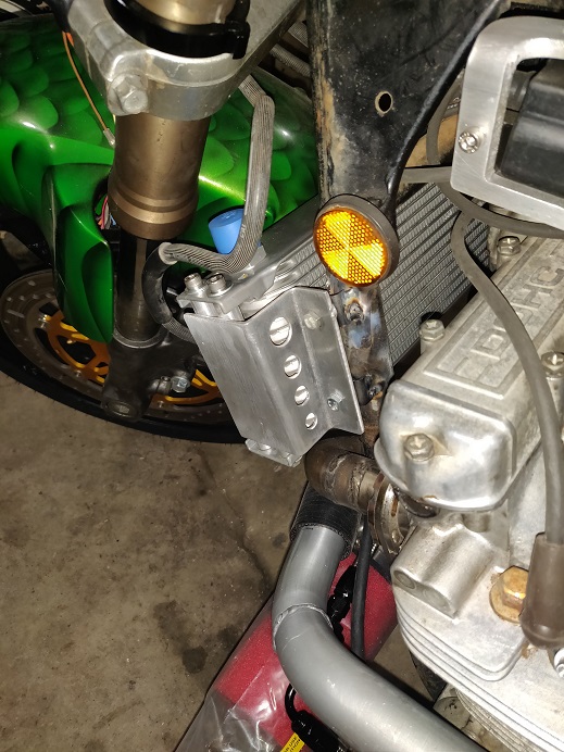

The oil cooling system is now plumbed up. This pan doesnt have the diverter plug like the 810 motor, but it doesn't matter for testing.

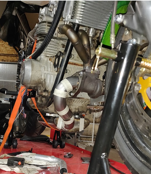

Next up is making an exhaust that'll look something like this. 2" from the turbo, then it splits to dual 1.5" side exits behind the foot pegs. This sits under the oil pan.

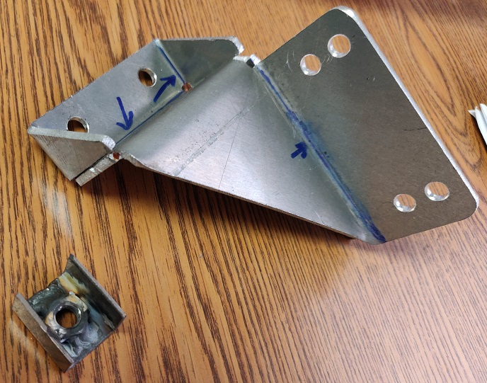

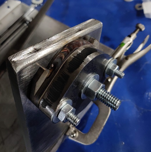

The bracket and nut thing for the oil thermostat mount

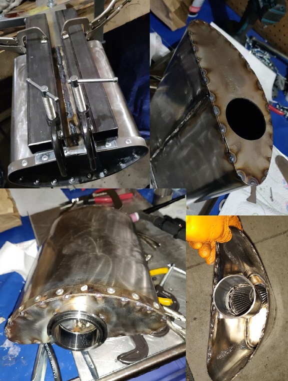

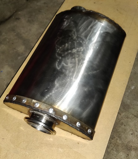

Finished up the glasspack this week. It went pretty well but i shouldve been more careful welding the shell seam. Still hate how much SS warps
Packed with fiberglass and ready for jigging under the motor. All the ugly stuff is hidden on the top of the muffler and everything else can be sanded smooth and polished in the end.

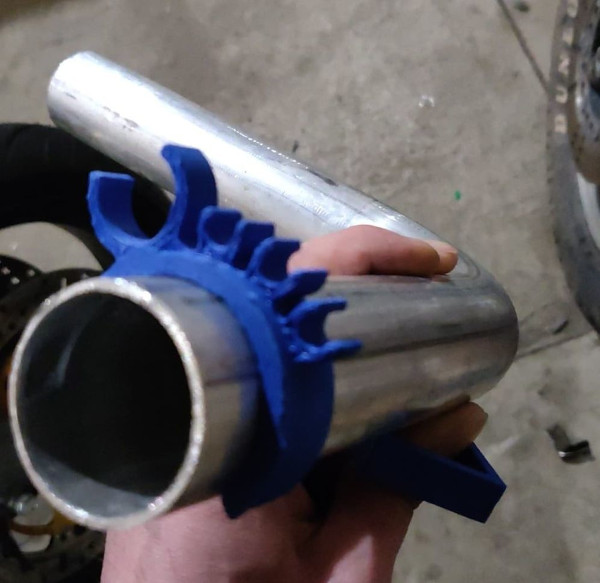

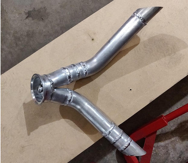

Made a die to form 1.5" tubing to fit the vband. I plan on using aluminum for the side exits as its lighter and i dont want to mount those to the frame.

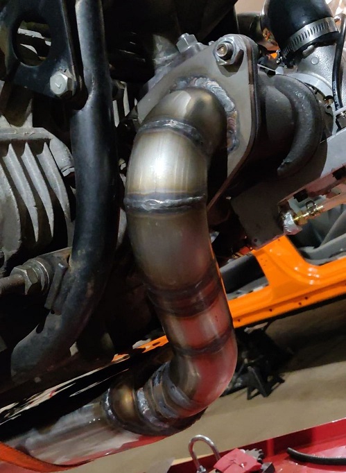

Welded the down pipe from the turbo to the glasspack.

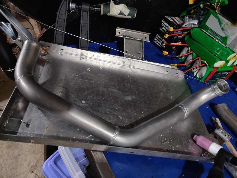

Welded the aluminum dual exit section
