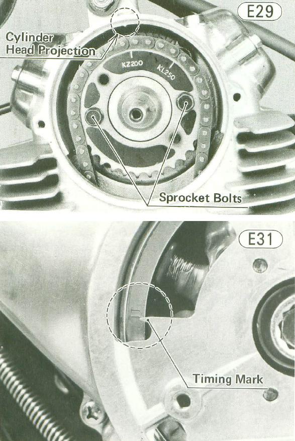

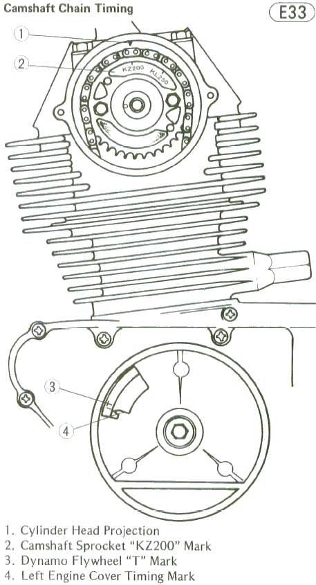

Did you remove the flywheel at any point? It is probably keyed to hold its position on the crank, but in case it moved, you will want to verify the pistons are at the top when the T mark lines up.
Here's what you should see for valve timing:

yep all that is correct. straight from the manual.
uhhh i think i missed that the advancer cam lobe could be installed backwards.... i wonder. I didnt take it apart on purpose it just sort of fell apart, i put it back together sans manual....in a split second...
im gonna be mad at myself lol.
i remember that part of the manual... skipped right over it lol got tunnelvision straight to "yep i ruined it" lol
makes sense though
"feels" like it has compression
doesnt fire, even with starting fluid.
timing marks, crank and cam sprocket all 100 lined up.
i did a points test last night... its opening when the crank is at f/ap mark.
I released some tension on the advancer, checked that it turns... that wasnt it.
plug checks out fine outside the cylinder.
anyone have a good initial carb setting? how many turns out etc?

yup thats what was stopping the party. take your time, and make sure the person who puts things on is the same person who took th em off lol
thank you @loudhvx
