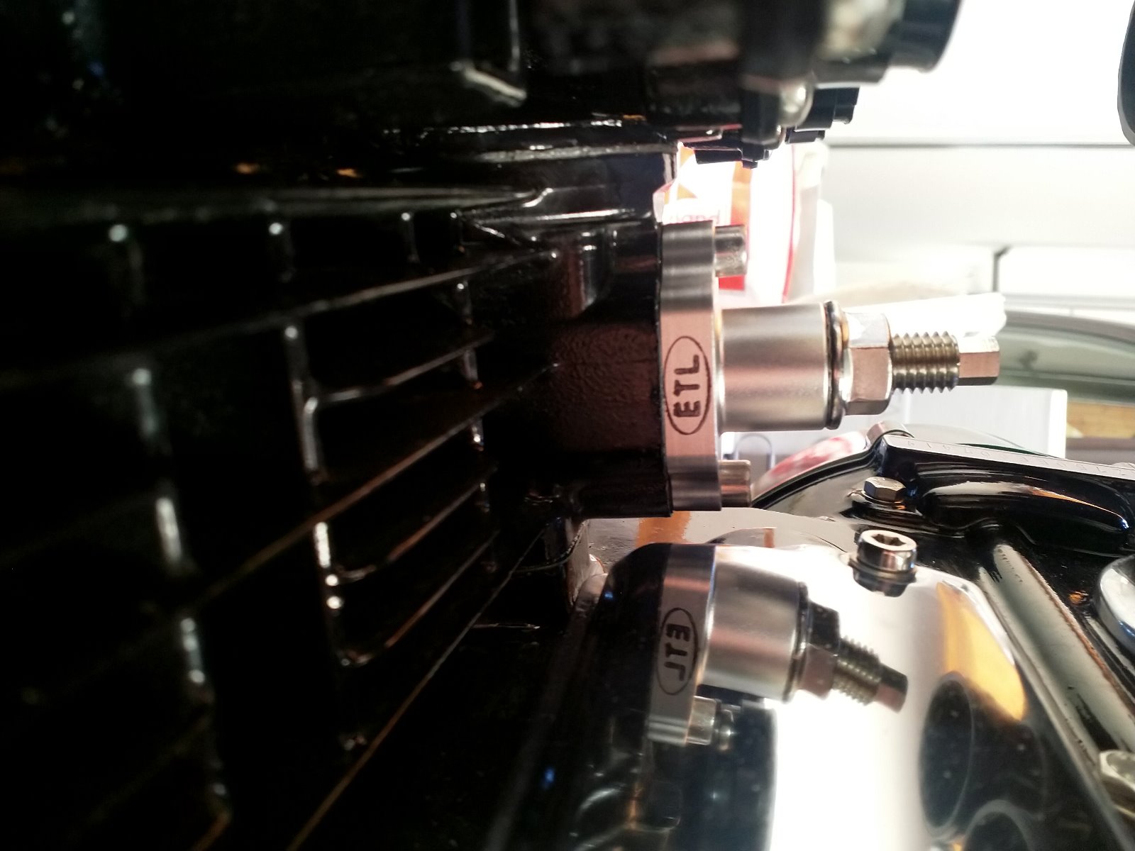

Fitted the new cam chain tensioner today. Waiting for new mounting bolts as the socket cap screws that came with it won't be any good with the sealing washer and the original bolts are too long.
Took the valve cover off and checked the valve clearance. seemed to have increased slightly in a couple of places. Took the cams off to adjust two of the shims and now I get to helicoil some more of the cam cap bolt threads. This will make it 7 of 16... figure I'll get through them all eventually. That's tomorrows job as they have closed the schools here until Easter. Still need to get some worksheets done for the kids but I can do it from home - so I'll have a bit more time for the bike over the next few weeks.
While I had the cover off I decided to measure the cam chain length. The manual says the limit is 128.9mm for a 20 link length. I measured 10 links and they were easily under 64.8mm (don't know what went on in my head - should have been 64.45mm). I'll measure it again tomorrow with both cams out so I can check the proper number of links.
