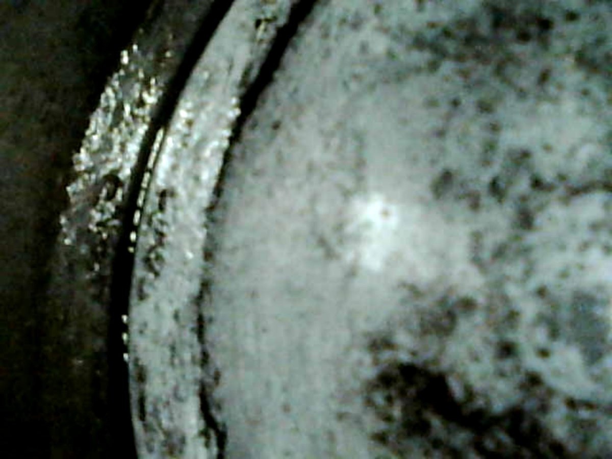

Had a look in the cylinders today - no debris so all good to start.
