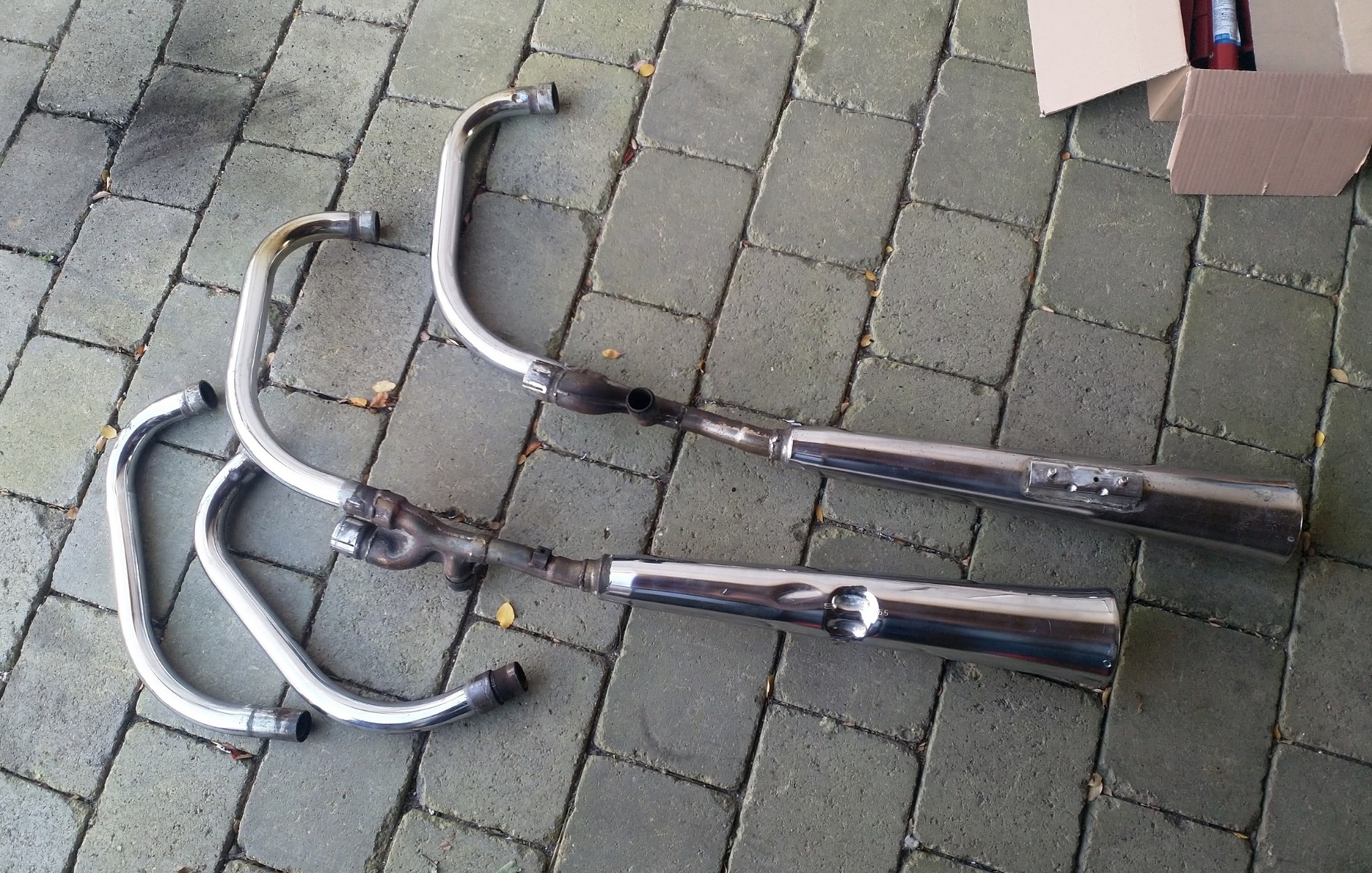

Found an original KZ750H exhaust for cheap:

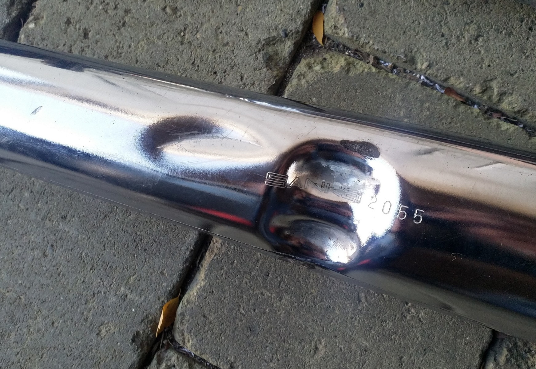

Only one significant dent in them:

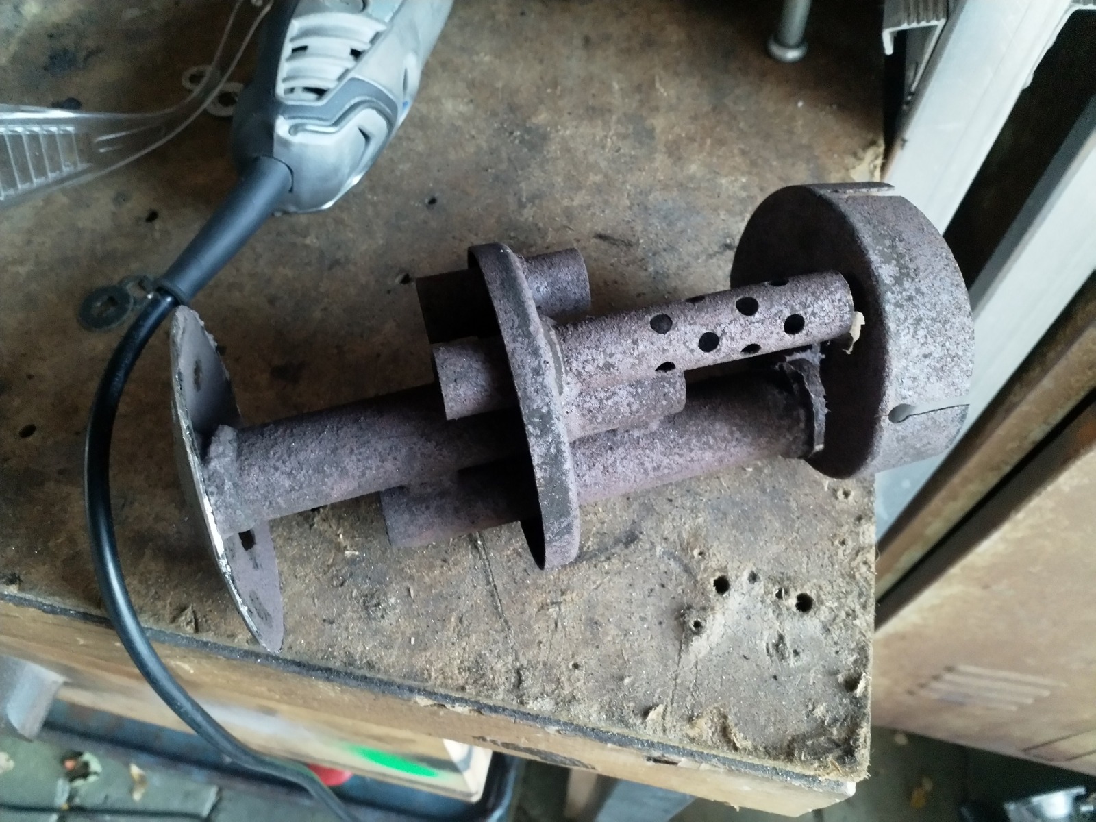

I pulled the baffles out and it looks like I'll be making some new ones this winter. Does anyone know of anywhere that does repro KZ baffles? Seems like it would be something a lot of people would need.
Anyway, now that the mufflers are empty I'm trying to find a place that will rechrome them. Wrote to a place in the UK earlier, still can't find anyone that does it in Germany. If it's too expensive I may just get them done with Cerakote chrome - doesn't really look like chrome but should still fit in OK with the rest of the bike.

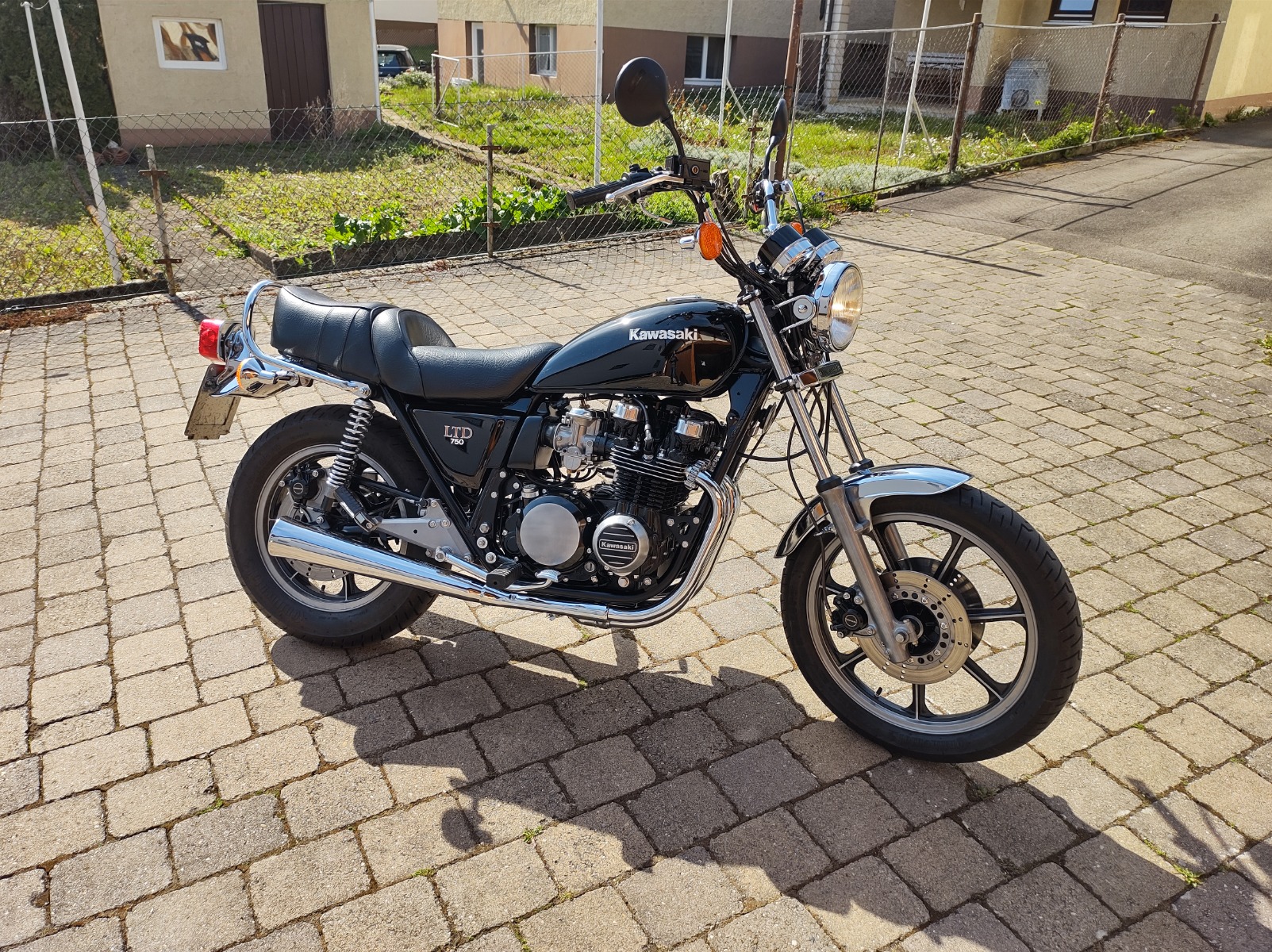

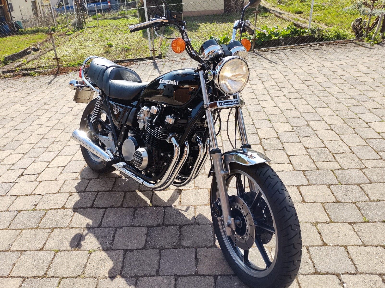

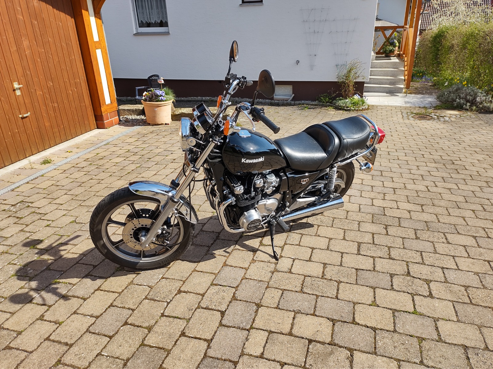

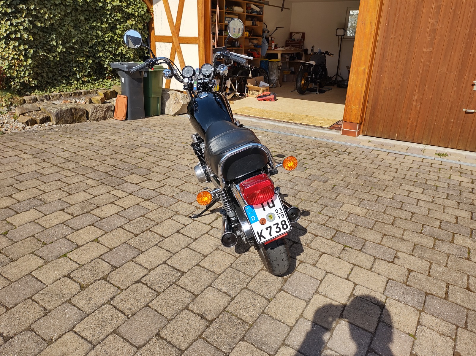

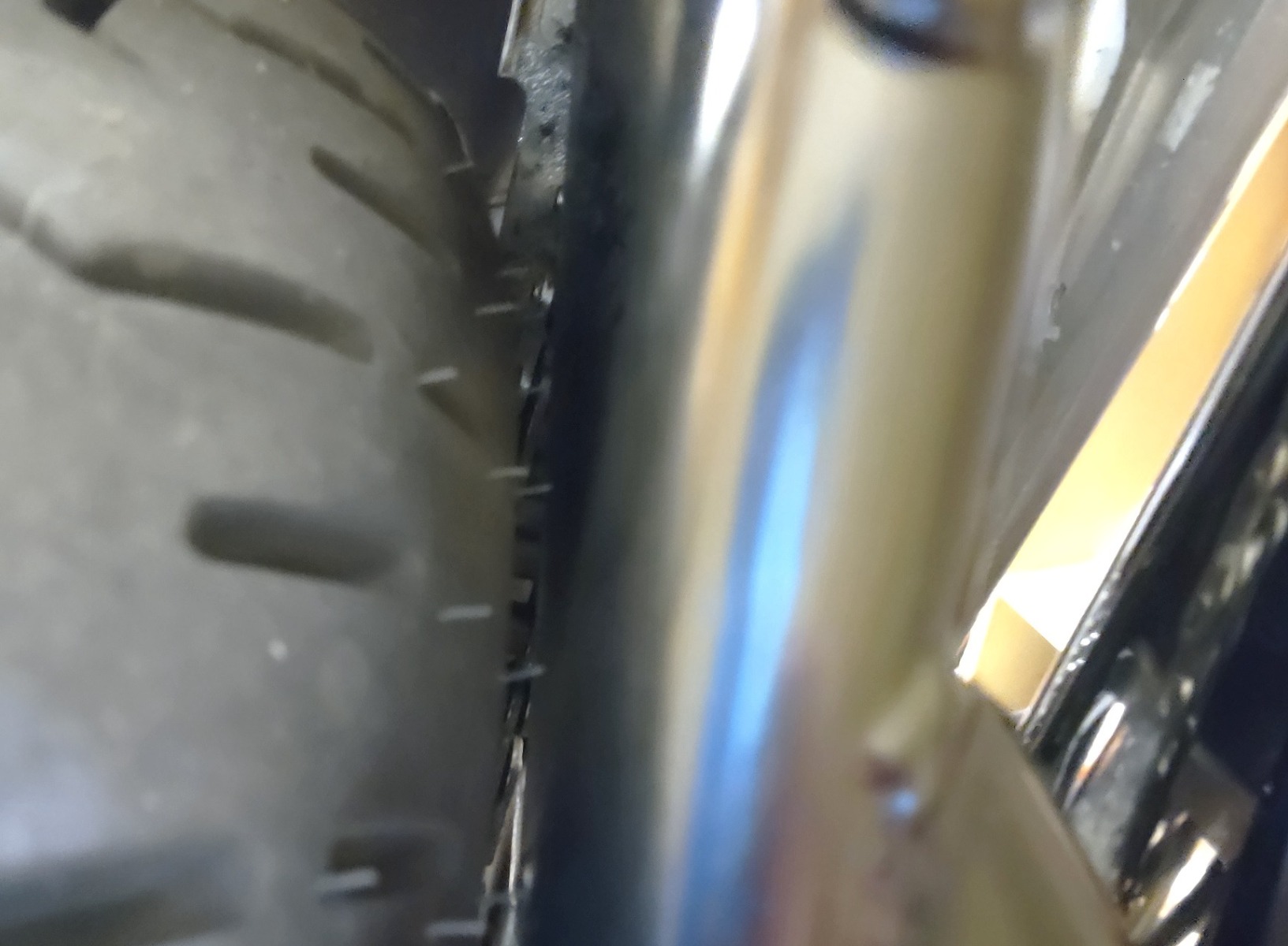

Finally got all the pieces of an original exhaust system together - put it on yesterday. The right hand side fits perfectly, the left side was a bit warped and the bracket wouldn't line up. I had to drill out the holes in the bracket from 8mm to about 12-14mm. Stuck some extra washers on and tightened eveything up from front to back. There was a lot of creaking going on, but I can undo the nuts on the exhaust studs and the flanges loosen up. This means that the exhaust ist tensioned between the head and the footrest bracket and there is no extra pressure on those tiny 6mm studs. I'm hoping that the heat cycles will get the exhaust to relax into the new position - we'll see when I have to take it off again

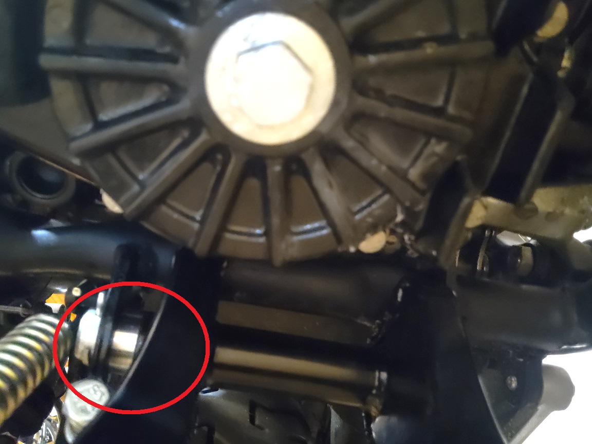

Speaking of removing the exhaust: I guess it has to come off if I want to do the chain tension. I can loosen the rear axle with a couple of spanners, but there's no way I'm getting it torqued up again with the exhaust on. How do you guys deal with this? I also can't use my rear paddock stand so I guess I need a centre stand.
Not really too worried, just makes some jobs a bit longer. There's no way it's coming off though, it looks so much better than the 4-1, it doesn't deafen me and the mid-range is awesome
(To be fair I never really put any effort into sorting out the mid-range on the 4-1)

Bike looks great with the stock pipes. So quiet too, so you can use lots of throttle without attracting attention.

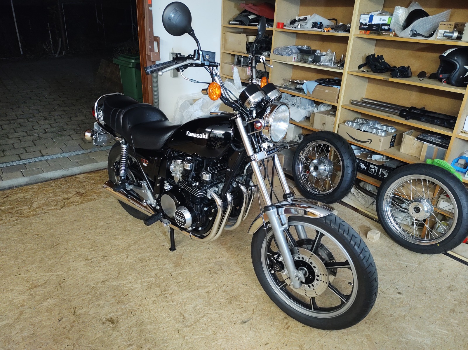

Just a quick update. Got the original carbs back on the bike - the ones that were giving me grief last year. Over winter I pulled them apart and did another round with the ultrasonic cleaner. This time I also used some carb spray to make sure all the passages were properly cleaned out. I need to do some fine tuning (idle jets and fast idle setting) but now they're running fine.
Also got the centre stand on so I can finally get the back wheel off the ground for maintenance. I had to weld some plates to the top of the stand so the back wheel cleared the ground - the brackets were a bit bent so the stand went too far forward and didn't hold the bike upright. After that was sorted and the stand was powder coated I put it on and realised that it hit the back tire when it was folded up. I only checked the ground clearance when the bike was on the stand and never realised that the mounts were twisted so the stand folded back and to the right. No way to get the mounts sorted out now and the bike is stable on the stand, so I just shortened the left side of the stand and put a spacer on the right. This shifted the whole stand far enough across to give me 2-3mm of clearance.
