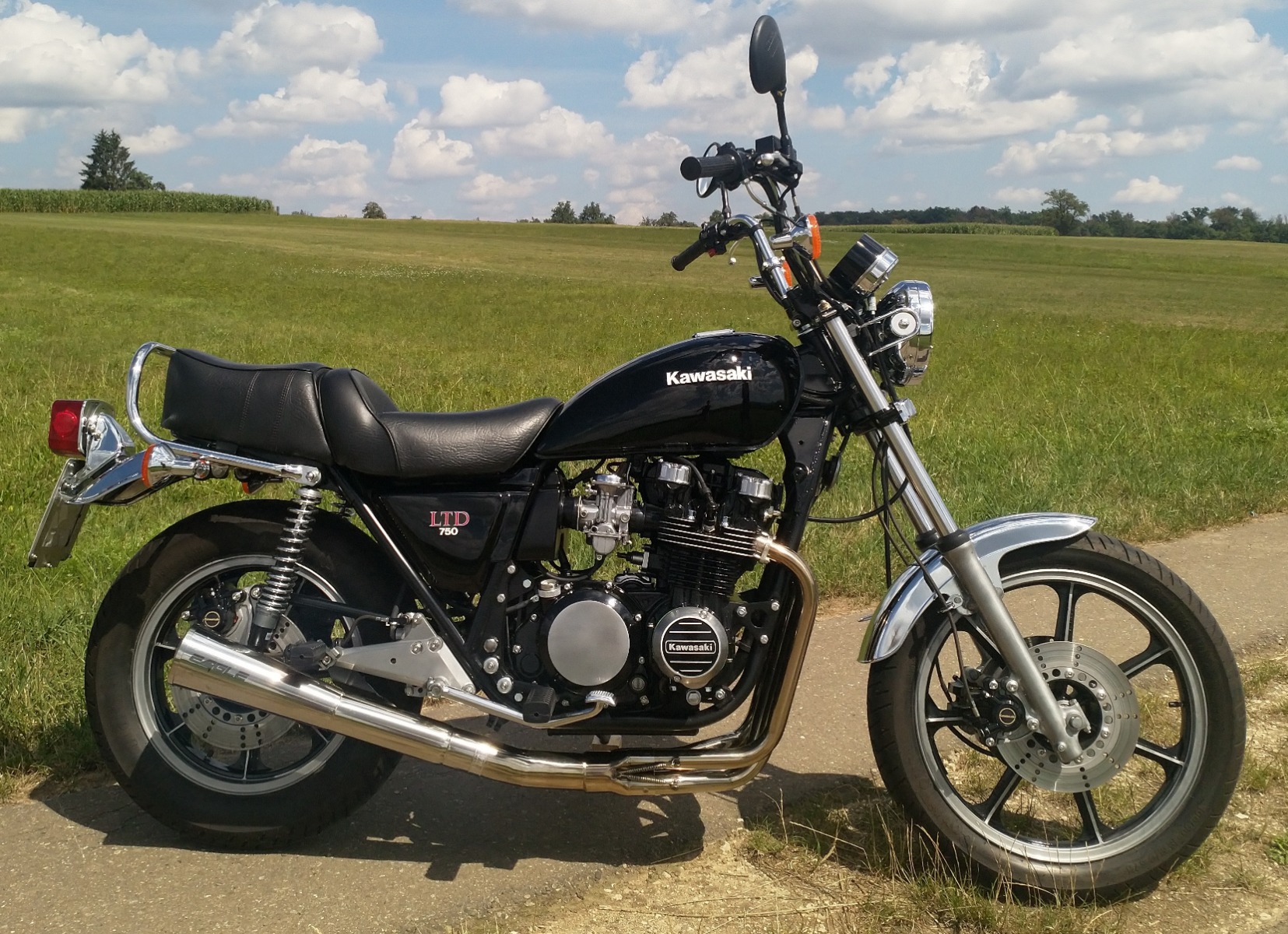

Went out for a final photo shoot before we went away on holiday.

30 Aug 2020 10:19 #834002 by kzstreetfighter71
Replied by kzstreetfighter71 on topic KZ750H Restoration
Thats a bike to be proud of, well done!

30 Aug 2020 12:41 #834011 by Mikaw
Replied by Mikaw on topic KZ750H Restoration
Wow. The side by side really shows how much work you did. Real nice
