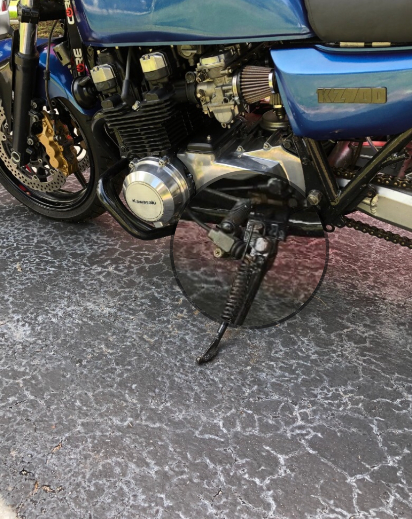

Thanks! I'm still trying to figure out how to mount a switch securely without drilling into the frame. I may end up using the automatic stand thing from Scirocco just to get through the MOT.

Thanks. Not sure he'd want to pull it off the bike, though
Got a new plate and spring for the side stand so it automatically retracts. Quick fix for the MOT so I don't rush anything and end up making a mess of the frame. I did see a picture of a 750 from Germany that had a switch mounted behind the footrest , that's probably the way I'll go.

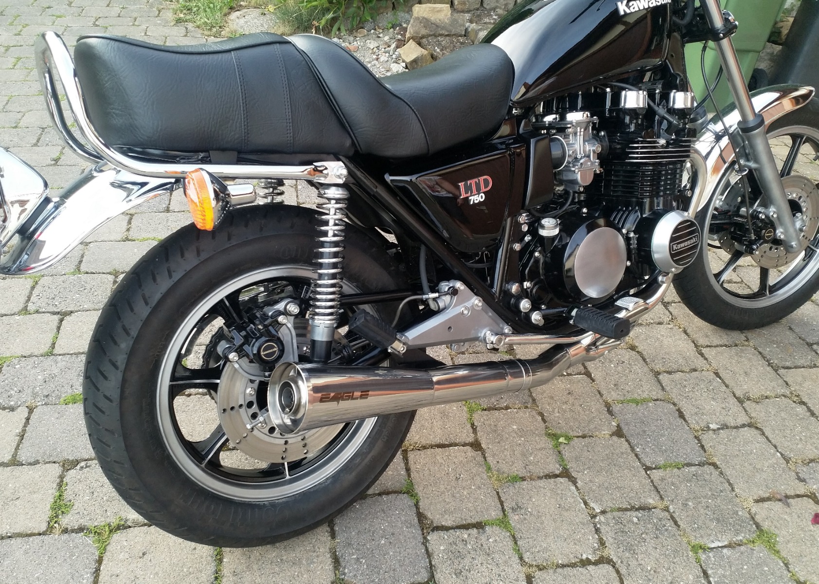

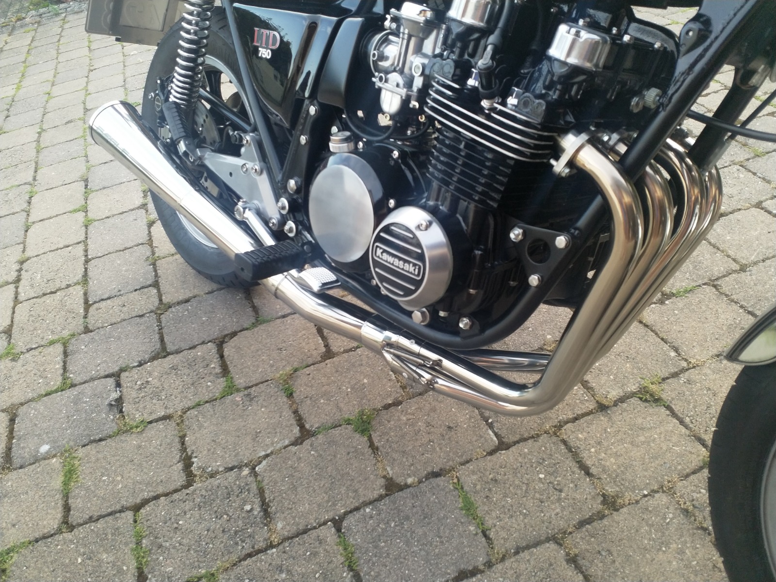

After four weeks of waiting my exhaust arrived today. Seems SpeedPro have swapped suppliers for their Eagle exhausts. They used to get Vance & Hines systems approved for street use, then just slap their logo on it. It seems they are now using Delkevic! So I now have a street approved Delkevic with the megaphone silencer. Basically cost me the same as a new system from Delkevic plus the cost of the noise tests so I guess it’s OK, can’t help feeling I would have preferred the V & H though. Still, the bike is ready for testing once more and there won't be any drama with the exhaust. And it still looks really good
I started her up and was happy to hear that the megaphone is a bit deeper than the straight muffler - makes it a bit more of a growl and less of a scream at high revs. Should be easier on the ears. If not, the middle of the two baffles can be wrapped to quieten things down a bit.

So, after a couple of months dealing with German bureaucracy I have finally got my bike registered!
The guy at the testing station still wasn't too happy with the noise levels, but he let it go through anyway as the silencer is approved for street use - he just said I may have problems if I ever get stopped by the cops.
I decided to wrap the inner baffle and see if that helped with the noise. It did and the bike even seemed to pull a bit better down low. At WOT, however, it was awful. It just wouldn't pull. After a test run I ended up with some of the fibreglass wrap hanging out the end of the exhaust - I guess I restricted the flow a bit too much :laugh:
I pulled all the wrap out and went for my first proper ride. The noise is fine. I could be an a**hole and open up the throttle in town, but if I just ride normally it's absolutely fine (no heads turned when riding through the small towns around here).
The bike runs well and it was a lot of fun to just cruise around on. I'm calling this one finished now
