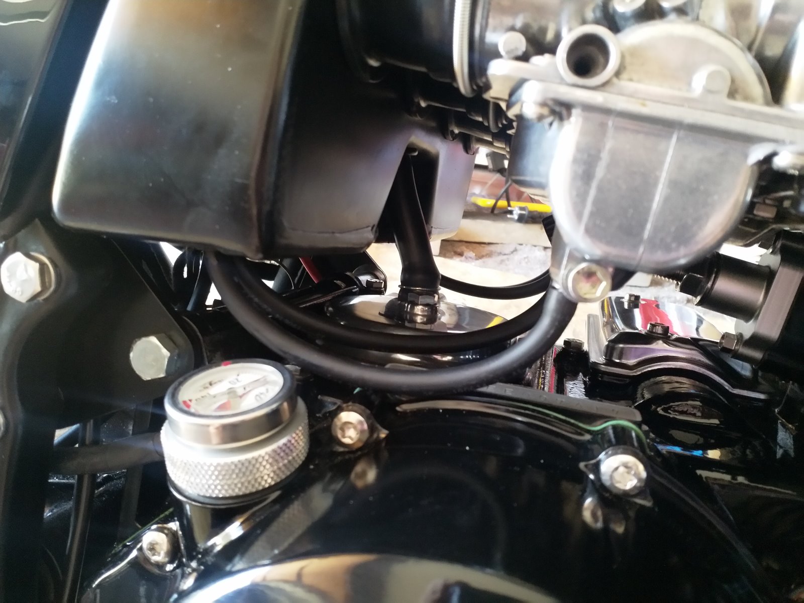

First thing I did this morning and it answered a load of questions! It always felt like idling at 1500 rpm was the sweet spot, it just didn't seem to idle well below that. Hooked up the digital tach today and look at that, 1500 rpm is more like 1150-1200! Still a bit higher that the manual, but an idle speed of 1100-1200 instead of 1000-1100 is fine, whereas 1500 was really bothering me.
After that, I resynced at the new idle speed. Still a bit of variance on the sync gauges when revving, but nothing major. I let her cool down, then retorqued the cylinder head nuts. I also cleaned the plugs as I'm not doing anything more until after I've put a few hundred mile on her.
Final bit of work was the overflow tubes for the carbs. They go to the air box and I routed the airbox drain tube down the swing arm so anything that comes out should miss the rear tire, exhaust and brake disc.

17 May 2020 11:53 - 17 May 2020 11:55Skidmark wrote: Get yourself a pair of "flush cut" dykes or wire cutters. They are beveled on one side only, and will trim zip ties flush to the housing. No more scratches or cut arms from those sharp tangs hanging off your zip ties. Not that I notice the little things...
Ha :laugh: I hear you - I actually left them like that on purpose so it's easier to get them back on - they're removable zip ties. I may put some permanent ones on but I don't have any wide ones lying around.
Edit: I will be turning the one in the picture around though
