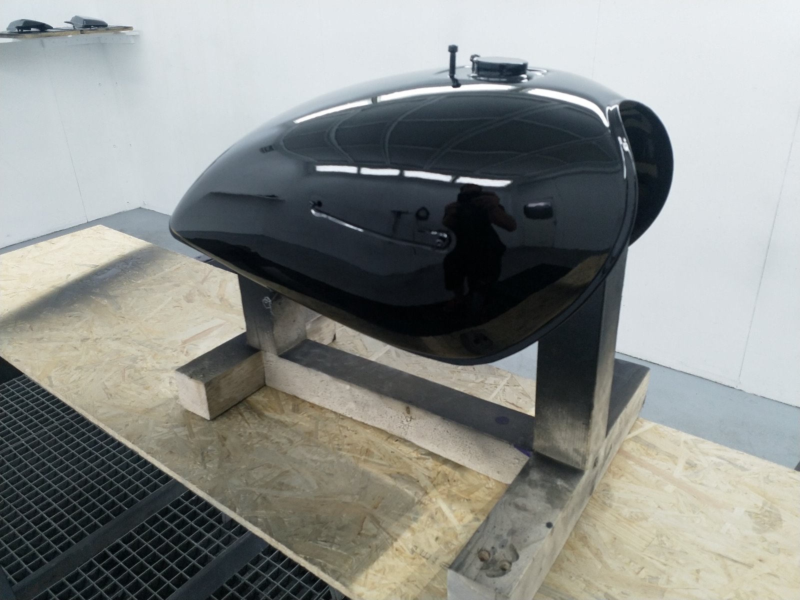

Last piece of the puzzle done today: painted the tank and side covers. The room I have been using wasn't available so I rented a room for a couple of hours.
The results are a lot better than I could have got in the other room. The lighting alone made a huge difference, not to mention the ventilation and heating system. You can see that I didn't quite get the lines right with the bog on the right hand side of the tank (look at the reflections), but it's good enough considering what it looked like after sandblasting.
Everything is safe back in the garage now (stressful drive home). Will leave it for a couple of days before I put the cap, petcock, etc. on.

I'm impressed! I have never tried painting with the exception of rattle cans. Great job!

Thanks. To be honest, using a spray gun is so much more forgiving than a rattle can. I really struggle spraying with a can but using the gun I have only had two runs on all of the parts for this bike. I hadn't done much painting before this project - just the brake callipers and an engine cover on the hornet.
I find painting a lot easier to deal with than polishing - that may have something to do with patience though

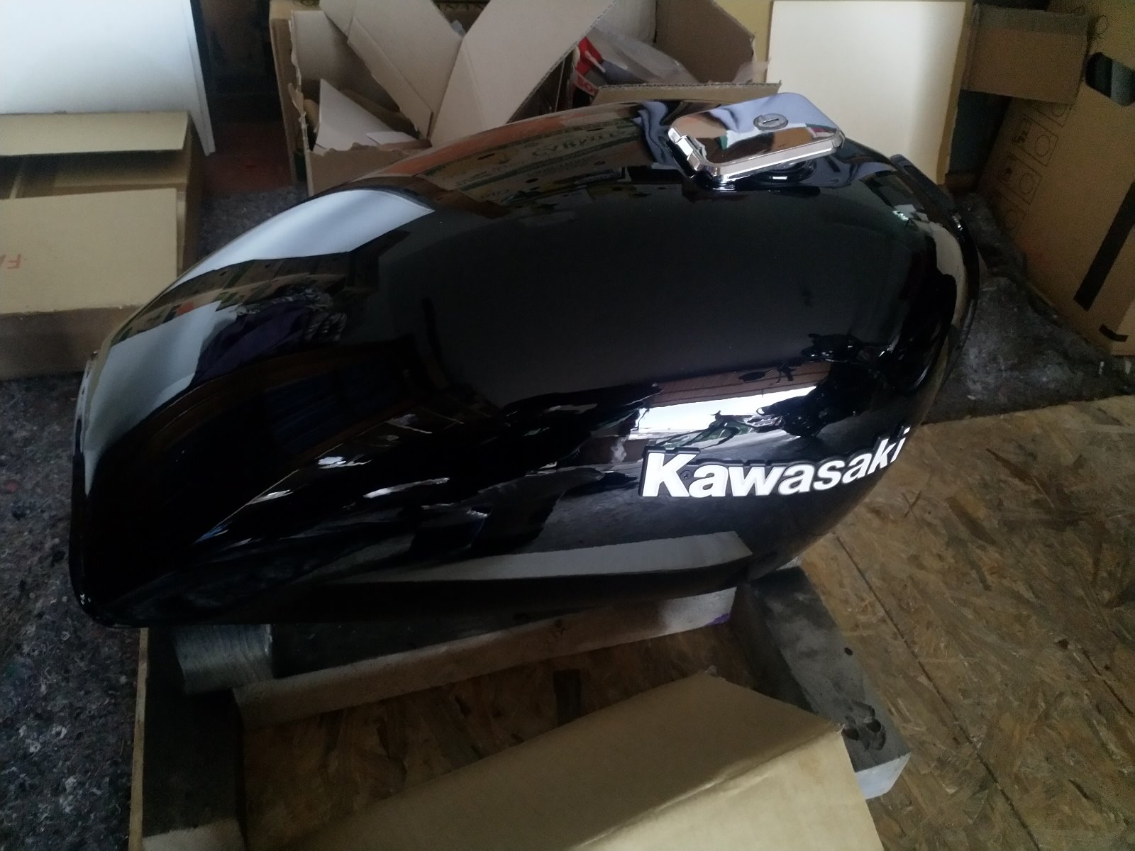

Couldn't resist today - I very carefully put the badges on the side covers and tank. They're back off the tank (as is the cap) until I put it on the bike, but the side covers are staying on.
Paint is pretty close to fully hardened and should be fine on Sunday - supposed to be fuel proof after 5 days so should be pretty good after 3. I'll be putting the tank on the bike on Sunday as it will be a year to the day since I pulled up on the bike. I won't put any fuel in the tank til later in the week, though. Not taking any chances

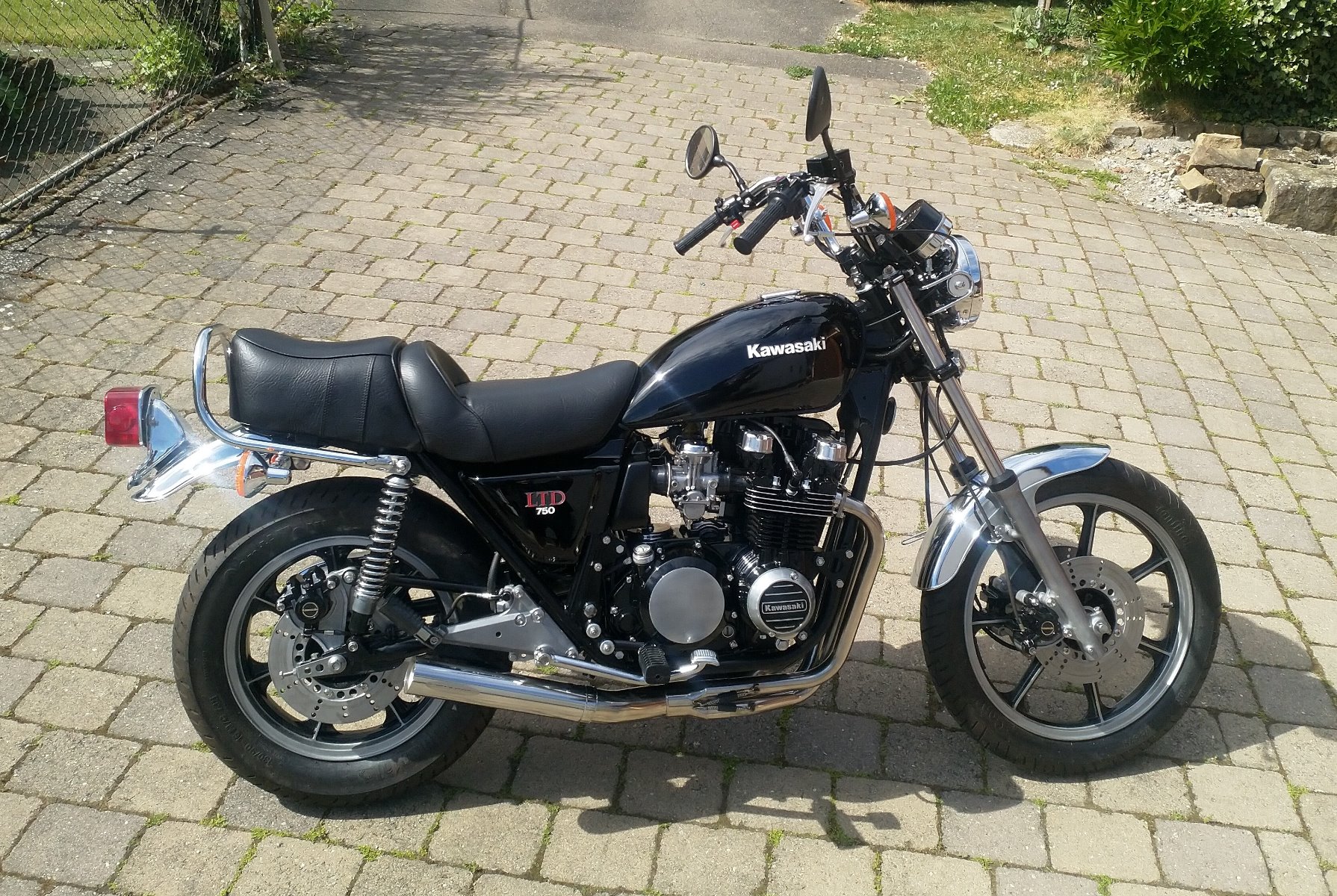

A year to the day since I bought the bike home. Need to wait a few more days before putting fuel in the tank, but all the resto work is done.
