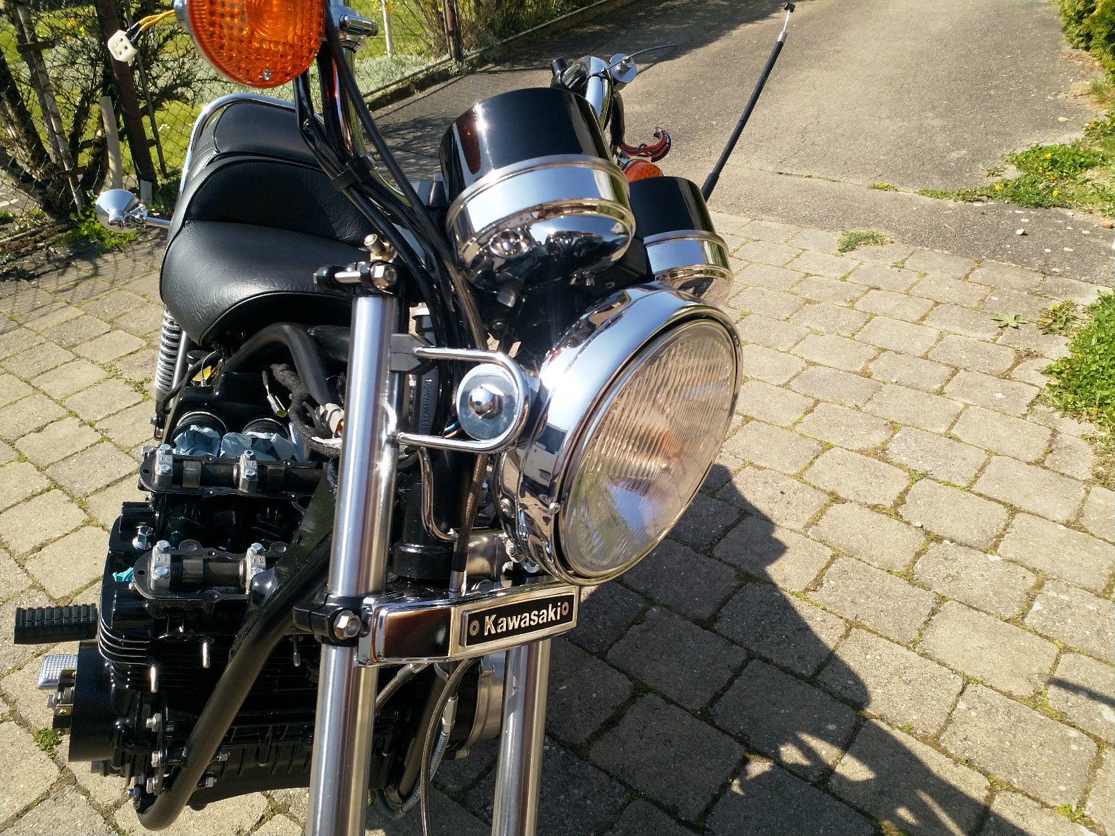

Got the front end done today. Finished off the wiring in the headlight so the electrics are done (except for replacing the connector on the low fuel sensor.
Got the front seat on as well. Even looks pretty tidy under the seat

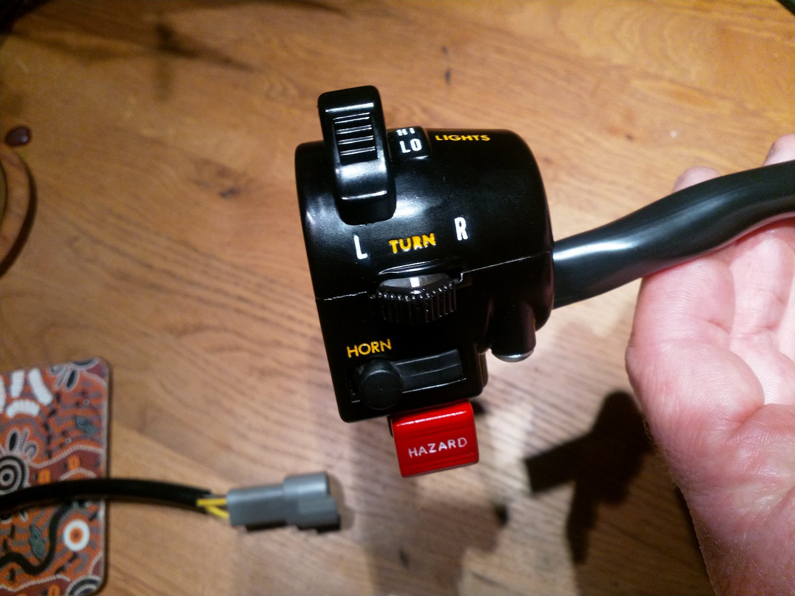

Got the switch blocks back together. Had them on the bike but was being so careful not to chip the paint that I squashed two wires (one on each side) with the plates that are used to hold them in place. Was wondering why fuses kept blowing :pinch:
Ended up getting the soldering iron out to detach the two wires so I could slip some heat shrink over them - not resorting to insulation tape yet!
All back together minus the plate holding the lighting wires in place as it doesn't seem to fit right on the new housing. The housing is from a German model without the reserve lighting device so two less wires running to the hi/lo beam switch. Will still be OK, just have to be a bit more careful when putting them on.
