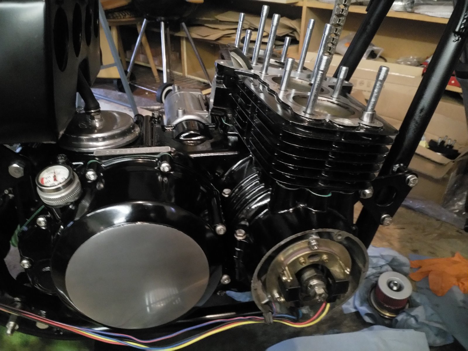

Thinking about the state of the engine studs and I'm wondering whether the long one is actually the right height and someone has been cleaning the others out with a tap and gone too deep. Does anyone know what the stud height should be? I can't find it in the manual. Alternatively it would be nice to know how many threads I should see sticking out above the washers at the top (a photo would be fine). The threads on the long one start at about the same height as the washer.
The lack of experience is pretty obvious now
kicking myself for not checking the height before I took the studs out - I just assumed they'd all be bottomed out.

Yeah, it was really doing my head in until I just got an e-mail from the old man. He suggested that someone may have broken/buggered a stud and just used whatever was lying around from another bike. Then I looked at the photo of the studs after getting them plated
Look at the stud on the far left - I don't think it would have stretched that much :ohmy:
I do wonder if it is supposed to go in the front left hole. If you look at the photo above the front left stud looks shorter than the right hand studs. Almost looks like I could swap the left hand studs around and they'd be the same length... Hard to tell from the photo though, will have to take the nuts off again and check the thread height.
