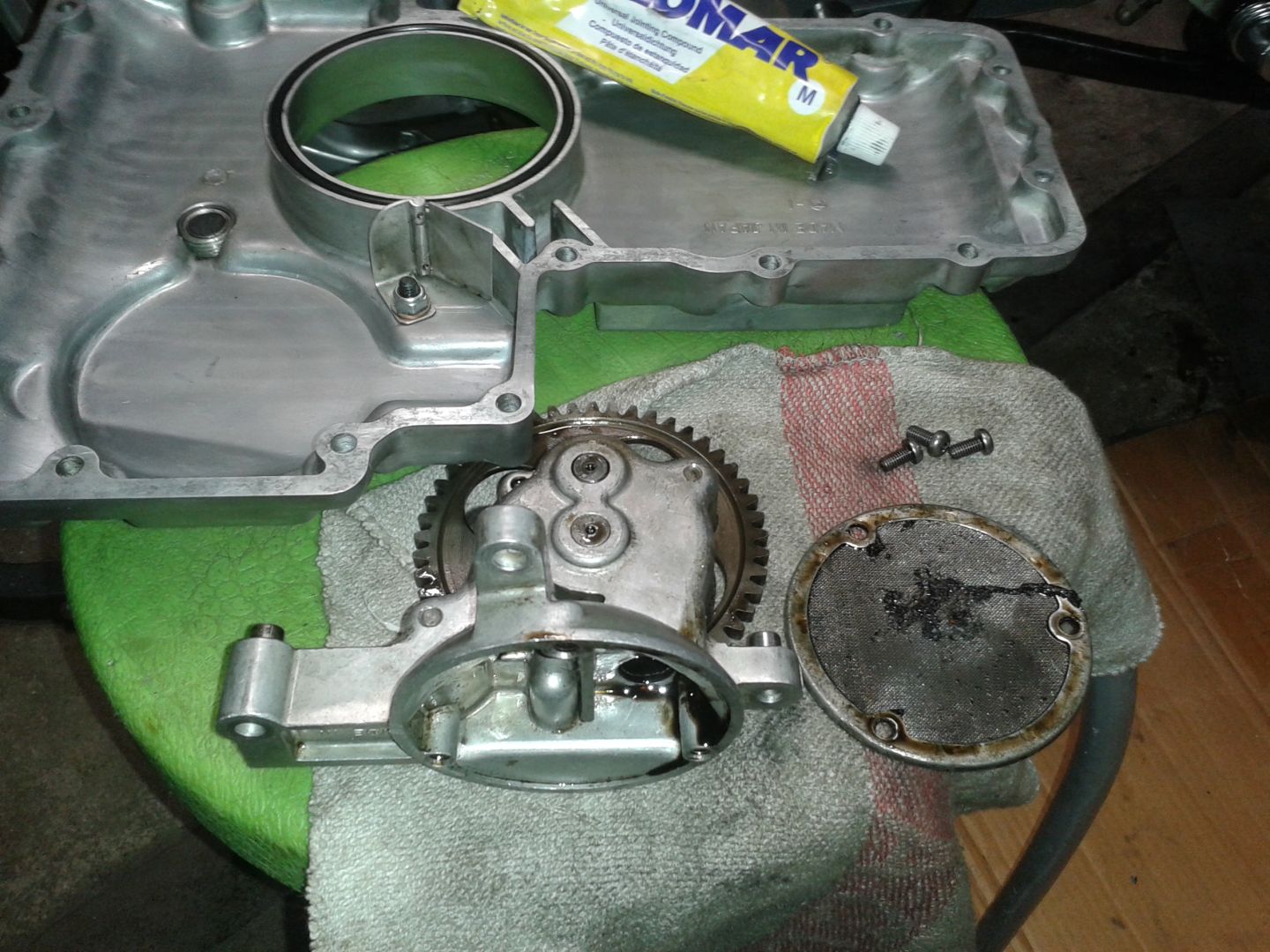

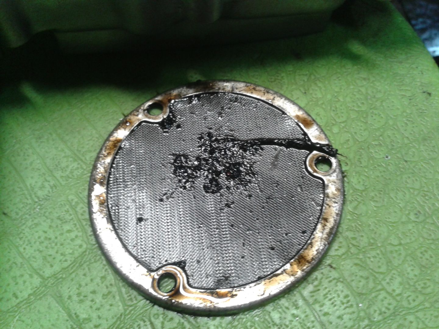

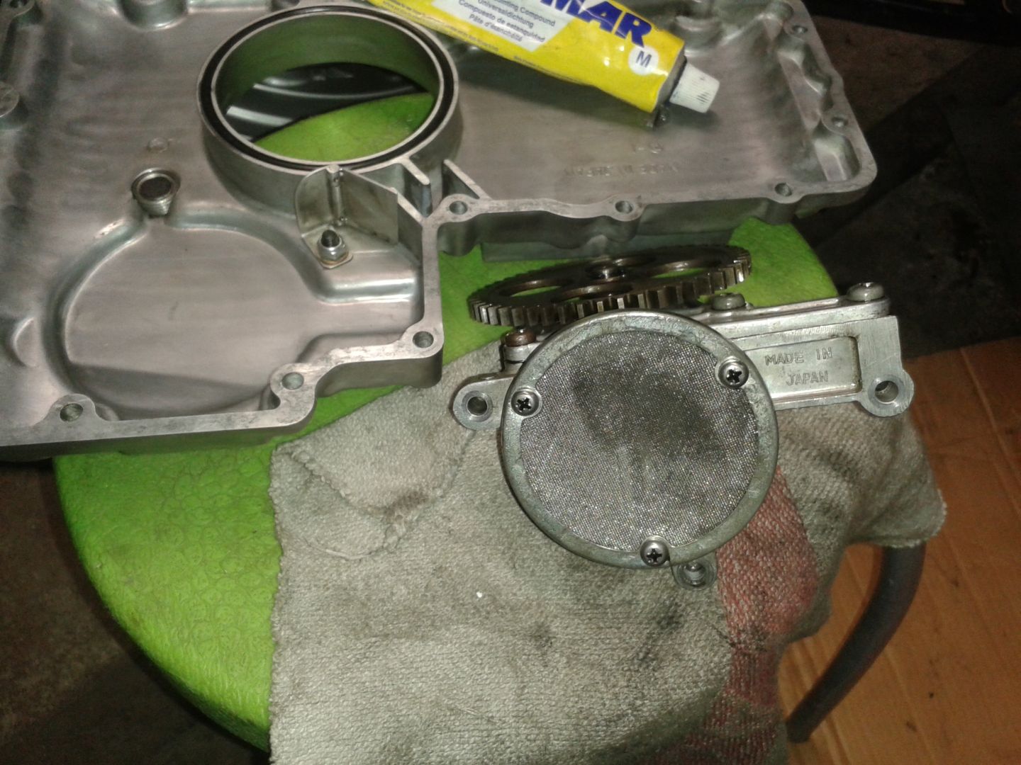

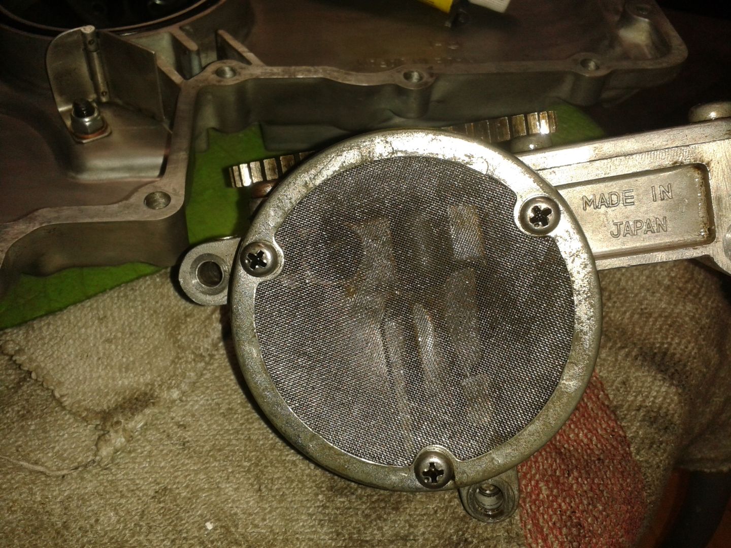

Hey, might be a silly question but would you guys rather get the bike started on potentially 2 year old oil to get it warm and easy to change? Or would you change it cold and maybe do another oil change in a closer interval to really get all the old stuff out?
'77 KZ650B1 in progress...
Re: 77 KZ650B Restoration/Build
25 Oct 2019 10:20
I would drain the oil cold and remove the oil pan. Give the oil pump filter screen and oil pan a good clean.
