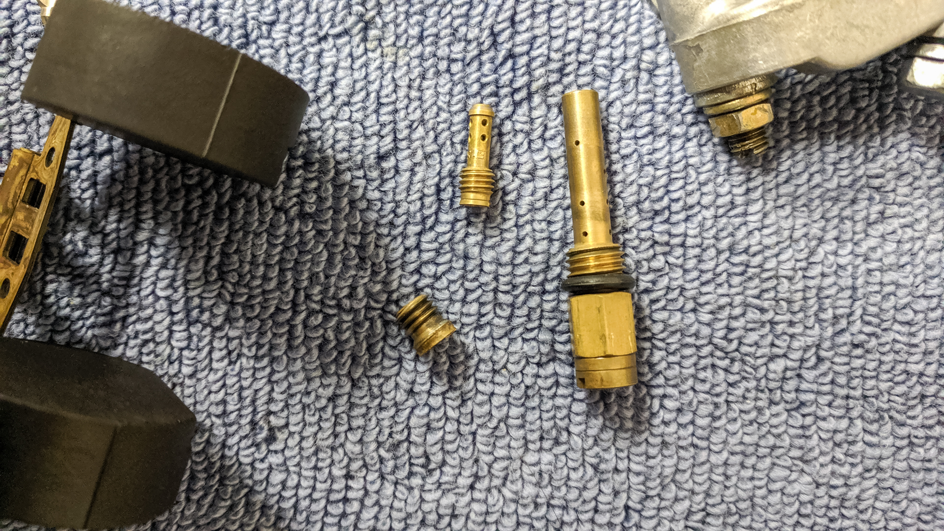

These are my jets:
3. The how-to video I was watching didn't have 2 parts to the pilot jet, it was just one. Maybe I missed something in the video, but does my set look normal?
It says 112.5 on the main jet and 15 on the pilot. What do most people like running here?
Also, how clear do the passages get for the jets? For the main jet, it was like a pinhole and I used some wire and now looks like this:

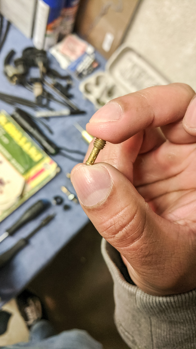

The jet on-top of the pilot jet (un-marked, stubby) looks like this after cleaning:
But my pilot jet still looks like a pinhole:
4. I can't even get my thinnest wire through. Now I'm trying very lightly, as to not damage anything. Is the pinhole light I'm seeing here normal or should I keep at it?

These are my jets:

One bristle from a wire brush works well to clear jets. And that pilot jet hole is very small. Good job checking them against a light.

It appears you have a set of vm24ss carbs that only have a pilot air screw. To the best of my knowledge all of the carbs (VM22 and vm24)that came stock on the 650s in the US market only those with the pilot screw have the additional #50 jet over, or under depending upon who you want to look/explain it , the the pilot jet.
I removed my years ago and the bike runs fine. I am not really sure why this additional jet was added, but feel that the engineers and designers thought it was needed to to provide a rather logical power band.

The stock jeting on a 77 KZ650 B1 (VM24) is #16 Pilot and #100 main Jet.
Keyster No.: KK-0041 kit offer a #15 and #102 jets
So with your #112,5 main Jet you are a little rich on a stock air box. Your main jets ( #112,5) is more like for runing pot filter.

Thanks, I left the 112.5 jets, makes sense they were purposely changed when changing to pod filters.
