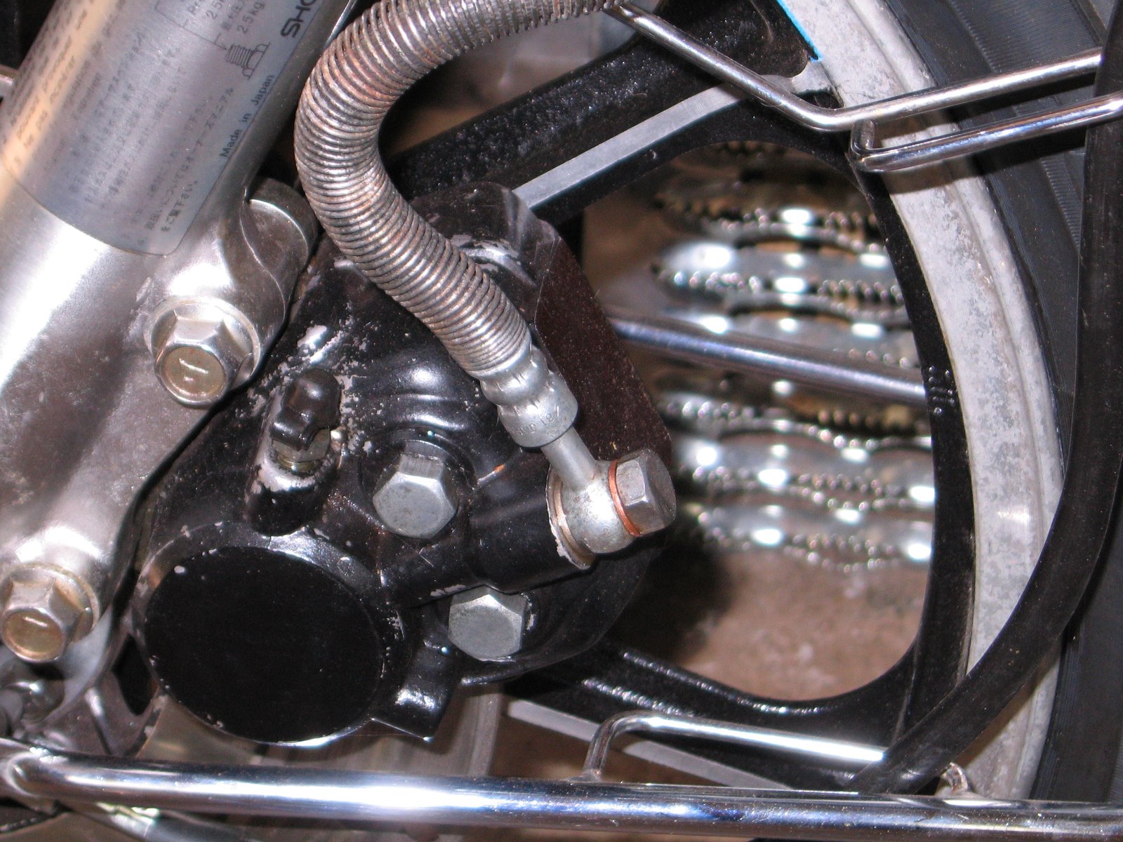

Air bubbles always stay at the highest point of the caliper at the bleeder screw.
But on your caliper air bubbles are locked on top of the banjo bolt.
The MC is on top of the handle bar and auto vent the air bubbles into the brake fluid Reservoir.

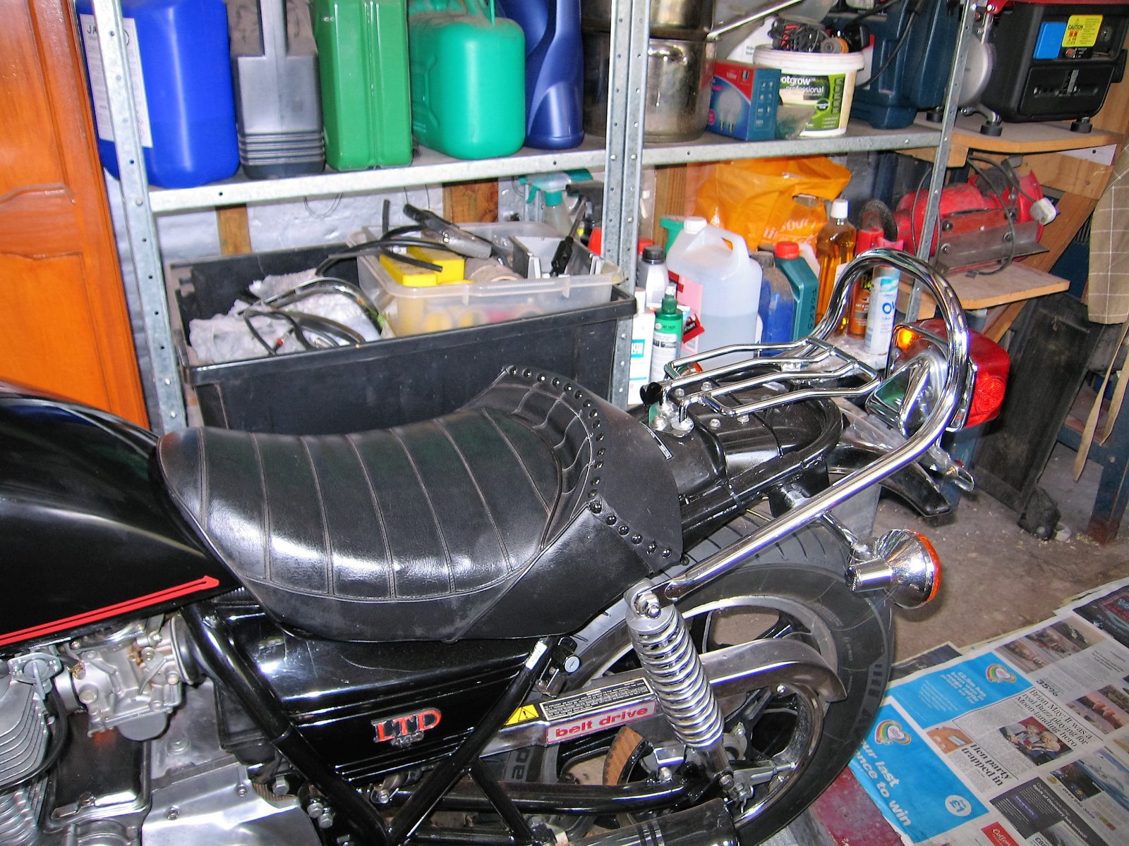

29 Jun 2019 04:37Beauty is in the eye of the beholder. For me, the shape is fine but the be dazzling looks like the back pockets of a 12 year old girls jeans.WIZZZ wrote: Is my mod' seat more ugly than the OEM ?

The calliper in the manual extract is different from mine.
