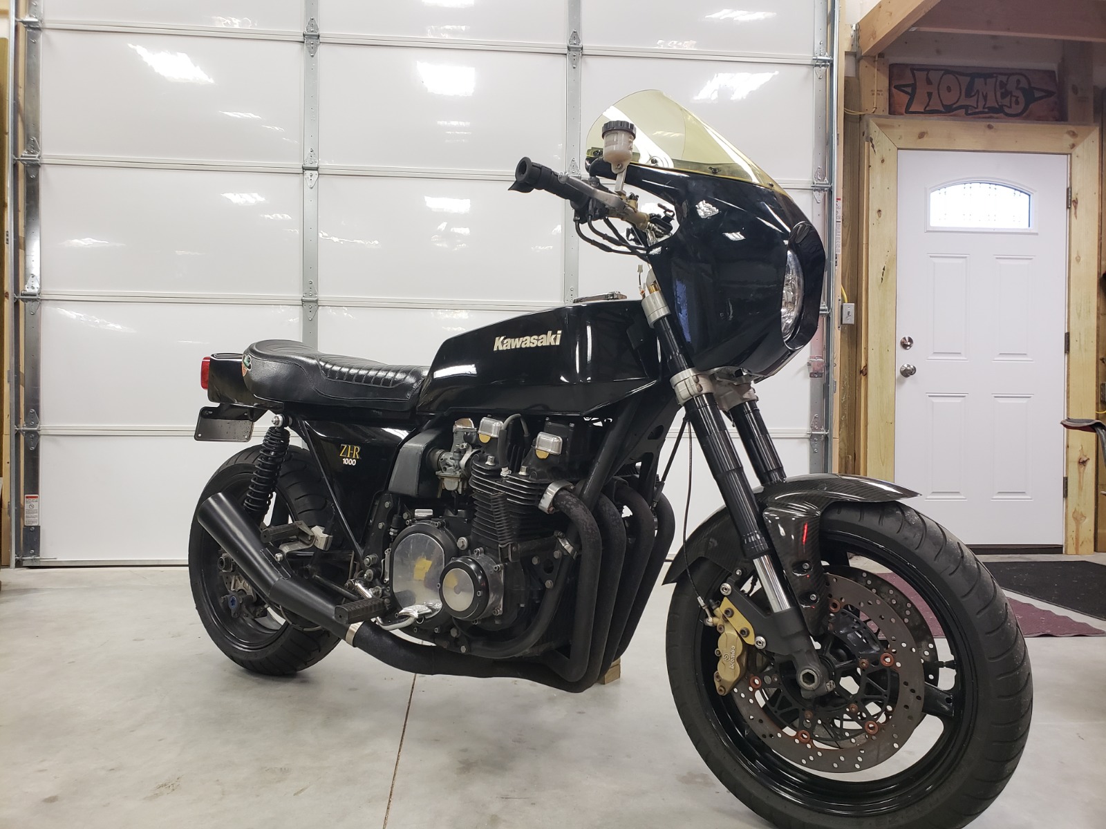

i have modded my 1980 kawasaki Z1R with a nod to putting it back together in stock form(someday)and move all of the mods over to one of my not so complete 78 z1r's .every mod i have made is reversible.i have kept every stock part i removed and carefully stored. r1 front end(my own custom drop triple clamp) and wheels,brakes etc.custom built(by me) chromoly swingarm.
i love my bike and from the conversations and reactions i get from people alot of other folks do to. i recently acquired a 1980 kz1000 ltd that has sat out and has a roached paint job and amazing looking( inside)tank.it is mostly complete and will make the perfect base for the stock black and silver LTD of my dreams since 1983 when i was 13 drooling over one my dad owned.now while my long term dream is for this bike to be restored,some of the original parts are so bad they have to be replaced. finding them first and paying for them second is going to take time and money. prolly alot of each.but i have a zx12 front end and a zx14 rear wheel so a zx14 front wheel and rotors,some custom machined triples, custom swingarm and i can have the old bike on the road pretty quickly and affordably as a kz custom mod.that way i can take my time and source the right stock parts to put it back stock.but in the meantime i am going to be enjoying a cool custom kz.that is going to look awesome next to my modded z1r! then once all the parts are ready i wll restore the ltd and move the custom/modded parts over to one of my kz900's and have a another cool bike in the stable. that's my long term plan,chess not checkers lol!

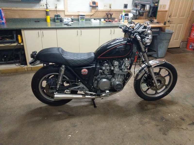

I've been working on changing a KZ440 LTD into a cafe bike. It was $200 and came with a clear title. No one is going to miss a 440 LTD.
I have clip-ons, VM30s, exhaust, etc. left over from a previous bike, and the idea of a belt-drive cafe Frankenbike amuses me. A spare tank from a KZ550 will fit right on there (and not interfere with the steering) so the horrible and dented teardrop tank can go away. I also picked up a standard KZ440 basket case to use for parts.
The original seat pan is still in place, and I used a coping saw to trim the foam from the stock king-and-queen seat into the bum-stop style. That particular project is stalled at making the custom seat cover, mostly because I don't really know how to sew - lots of trial and error. Adding the frame tabs for the rearsets will actually be easier than sewing, I think.
Anyway, it should be at least slightly faster than stock and with modern tires - and a more reasonable riding position - it should handle better.
