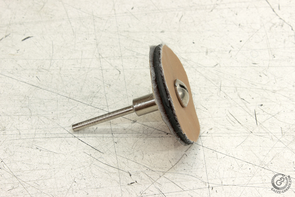

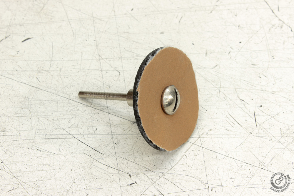

When assembled it looks like this:
Sandpaper could be installed on any side of the disc or on both sides simultaneously.

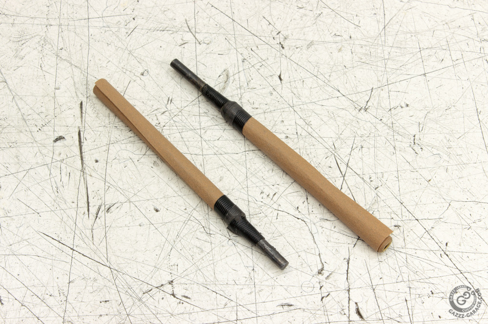

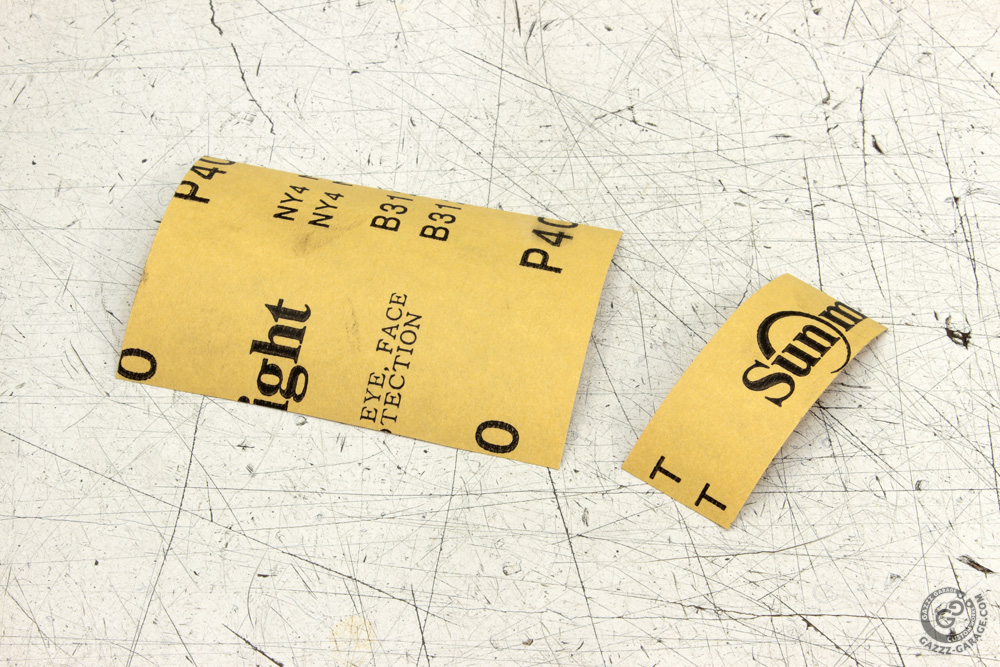

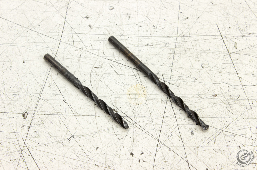

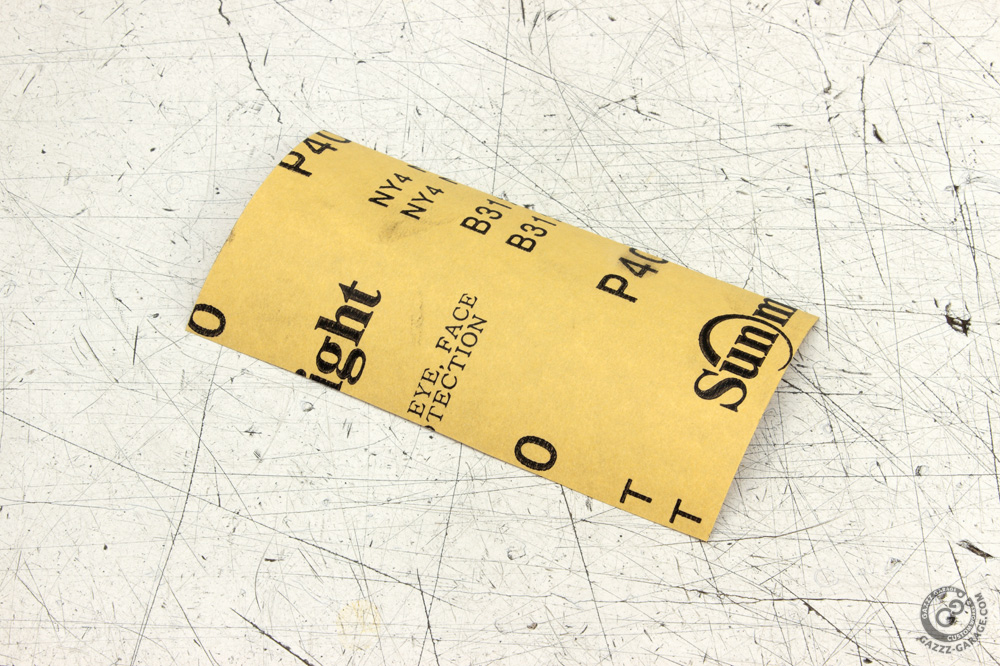

And last but not least attachment for rotary tools. Actually it's the most useful tool especially when it comes treating pipes or holes from inside (including ports of cylinder head). But it could be used on outer surfaces, ribs and grooves as well.
Most of "universal" sets of accessories for rotary tools come with pretty useless drill bits. Usually they might be used on wood or plastic but they are no good for metal.
We need two things to turn these drill bits into useful attachments. First is a rectangle of sandpaper (cut from sheet or roll).
Kawasaki KZ650 cafe-racer: in progress
Kawasaki Zephyr 750 (810ccm, 4in4, spoked wheels)
Honda CB815 "Eight Fifteen" cafe-racer
Yamaha XJ "Eight Ball" cafe-racer
www.gazzz-garage.com
- gazzz
- Posts: 563
- Thanks: 319
Re: KZ650 cafe-racer
04 Apr 2022 13:47 - 04 Apr 2022 13:47

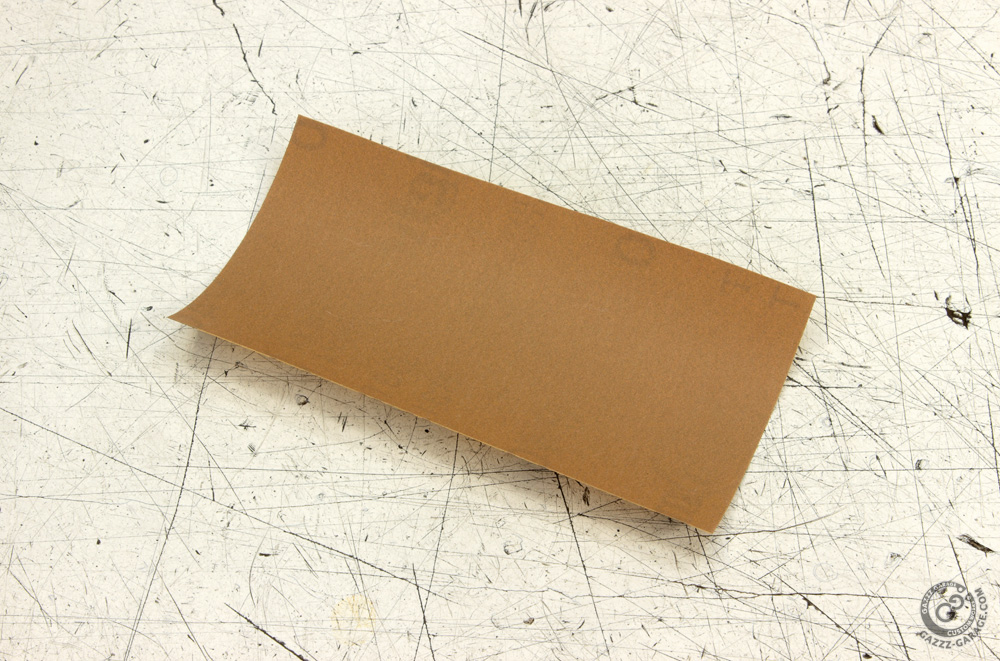

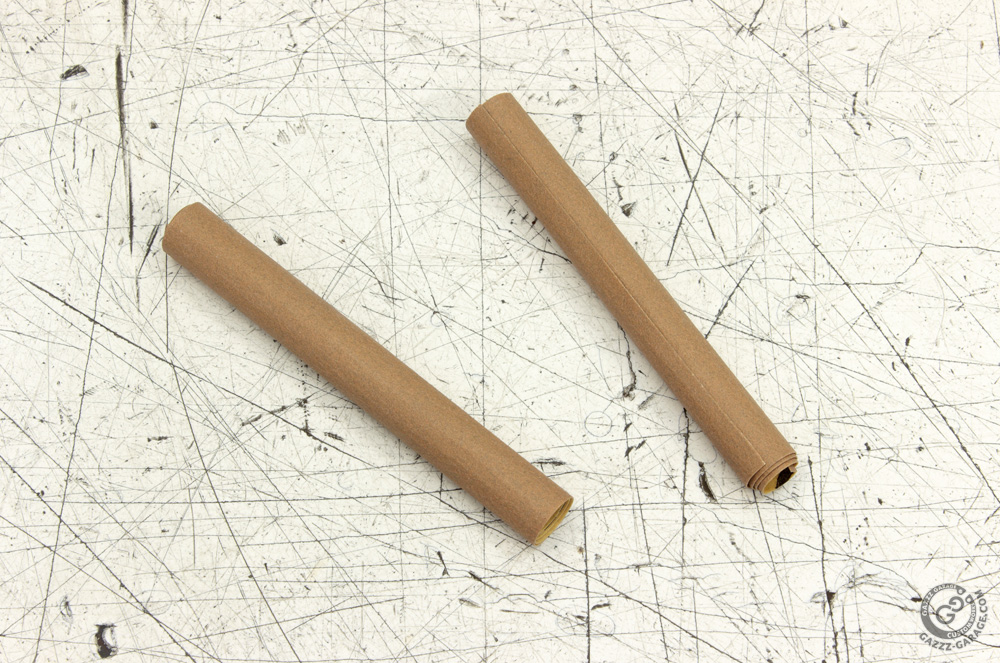

Diameter and length of future depend on dimensions of sandpaper rectangle.
It has to be rolled in tube like this:

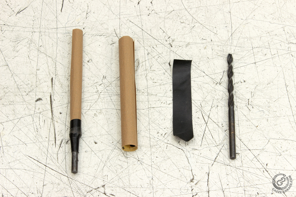

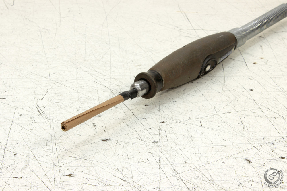

Roll of sandpaper has to have an internal diameter suitable for the drill bit, so the drill bit may be screwed into the roll with little force. Second thing we need for the tool is a strip of paper tape or vinyl tape or duct tape. With the help of that strip we have to fix sandpaper to drill. Mind direction of rotation.

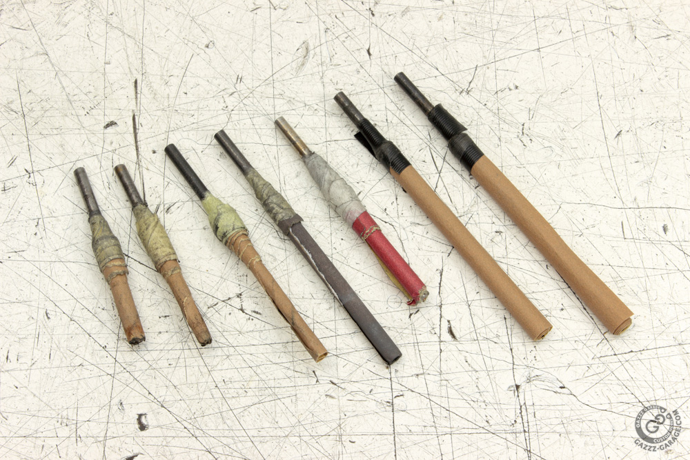

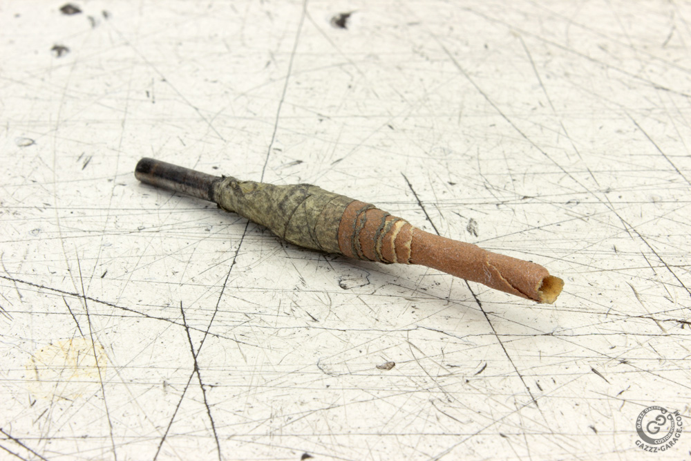

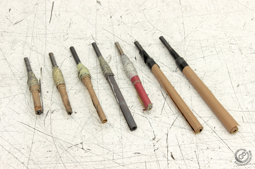

This tool doesn't like side loads because it essentially is paper. But it could last for quite a long time, since after the upper layer is worn it may be torn off exposing a new layer of fresh sandpaper and so on and so forth until the end of layers. Same thing with the working end of the tool: once it wears, it may be cut off with scissors. Wide range of sandpaper grit make this tool truly universal. Here are some examples of worn or half worn sandpaper attachments I have used some time ago:

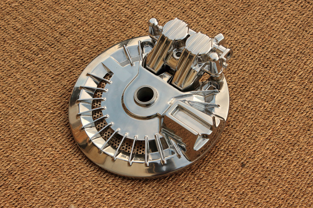

And here is the most illustrative example of work I did using all four types of tools. I believe you have already seen it.
