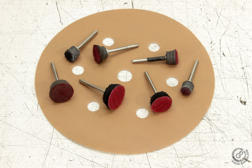

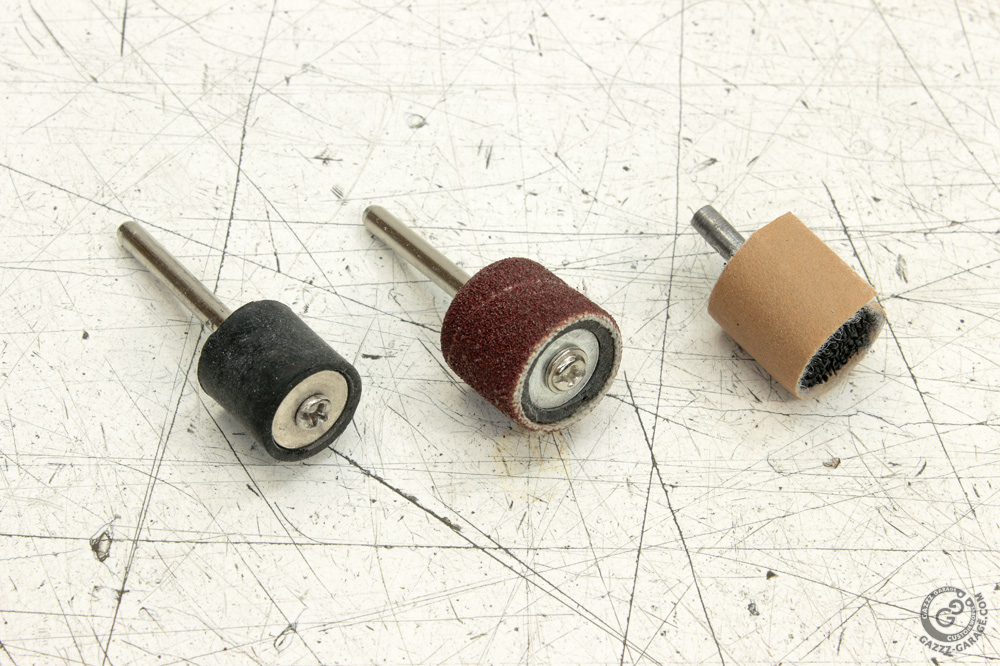

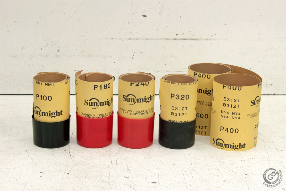

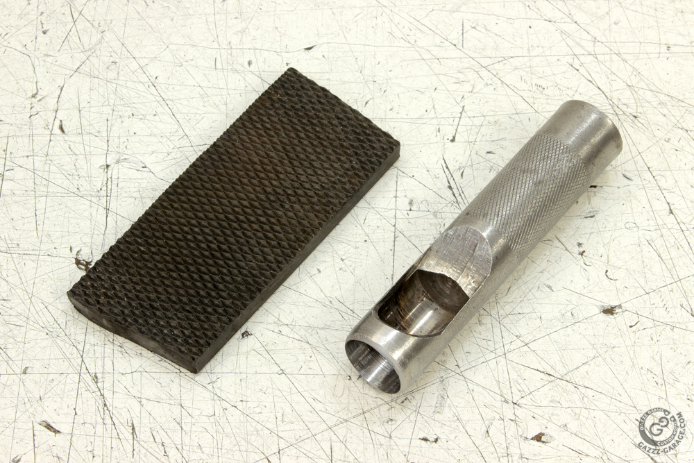

All of you have seen what I could do to aluminum parts. I already gave some tips on how to do that. Now it's time to give those tips that I have kept for myself. I thought them out on my own working on aluminum polishing for years. As I already mentioned polishing - it's a lot of sandpapering. So one has to keep a range of sandpaper at hand. Since I also regularly sand steel and fibreglass, I keep a large box specially for sandpaper and Scotch-Brite. All these materials are of automotive grade and my favourite brand for sandpaper and sanding discs is Sunmight. It is not a problem to store sandpaper sheets and sandpaper discs, but sandpaper sheet rolls always tend to fill all the space in the box and intertwine. Solution that keeps them in tidy rolls and makes them easy to use is simple. It's good old caps from penetrating oil and carburettor cleaner cans.
However, keeping sandpaper sorted is the simplest thing. Next tips will be about tools I invented while polished different aluminum parts. I have never posted them before, even on my own website. I preferred to keep them for myself since I worked them out on my own. But in times like we have here this knowledge may be easily lost and that will be no good. So I decided to share them with you. These tips wouldn't make work for you, but they may make it a bit easier.

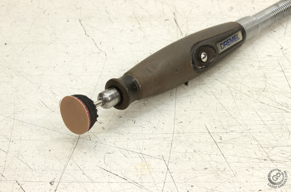

Here is the first tool: attachment for rotary tools to help sandpaper parts. It is especially good for different deppenings and hollows (like depressions for bolt heads in engine covers, for example).

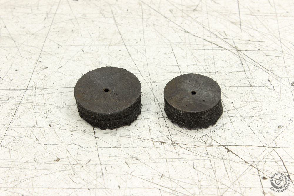

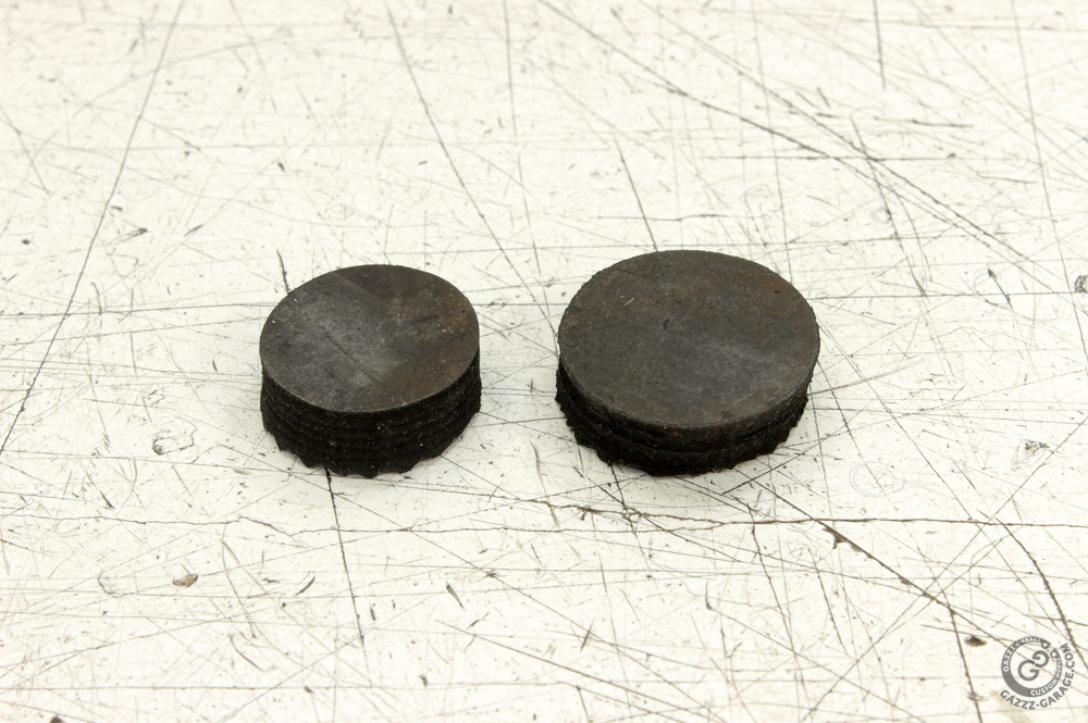

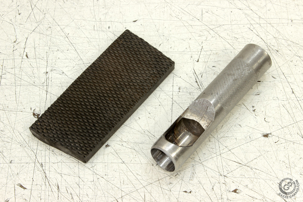

To make it one needs a thick shit of hard rubber. I bought that rubber in sheets in shops that sell rubber for shoe soles repair. One also needs a set of round hole punch tools.
Let's punch a couple of round blanks from the rubber sheet. The result might look quite raw, it doesn't matter.

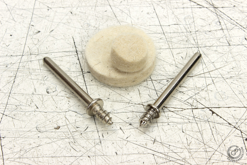

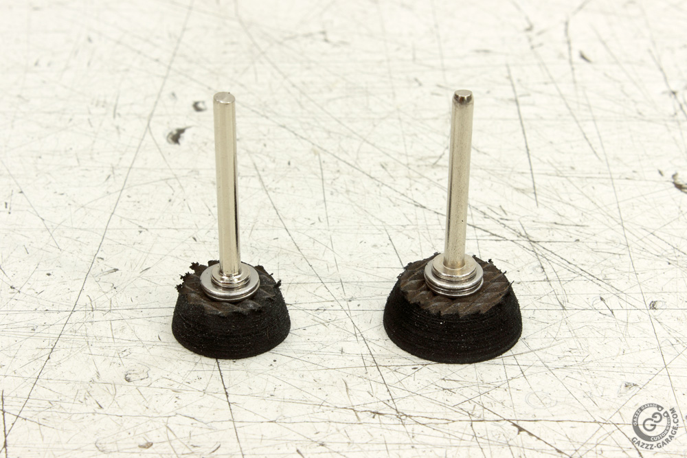

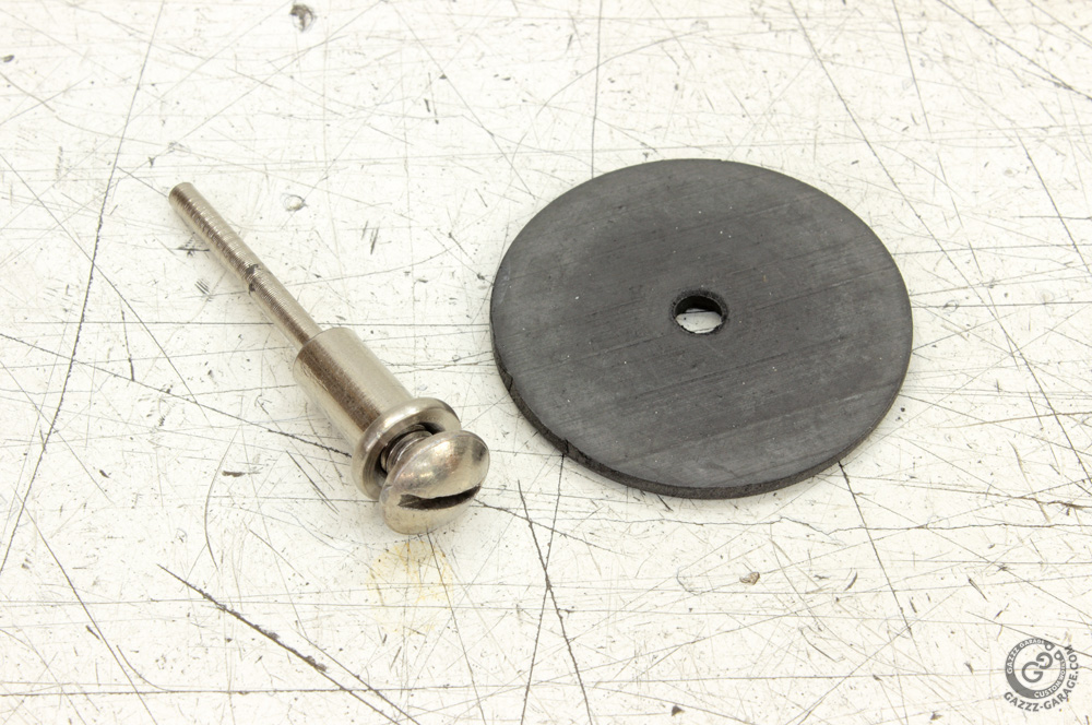

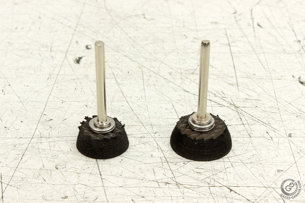

Then we have to drill small holes at the approximate centre of rubber blanks, like this:

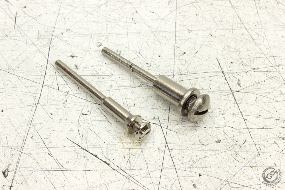

Next thing we need for our tool may be found in a set of accessories for rotary tools. It's a screw mandrel for small felt polishing discs.
I recommend putting a washer on the screw before screwing it into the rubber blank. If the screw length is bigger than rubber thickness, put some additional washers on the screw.

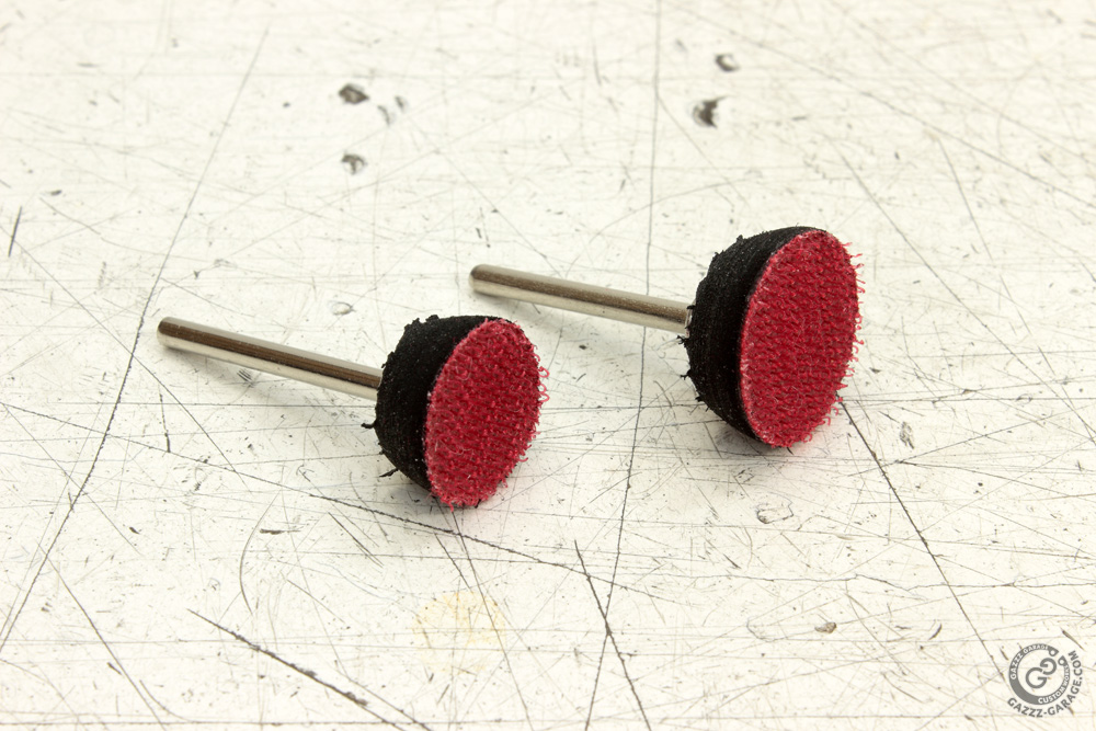

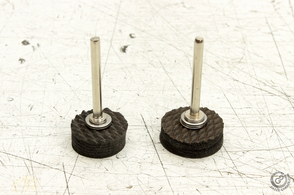

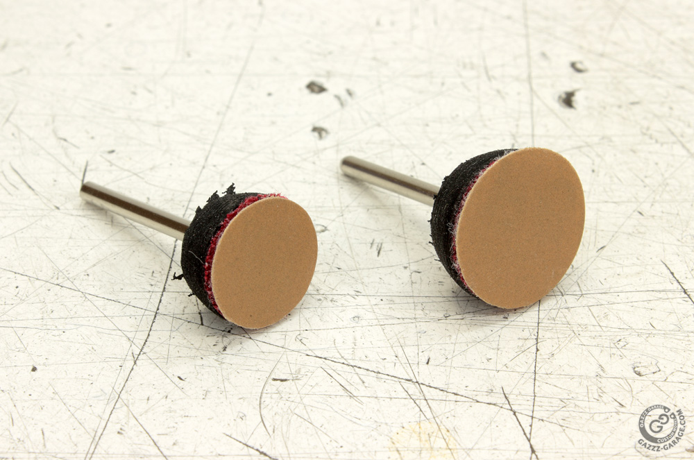

Now it's time to put a future tool in the bench drilling machine and make it perfectly round with the help of sandpaper (grit 60-80). I also recommend removing some weight from rubber by means of making it conical.

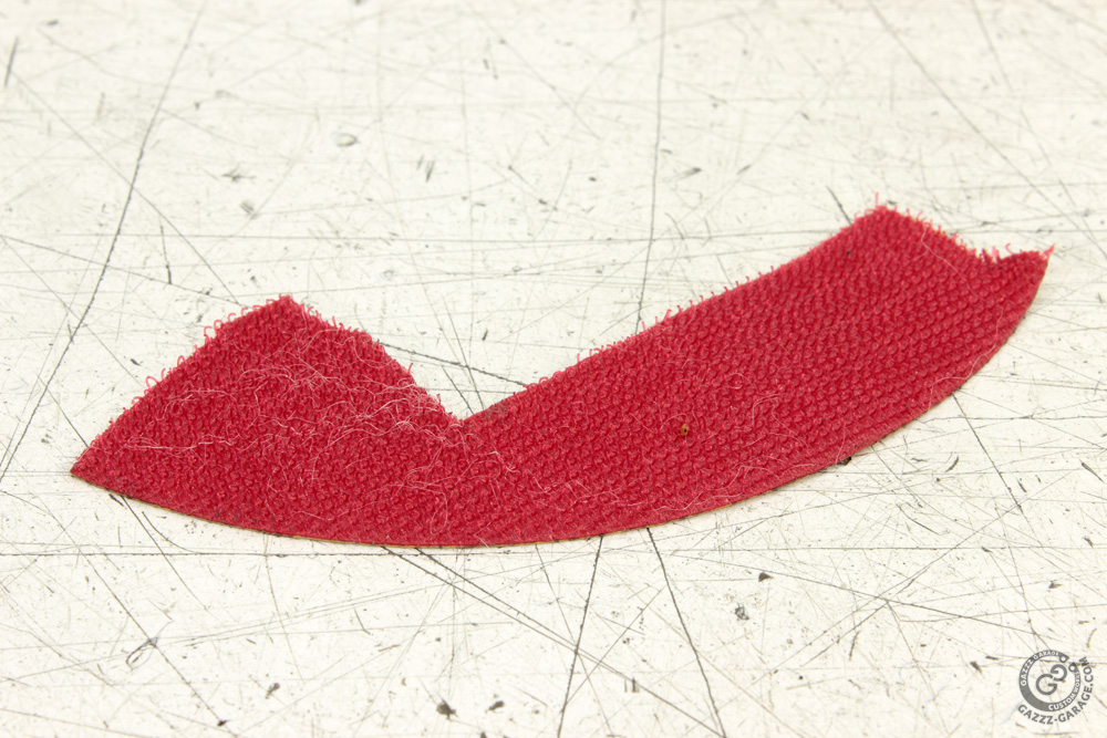

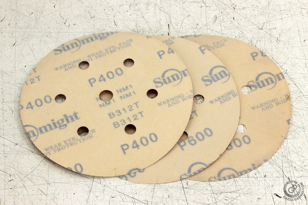

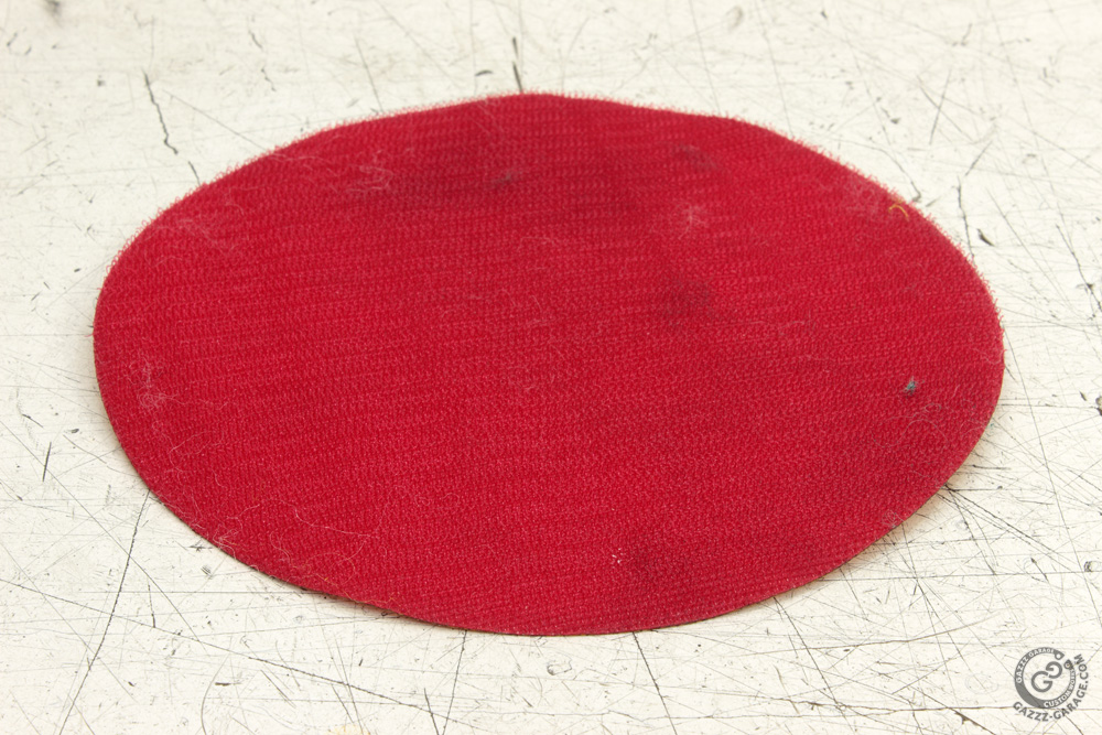

Next point is self adhesive hook-and-loop tape or disc. Last time I was buying such things I found 150mm discs. Still using first of them though.
It is crucial to degrease rubber contact surface thoroughly before mounting hook tape on it. Result will look like this:

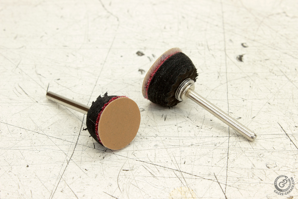

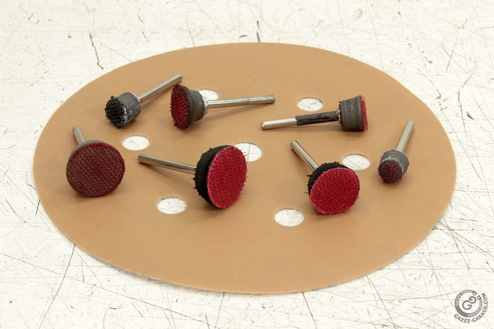

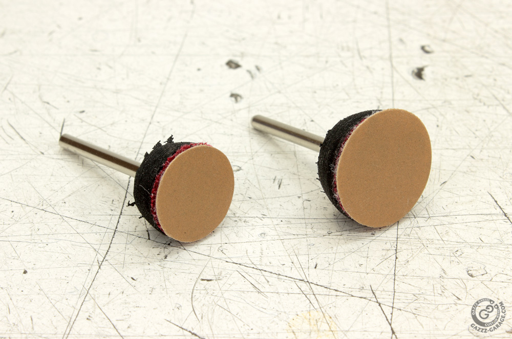

I have a lot of such attachments of different diameters. One may punch sandpaper pads for these attachments from sandpaper discs of different grit. In such a way this type of attachment is not only very useful, but also quite cheap even as one has to replace hook tape on it from time to time. I used such tools to sandpaper KZ650 engine covers and CBX550 wheel hubs and brake components.

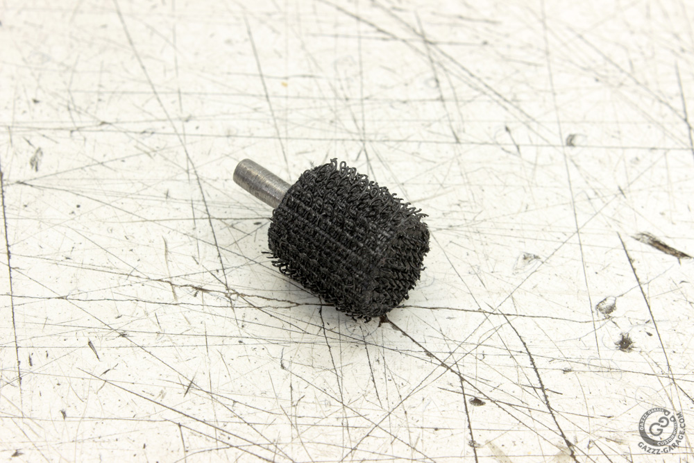

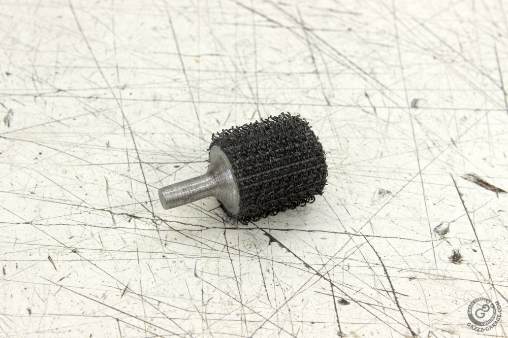

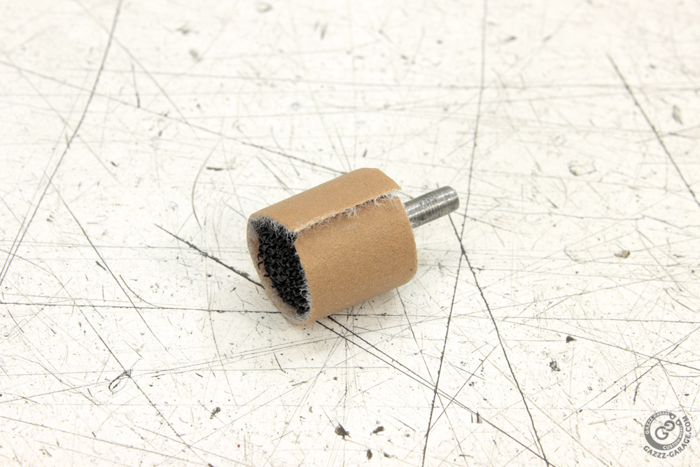

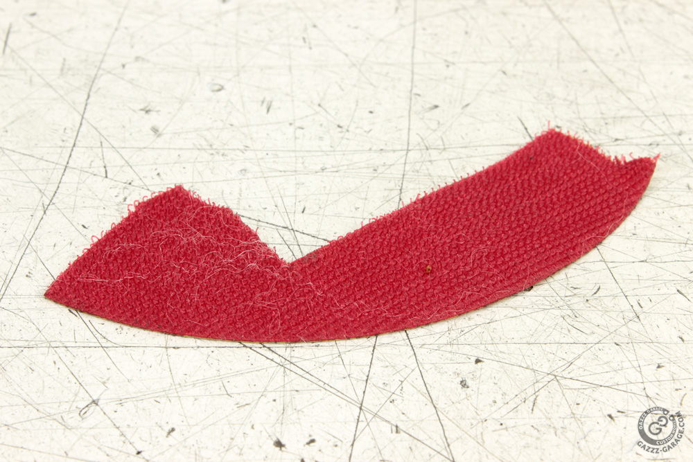

And here is another small attachment for a rotary tool. Initially it was a thread adapter (or something like that) with a round body. I decreased the diameter of its threaded rod so it could fit a rotary tool collet and put 3M hook and loop tape on its body.
In this way a piece of sandpaper disc may be mounted on it (with small overlap) like this. Mind direction of rotation.

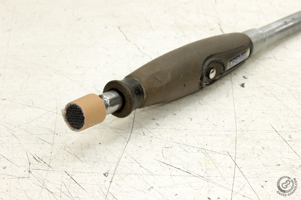

I invented this attachment when I became tired searching for sanding bands of fine grit. Using this attachment requires some accuracy.
