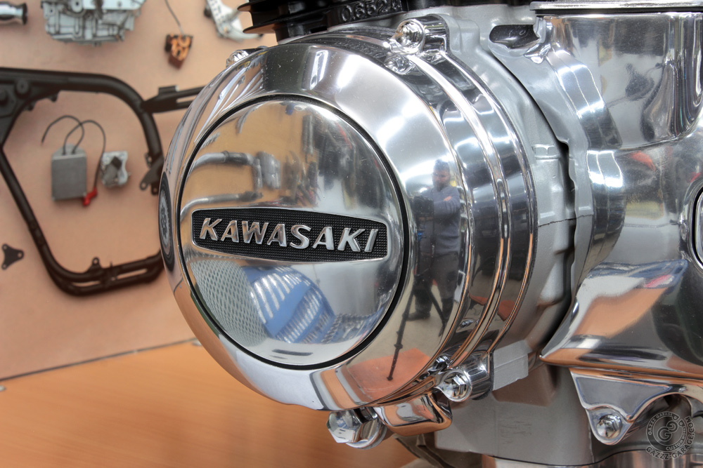

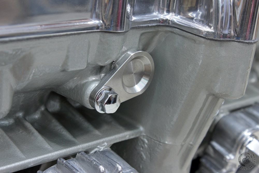

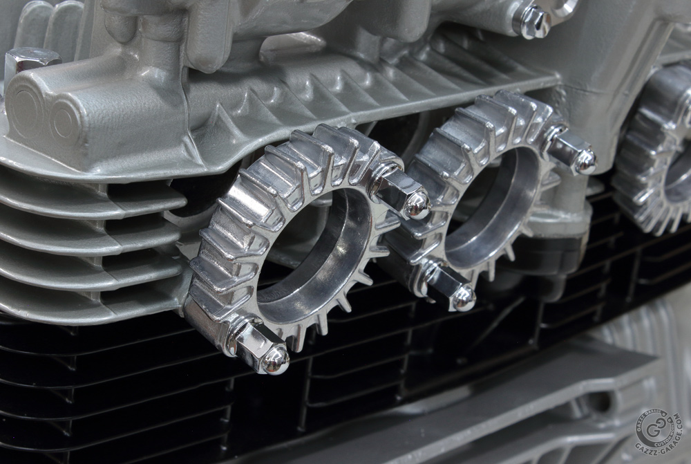

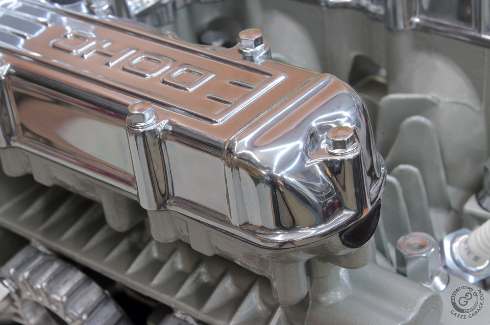

And here are some detailed photos of the Kawasaki KZ650 engine.
For all polished covers I chose chrome plated small hex head flange bolts. These are genuine Kawasaki bolts with length identical to the length of original screws. Chrome plated bolts look awesome.

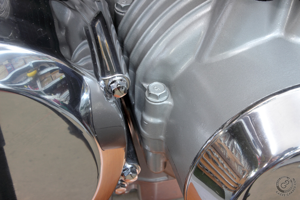

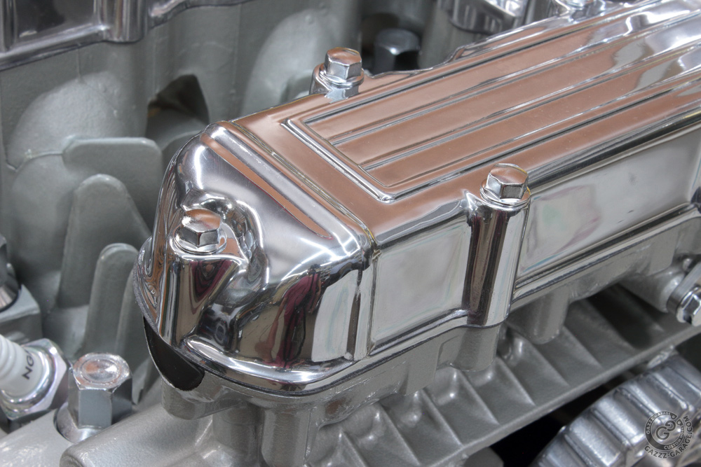

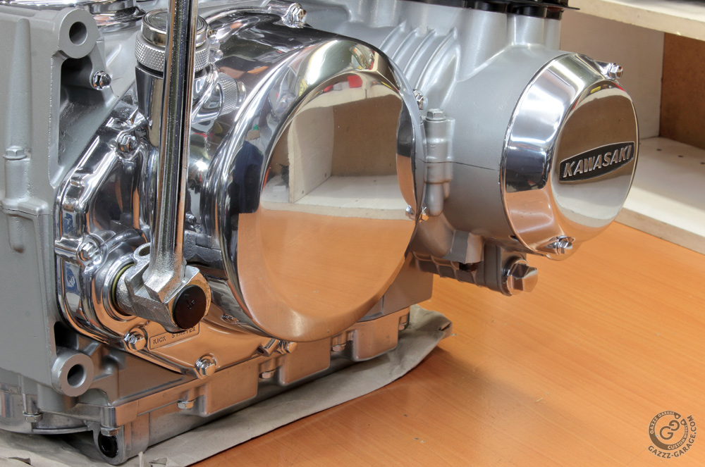

For intake manifolds I chose small hex head flange bolts in black colour.
As for the painted parts, I chose Kawasaki ZR7 flanged bolts that come zinc plated but in matte finish.

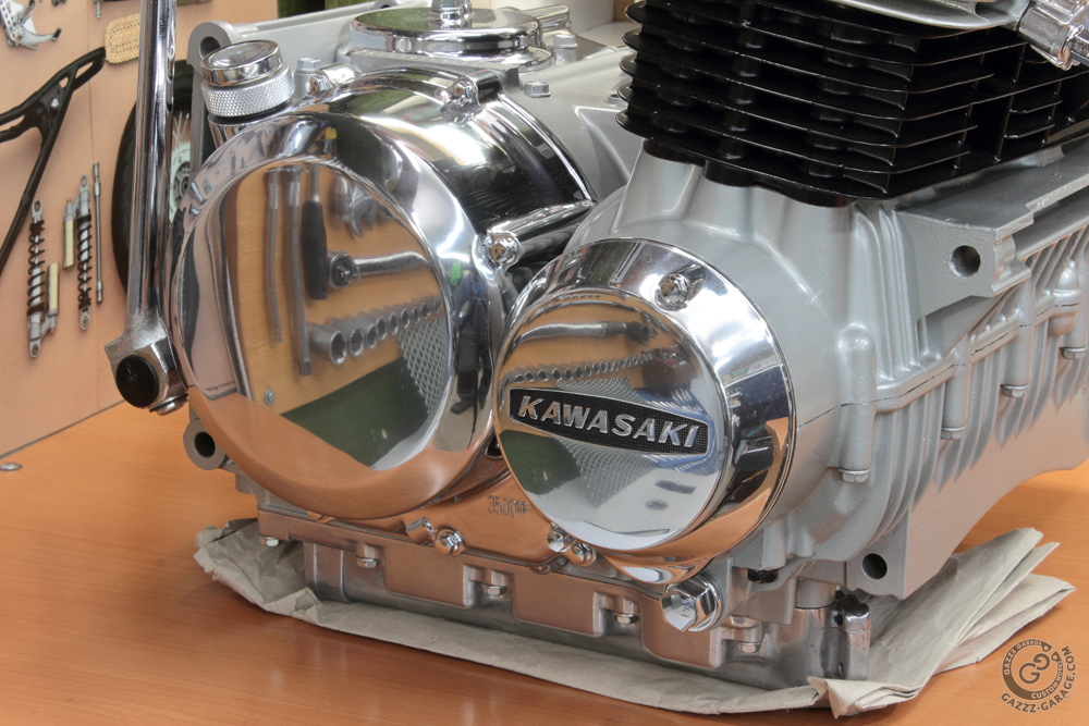

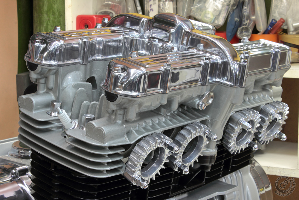

New genuine exhaust holders in combination with Honda high flanged cap nuts look great too:
Oil temperature gauge installed in place of oil filler plug.

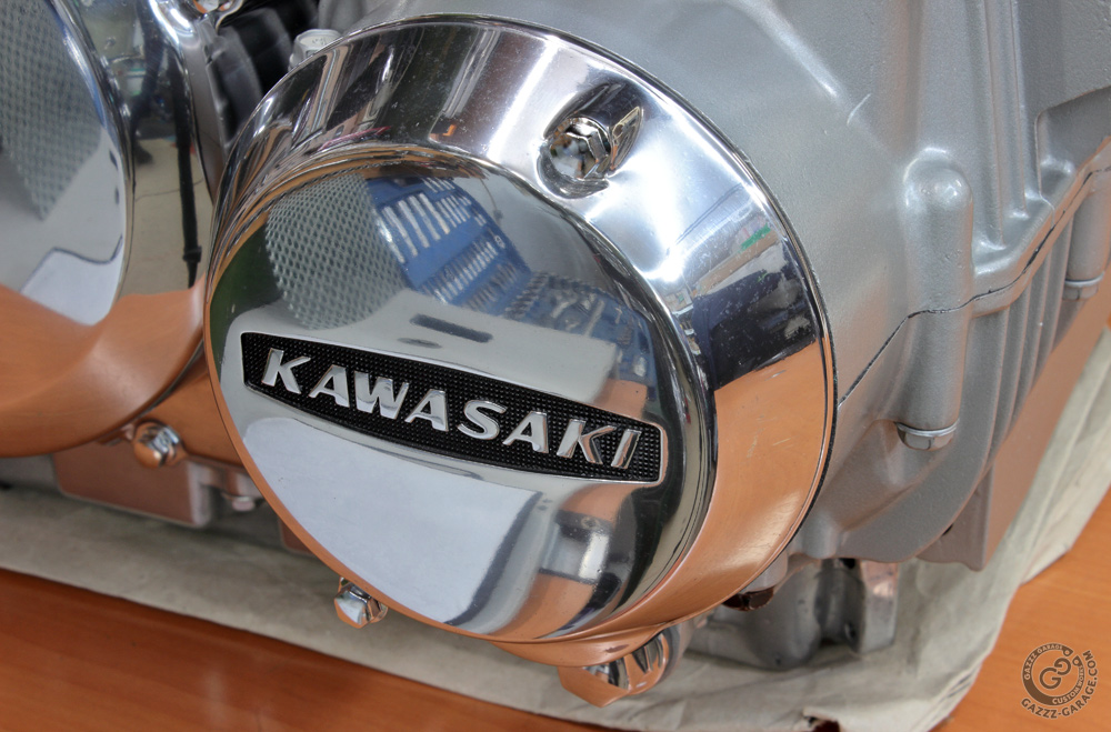

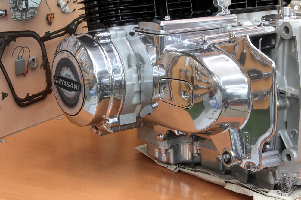

Beautiful clean work as usual Gazzz. Would that stator cover you used work on an 1982 GPZ 750 ?
The following user(s) said Thank You: gazzz
- gazzz
- Posts: 563
- Thanks: 319
Re: KZ650 cafe-racer
23 Nov 2021 13:52
Thank you! Yes, I think that cover will fit all further 750ccm developments of the KZ650 engine (up to ZR7).

Thanks for the reply Gazzz. To save going back through the thread, what model was it off ?
- gazzz
- Posts: 563
- Thanks: 319
24 Nov 2021 00:19
1978 KZ650 C2 and B2
