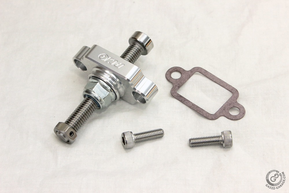

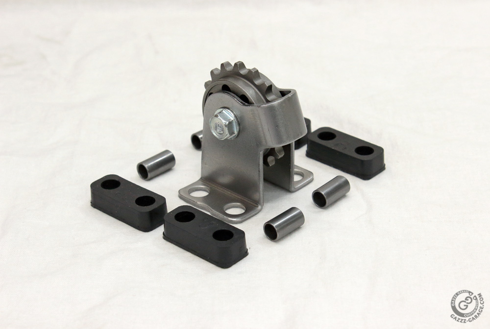

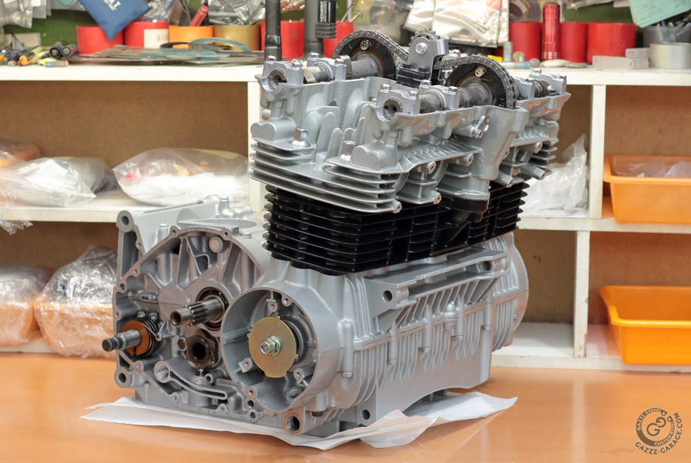

With the cylinder head in place my next tasks were camshafts installation and timing adjustment. I bought a Kawasaki Zephyr 750 camshafts for the KZ650 project. They are mostly identical to KZ750 camshafts and have similar lobe heights but Zephyr 750 exhaust camshaft has only blank in place where KZ750 has tachometer gear. Therefore, Zephyr 750 camshafts are still compatible with KZ650 cylinder head and camshaft sprockets.
Photos of me working was taken, as usually, by Oksana.
All-new components of new upper idler assembly:
PMC manual tensioner.

As for the valve shims, I started with the thinnest on the first camshafts installation and then, after measuring gaps I replaced them with shims of correct values.
As for the timing adjustment, well, it’d be better to put it in a separate article (and pictures for it are already ready).

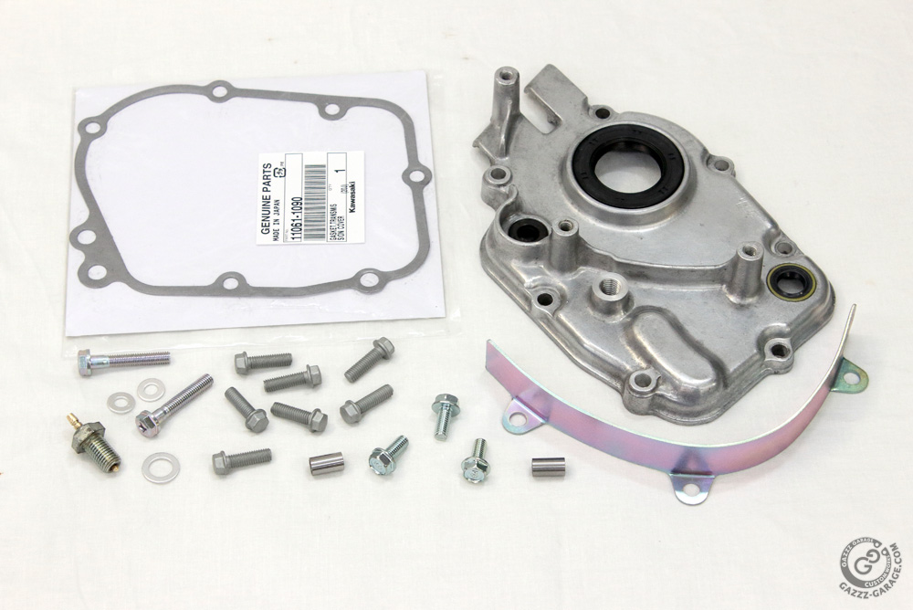

Therefore, let’s jump to the transmission cover. And again, all components except the cover itself and neutral switch were new.
I didn’t use the shift shaft oil seal guide for cover installation. Instead I checked the shaft for smoothness and put the cover slowly with seal and shaft oiled.
