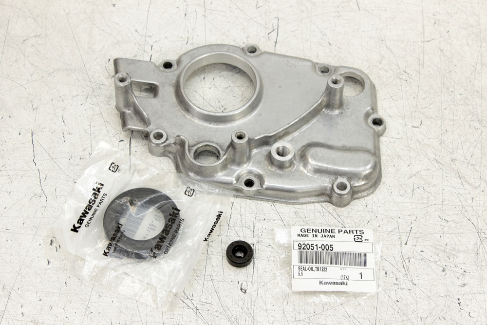

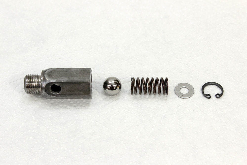

And here is the last part of preparations for Kawasaki KZ650 engine assembling.After engine dismantling I put relief valves (have two of them) in a separate box. And there they remained untouched till time came to get them clean, reassemble and choose one for upcoming engine assembling.

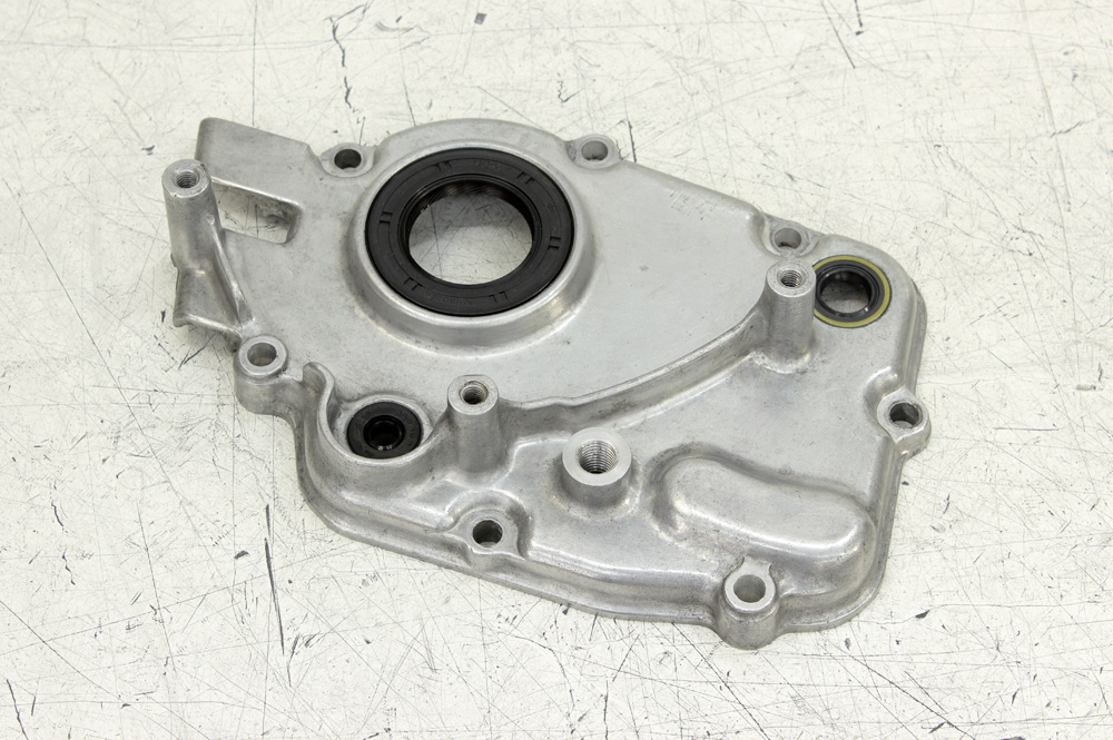

Next task was to install new genuine seals into covers. First came the transmission cover.

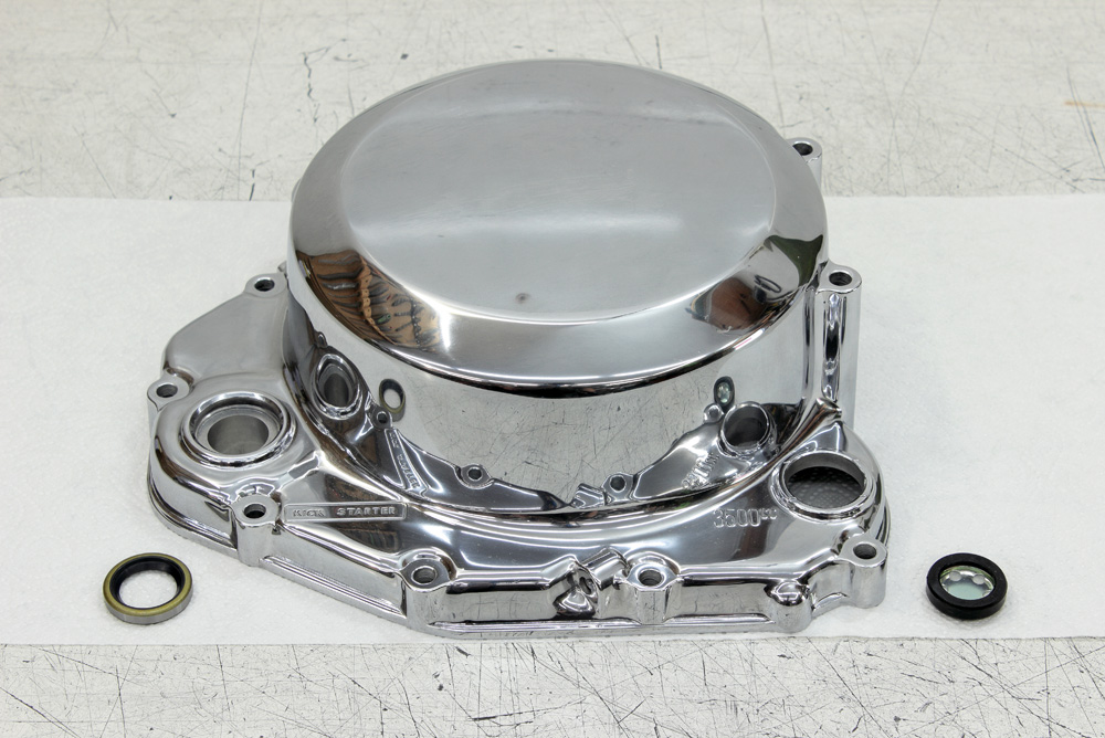

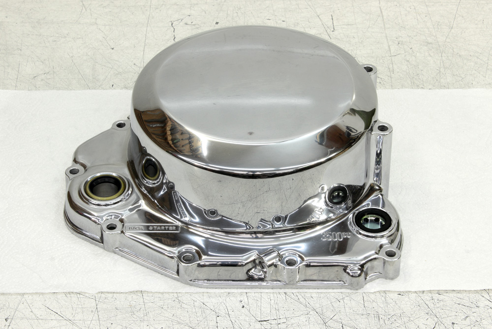

Then it was time to install the kickstarter oil seal and oil level sight glass into the clutch cover. As you already know I used a dab of sealant to fix it in its place.

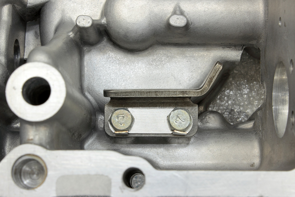

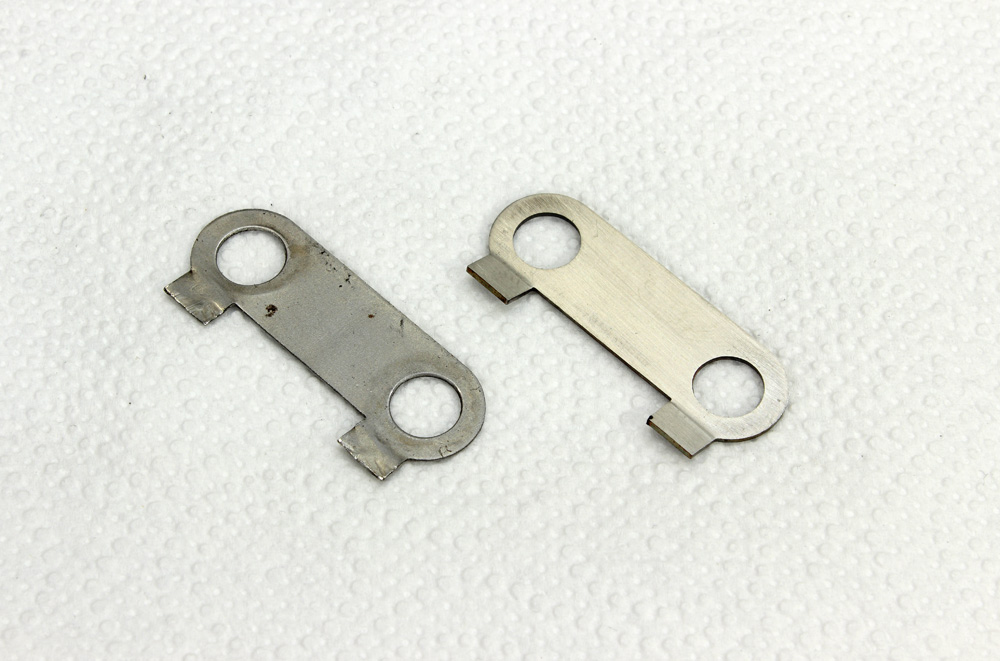

Next point in the list was kickstarter stopper. It is to be fixed to the lower half of the crankcase by means of two M6 bolts equipped with a lock washer. This lock washer is no longer available and with modern thread locking compounds there might be a question if it is really necessary. I decided I needed one, so I measured the original lock washer, made its drawing and ordered it to be laser cut from stainless steel. The thinnest stainless steel plate available was 0.5mm. It was a bit too thick compared to OEM lock washer, but it is the case when one works with what one could get. Here they are, OEM and my lock washers side by side:
Lock washer bending was (expectedly) tough but bearable.

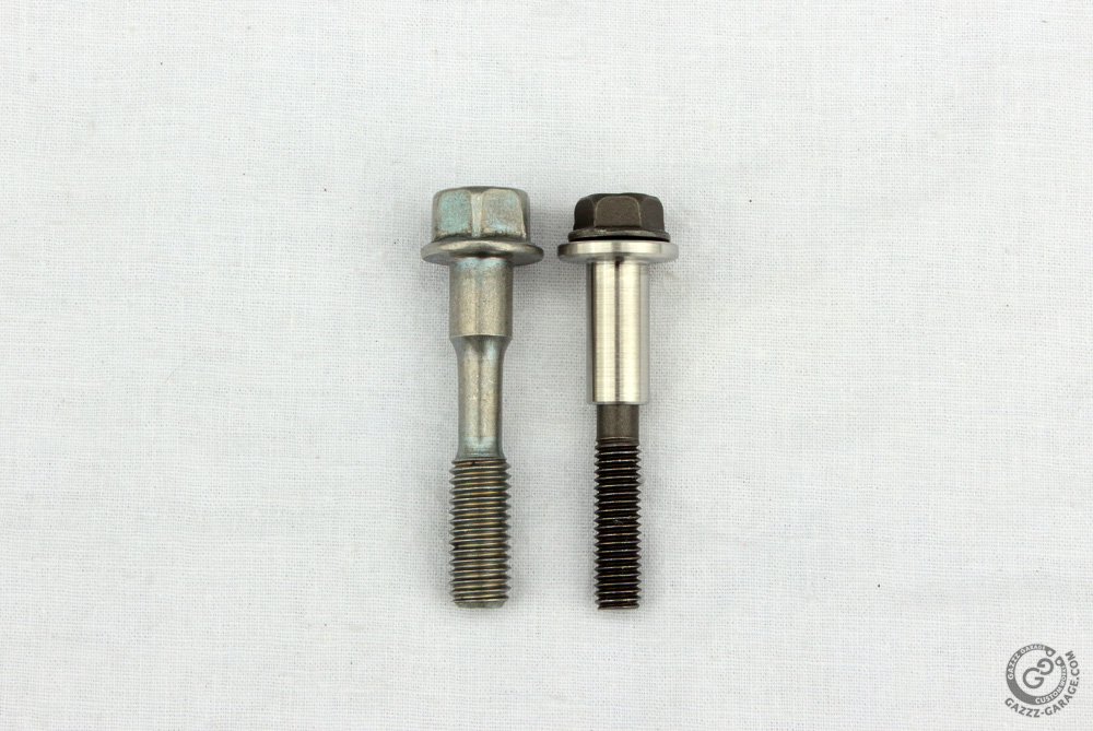

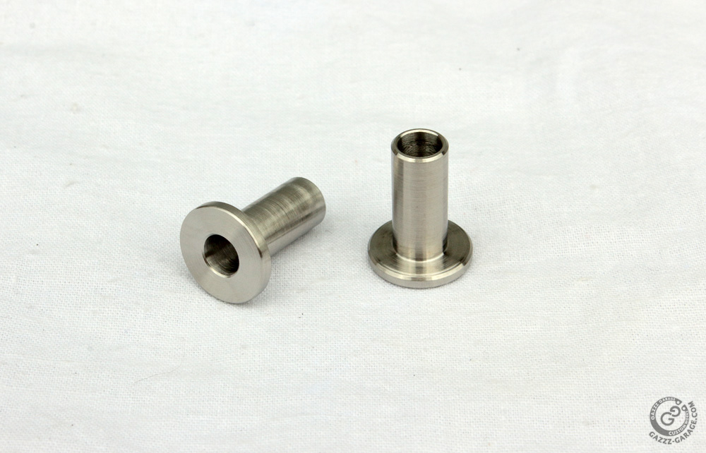

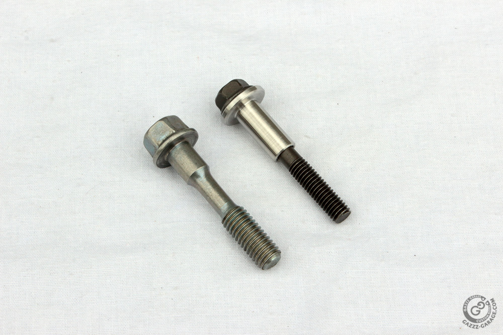

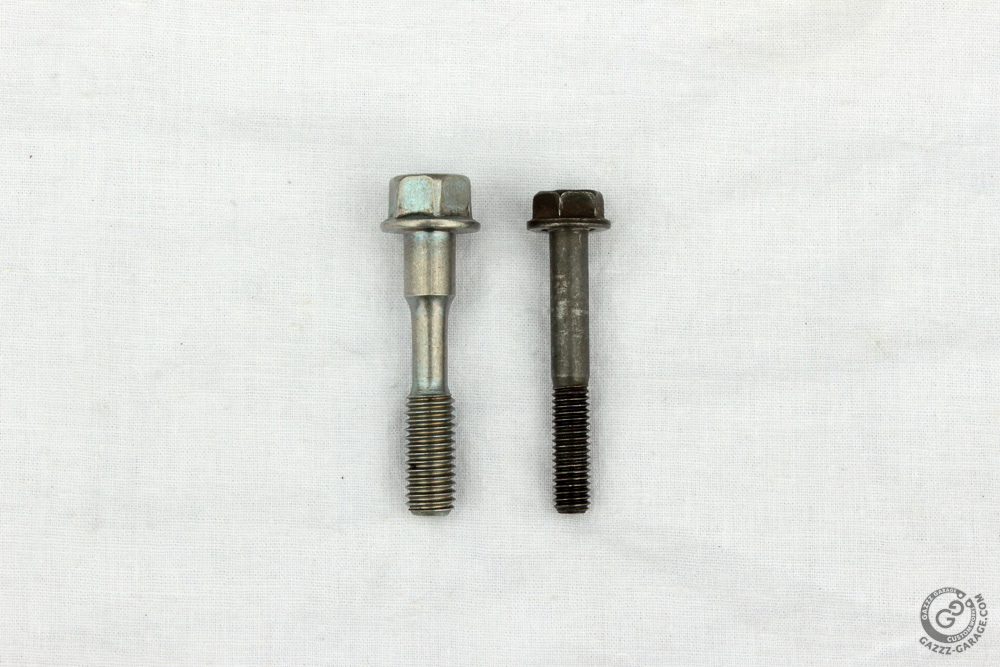

And here we come to the last part of this chapter. Since I decided to use KZ750 cylinder head along with KZ650 cylinders, I faced an issue: cylinder head is to be fixed to cylinders not only with cylinder head studs, but also with two bolts and while in case of KZ650 these bolts are M6, in case of KZ750 they are M8 with bodies partly reduced to around 5.5 mm. Here are KZ650 and KZ750 (Zephyr 750 actually) bolts in comparison. The length of both is identical: 43mm.
KZ750 cylinder head has holes to accommodate 8mm bolts and it is a core of aforementioned issue: for one thing, 6mm bolt in the more than 8mm hole might be skewed when installed, for another its head has diameter smaller than diameter of 8mm bolt head, therefore there is a question if it will have sufficient contact area. Therefore, I didn’t like the idea of using the KZ650 m6 bolt with KZ750 cylinder head, but the idea to cut 8mm threads instead of 6mm threads in cylinders was even less attractive for me. To solve the issue I designed adapters to fit 6mm bolts into holes for 8mm bolts:

Adapters were made of stainless steel with heads of diameter similar to genuine 8mm bolts. Since I had to use longer bolts ( to compensate 2mm of adapter head), I bought a couple of 6X45mm bolts (genuine Honda, of proper tensile strength). Here is my setup in comparison with 8mm bolt:

And here is a pictures of how it works:
This was the last point in the preparation list. With all preparations done I proceeded to engine assembling.

14 Jul 2021 12:36On my motor it was missed alltogether. And I am first opening motor, so it was like this from factory. I didn't find them in stock (NLA) so I just used blue locktite and torqued to spec.Next point in the list was kickstarter stopper. It is to be fixed to the lower half of the crankcase by means of two M6 bolts equipped with a lock washer. This lock washer is no longer available and with modern thread locking compounds there might be a question if it is really necessary. I decided I needed one, so I measured the original lock washer, made its drawing and ordered it to be laser cut from stainless steel. The thinnest stainless steel plate available was 0.5mm. It was a bit too thick compared to OEM lock washer, but it is the case when one works with what one could get. Here they are, OEM and my lock washers side by side:

14 Jul 2021 12:37Which way you installed second (inside) seal? Any pics?

14 Jul 2021 13:20I have two sets of cases, one of them had a lock washer, another came without it. So it may be that not all kickstarter stoppers were factory equipped with lock washers. Situation with dowel pins is simpler. As far as I know, front and rear dowel pins weren't used in serial KZ650s. They were replaced by two dowel pins beside the ends of the crankshaft (left and right). This makes sense since the position of the crankshaft is most critical. Also, such position of dowel pins is classic for inline fours.On my motor it was missed alltogether. And I am first opening motor, so it was like this from factory. I didn't find them in stock (NLA) so I just used blue locktite and torqued to spec.
2 dowels were missing from cases as well (front/rear).
These seals have to keep grease inside of the shift shaft guide, so they are to be installed back-to-back: outer seal facing outer side and inner seal facing engine.
