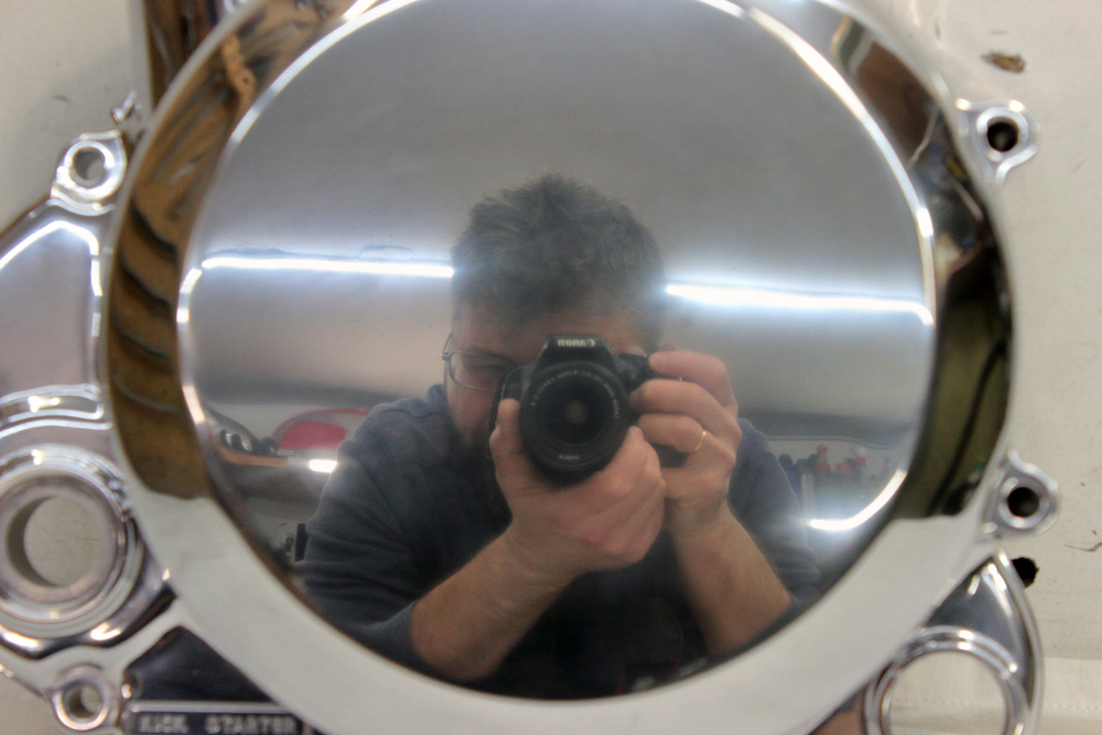

I was forced to work accurately on lettering, since they are pretty thin, but result like this will do for me.
And talking of reflection, it was hard not to notice them during photo shooting:-)
Bit closer:
Bit closer:

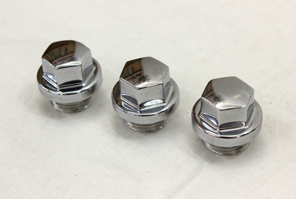

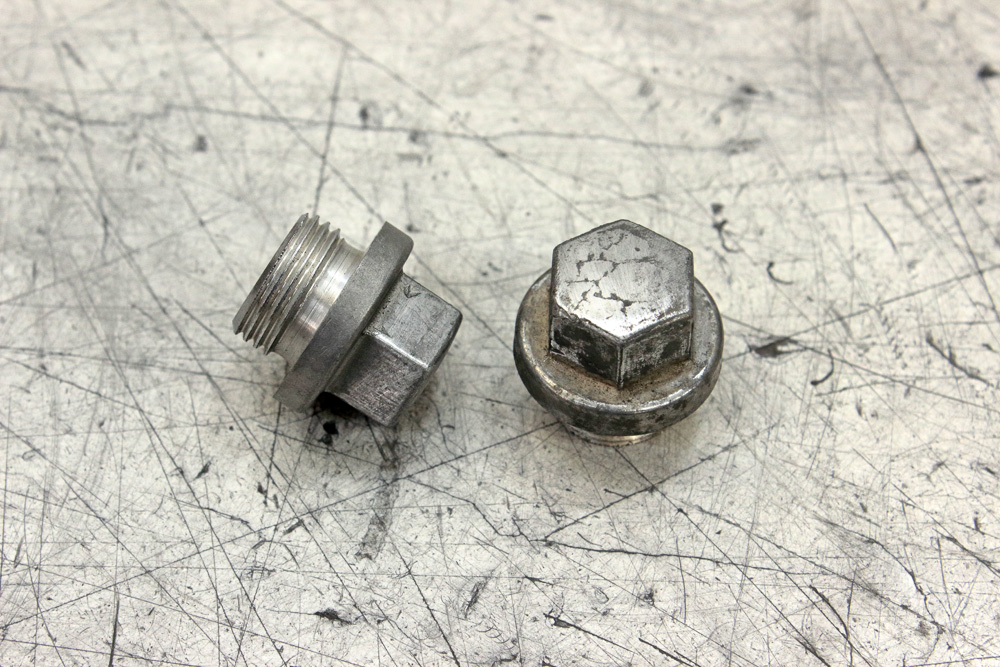

However, let’s proceed to smaller parts, like breather cover or plugs for the main oil gallery. Here they are, plugs before sandpapering and breather cover already in process:
Plugs were pretty rough and since they have to be tightened by wrench, I couldn’t take much aluminum from them.
But the result looked much better even with such limitations.
